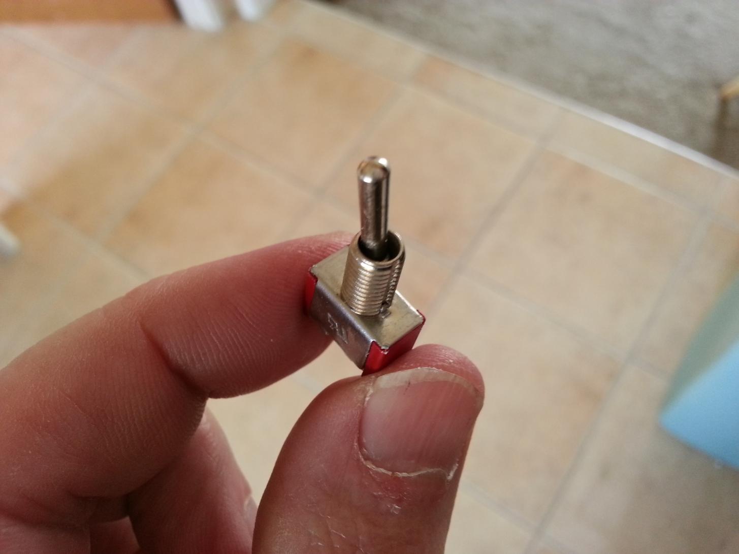

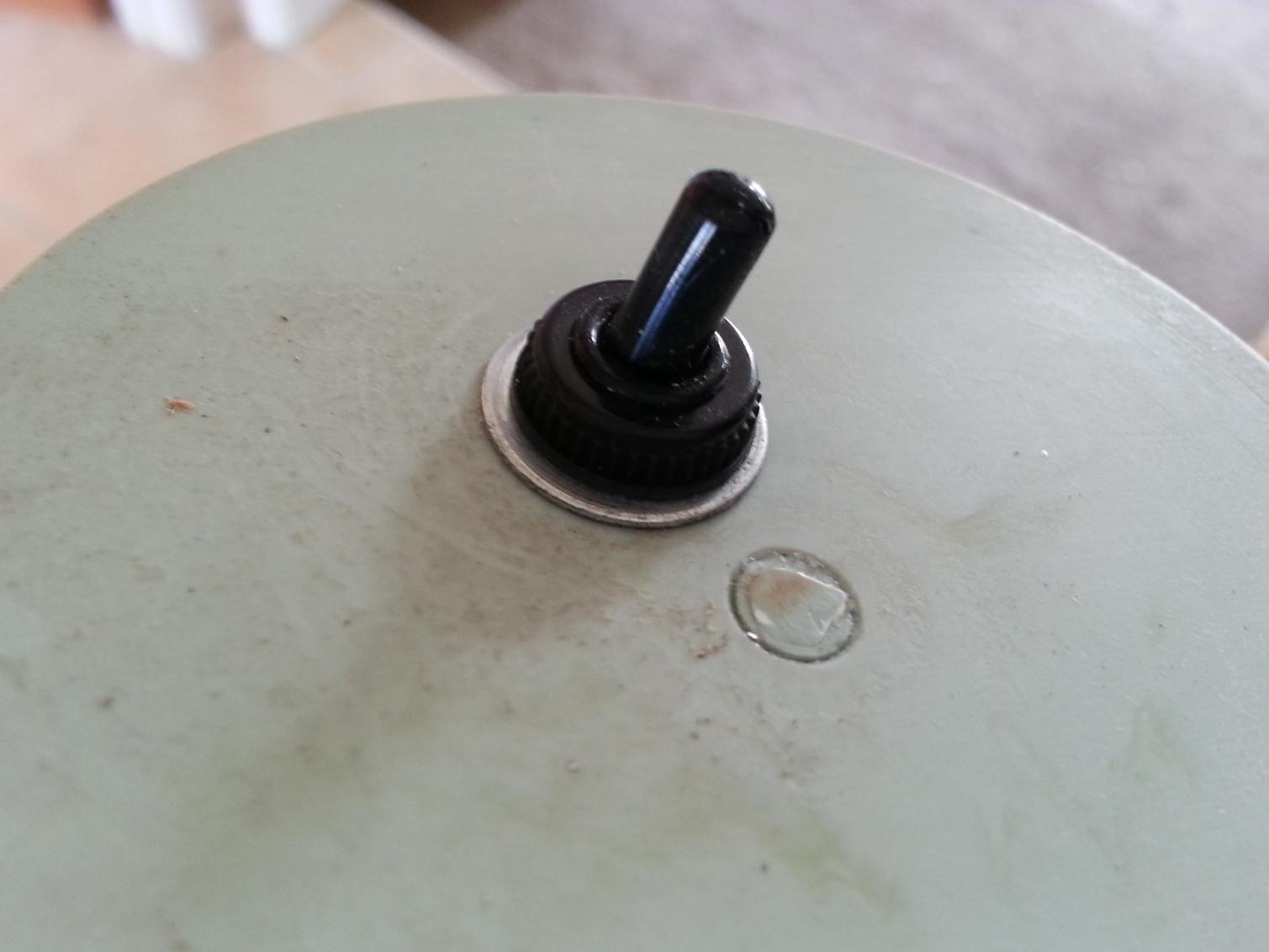

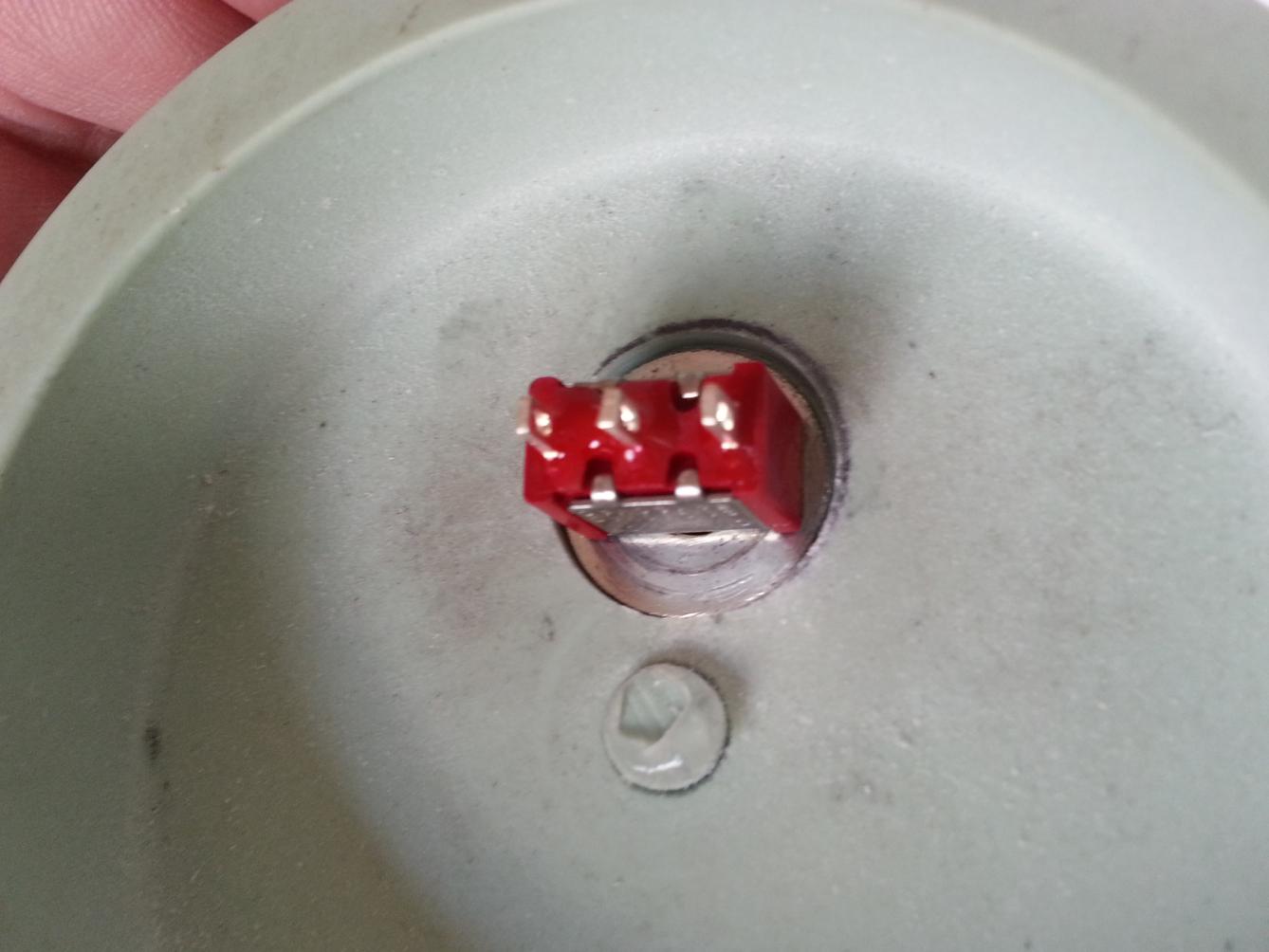

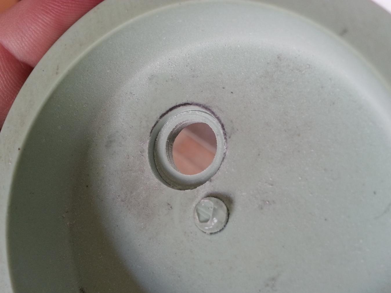

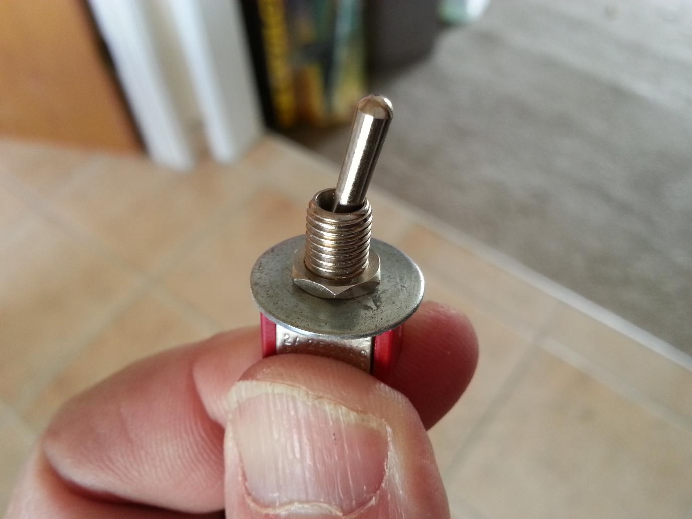

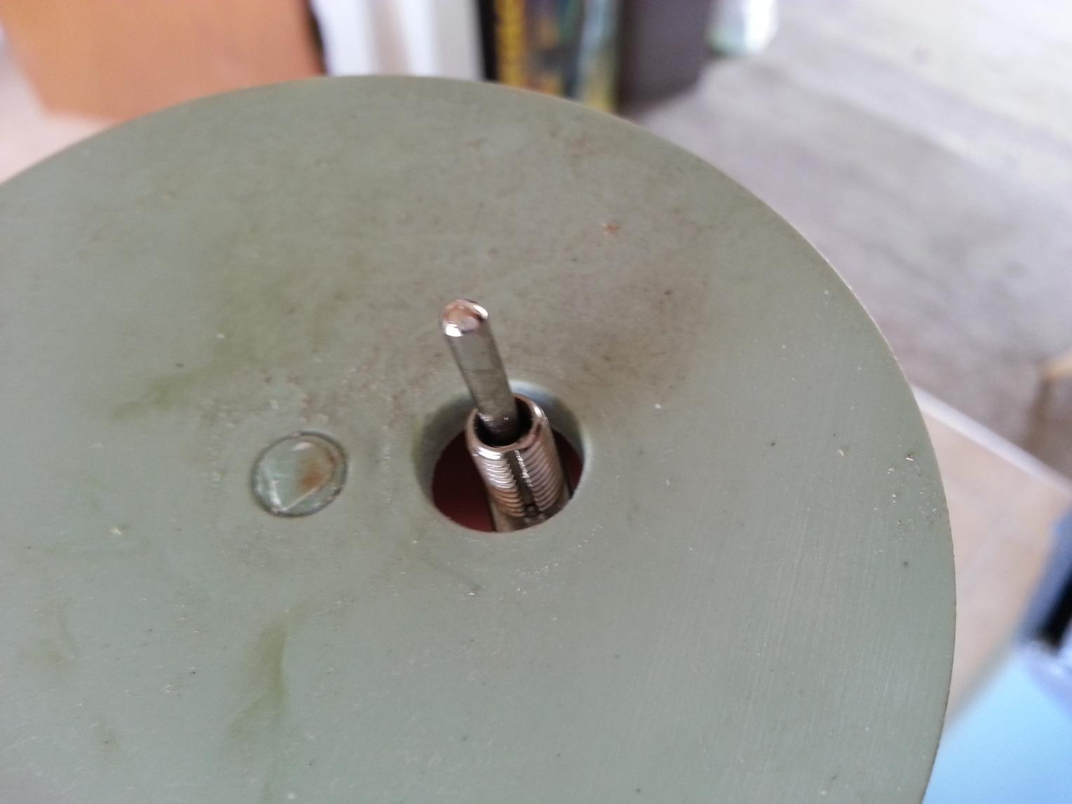

                        Reading this is somewhat alarming. I just purchased and received yesterday the Skipjack subdriver. I noticed the micro switch that came with it was so small it almost fell through the hole in the forward bulkhead and barely protruded beyond the surface of the bulkhead. This was a source of great consternation. The photos posted by He Who Shall Not Be Named (TM) clearly show a larger toggle switch which explains the large hole. Now I read the micro switch cannot handle the amperage, a thought which also crossed my mind. Is this true? I paid good money for an electronics kit that was supposed to be sufficient for this boat.
                        Since the switch was so small, I did find a better way to mount it. I secured a 5/8" washer to the switch and drilled a 5/8" countersink around the existing 1/2" hole from the interior of the bulkhead. This allowed the switch to sit further into the bulkhead and protrude further out the exterior, allowing sufficient space for another thin washer on the exterior, so that the rubber O-ring in the plastic and rubber exterior sleeve would have a flat surface to seat upon, which would enable it to serve its waterproof intention. Of course, generous amounts of RTV silicone sealant will enhance the waterproofing.
                        The switch itself is marked 5 Amps at 120 Volts AC. I'm no electrician, but if it can handle 5 Amps at 120 Volts AC, it cannot handle 5 Amps at 11 Volts DC? I don't know. I only know I paid a lot of money for this, and you are saying the switch is insufficient.
                        He Who Shall Not Be Named (TM) or Mike Caswell please respond and confirm whether this switch is sufficient for its purpose.

                          The switch is not. I will fix you up. Contact me. dmeriman@aol.com
                          I'm conferencing with Mike on this matter -- thanks for bringing it to our attention
