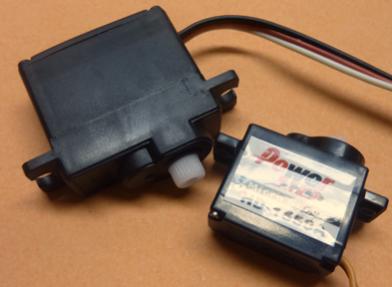

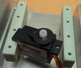

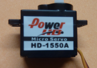

                  supplied servos in the electronics kit for the 3.5" SD
                  This is the micro servo supplied with the 3.5" SD electronics kit...Click image for larger version
Name:	servo supplied with 3-5 inch electronics kit 002.jpg
                  This is the mounting system (I think) on the 3.5" SD...Click image for larger version
Name:	servo supplied with 3-5 inch electronics kit 001.jpg
                  Either the wrong servo was supplied or I'm missing something.

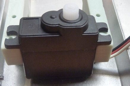

                  I have some of these older bigger style servos (on the left) in my supplies...Click image for larger version
Name:	servo supplied with 3-5 inch electronics kit 003.jpg
                  The older bigger servo seems to fit nicely in the mounting brackets...Click image for larger version
Name:	servo supplied with 3-5 inch electronics kit 004.jpg
                  Is this what you had in mind?
                  Dan

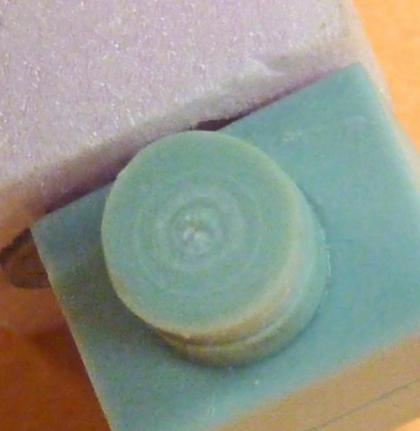

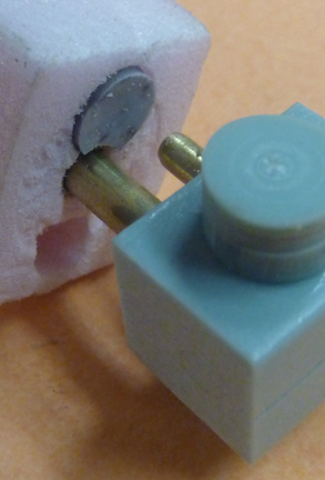

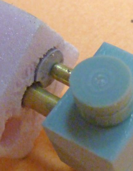

                    snorkel theory
                    When the snorkel is closed - sub submerged - how does the snorkel head appear?
                    Does it look like this...Click image for larger version
Name:	snorkel head 001.jpg
ID:	76844 and then closed like this...Click image for larger version
Name:	snorkel head 002.jpg

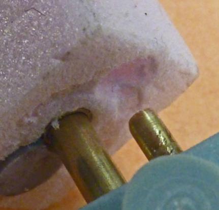

                    does it look like this...Click image for larger version
Name:	snorkel head 003.jpg
ID:	76846 and closed like this...Click image for larger version
Name:	snorkel head 004.jpg
                    I could make a case for either one but you probably had one of them in mind when designing this system.
                    Or, am I totally wrong on the whole concept?
                    Dan
                      • 1660
                      Dan,
                      The first two pictures show how it's done right, this way the brass inlet tube will be sealed by the rubber, which is glued on the float, never ever use the method shown on the last two pictures, unless you like to swim and dive for your sub.

                            Dearest Olympians,
                            Thank you both for replying to my little query. I suspected that the right way was the first two pix but with "He Who Must Not Be Blamed" it's always best to ask.
                            So I take it that I should use my older servos as well and that supplying me with smaller servos that don't fit the mounting brackets (see post #9) was just a test to see if I was paying attention.
                            Dan (serf 4th class)
