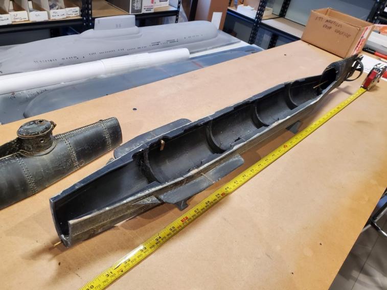

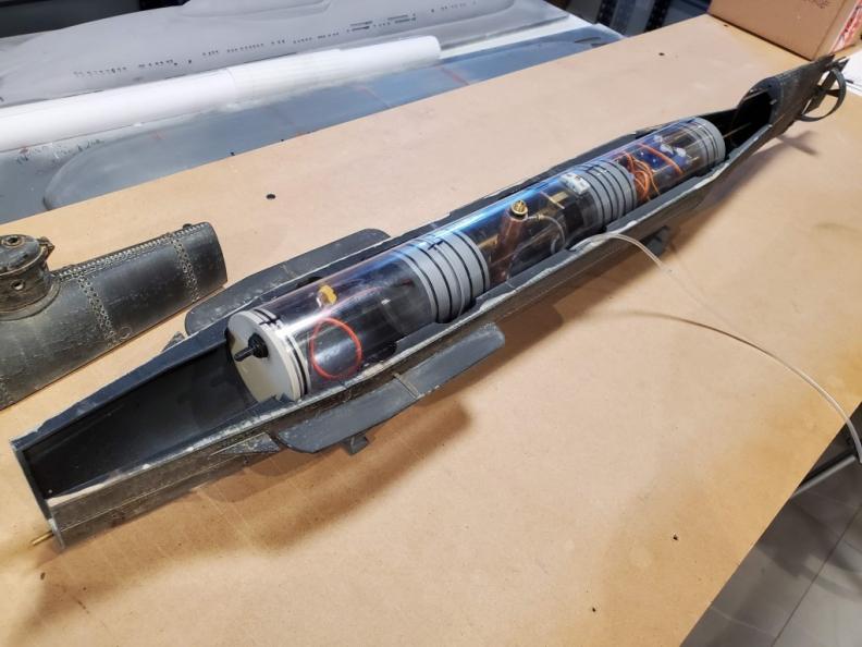

    These 3D files allow you to build the entire hull of this historic craft, including her propeller. The builder will need to source the spars and rigging in order to complete the model fully. Internal bracing is set up to accept a 2.5" diameter watertight cylinder.

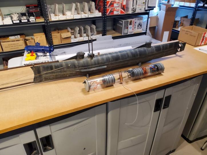

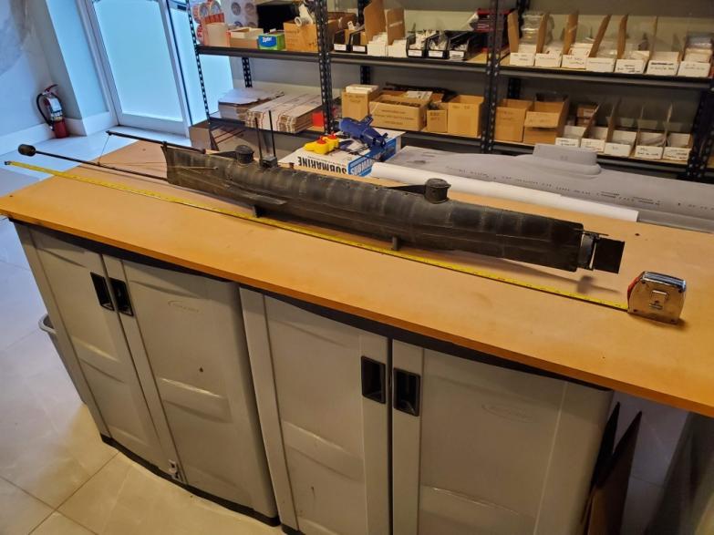

    Very cool looking sub, how does it perform?
    • SubDude
      • 825

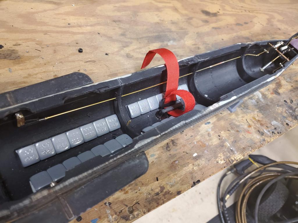

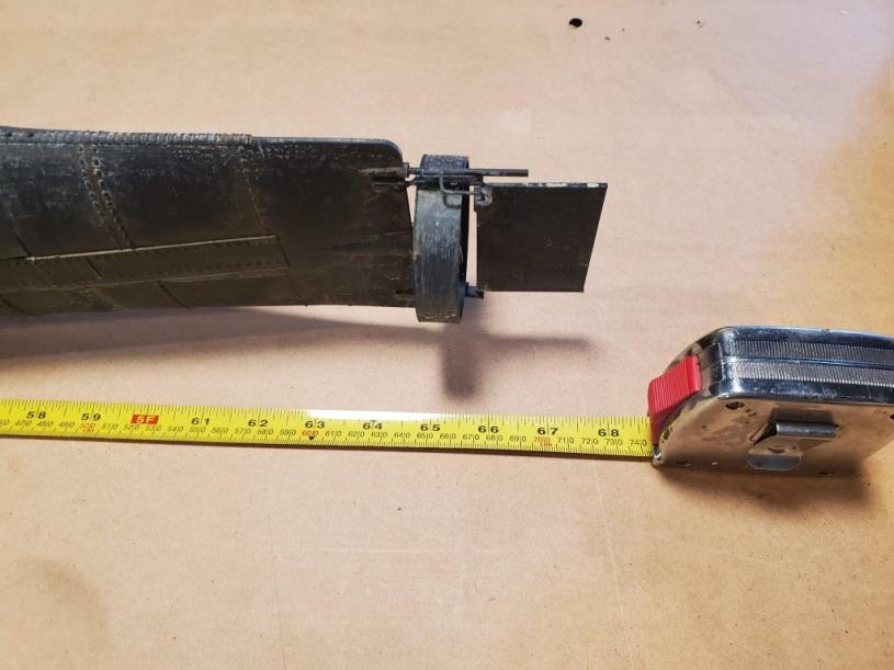

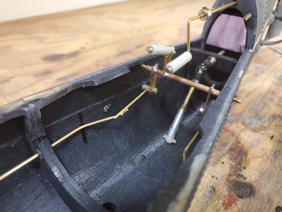

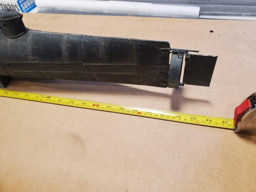

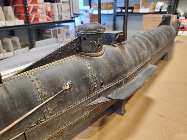

      Do you have a plan for how you are going to control the dive planes?

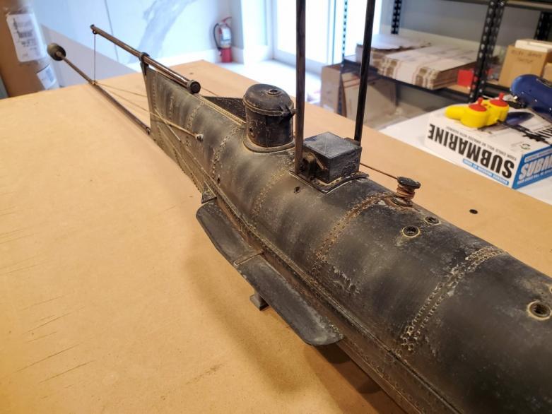

        Cory, she is undergoing trimming now. It would have been done already except for this stupid storm hanging around Florida. It's wreaking havoc with rain and wind. I don't anticipate it to be a screamer, and I don't anticipate it being a real pussycat to operate. One set of planes situated near the center won't offer any pitch control, so it will all be down to miraculous trimming. Hoping to have it wet by this weekend if things go well.
        Steve, the cylinder and linkages are all completed. I ran a simple set of twin rods from the planes down the boat and to the rear output of the cylinder.
