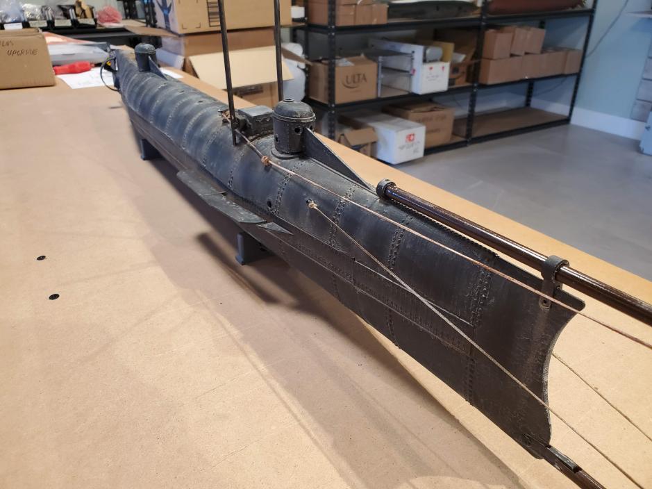

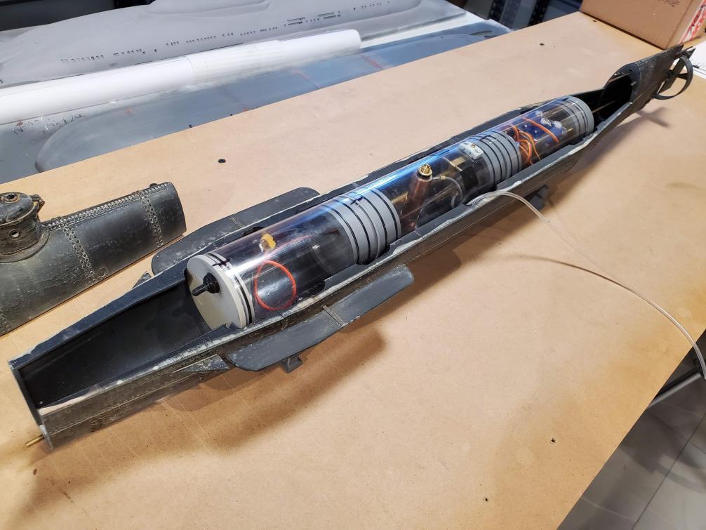

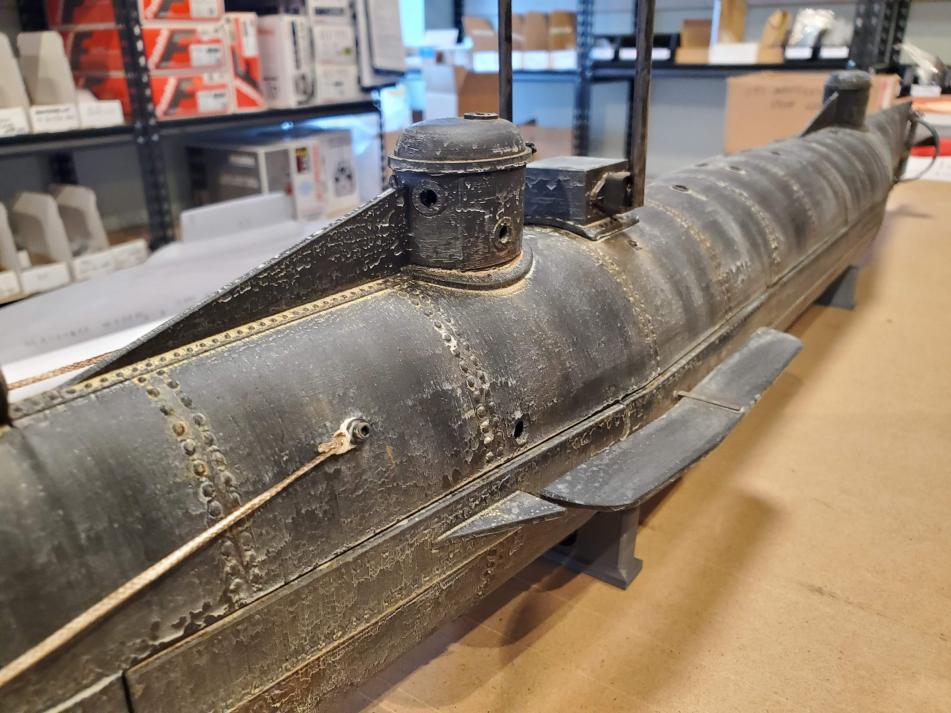

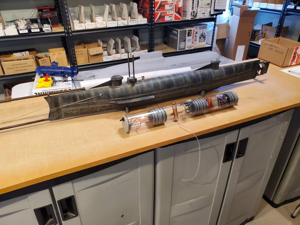

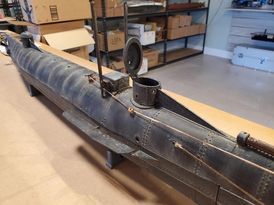

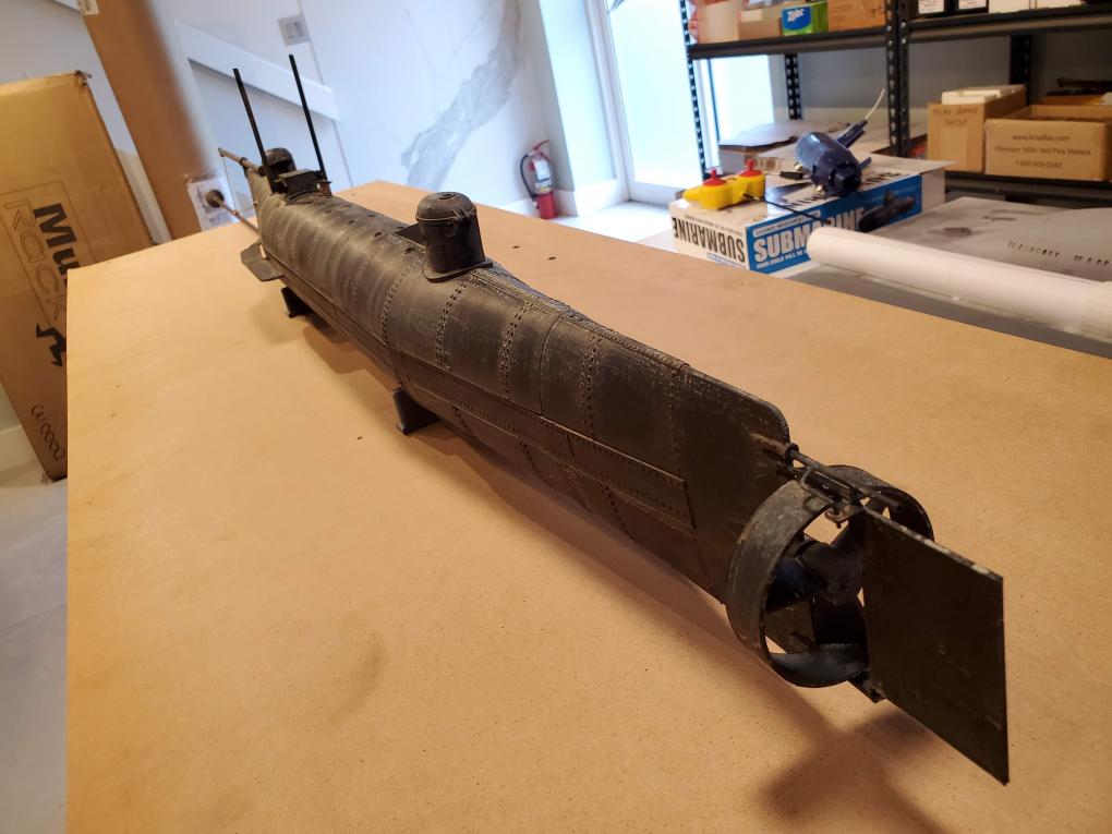

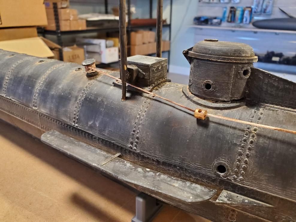

    I'll be creating a file overview and build video by early next week. In the meantime, here are the pics and vital stats!:
    1/12 scale HL Hunley, optimized for conversion to RC operation. Great as a functional model or a static display!

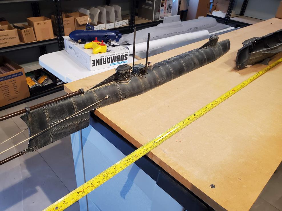

    110cm long with a 12cm beam (about 43" long and 4.3" wide without the torpedo spars). Length with the spar is right at 68" or so.
    This prototype is being built as a fully functional model using a 2.5" MSD. The build will also feature 2.4GHz control (Hunley didn't dive below periscope depth) and SNORT ballast. The radio antenna and the SNORT intake will be hidden in the snorkel tube intakes.
    Really, all that's left prior to trimming is final cylinder testing. I'm really happy with how the hull turned out. It's a beautiful and unique model. I'm anxious to see how it performs in the water.
