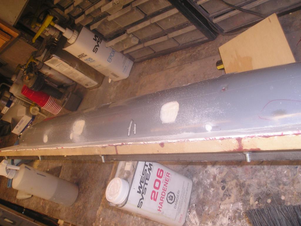

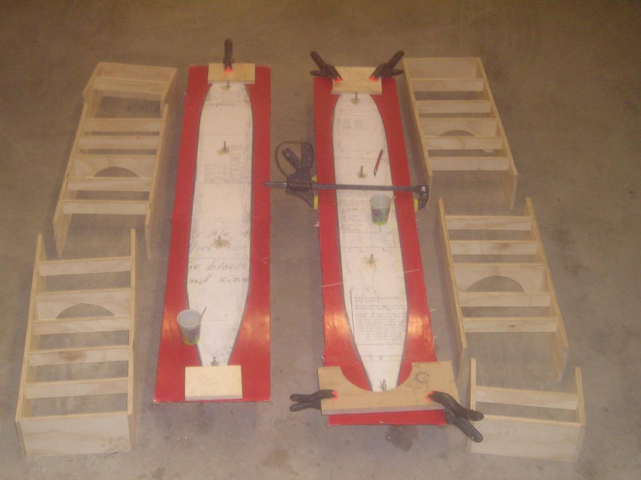

                  Ughhh...I was close at the beginning of the week...then I de-molded the hull and found that we have a problem(s) Houston. First off, the rubber wasn't curing properly so I made an oven (50 degrees C) to help cure it. The rubber cured, but apparently something else cured and expanded inside my plug moulds giving me large expanded blisters on their sides of which transfered to the rubber. Also, the excessive heat softened the exterior so that the fiberglass pattern sort of printed through. Then trying to get the bottom hull half out of the mold, the WAA's were partially damaged. Also had delamination on some of the cured rubber layers. Not a good week. One extremely good thing is that all the areas with detailing were still miraculously ok! Anyhow, now that I have finished feeling sorry for myself I have commenced on repairing and refinishing the plugs and I have a strategy in place to get everything corrected and am back on track. I feel terrible about this and I sincerely apologize to everyone who has been patiently waiting for this project to be finished.

                    Within this forum I think it safe to say that only Bassplayer1, Rick and Me truly appreciated how devastating this 'incident' is, Joel. We three (and I'm sure there are other 'experts' reading this who are nodding in agreement, as they too know the enormity of this problem) have been there. Not that you were glib or anything, Joel, with your above post, but what you're facing is a very involved and expensive fix to a set of hybrid tools.
                    What a ****er!
                    Get out of the shop, take a break, and come back to it only after your blood drops below the boiling point and a smile once again crosses your lips.
