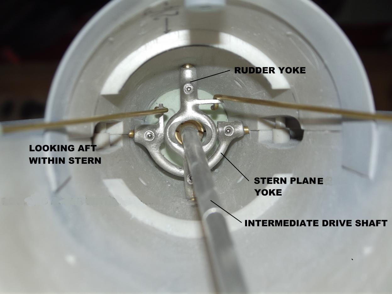

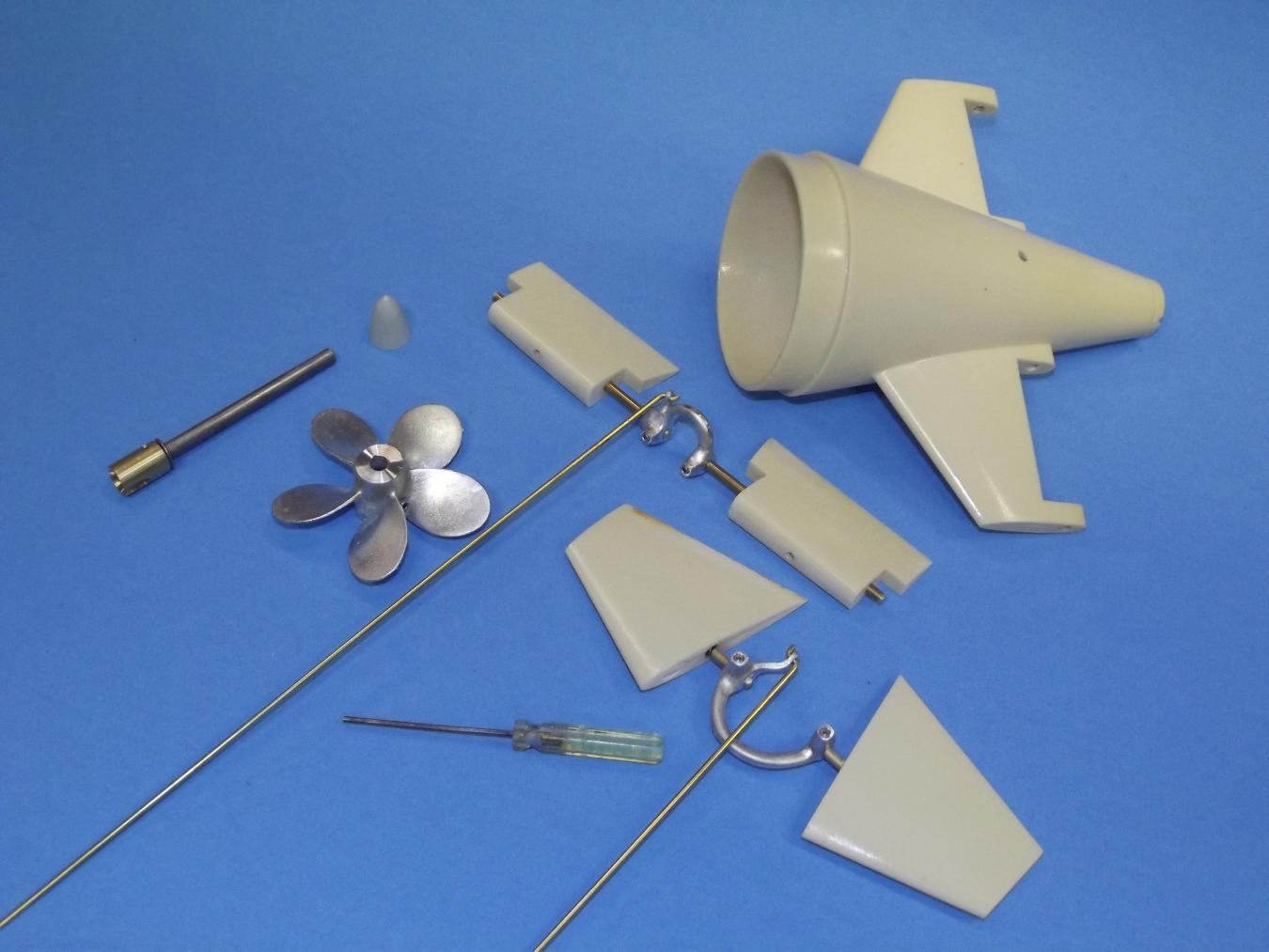

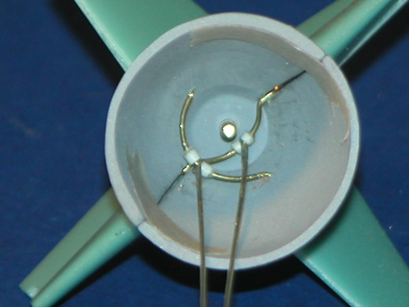

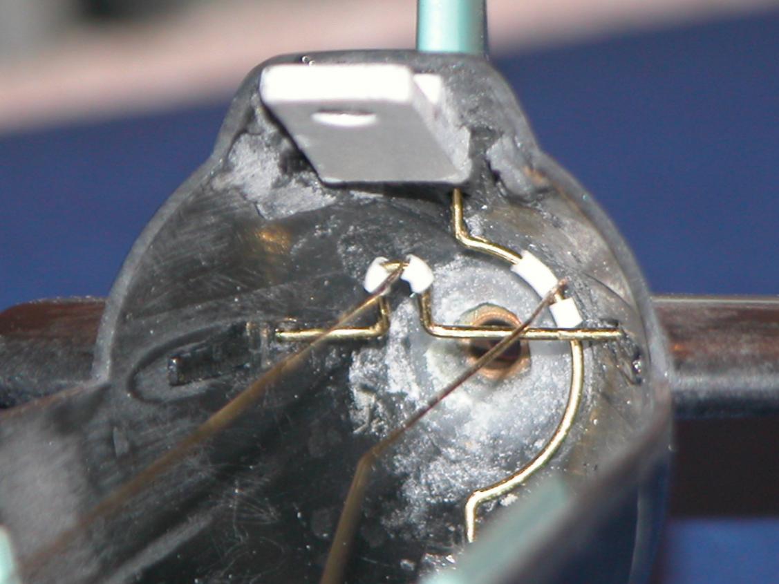

            Not much work these day because I'm stuck with a problem : >:-o
            - the distance between the steering rudders axle and depth rudders axle is very small and do not know how to manufacture coupling rudders ....
            - because of that I can't get a left / right rudders movement necessary for the turn submarine and no movement up / down for dive planes ,
            The distance I took it form the drawing and scale distances table , but doesn't seems to be right . >>:-(
            May be You can give me some advices .
            MARIUS

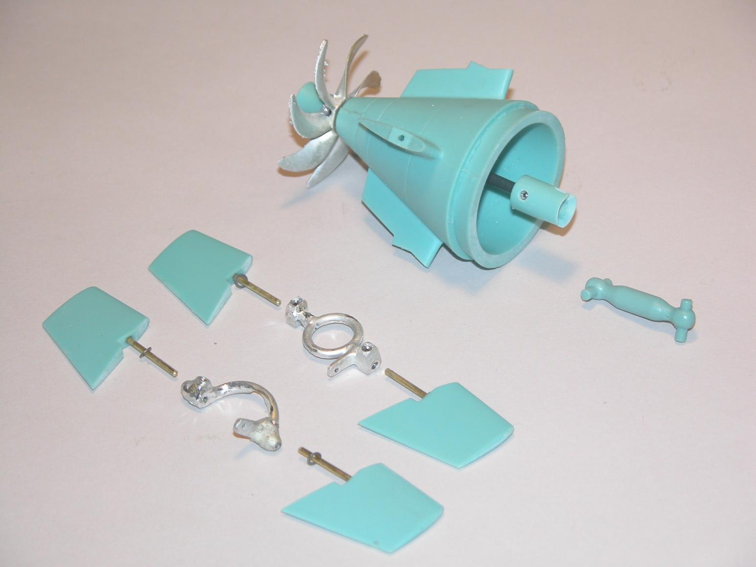

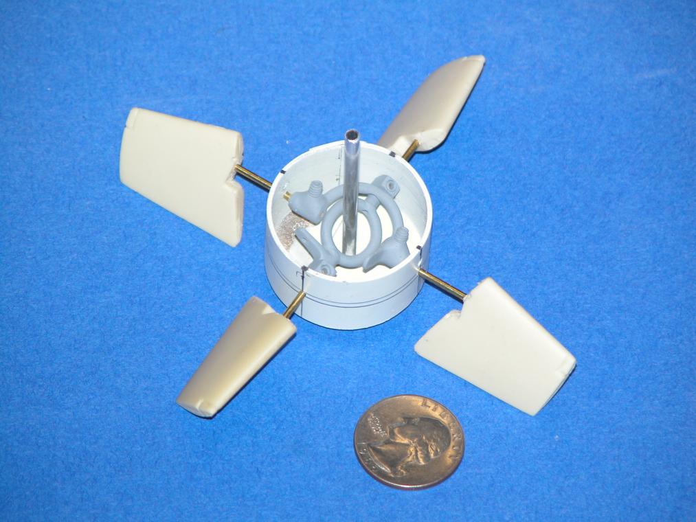

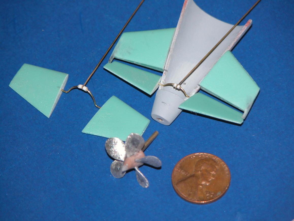

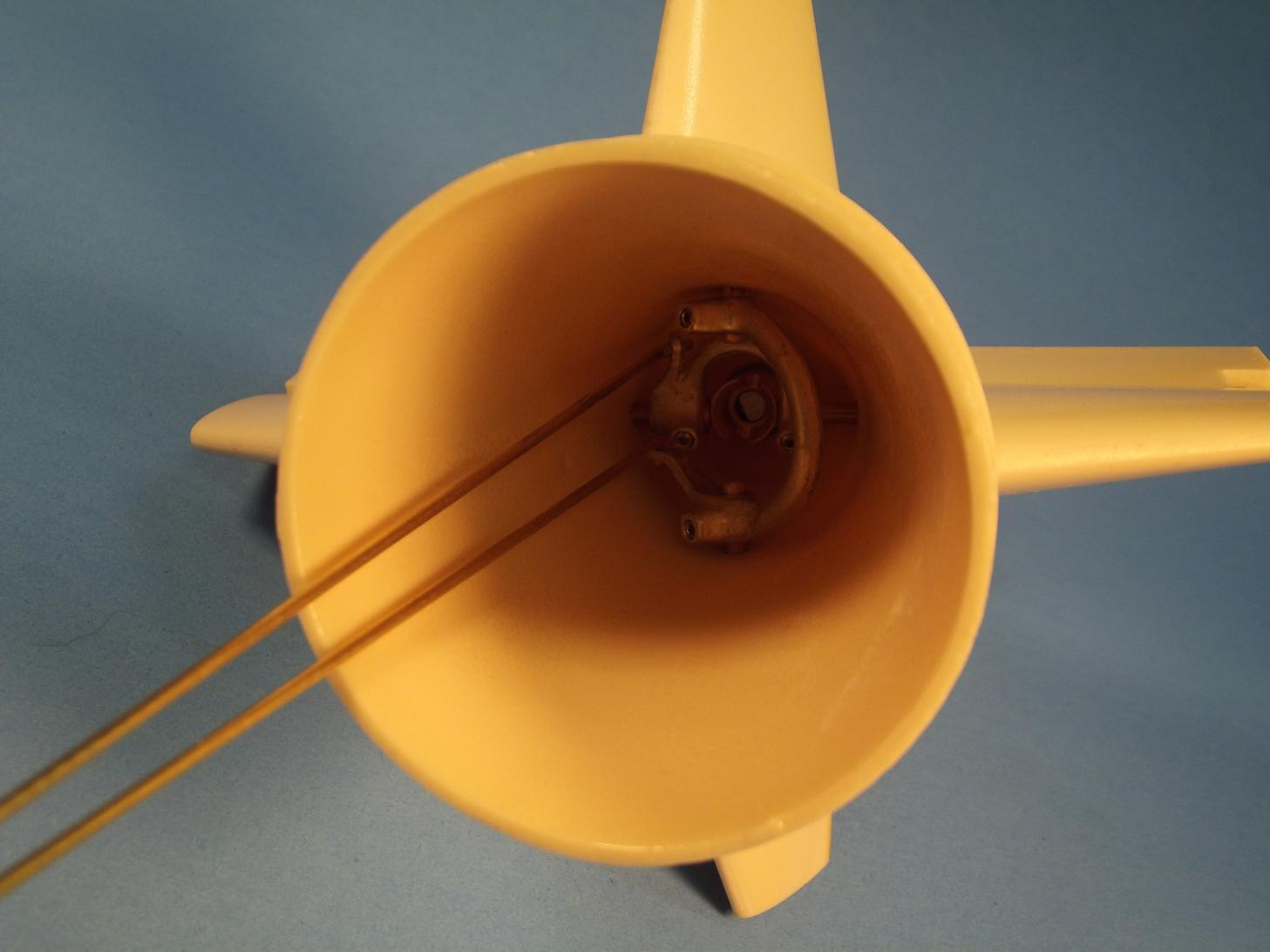

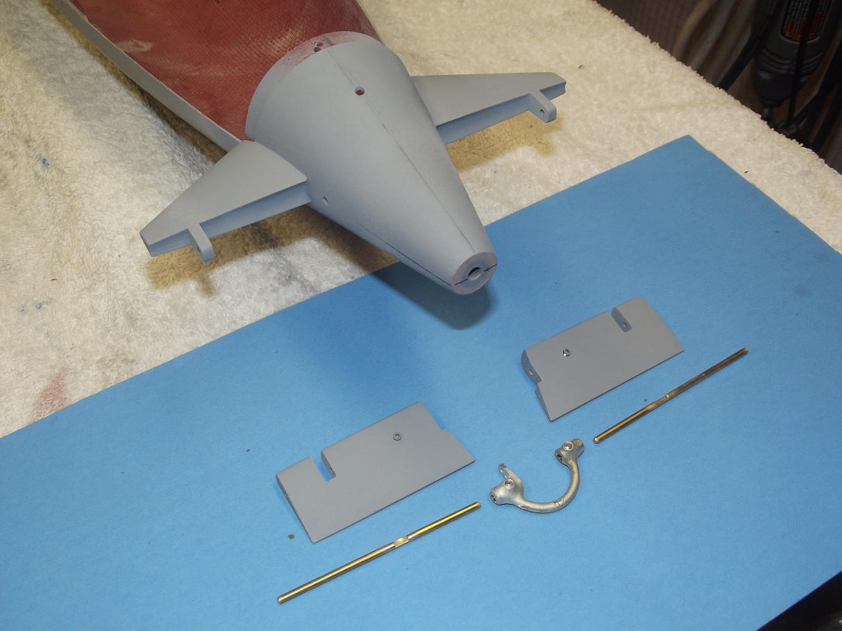

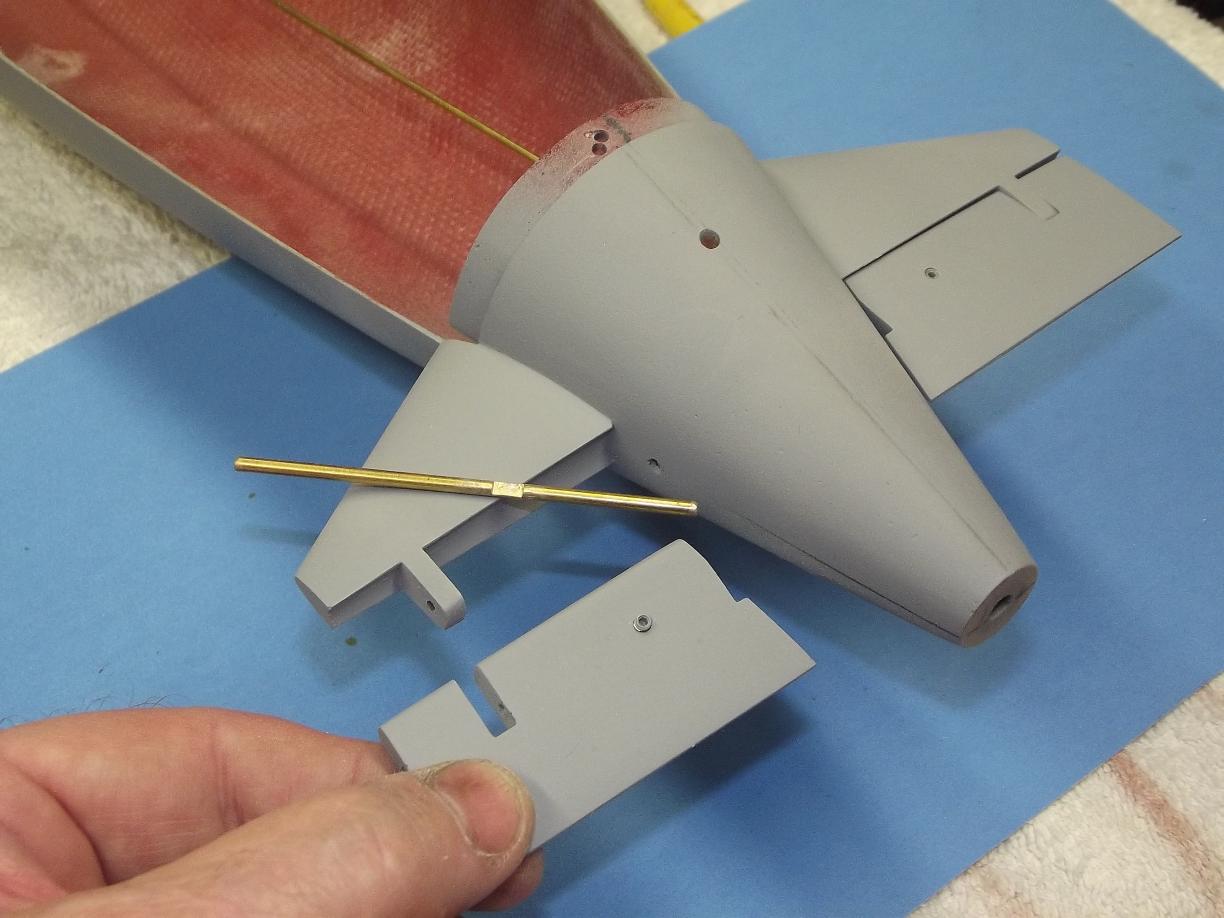

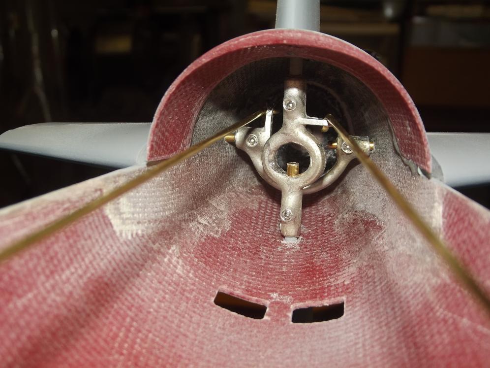

                    • 14014
                    Originally posted by Peter W
                    Marius pictures would help, but some where you will find info on Mr M's D&E 1/96 Skipjack kit/build. I would imagine that he had these problems and he definitely will have overcome them, a 1/96 skipjack is a tiny beast compared to a 1/81 LA.
                    Peter
                    BEHOLD!! (crack of thunder)

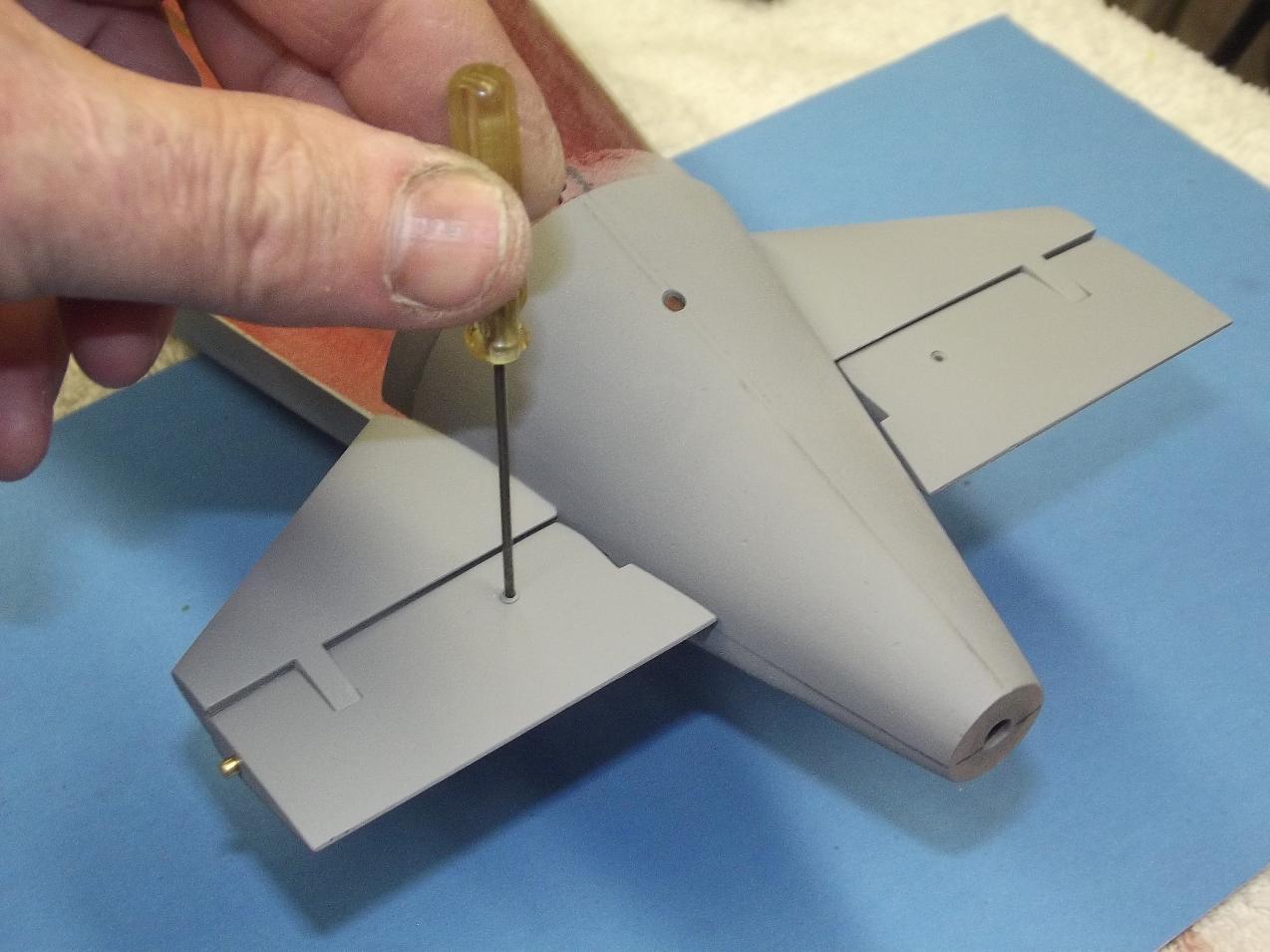

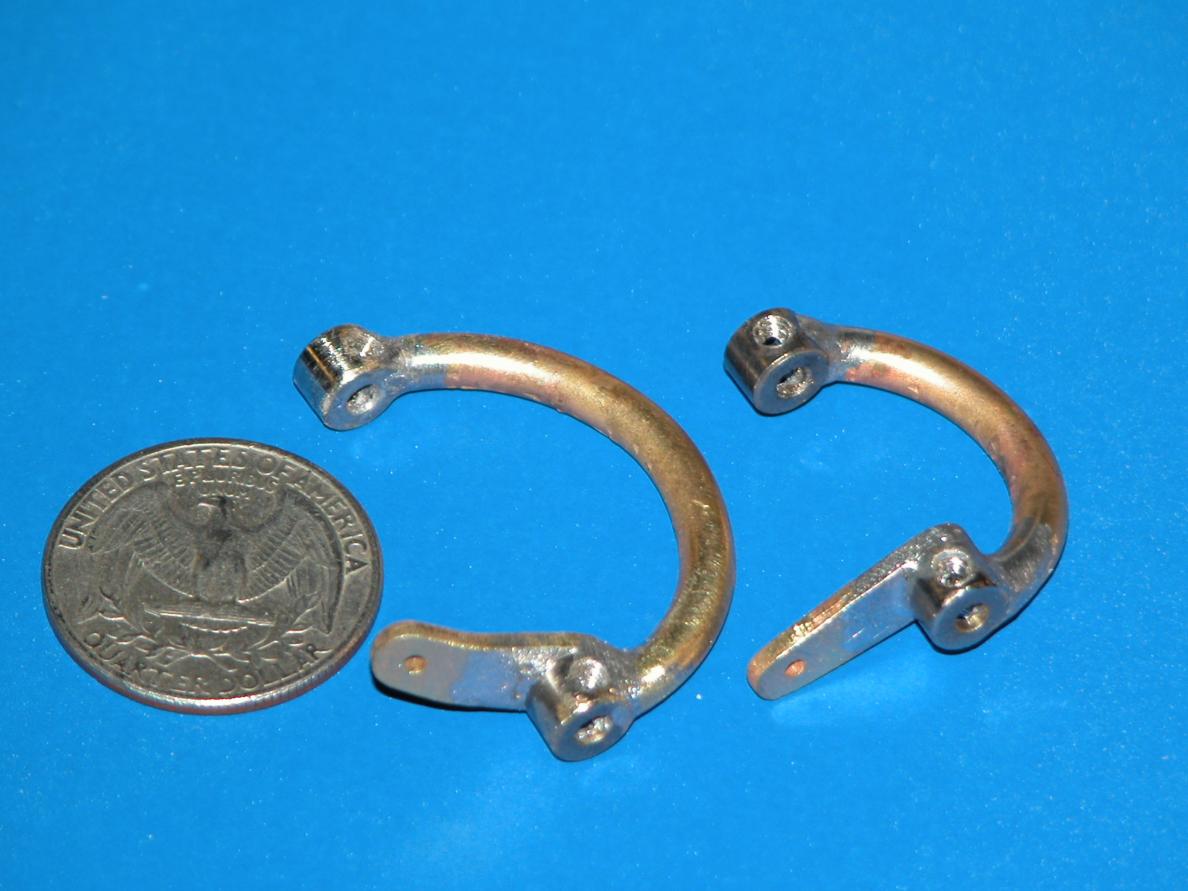

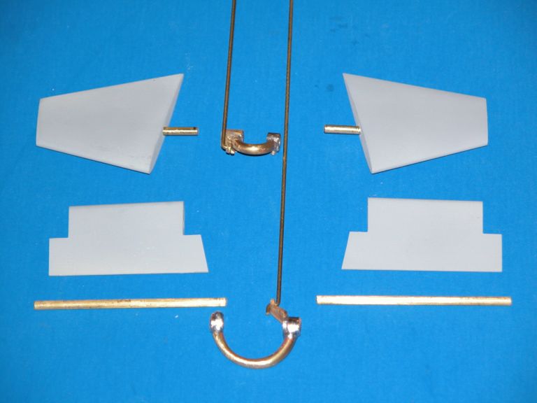

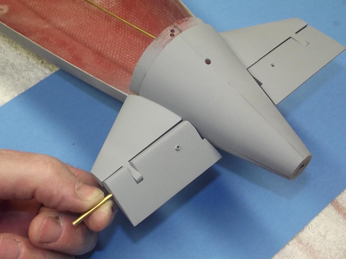

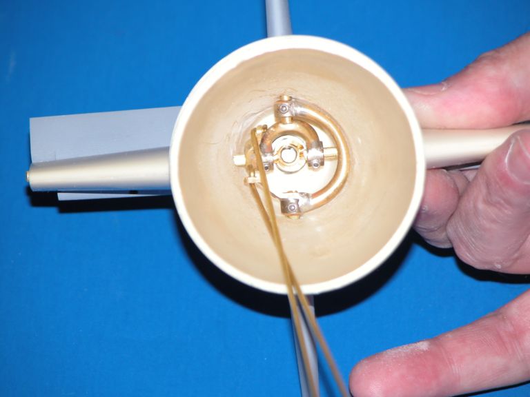

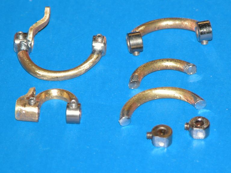

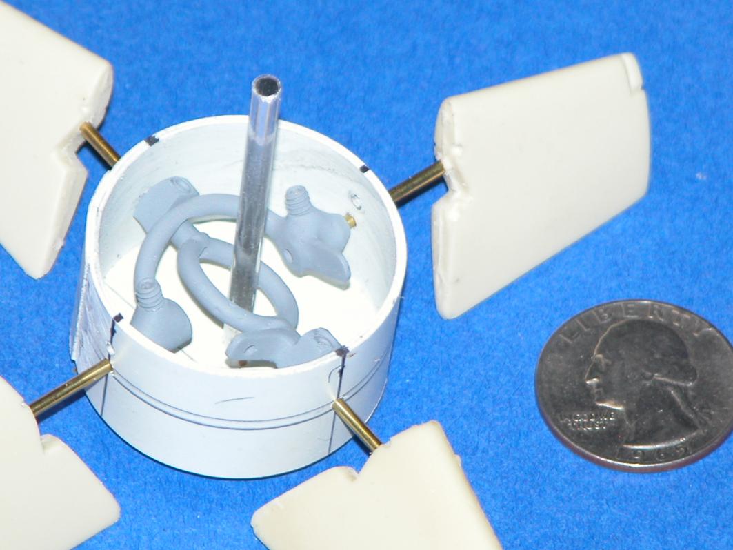

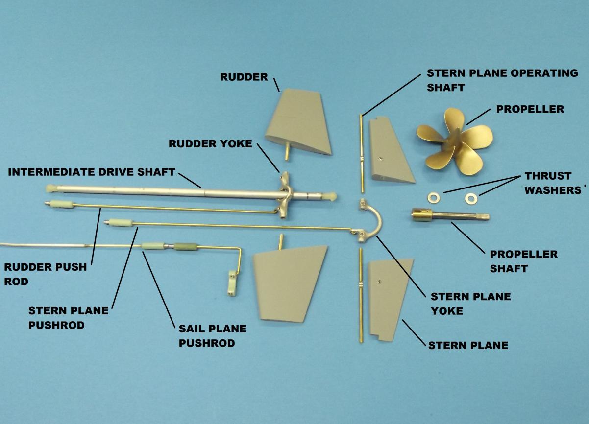

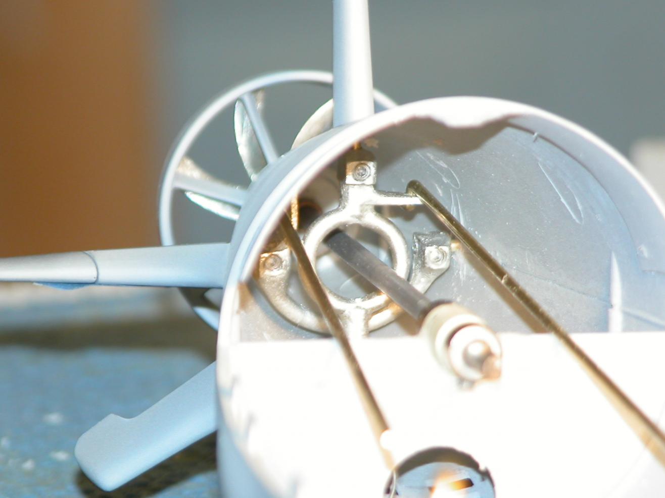

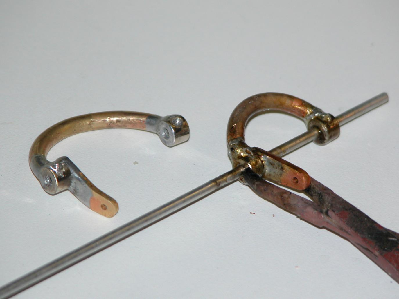

                      • 14014
                      ... and this is how you make 'em:
ID:	98098 Click image for larger version

                          • 14014
                          Originally posted by profesorul
                          Sorry , I forget the pictures :
                          MARIUS
                          Install the stern plane operating shafts the way I showed and you can get away with the tight bushings.

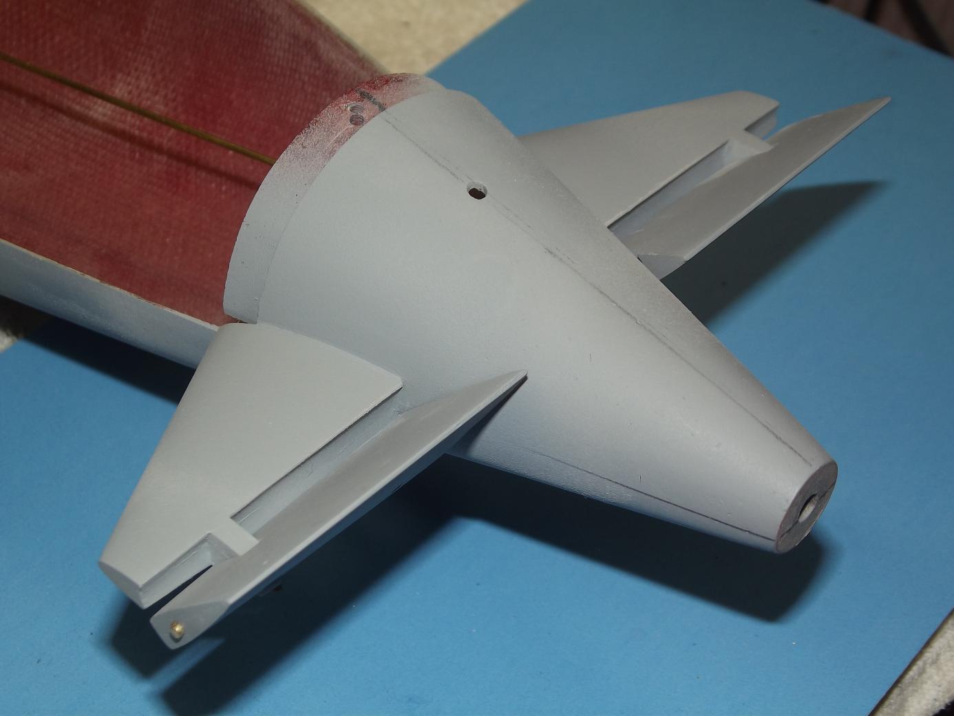

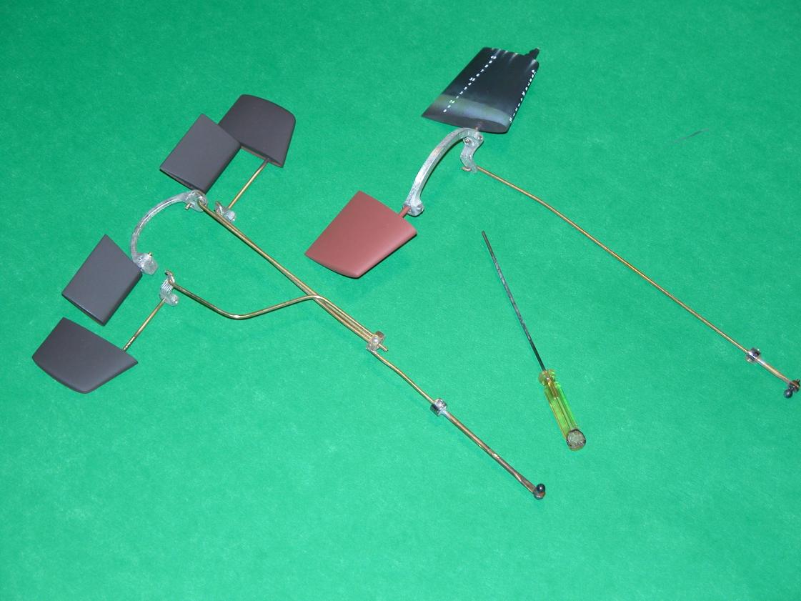

                              HI there ,
                              These waht came up for Dive Planes :
                              MARIUS
                              • profesorul
                                • Mar 2010
                                • 63
                                Some small update for it :
                                At the end is going to be painted only with primer and the some grese
                                MARIUS
