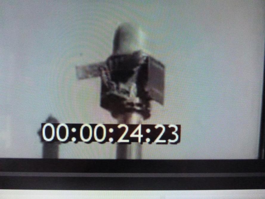

    Pretty darn close. Looks like the body of the sensor below the radome narrows in the centre and fears at the top and bottom. The side plate antennas are sitting just outside the base of the dome and the curved mesh antenna's horn is mounted very low on the body of the sensor. That forward mast is a killer as well. Until I saw the recent Polish photograph I thought that it looked elongated but its actually more disc like. And the biggest gotcha of all is the (navigator's)periscope that I thought was a satellite antenna! Live and learn.
      Geeeezzzeee.... I hate auto correct!!! Perhaps the body could flare at the top and bottom, instead of fearing!!!

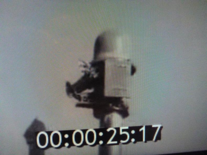

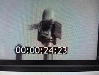

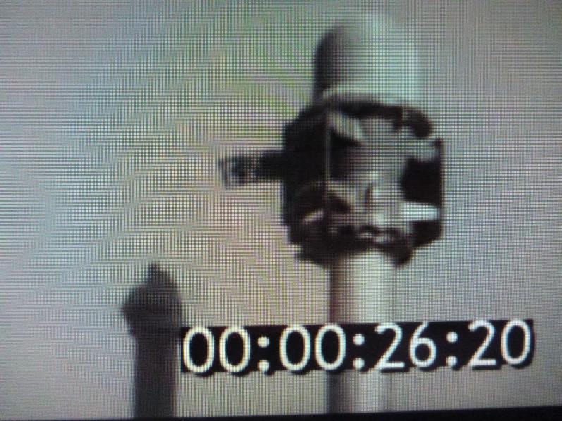

            Found this early this morning:Click image for larger version

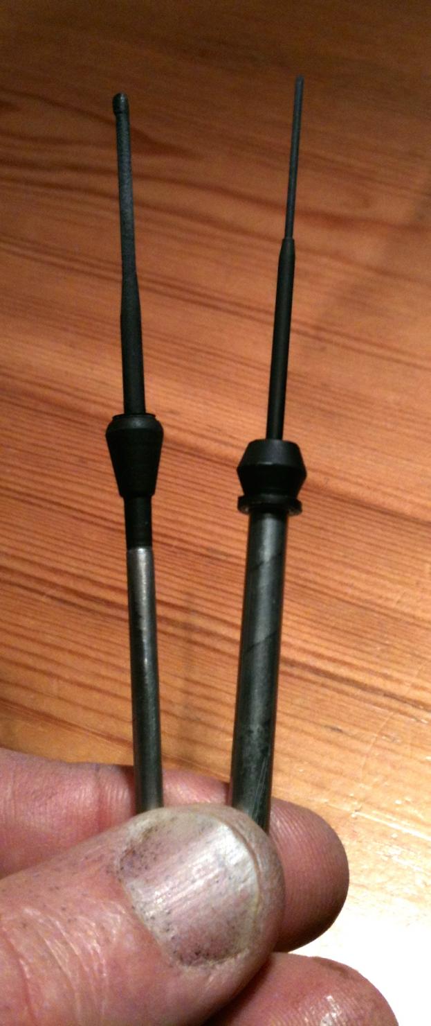

              Todays little achievement. Old and new. Click image for larger version

                HI Scott ,
                Excelent job SIR .
                Those Masts are made on lathe ? / what material did You used ? .....or You cast them ?.
                MARIUS
                P.S . that light from antenna send to PETER cames from an SMD LED ?. ....or what ?.
                If Yes , how the H*** did You do it ?! .

                  Hi Marius,
                  You can purchase .8mm LEDs from these guys
                  12volt LED lights for modeling project, top-quality, affordable. Elevate your models with radiant illumination. Ideal for various DC-powered hobby applications.

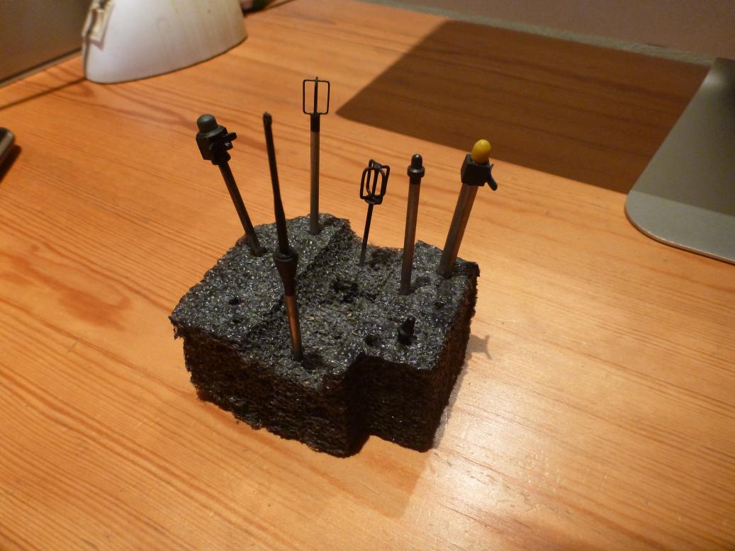

                  I am very lucky to have a small lathe and it does very well with most things. There is a grave yard of not quite perfect masts, however.

                    The shafts are stainless steel. The other bits are sandwiched polyurethane, turned down on a lathe. The light that Peter has fitted to his Akula is a .8mm LED sitting on a 1.5 mm aluminium shaft with a clear plastic top which I drilled out and turned down to fit the shaft. It needs a black top and base ring at present.

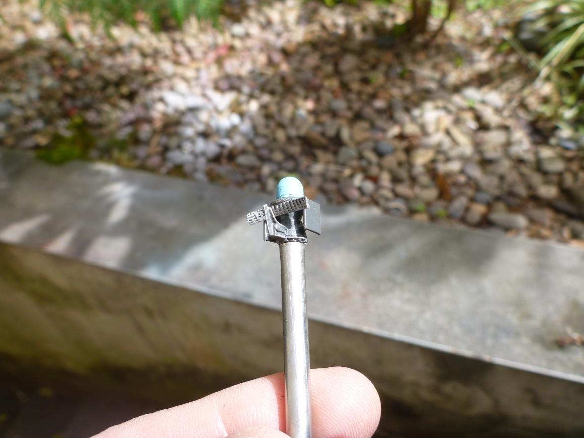

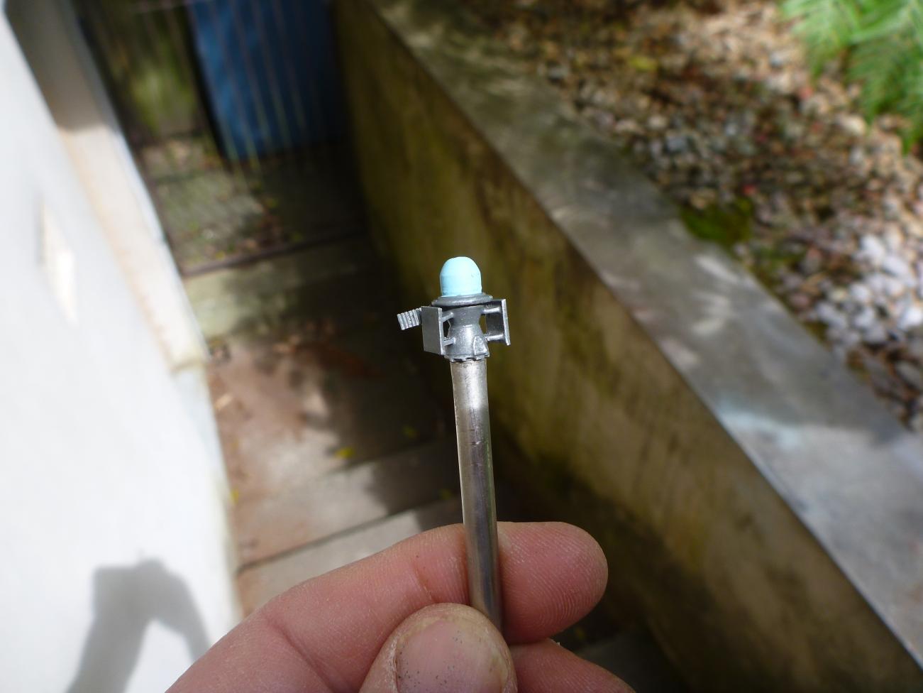

                        This is the final iteration of the dreaded MRP-23. Its not perfect but its the best that I can do.
ID:	98033Click image for larger version
                        And looking at the blown up photographs I have just realised that I put the antenna dish on backwards! Bugger.
                          That is pretty stinking awesome!
                          • Peter W
                            • May 2011
                            • 511
                            Looks excellent ! but .....you need a pic of it in the sub!
                            Peter
                              Still working on the other antennas!!
