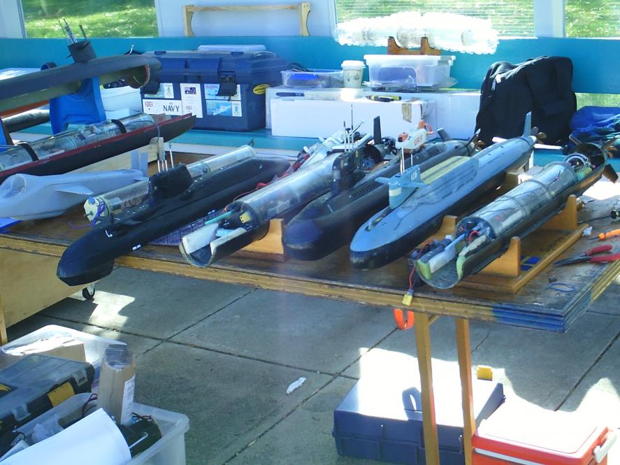

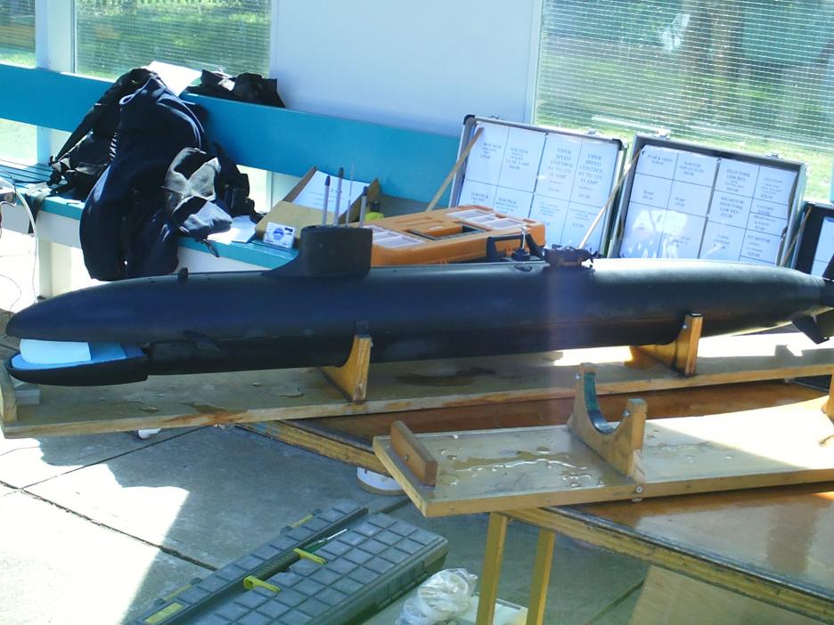

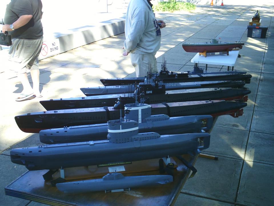

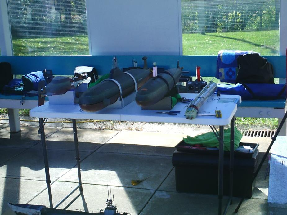

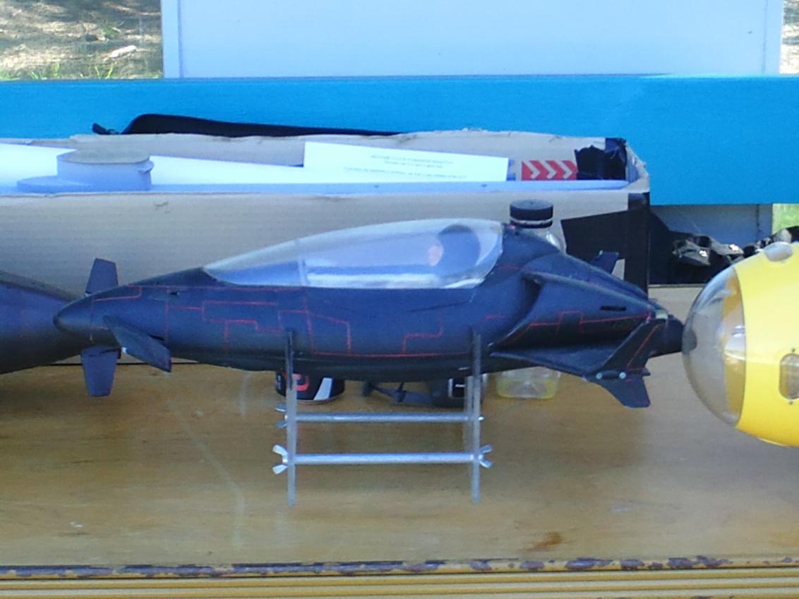

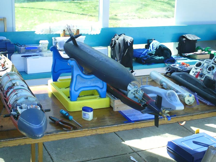

      I didn't get to many videos or pictures to offer here as I got a little carried away running my boats but what I did take are here...
ID:	91275Click image for larger version
ID:	91276Click image for larger version
ID:	91277Click image for larger version
ID:	91279Click image for larger version
      Jim's Seawolf as result of kissing the wall a little to passionatelyClick image for larger version
      There were three Skipjacks about four type XXIII's a couple of TT Nepunes, many variants of German u-boats from kits to scratch builds. Dr Pat brought along his big U-boat and there was an Engle 212. There were some Russian nukes and British one as well. Which at times made for a rather crowded pool!!
