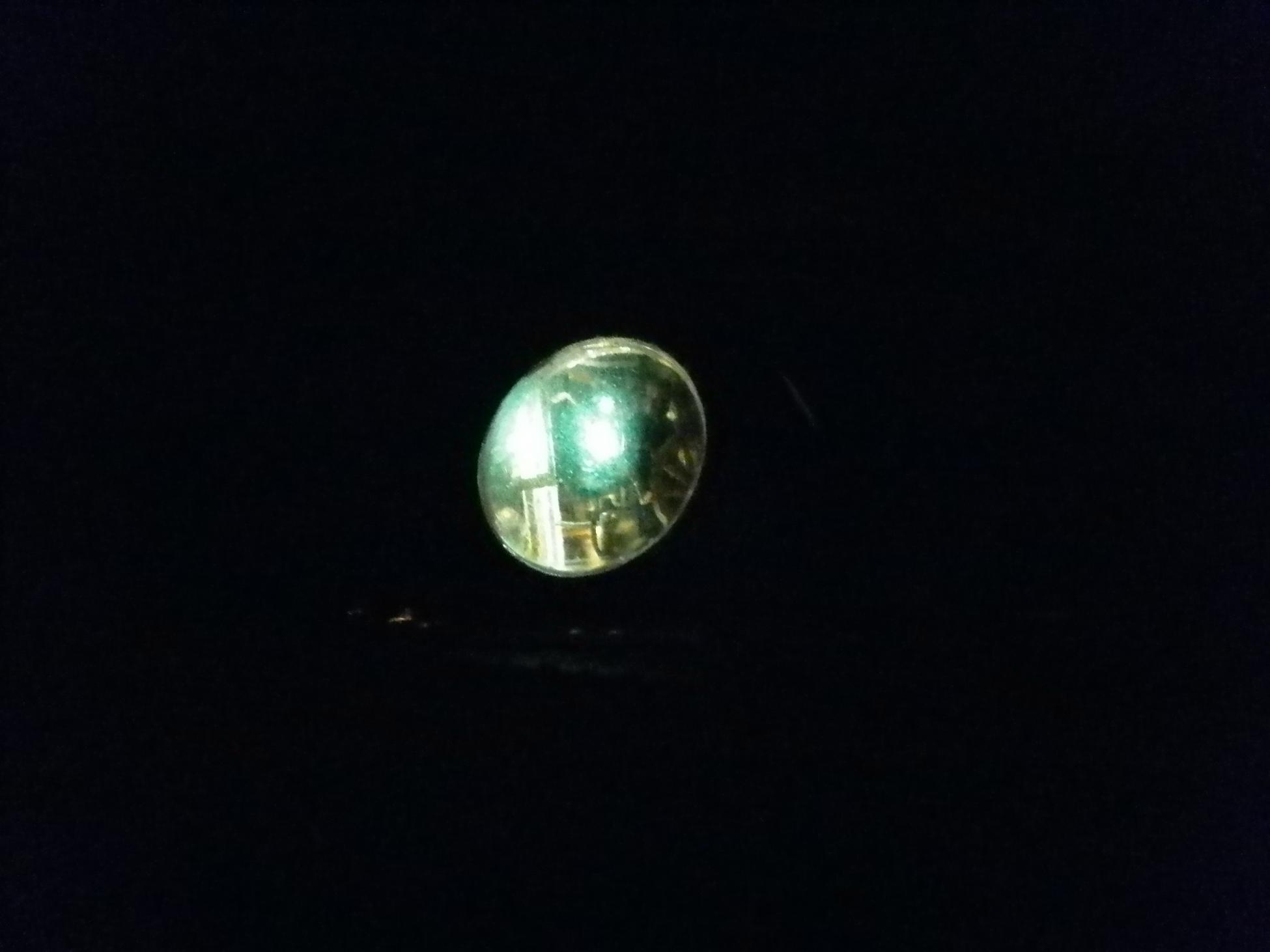

    I tried a couple of different lighting ideas for the wheel house gauges with various green leds
    but none gave me what I wanted or seemed to have the wrong luminescence or hue as above. In the film the dials all have a green glow around the edges so I glued the fibres with the pva and added the green wash letting it settle around the edges the result though not entirely accurate came out ok for me. Next on the to do list was lighting the alligator eyes. This was done with micro leds which I up to then had not used a lot but those that I had seemed to give me a better scale effect. Also I could recess them farther back again helping me, I hoped, with the scale effect and it did just that. Let me say that attacking the model with a dremel was from begining to end a heart starter.

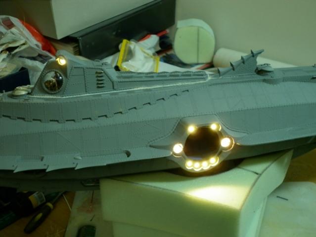

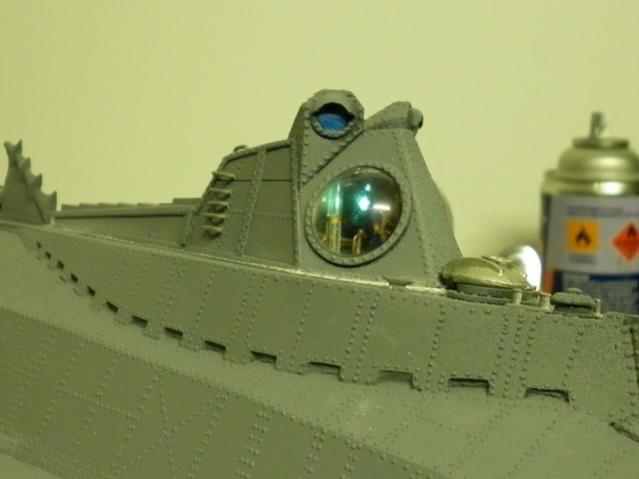

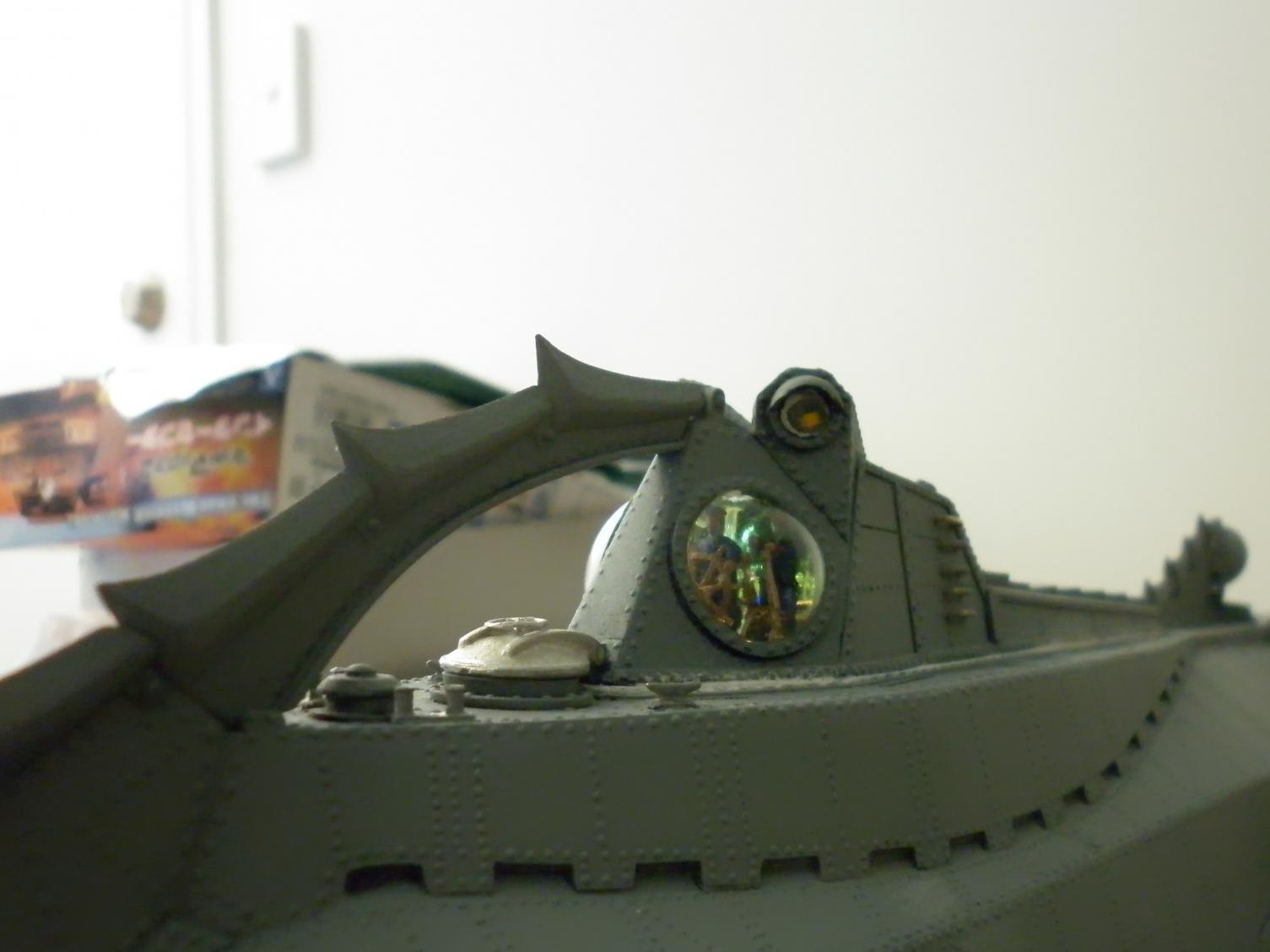

              So going back through my pictures and stuff I assembled the wheelhouse to the hull after I added the windows and alligator eyes light lenses all the lights were tested and fixed. With the windows I dipped them into some future floor polish and then sat them on some tooth picks resting on absorbent paper. All of this was then covered to help keep the dust off and left to dry overnight. I then glued them in place with a good quality pva glue and set it aside till the glue had fully cured. I used pva instead of ca because ca can some times send clear plastic brittle. It will fog the plastic too but the future will generally get rid of that but I am not sure what type of plastic these and the salon windows were vac-formed from I opted for the pva. One thing that was annoying to me was the rather large gap around the wheelhouse and where it sat on the hull... It was an easy fix with some styrene strips and filler but still annoying
              The next thing was adding the lights around the salon windows then wiring the remainder of the lights and motor for the propeller and making up a shaft from evergreen tubing. To keep down the sound of the motor I wrapped it in foam. I am pretty sure it is a 500 series motor rated for 12 volts. I actually lucked it with its running speed because the entire system runs off 9 volts the motors revolutions on the lower volts are pretty close to the spin as seen on the prop in the film when the sub is just cruising. What I forgot to do was add some suppressors to the motor as it plays havoc with the TV and DVD recorder when I switch on the prop BLUSHER For the lights around the salon windows the two large ones are 5mm leds that I ground back and the smaller ones are the micros. I dug around on my pc and found the link to where I got the lights fromhttp://www.modeltrainsoftware.com/

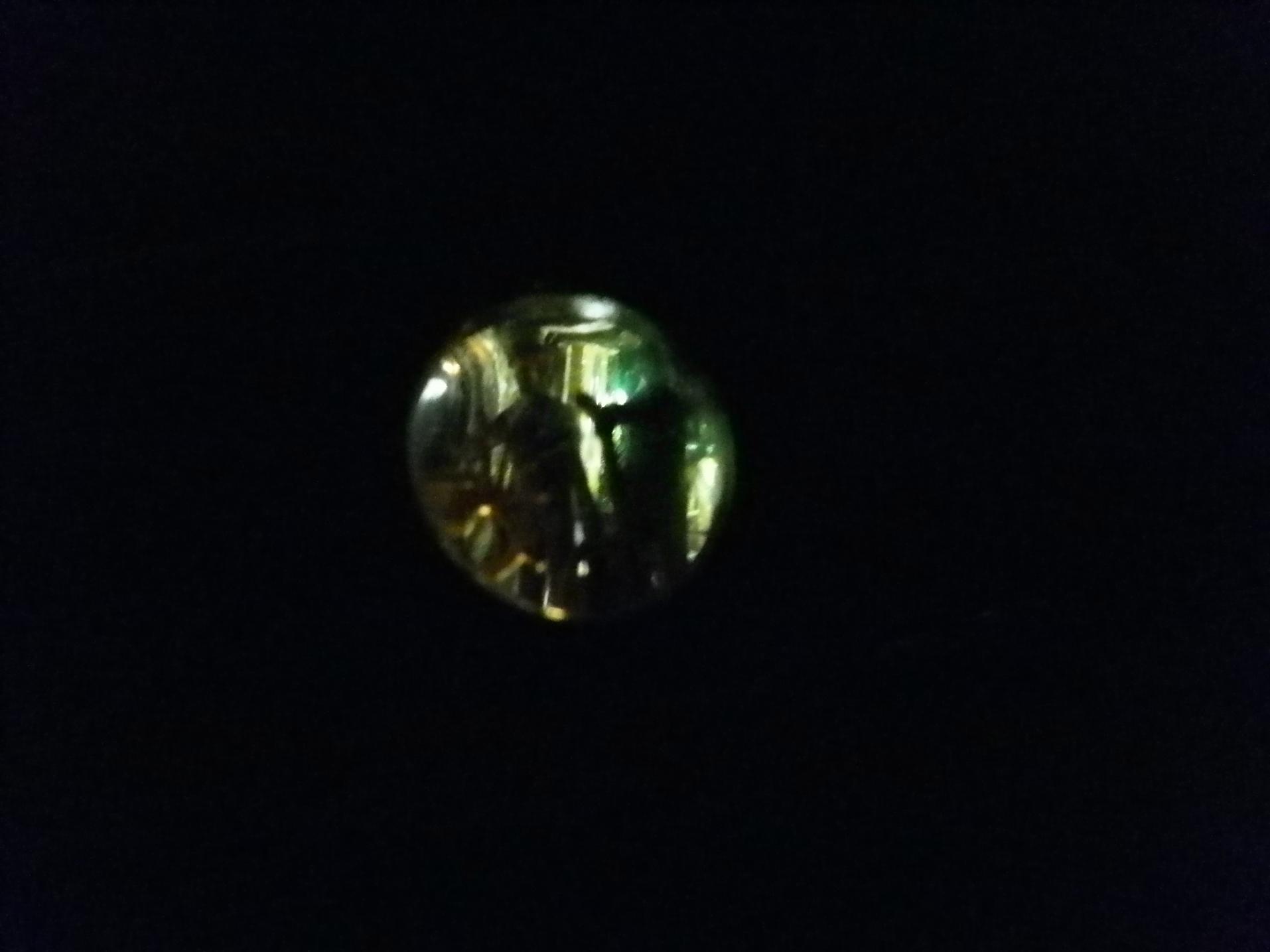

              Before I masked off all the lights I did yet more lighting test in different lighting conditions. I knew that once this was buttoned up there would be no fixing anything afterwards...

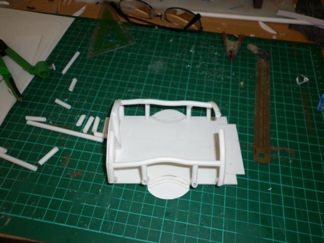

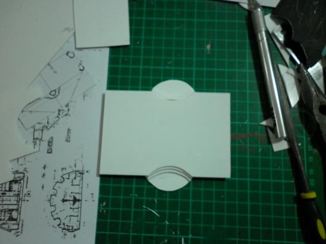

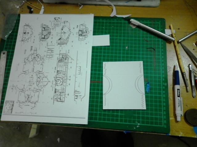

              With the exterior pretty much done it was on to the salon and a real test to match dreams and ability... By that stage most of the pieces I needed had arrived in the mail and I had cleaned up the copy of original blue prints I have on a disc. By cleaned up I mean I had to enhance and resharpen the scanned images so that I could work with them.

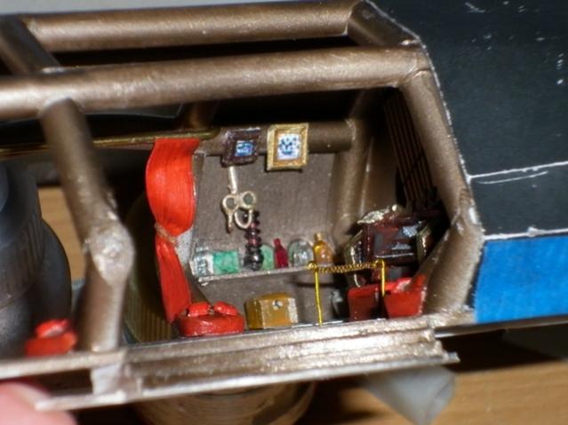

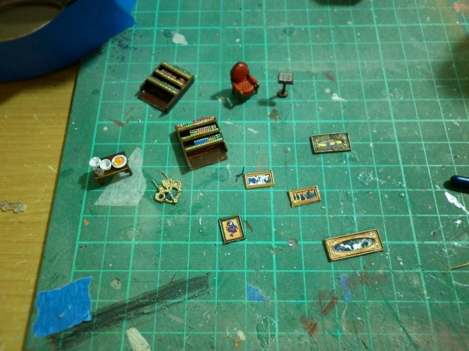

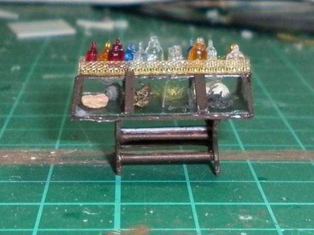

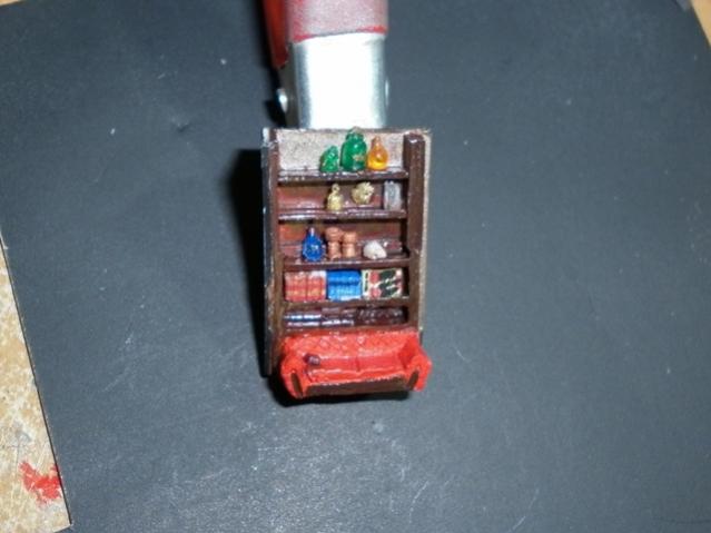

                For the salon fit out I again used HO scale items with some desks, chairs, picture frames, jars and bottles and settees for the curved window couches. All of these were in white metal so they were pretty easy to file and rebuild. Things made from scratch were the organ, tear drop couches, specimen table, the little fountain, some of the rows of books and shelves along with the couch under a bookcase. The little fountain suffered a 'DOH' accident and was rebuilt for the better as it happened. I also made various gauges that hung from the ceiling and on the work desk in front of the three aquariums

                The pictures, curtains and rugs are again HO stuff which I scanned and re-sized and things like the lamps are odds and sods from the bits box. The gold braided rope around the organ pit is very fine gold thread from a scrap booking craft supplier and the gold edging on the specimen table and book shelves is trimmed from craft ribbon and glued to thin clear acetate sheet.Looking at the dates the salon took around ten days and nights to complete to the finished result. Which included watching the film and taking snapshots to help out as well and I had to take some liberties with some things due to its scale and my abilities.

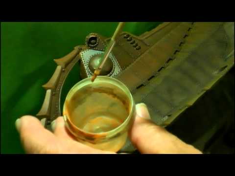

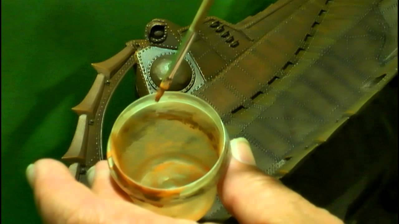

                    With the base finished came the slightly daunting task of painting it. I had seen on the web countless versions and paint jobs to depict the look. What I was trying to achieve is a look that mimicked the film and not based on what an ironclad would have actually looked like. I believe that the character of Nemo based on his scientific genius would have forged a metal that was based on iron but yet better. The eleven foot hero model is I believe made of bronze. But Nemos boat was not made of bronze nor was it Iron so that and the look of the film was my starting point. Here is the model on the stand and it sat there for a couple of days as I played withmy paint mixes
                    I used the cut out iris pieces as my experimental pieces for the subs colours. One of the test colours came out to green under a daylight light the other was to red/bronze not grey/black enough for me.
                    After a couple of nights from memory I finally had a batch of base colour that differed from the stand enough for me to be happy with so I worked on the skiff.
                    Satisfied with that I moved on the the model proper... To begin with was the black base over the grey after I had masked off all the various lights windows etc. Then the first of the other base colours followed by the dry brushing and weathering.
                    This is the wash applied over the primary base colour
                    I decided as a bit of a lark to video the painting process and post it on youtube. Looking back I am glad I did!!

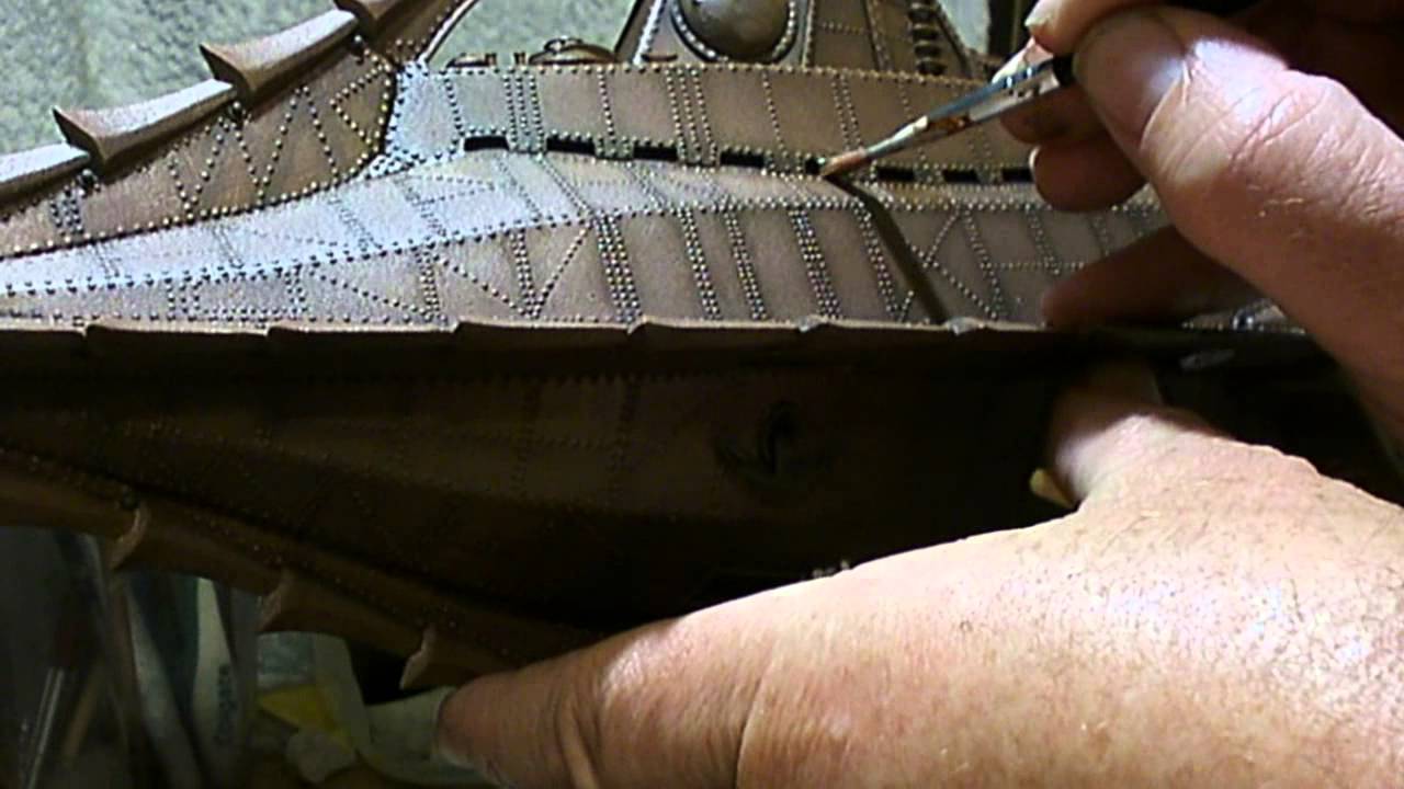

                      Above I used the word "mimiked" in regards to how I wanted the sub to look in hindsight I should have said paid homage...
                      Anyway the next clip is about how I dry brushed the model. The term dry brushing as we know is a technique but it is a technique that can be done to a models death if it's not practiced as a skill. I remember many years back a hobby shop owner belittled one of my gaming pieces for being over dry brushed. I pointed out it was an old reptilian hero meant to hundreds of years old and so it should look that way. Yet he was still arrogant and dismissive about my work. The last laugh was on him though when it won a top award and a regional comp and expo... David talks a lot about using a colour wheel and I agree that it can be invaluable and if your not good with colours then you should have one. But for me I work with colours as part of my job so I go a bit further than tones as we often go into shades and depths. There are days I eye match a fair bit from decorative paints to industrial two packs so as a result I don't have one at home just the fortunate skills that came from starting with the wheels basic use. Don't mean I haven't screwed up thoughScuba Diving

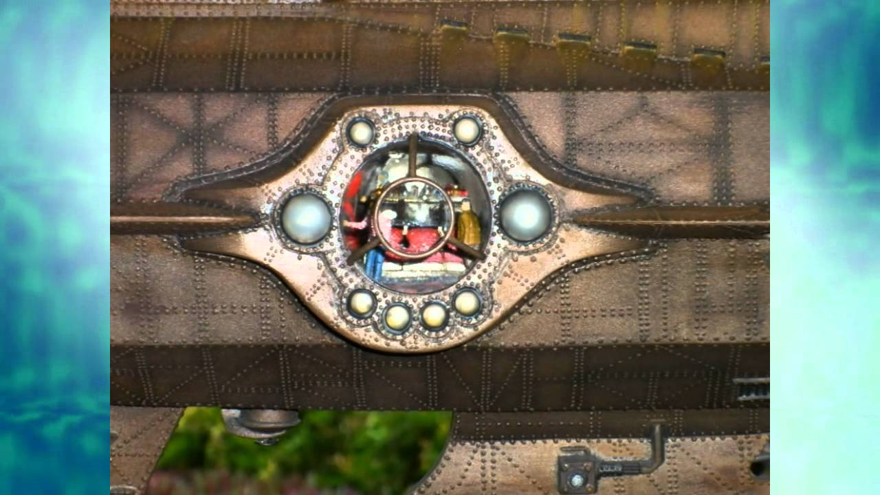

                        These videos I did were on the final weathering stages of the model and the last is of it the completed for display.

                            And finally a small video of the completed model. And yes I know that I spelt propeller incorrectly... BLUSHER
