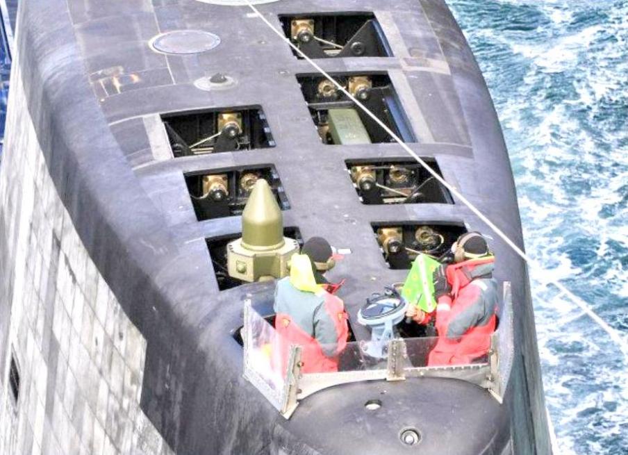

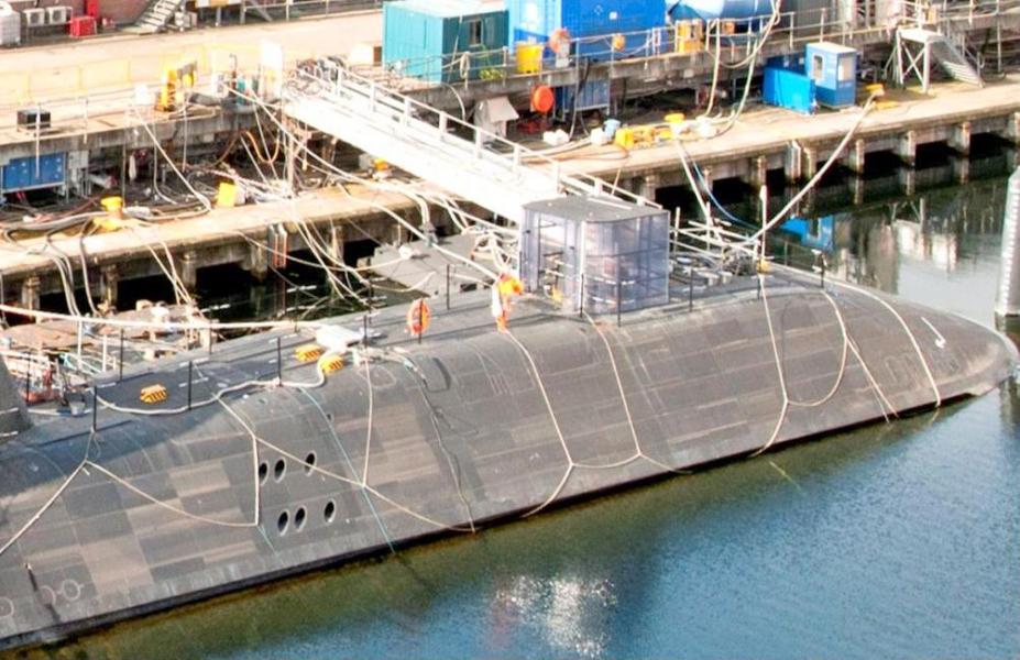

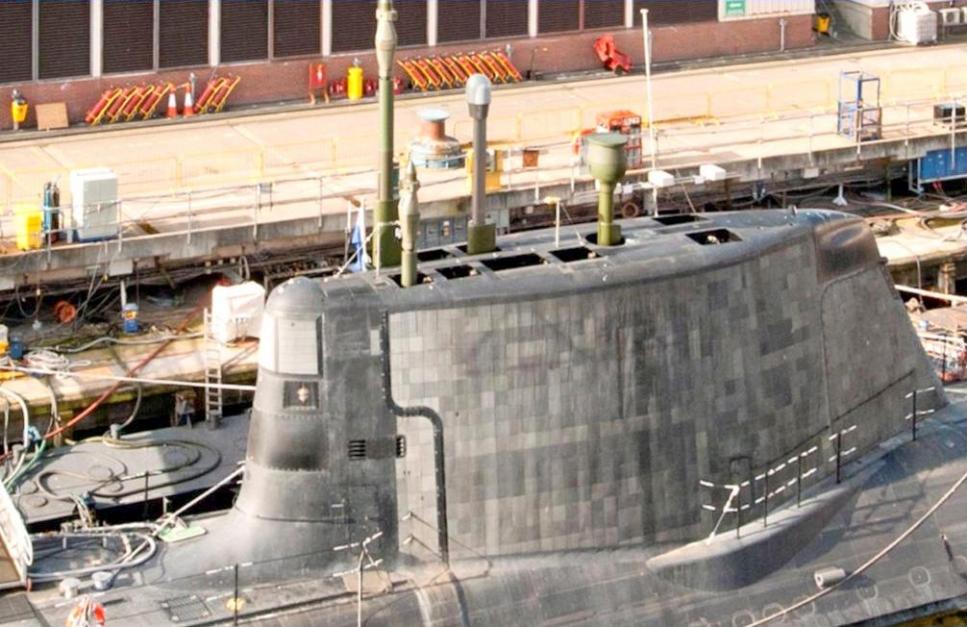

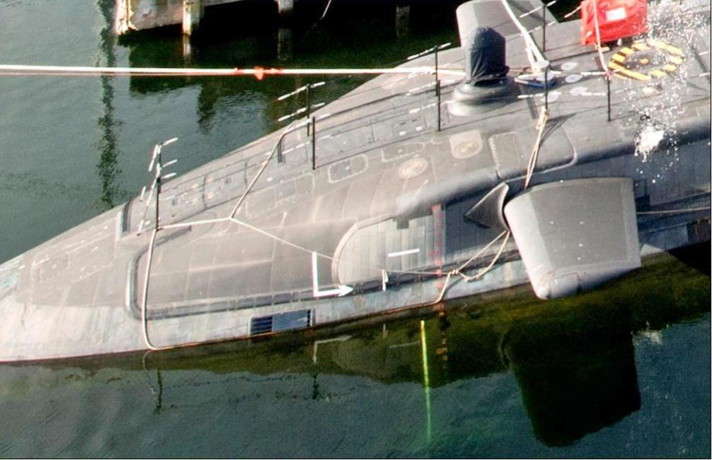

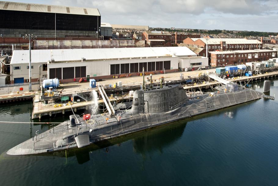

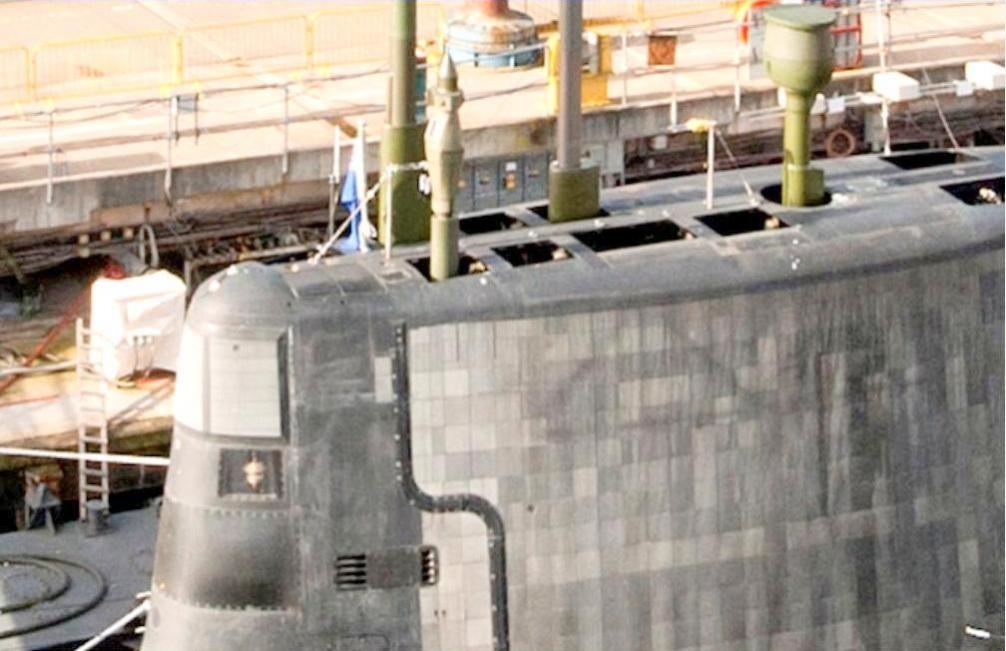

                        Joel, perhaps these will help.Click image for larger version
Name:	Ambush sail stuff.jpg
ID:	75459Click image for larger version
Name:	Ambush sail stuff closer.jpg
ID:	75461Click image for larger version
ID:	75462Click image for larger version
Name:	Ambush large.jpg
ID:	75463Click image for larger version
Name:	Ambush and rudder.jpg
ID:	75464Click image for larger version
ID:	75465Click image for larger version
Name:	Ambush Sail closer.jpg
ID:	75466Click image for larger version
Name:	Ambush stern.jpg
