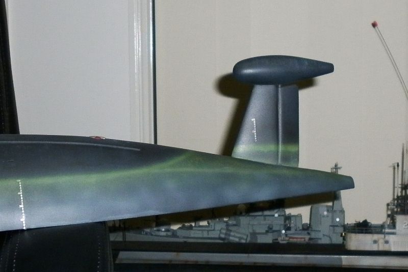

    LOL.
    Sorry.
    But, it will change, entirely, the look at the stern. Good man!

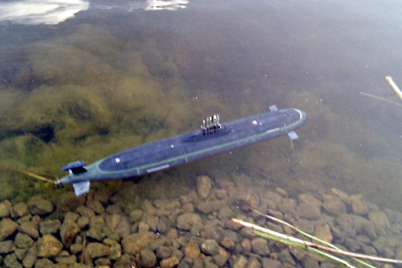

                    Well after yesterday arvo I can officially say it is finished. All that is left is me learning to pilot the thing better... The Titanic Anyway after spending the first part of Saturday with the wife out shopping and hunting down a new mobile phone and plan then doing all the lawn work I have neglected over the last few weeks I decided to take out the Akula to one of the local puddles here in the estate. We have three here, the biggest is the original dam from the property before development. It is not rc boat friendly as it is full of submerged trees and is full of drifting weed and alge banks. The smaller middle one is where I've taken the Seaview & Gato for some tests and runs. However we haven't had any rain here for about 2 months so it is a little scungy at the moment as it normally flows over a small rock wall to the third lake so it is full of duck weed and alge bloom. The bottom one is a decent size but not that rc user friendly either, as it is surrounded by a sandstone block wall that raises the bank about 2 feet above the water and these are surrounded by various gardens. However it is split in two by a road bridge and it is in the bottom third that I went yesterday. It runs a fountain in the middle that runs 24/7 and there is some sort of recirculation system with them as well so apart from local wind rubbish from the area and lazy sods using the adjacent parks & grounds the water is pretty good per-say. At its bottom end is a gravel ramp of sorts left over from construction which made getting into the water a treat. The only danger on this pond is the wall of bull rushes that ring the edge...
                    Ok enough of the topography lesson... Please forgive the poor pictures as I took these on my mobile whilst operating the tx unit. A lot must be said for having a camera person or at least a tripod... Now I have got to say that this boat is as much fun to drive as the Gato.(Sorry David) with the slightly over-sized and out of scale planes and rudders it has handling, turning, diving and surfacing are very respectable and responsive indeed. Also with the type of ballast system it has I found I could get it to pretty much 'hover' with the scopes just below the surface :biggrin: I also never notice any unusual pitch or roll from how water and air sit in the tank and I don't believe this tank has baffles either. Now having said that, logic and some cowardice ruled here with the hover test runs. So it never strayed to far from the shallows off the gravel ramp Scuba Diving
                    Most of the time though I just ran it with the scopes n masts broaching the surface at just above the sail. I also played with the epa on the throttle stick and found running it at 65% forward throttle not only gave a truer scale speed but also helped it run level under water and not pitch the nose down as I have found it does at much higher speeds!? and if id did start to glide down a little rise on the forward planes fixed that. Most of the underwater runs had me only running the right hand stick which controls both motor & rudder. you got to love the ADF2 auto leveler.
                    Even on its own running with decks almost awash it has a nice look and even a bit sinister... LOL

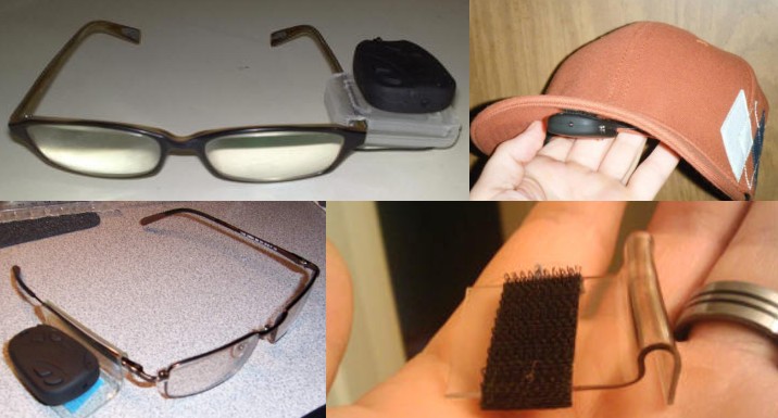

                            If you get one of those little 808 keyfob cams, you can attach them to a baseball hat or a pair of glasses (or sunglasses) so that the camera tracks your line of sight. Hands free filming. You could do the same thing with a mobile camera I guess, but you'd look a bit of a pillock with one of those strapped to your forehead.
                            If you get one I recommend a version 16 (720P recording).
                            http://www.ebay.co.uk/itm/Mini-DVR-8...4&cmd=ViewItem
                            Still shot taken from some footage shot with a version 16 808.
                            A depth controller on the front planes will probably deal with any bow down shenaningans. The subtech unit is the only standalone unit I know of currently for sale.

                                • 2626
                                #60
                                Originally posted by alad61
                                how could you run one on a sub??
                                You need to build a watertight housing. I moulded a few from GRP with a aluminium bayonet seal, with as close to optimal streamlining as I could get. No need to go that level- I've seen perfectly performing enclosures made from PVC pipe, old deodourant caps, even a tic-tac box etc.
