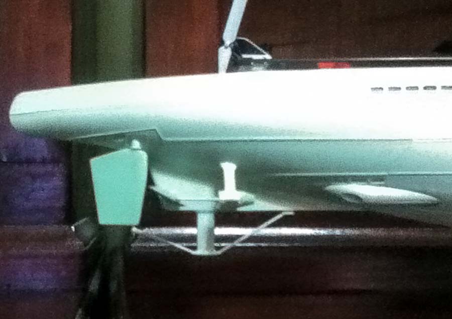

  • Avera
    replied
    Hi Folks,
    My next two questions:
    1) How do you support/connect the deck as one piece? I don't think that the small lip connecting each piece is sufficient.
    2) How much lead weight goes in the keel?
    Thanks,
    Andrew
    PS: I added some pictures of my progress, pretty poor quality from my iPod Touch. I'll do better later, this was a quick thing.
