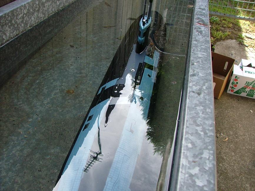

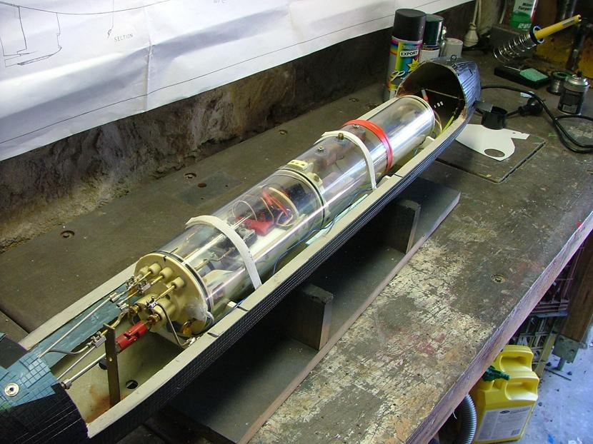

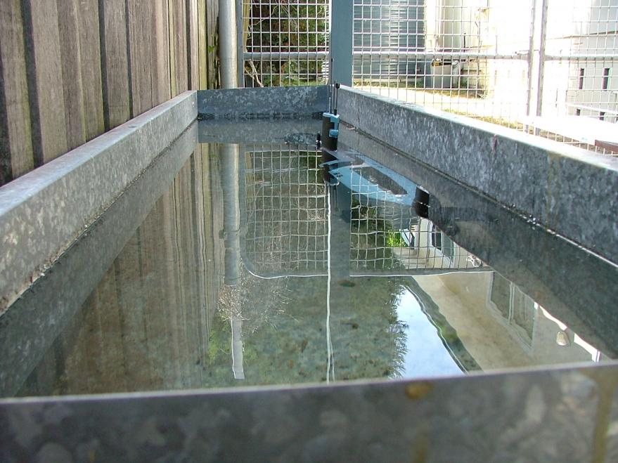

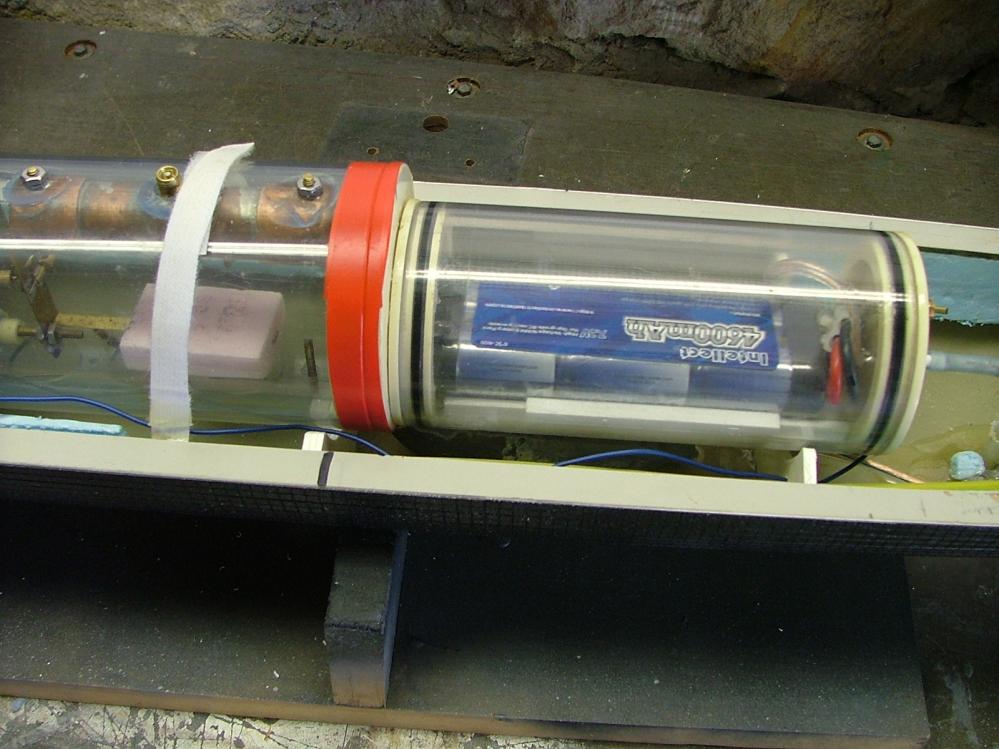

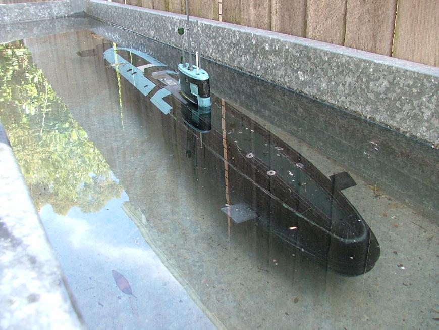

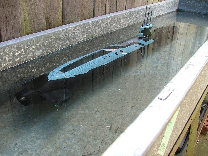

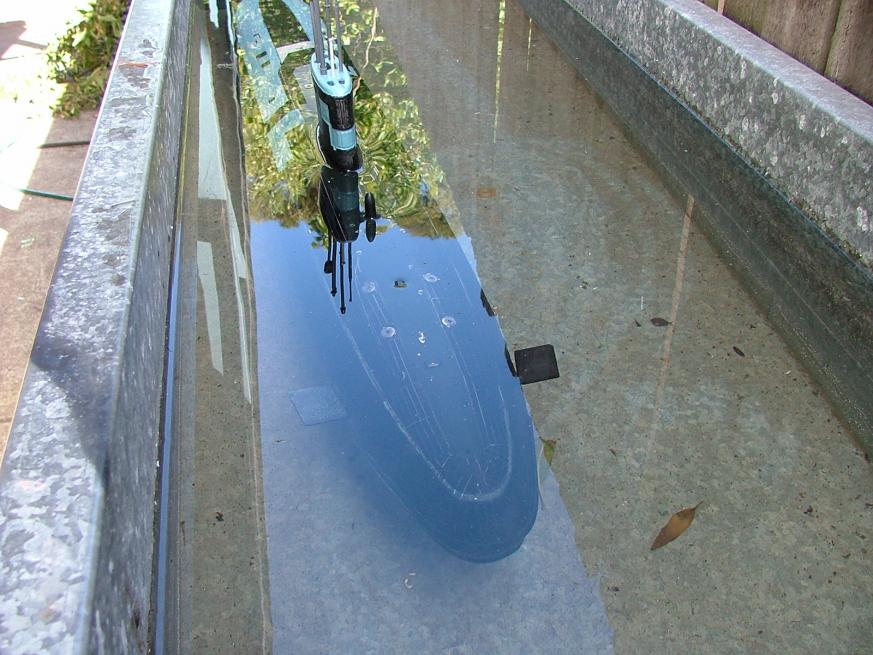

                  Ok more tank testing and some photos too.
                  Here you can see Trenchant in the wet stuff. I drilled the upper deck with some more openings and still needed to add a tad more weight. I do run my boats slightly positive as I run in a lake where visibility in some areas is patch at best.
                  That said she is too positive still.

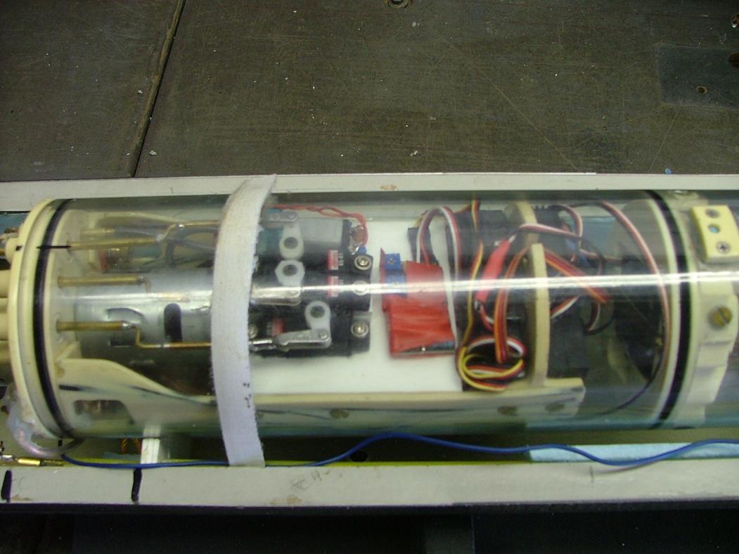

                  The subdriver photos show here that I use a 3.5" single screw subdriver and have connected forward of the ballast tank a 3" enclosure for the 7.2 v battery.
                  David / Mike, what would it cost to have a connecting end cap like the two I have connected between the battery compartment 3" and the BT 3.5"?
                  I used some threaded brass rod to join the end caps and glued them together. I added a battery tray to the 3" battery compartment.
                  This is a very nice boat and I do like the colour scheme - it will be good for 4 eyes here to see it too in this pattern. I have added some weathering - scum line and removed some tiles too.
                  All up I like it.
                  Best
                  John
                  sigpic

                    • Slats
                      • 1776
                      here is some more photos
                      sigpic

                          • Slats
                            • 1776
                            I'd like one, as I feel a moulding would be so much better than the way I affixed mine together. That said they way I have it ain't broke - it works just fine.
                            If not commercially viable - don't worry about - I complete understand and I am sure others will too. We live in the real world.
                            The 3.5" Subdriver could easily be coupled to an SLA in the wet area. I choose a NimH pack as I have a 7.2 V motor in the 3.5" SD I have, and like the idea of using the 7.2V bat pack over going wet (and I must say heavier), with the SLA.
                            Having the battery pack section join the ballast tank, just makes IMO the whole SD look neat and tidy as one whole package. Indeed that's what I love about the original 3" D&E Subdriver is that its so neat and tidy. Of course that SD has the electricals inside, here in mine they are external.

                              I like being able to remove battery without disconnecting the complete sub driver. That's one thing I like about the 3.5 design, over the other SDs. :)
                              Also gives more options in weight positioning.
                              (I realize it needs to be all in one assembly for the very Small versions, tho.)
