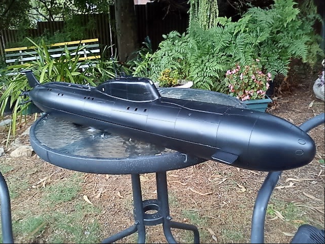

        Here it is just after the first coat of black

          You need to cover those torpedo tube doors on the bow then rescribe new ones on the sides.
          Also the sail is located closer forward. Maybe you could cut out the sail and move it a bit forward then make a new rear deck out of styrene sheet. This way you could put a VLS on her.

            Stop nit-picking, damit .... AND FINISH YOUR 1/144 KILO!!!!!!!!!!!!!!!!!!!!!!!!!!!!!!!!!!!!!!!!!!!!!! !!!!!!!!!!!!!!!!!!!!!!!
            And Chris: you turned a dog into a good looking mutt there. Dynamic or static diver?
              Now running with my tail between my legs...

                Thanks redboat219, but you are talking about a K329, what we have here is a K329s.:wink:

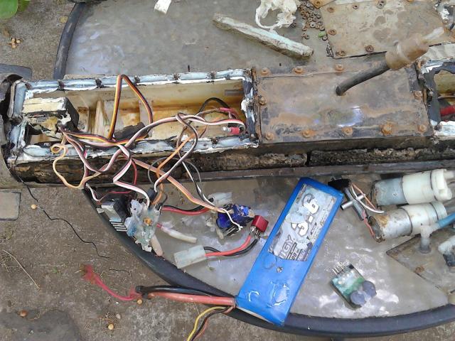

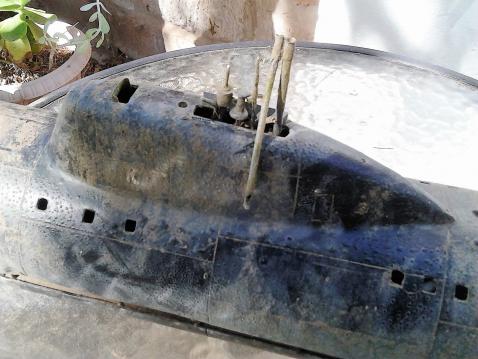

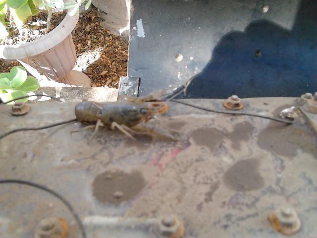

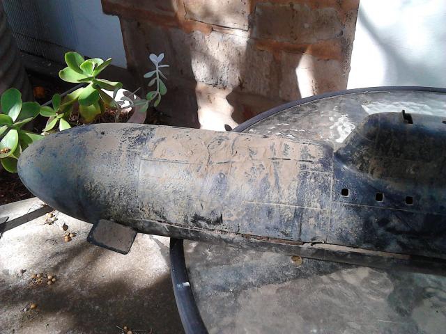

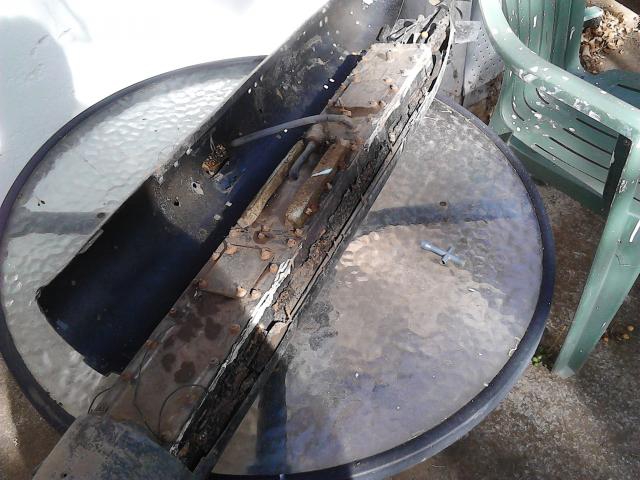

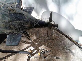

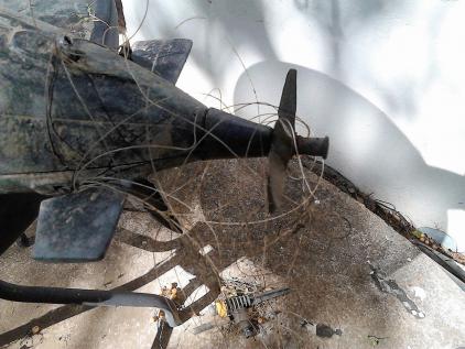

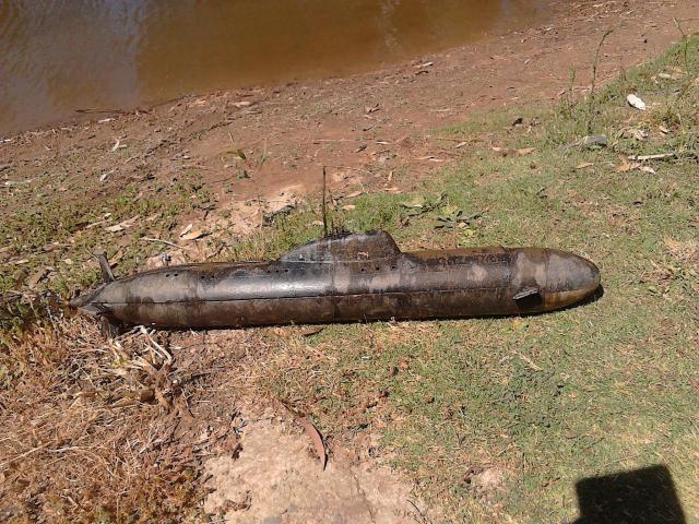

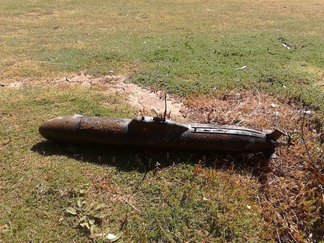

                  It's been a while since I have been here and a lot has changed.
                  My k329S went missing when on patrol. It was doing a demo run at a large lake in the mid north of South Australia during our winter. It was the commanders fault he (me) lost contact with it when he (I) looked away to answer a dumb question. First thing that was done when it was lost was to stop ALL actions, but after a couple of minutes (which seemed like hours) it was decided to blow the emergency ballast. Still no sign of it not even bubbles. So I sat there looking at the area where it should be for ages. Still no luck. A sweep of the area with a net also returned no result. After a hour had passed and all sorts of things tried I came the decision that it was lost. Being the type of guy that hates loosing things and the lake is only 3/4 of an hour away from home I would go there whenever I could to look and reflect on where it could be.
                  South Australia is a hot and dry place and with each visit I noted that the level of the lake was dropping as the seasons changed. Come on summer.
                  One of the visits I made in summer on my bike I thought I could see a dark shape about the correct size in about 3 foot of water and 15 foot from the now edge of the water, what could a bloke do?
                  A quick look around, no one in the area, Off with the boots, socks, and jeans and in I went. Mud ozzzing between my toes my shirt now wet I felt at it with my toes around the shape and picked up one end with my foot just enough to grab it with my now soaked arm. YES it was what I was looking for. MY MISSING SUB. Now how to get it back home on my Sportster? Lots of fun!!!!!.
                  The battery was flat(LOL), every thing that had steel in it was rusted on the out side but the dry areas were still dryish. no water but corrosion on everything and in the hull 2 living things. It had become the home for 2 Yabbies, small fresh water crays.

                    Now, THAT'S weathering!
                    You got it back! I well know the awful feeling as you bring an empty boat-stand back to the shop. You did not give up on it. Good work, sir!
