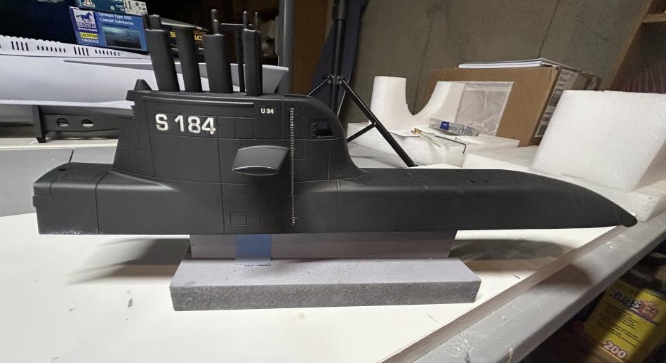

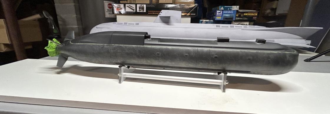

    More from the neophyte trudging among giants……the sail is now primed and will be set aside while I finish upper hull details and prime it. I am pleased with the sail.
    As I mentioned, I am not a rivet counter, but I thought my fellow neophytes might like this photo of a Virginia Class sail. I have opted not to attempt the stressed surface. I really like this photo though!

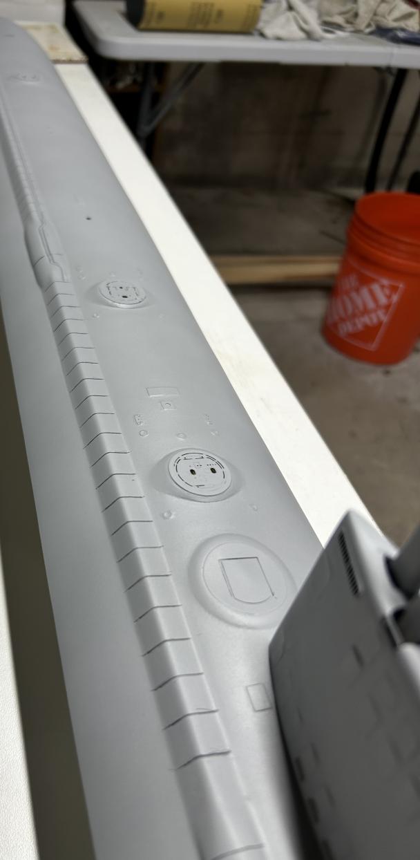

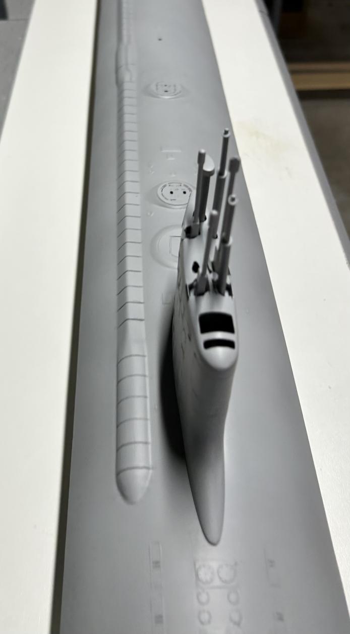

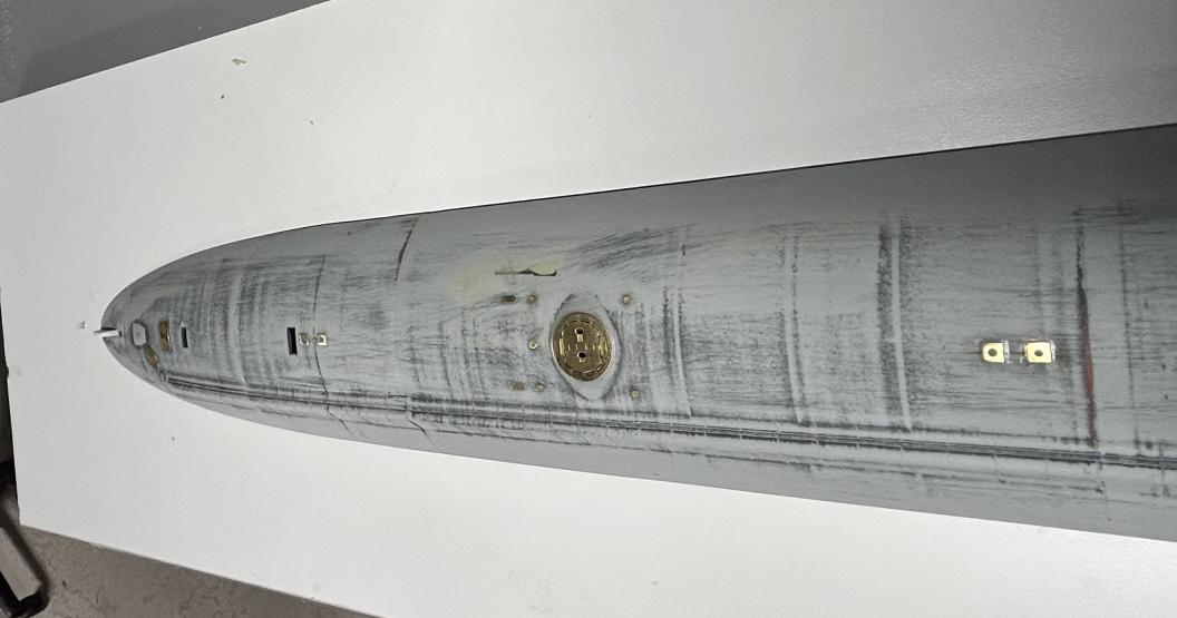

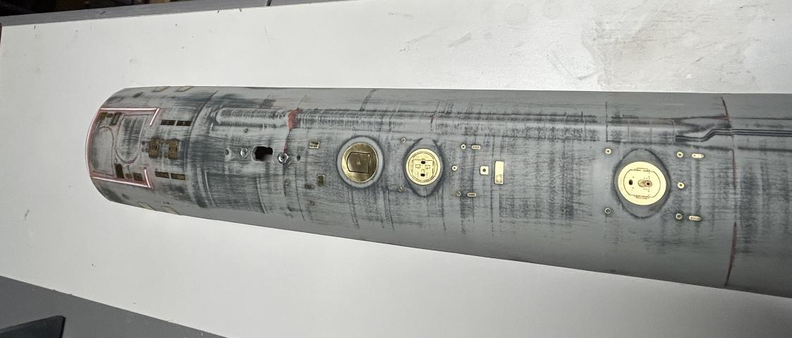

                          Getting a little more time and trudging along…..upper hull is primed…..
                          Click image for larger version  Name:	IMG_7893.jpg Views:	0 Size:	45.4 KB ID:	196162 Click image for larger version  Name:	IMG_7892.jpg Views:	0 Size:	52.3 KB ID:	196164 Click image for larger version  Name:	IMG_7894.jpg Views:	0 Size:	47.9 KB ID:	196165 Click image for larger version  Name:	IMG_7895.jpg Views:	0 Size:	42.2 KB ID:	196166 Click image for larger version  Name:	IMG_7890.jpg Views:	0 Size:	57.8 KB ID:	196161 Click image for larger version  Name:	IMG_7889.jpg Views:	0 Size:	57.1 KB ID:	196160

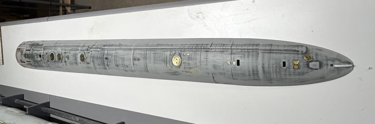

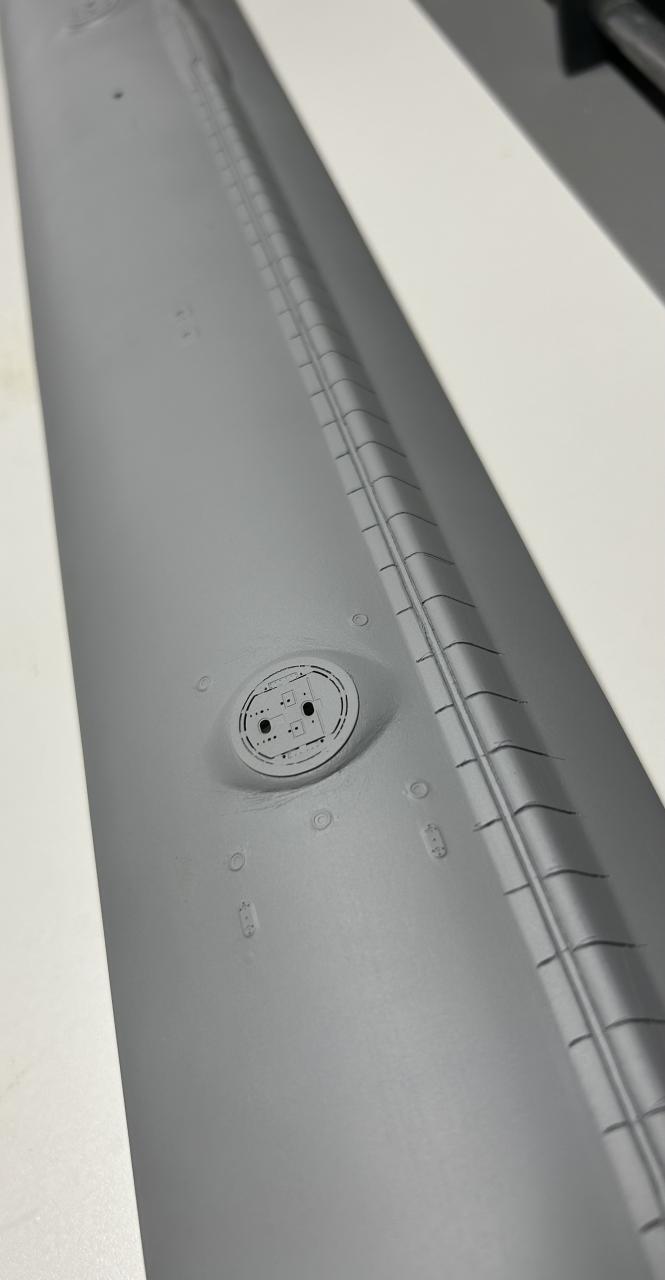

                            Reminder to my fellow struggling newbies - if you choose to use Tamiya’s terribly expensive Fine Spray Primer to help preserve small (PE) details and you plan to use acrylic color coat next, all the solvents on the Tamiya primer must be thoroughly dried out. I will use IR lights snd then let it set for a week.

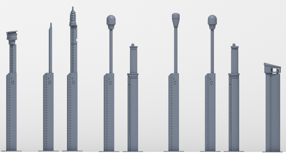

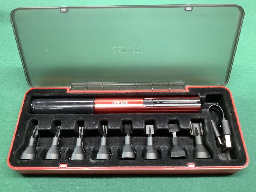

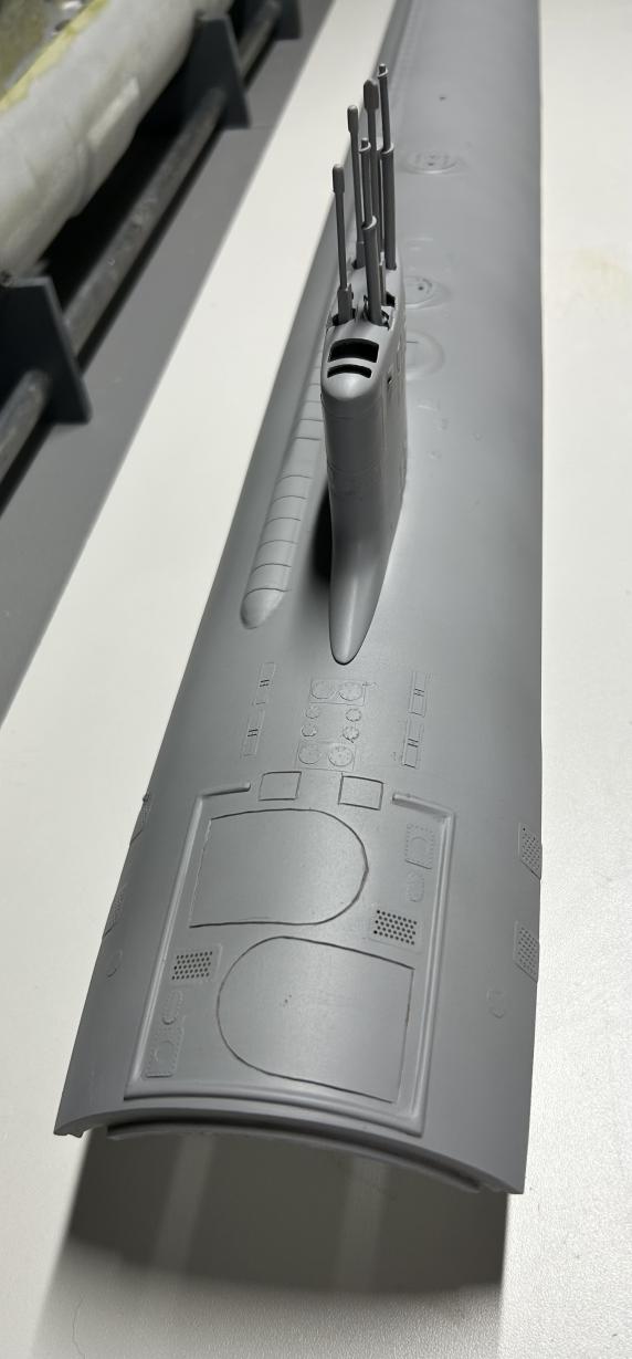

                            • CC Clarke
                              • Aug 2020
                              • 320
                              Lots of sanding on display here - the bane of FDM 3D printing, but it's looking good! For detail sanding work, I use a DSPAIE reciprocating sander which works very well.
                              As for mast and antennas, this is a full set of 1/72 I made for an upcoming Block V build, as soon as official photos of the new missile deck and sonar array are published. Remember the angled portion of the mast fairings points forward when installed.

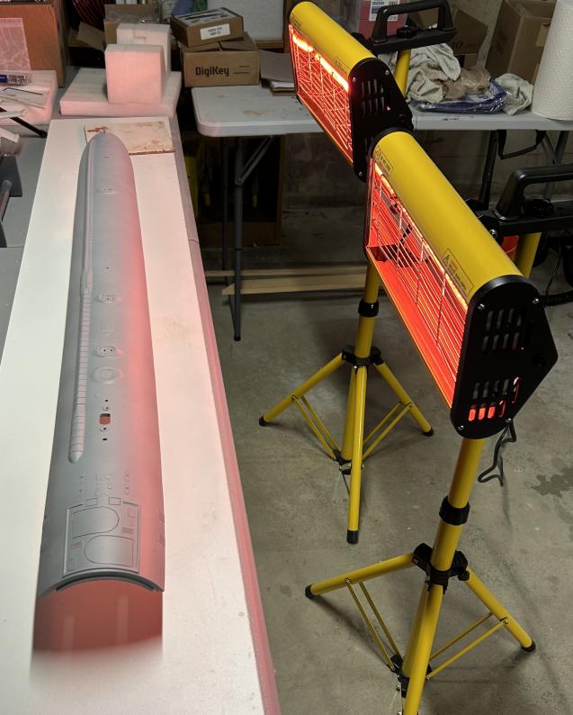

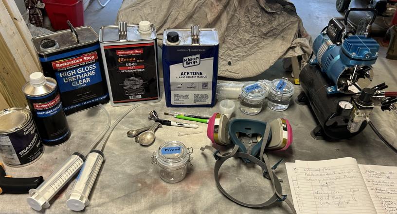

                                Trudging along…… and just a reminder that I am a beginner just trying to share whatever things I might run into that might possibly be of interest to fellow newbies……mistakes and all LOL.
                                While not specific to the USS South Dakota, today I used 2K polyurethane clear coat for the first time. This will eventually be the clearcoat that I use on the South Dakota so I thought I might share my first experience with it even though the subject model was my 212A. I had stripped its original paint job, repainted with acrylics, and today put on the 2K clearcoat because I wanted something much more durable than my original rattle can clear coat. David Merriman prefers the rugged qualities of this clearcoat and that’s what I was looking for. I tried to read as many of David’s descriptions of using this paint as possible - but in the end I just had to jump in and experiment myself. I did so with a little bit of trepidation but I’m happy with the results and here’s what I’m learning:
                                1. The products used were Restoration Shop Urethane (C), Restoration Hardener (H), Restoration Reducer UR-60 (R), and Transtar 6494 Flattening Agent (F).
                                2. The mixing ratios were 4 parts C to 1 part H. 2 parts R were then added to thin it. Then 1.5 parts F was added to flatten it. These ratios produced the drying / hardening rate and level of flatness I desired. I got lucky on my first round guess.
                                3. The process: spray a wet coat with a wide nozzle Pasche airbrush; wait about 10 minutes for it to flash; spray 2nd wet coat; wait 30 minutes for solvent release; and run IR lamps 15 minutes at 130-140° for quick drying. I will wait another 24 hours before handling set it aside for a week just to be sure that it is cured.
                                Soooo…….what to share about this with my fellow newbies????? Using 2K is s personal choice - there are lots of easier ways to clearcoat but none will provide the durability of 2K. I guess the first thing I would say is if you’re not particularly into painting, don’t do this. 1st, the products are very expensive (although in the quantities purchased they will last a long time). 2nd, the products are extremely toxic and a bit messy to use. I would say don’t even think about it unless you’re willing to buy the appropriate mask and have a well ventilated area like a garage with doors at both ends. 3rd, it’s pretty easy to screw something up. 4th, I think when I spray the South Dakota I will go from the Pasche to a very small auto shop touchup gun .
                                If that doesn’t sound like fun, you might just grab your favorite one part clearcoat rattle can and go for it LOL.
                                I’m pleased with the results I’m glad I ignored the trepidation and tried it. I hope this might help some of you who are doing head scratching about many of these questions on your first sub. Until next time….,
