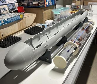

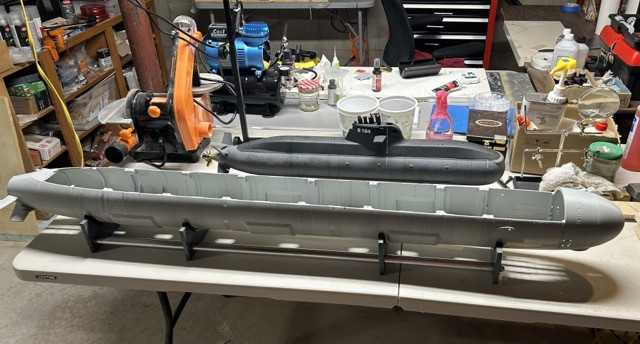

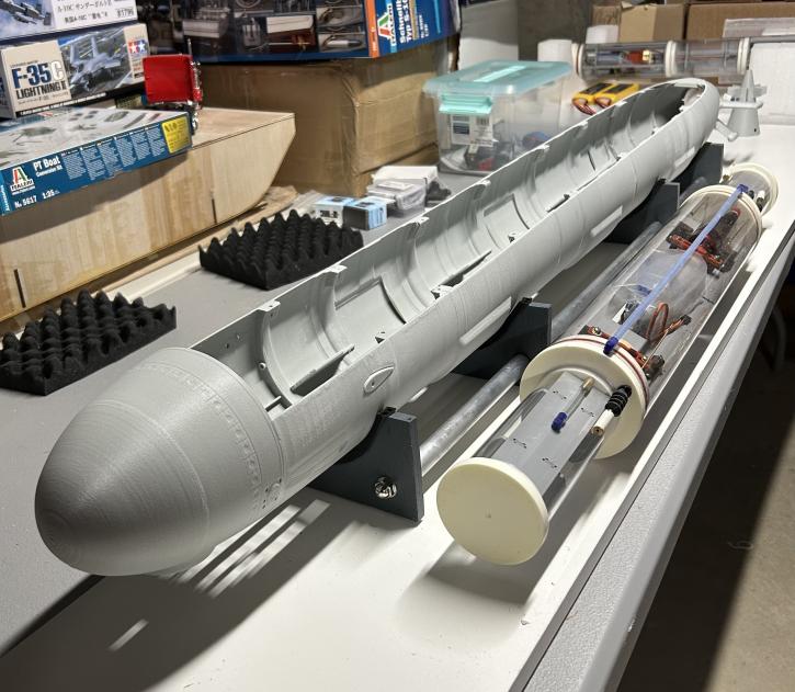

    Through the wonders of Subex25 I had the privilege of going inside the South Dakota last year. I decided right then and there I would learn how to build RC subs and would eventually build a model of this exact sub.
    I built an Engel 212A to get my feet wet - but it is a dry hull with excellent step-by-step instructions. This model comes with no instructions LOL and is a wet hull. It will be a learning experience - not to mention incredibly fun!!!!
    The ABS/GG hull was printed by Bob Martin and I am very pleased with it. At this point lower hull sections are welded together. The next step is to fiberglass the interior joints. I generally build a stand in the beginning of a project and throw a cover over it during building. This hull will receive an R&R dual tank WTC.
    My primary reason for this post besides just the fun of sharing Is to let other beginners who may be intimidated by this hobby realize that a complete newbie can do it. To my mind it just takes patience and humility as you read and learn from others.

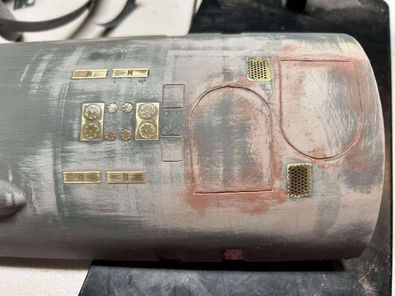

        4) And finally to bring my thoughts home here’s a photo of work in process on some scribing and PE placement on the bow of the Virginia class. My 76 year-old fingers were dreading this process. I questioned a photo in David’s “Today’s Work” and I am now trying (practicing) the technique in his photo. In the photo you can see the first attempts using Bondo Glazing putty to help cleanup scribing. Additional work needs to be done of course - but this is a new technique and I am working on improving it. I have enough confidence that when it is done I think I will be very comfortable with it. Of course it will not have that absolutely professional look that master craftsman David achieves - but that’s not the point. The point is to try your best, learn, and have fun.

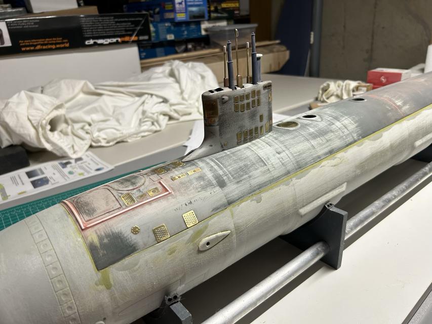

                      The neophyte happily trudges along among giants…… learning lots…….it’s actually beginning to look like a submarine
                      Click image for larger version  Name:	IMG_7643-compressed.jpg Views:	0 Size:	73.4 KB ID:	195313
                        Excellent prep work on the VIRGINIA so far. So glad that your deferring heavy priming and paint till the little **** is done... and done right.
                        Yeah... r/c submarines are new to you, but you evidence above averate skills you obviously developed down other paths of the r/c vehicle hobby.
                        All your humble-pie bull-**** ain't fool'n me, Tim: You come at this game loaded for bear. A couple of years and you'll be teaching me new things.

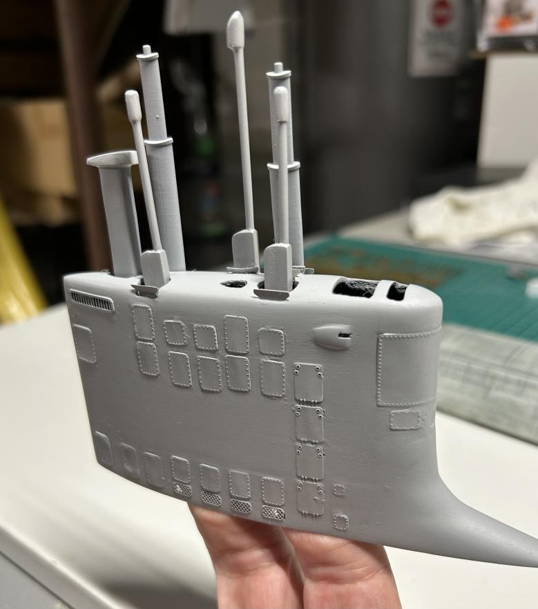

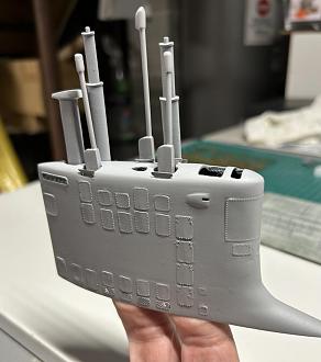

                            More from the neophyte trudging among giants……the sail is now primed and will be set aside while I finish upper hull details and prime it. I am pleased with the sail.
                            As I mentioned, I am not a rivet counter, but I thought my fellow neophytes might like this photo of a Virginia Class sail. I have opted not to attempt the stressed surface. I really like this photo though!

                              3) PE (photo etch): I was dreading using photo parts when I started on this project. I got over that hurdle - this is what I learned; 1) make sure you cut the PE parts out on a rock hard surface 2) anneal parts that will fit to a curved surface (heat it up and then cool it - lots if videos on it) 3) make your own application tips when using CA glue (I sharpen a 1//16” sprue and use it with thin CA). 4) depends on your view towards detail, but in my opinion don’t sweat the really tiny stuff that you can barely see - (2 feet away from you no one will see it).
