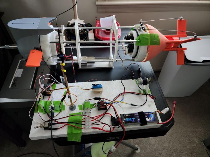

    Control Scheme:
    Receiver: frsky R9mm –ota
    Flight Controller: Speedybee F405 WING
    Flight Control firmware: INAV
    Features:
    Ability to locate the receiver antenna for optimum reception (vertical & outside of hull)
    Ability to locate the gyros and accelerometers as close as possible to boat’s CG.
    Access to all 16 receiver channels via FPort
    Telemetry
    Pitch and Yaw stability
    Three modes of BOW – STERN Plane operation:
    • Independent
    • Synchronized
    • Opposed

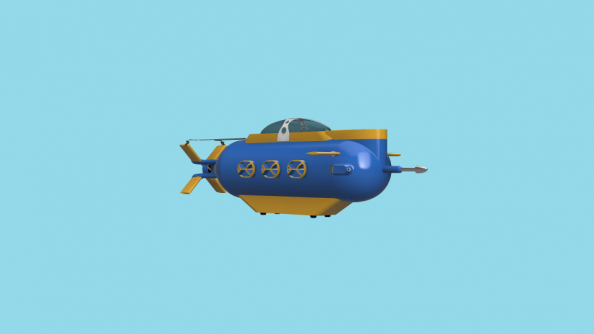

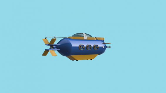

    Latest CAD renderings
    • TuptubBuilder
      • 152
