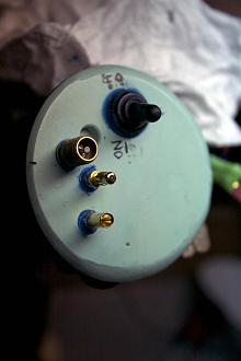

Taking David's suggestion, moved the 9v into the battery compartment. It will squeeze in there, so I drilled 2 1/16th holes into the already existing indentations and put bullet type connectors in on the wire. Sealed the hole and indentation with RTV.
There is a male and female mounted and that will prevent crossing wires. Tomorrow I will finish and test, then re-trim the sub. Just thinking out loud here, will I need to make a bracket or holder to prevent the 9v battery from shifting around? Tomorrow is another day for exploring and taking on challenges.

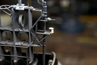

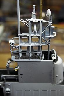

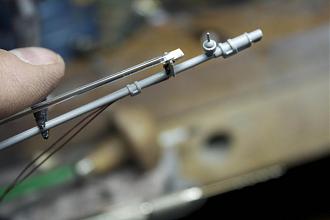

On the conning tower light, I cut a groove down the back and drilled a small hole to thread the wires for the LED through.

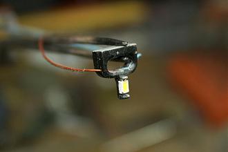

These warm white LEDs add a little yellow to the light making it appear closer to a light bulb and are much larger than the red/green LEDs used in the side navigation lights.
Then to run the wires down the back, I used the liquid glue to pre-melt the plastic (in small sections) and squished the wires into the molten mess with tweezers. Holding then until it solidifies and move on to the next section. Then followed with thin CA as a quick filler and adhesive.
The lens was made out of a clear rod of styrene that was sanded in half and glued to the LED with CA.
It came out O.K., unless you look very closely, it is hard to see the wires down the back.

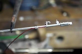

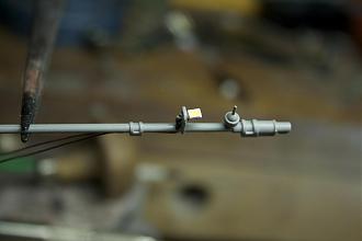

The Aft light was done the same. Just a different route.

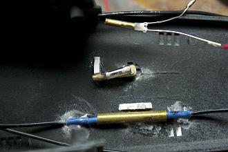

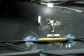

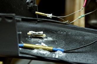

I wanted a way to turn on and off the lights. The solution I came up with was a crude switch using a Normally Open Reed switch. The reed switch is one of the very small one reed switches that I purchased for making an electric torpedo. I encased it in shrink tubing to insulate it and then slid it into a brass tube to protect it from getting broken. The capstan is the knob turned to make the brass arm swing over to the reed switch. Here is a side and top view.

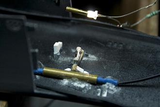

On this setup in the picture I used an LED to test the setup. Styrene was used to create the full “off” stop and the “on” lock/stop. A magnet was attached to the arm (actually two magnets - I had some in the brass tube at the end of the arm, but after the first setup it did not work. So, a second, stronger, magnet was added a little further back)
A test of the conning tower lit up.
Later I will worry about a proper paint job. Now I need to get this wiring finished and check the trim.Leave a comment:
