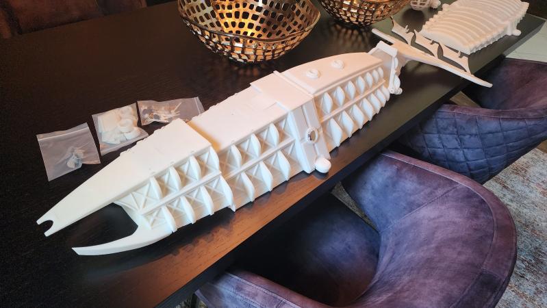

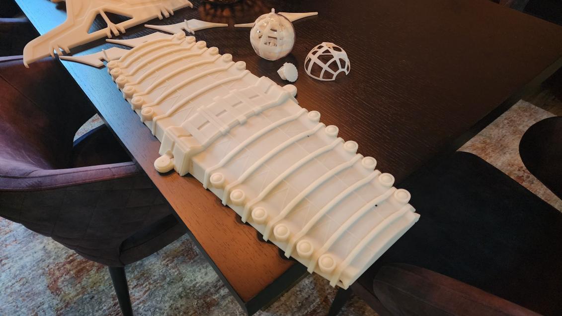

    I've got more description in my upcoming weekly video that drops on Friday, but here are a few shots of a project that I've really wanted to do for a long time.

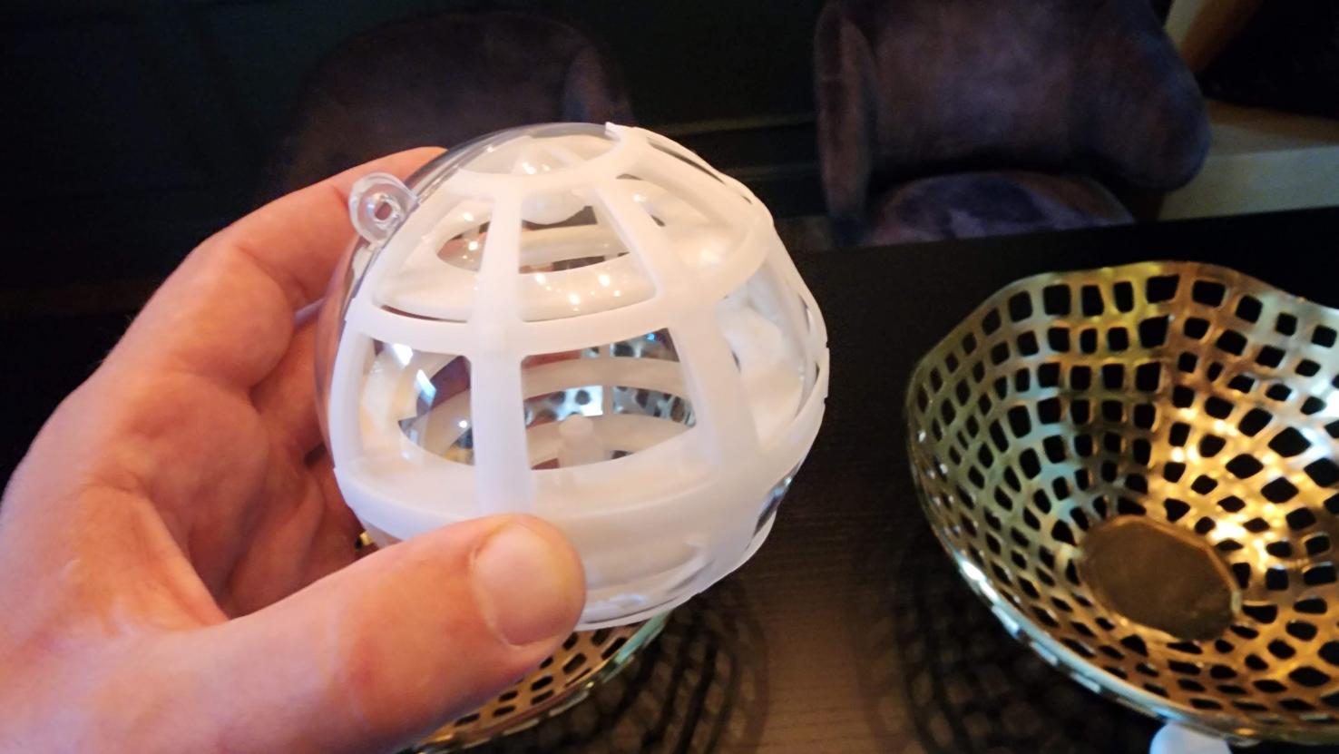

    Files are freely available on Thingiverse, but needed to be heavily modified for actual printing and functional control surfaces, hull split, etc. Overall length is about 4ft. I fully detailed out the control sphere, and it will be a dry area to help offset the weight of the (rather thick and strong) hull.

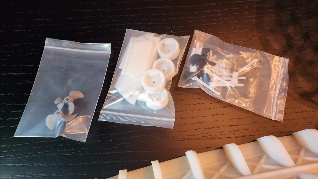

    Planning twin brushless 750kv motors, 12.8V battery, waterproof servos, and custom box-style compartment. Oh, and about a million orange LEDs!

    Wonder what the effects the high mounted fins would have on the model once she's in the water.

        When I was planning mine, I envisioned making each engine pod self-contained, with the controls housed in a watertight box. Everything I’ve learned in Fusion has been focused on modifying those files, and I’m still trying to do that.
