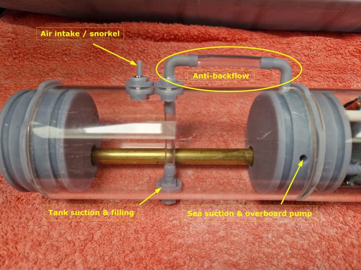

    The leaking of water through the pump is called backflow and is normal for pumps other than peristaltic pumps . I don't know what type of pump they are using—perhaps a gear pump? In my opinion, the only way to avoid this without using a solenoid valve is to have the suction/filling line higher than the water surface when the boat is surfaced.
    Or, you can ignore it and empty the tank once in a while if you stay on the surface for a prolonged time.
    Maybe reach out to Ron of R&R?
    Below my layout.
    Click image for larger version  Name:	Victor_III (133).jpg Views:	0 Size:	74.1 KB ID:	181564
    Grtz,
    Bart

      What Bart said. The filling intake has to be above the waterline when surfaced. I don't use valves. A piece of silikon tube reaching from the high-up intake in the endcap into the keel area underwater will work.
      Gear pumps leak. That's normal.

        Bart, I like the look of your anti blow back set up. I think I understand how it will work and may be able to incorporate it into my WTC if needed..
