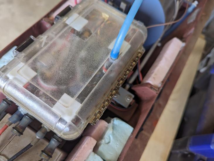

    1. Her S3 T2500 Command and Control box, which contained the brain of the system. These past two and a half years of running in the North Texas mud holes clearly (no pun) indicate the clay like silt accumulation I’ve been suffering. This box was clean for almost 6 years of operations until I moved down from Long Island NY. Note the hinges! For the record, any boat I run gets a complete post patrol check and fresh wash when I get home.
    Click image for larger version  Name:	20240319F.jpg Views:	18 Size:	51.7 KB ID:	179027

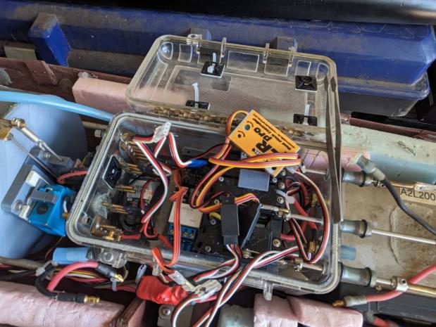

    3. To the extreme left is the 127mm [5”] OD Ballast tank, its waterproof Blow vent servo. In the CnC box, the FrSky “Archer SR10” receiver (2.4ghz), associated “R9” receiver (915mhz) receiver, FAS40 ADV Current Sensor and associated “rats nest” wiring have been removed. To the left is power distribution, 5V Power Supply below, the ancient Jomar “Nautical Throttle, Rudder/Fairwater/Stern Plane servos upon which the Engel LRPro APC is resting. The the right of the CnC box is the feed wires to the Motor compartment and the No. 2 SLA Battery
    Click image for larger version  Name:	20240319E.jpg Views:	17 Size:	59.2 KB ID:	179029

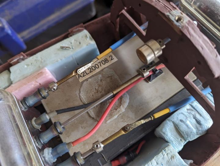

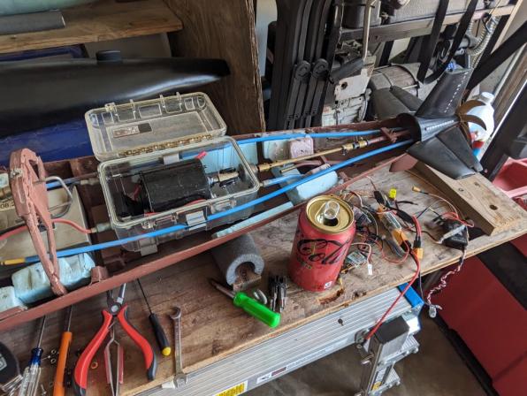

    4. Here at the stern you see her open Motor Compartment. She sported a Redmond 12V 10A Brushed RV HVAC electric motor for propulsion swinging a brass 95mm [3-¾”] 7 bladed screw. Direct drive. Just aft of the motor itself you can see the homemade “torque absorber” which GREALY saved the drive train during emergency maneuvers. Can you say, “No blown dogbones.”? Note the discoloration of this compartment as well.
    Click image for larger version  Name:	20240319B.jpg Views:	17 Size:	58.1 KB ID:	179030

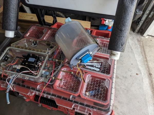

    5.The removed CnC compartment and Ballast tank sitting on the mobile “RC Submarine Tender”. Again, note the discoloration from my local ponds.
    Click image for larger version  Name:	20240319C.jpg Views:	17 Size:	55.4 KB ID:	179031

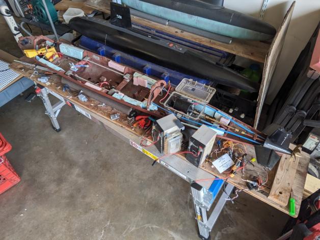

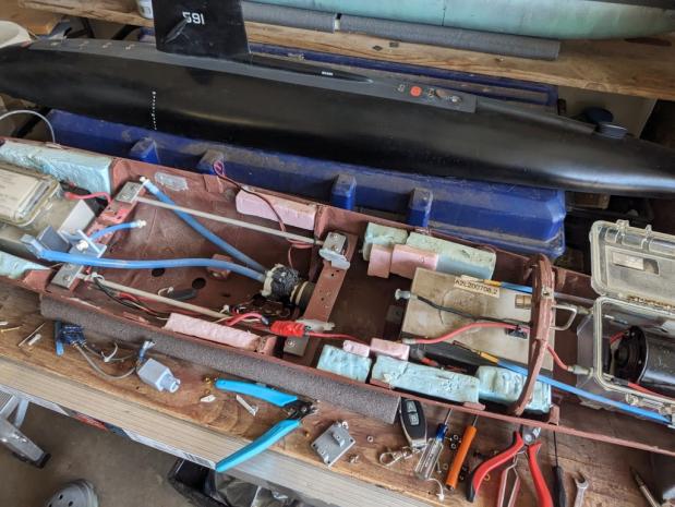

    7. Gutted. Took about 10-15 minutes to get here. Most of which was remembering the order of operations to safely remove everything from the CnC. ALL my boats have fairly easy access to everything for Maintenance, repair or replacement. The motor compartment is easily removable by backing off the shaft and a single hold down screw. After a thorough scrubbing, the new, yet to be revealed system will be installed.
    Click image for larger version  Name:	20240319A.jpg Views:	17 Size:	56.5 KB ID:	179033
    As I’ve said, the new system will employ everything I’ve played with. About the only items in the dry will be the LiPO’s Sensors and receiver itself. The ballast tank will be adjustable as she’ll be shared among a minimum of 6 hulls including single and twin screw boats. That’s the 101mm [4”] system for the larger boats, a smaller 76mm [3”] will be shared on 4 hulls.
