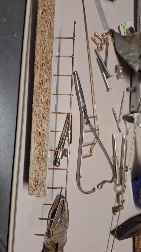

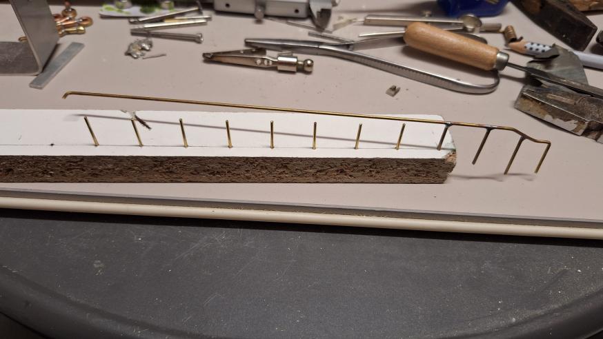

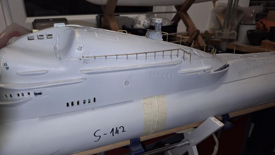

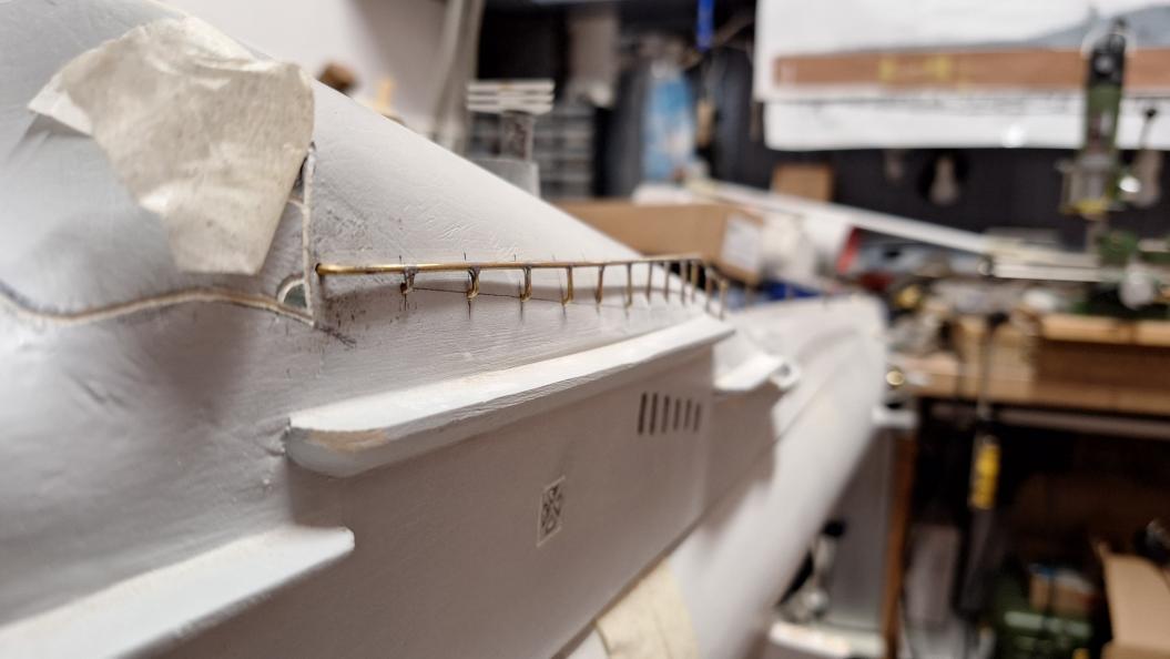

    replied
    First reling is in place! As with the original, the longer posts stand upright on the deck while the fore ones are bend and attached to the side. Some minor corections are necessary, but overall it worked from the start. The positions of the angles were marked over the drill positions and than bend with pliers and fingers. Some trimming back of the ends was necessary to be able to put the reling on.

  • JHapprich
    replied
    More soldering. Made a jig to install the missing posts to the reling sideways of the missile containers. After preparation, the soldering went quickly.
