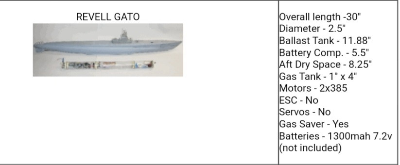

      I'm way late on the update but here is some progress. I've mostly completed the ballast chamber of the wtc. I also have the bow end cap rigged and ready to install. I'm currently working on the motor bulkhead and the stern dry compartment. I'm also working on designing some of the parts from the old conversion kit in cad to 3d print. I'm doing it the hard way due to not being able to get the parts. I've also completed a prototype torpedo and launcher and tested it in spar time when waiting for parts. Those are too much fun to play with. Still need to design and print a snort valve, as well as get back to work on the hull. But it's been too bloody hot in the shop. Now for a few questions, 1: what was the over all length of the original wtc? 2: what is the spacing between the torpedo launch tubes? And lastly, Are there any dimensions for the torpedo tube mount?

        Don't even think about weapons and wood planking till this model is in the water and working surfaced and submerged.
        Basics...
        ... and only when you have a handle on the basics, go for the fancy ****.
        Crawl, stumble, walk, jog, run, then... and ony then... sprint.
        You ain't ready to sprint, kid.
          Revell 1/72 Gato Subdriver specs Click image for larger version
