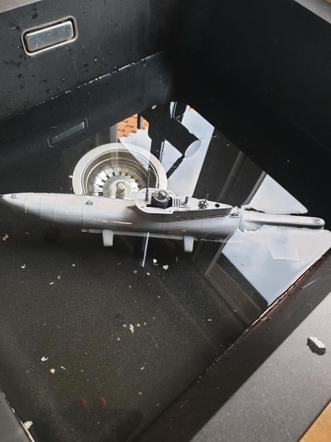

      Well, i did some testing in the kitchen sink, that went not so good. i started with a weight of 325 gram and with 5 miniutes the weight was 332 gram. leaving her iside the water gave her even more weight, took her horizontal positioned to the cave and started to opening her up.
      Lots of water in the hullpart and some in the sternpart, it seems she is leaking through the O rings, sealing those inside their settings with RTV can be the solution, first she has to dry.

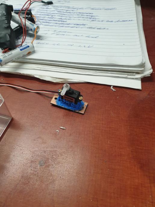

      Yet again i fried the servo of the torpedomechanism, probably water had come inside the servo, the idea is to seal it with RTV as much as possible.
      Click image for larger version  Name:	20240203_172109.jpg Views:	0 Size:	60.2 KB ID:	178174

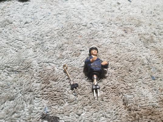

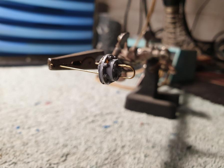

      While waiting for the water test i made this, on the right the standard key with the crewmember which was allready made in the past, on the left a key which can be used during the first stage of the boat in the water, it has to set due to the temparture difference between the land and water, this second key gives me room to ventilate the boat.

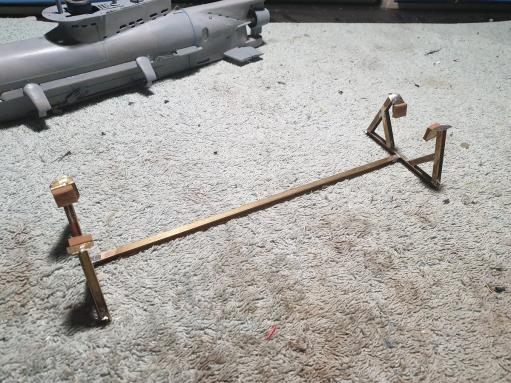

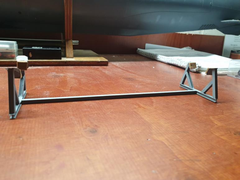

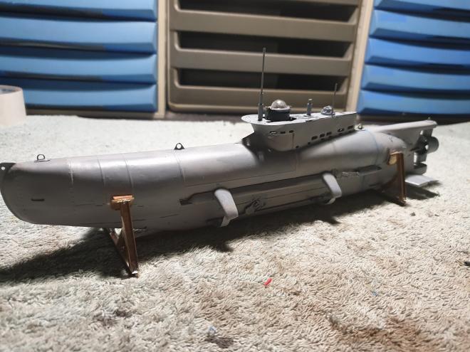

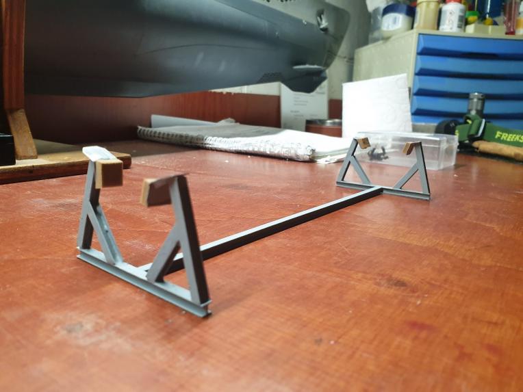

      Also made this, a stand for the Seehund, had some H shaped copper left.
      Click image for larger version  Name:	20240203_172155.jpg Views:	0 Size:	56.5 KB ID:	178176
      The Seehund will fit snuckly between the rubber pads, this stand is a bit inspired on the transport lorry they used to get the boat at the desired location

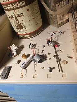

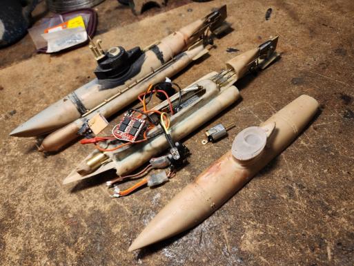

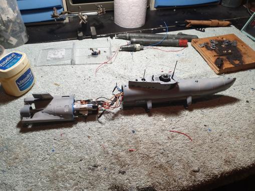

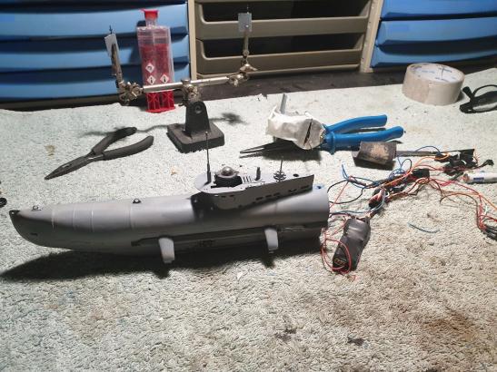

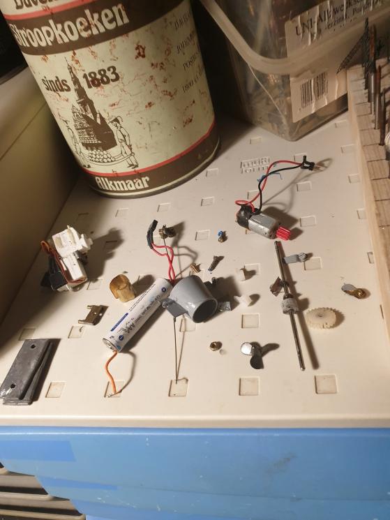

      Here i stand now, opened her up to dry, had to fiddle out all components, the flange of the sternpart was loose, used 2K epoxy glue to get it back on, it's secured it with tape while drying
      Click image for larger version  Name:	20240204_175041.jpg Views:	0 Size:	51.7 KB ID:	178178
      Those are the parts i had to remove, the sternpart is stripped from all it's components, the servo for controlling the torpedo's is still inside the hull, when dry i can take her out.

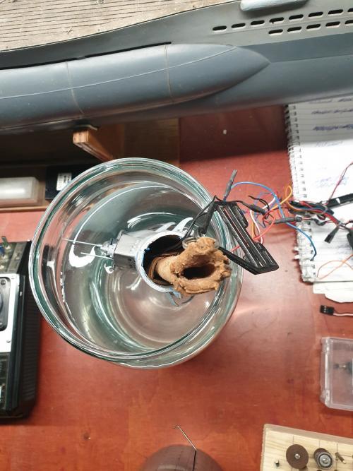

            Done some work this week, just as i suspected the O rings where the issue, ended up sealing them with RTV, did some testing to see if that was the solution, pictures

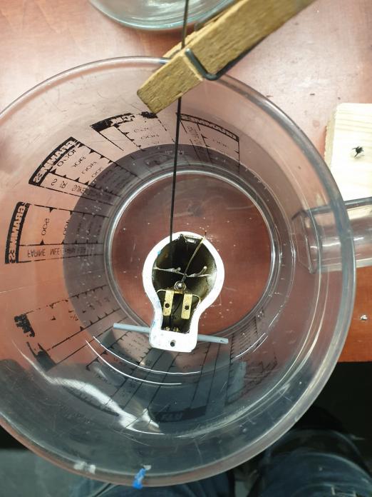

            Rear-end sealed and into the testingpot, left it there for a hour
            View from above, no water inside, both the shaftseal and O rings kept the water outside.

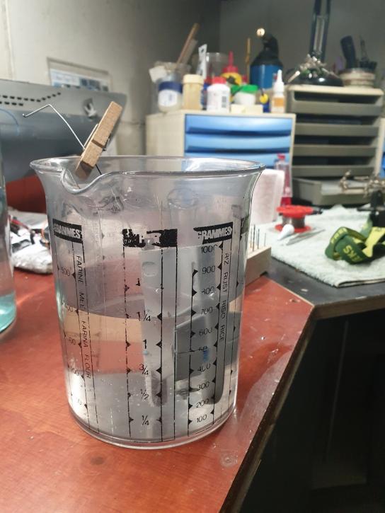

            Frontpart into another testingpot, pretty much the same procedure.
            Had to add some weight to keep it at the desired depth, left it there for at least 1 hour, same outcome as the frontpart, no water inside.

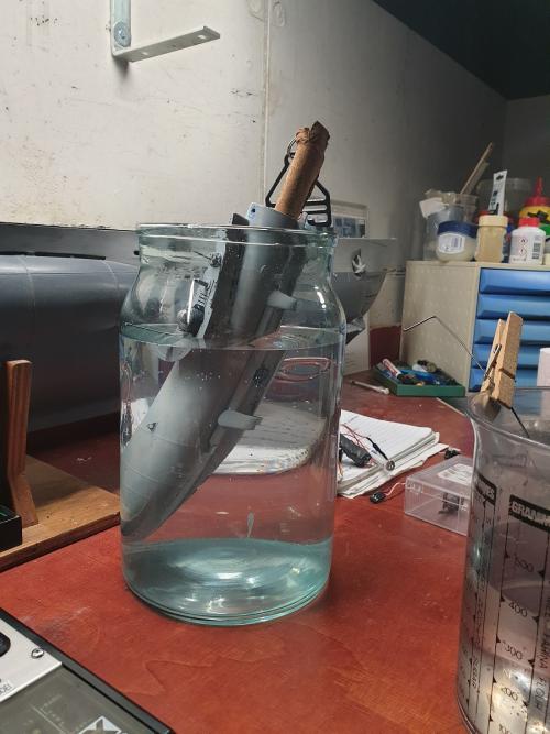

            Sealed the bottom of the torpedo release servo with some RTV, just to prefent water damage, it is really a pain in the ass to get this servo in or out.
            All this steps revealed i made mistakes by not testing this really good, i got punished for this, first crawl, then walk and run, i can hear you David!!!
            This weekend i want to put the Seehund together, hopefully for the last time, testing will be done when the RTV is cured, i'll report back with the outcome

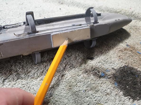

              Made the holders which hold the torpedo's in place, heavier with some strips of flat lead, this is done to ensure they will unlock when needed.

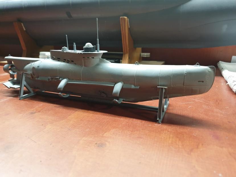

              The Seehund in his stand, ready to be tested if she is watertight.

              Did some tests and left her inside the sink for at least 1 hour, weight stayed the same, so she can called be watertight, wateline a bit too high, it seems that the foam at the keel can be removed, have to do some more testing to find this out.

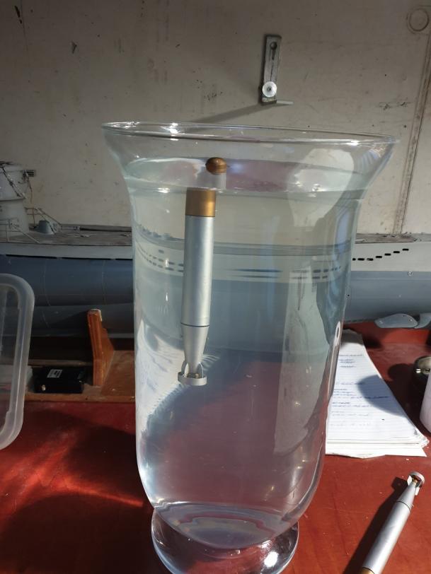

                First i trimmed some torpedo's, and made the maidenrun in the bathtub,
                They are all trimmed like this, giving me the garantee that they will not dive into the mud when fired, it will cost you some speed but they never get lost.

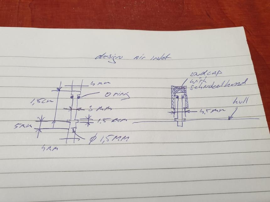

                Made a drawing what i want to build, a vent that you can close when the boat is used to the watertemparture, thus giving you the oppertunity to run her dynamicly underwater, a job for the lathe and some alterations on the boat itself.

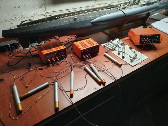

                First batch of batteries has arrived, waiting for the second batch, now i run all my torps on a 1s lipo, i had a blown battery with two, made the hunt for small NiHm cells. want to rebuild all torps with those cells, don't like the idea of having lipo batteries in enclosed torpedo's in storage.
                Lipo batteries on their own are safe enough to store them outside your boat, but the problem i ran into was, i keep the torpedo's most of the time in storage simply because you don't use them that much, they are enclosed tubes, managing those lipo's means, taking your torpedo's apart each time you want to service them.
                With NiHm cells i don't have that problem, simply charge and run.

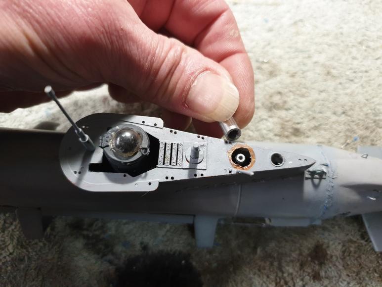

                  The inlet for the Seehund is done, batteries replaced inside the torps both for the type VII, type XXII and Ko Hyoteki are also done.
                  Click image for larger version  Name:	20240221_204408.jpg Views:	0 Size:	53.8 KB ID:	178716

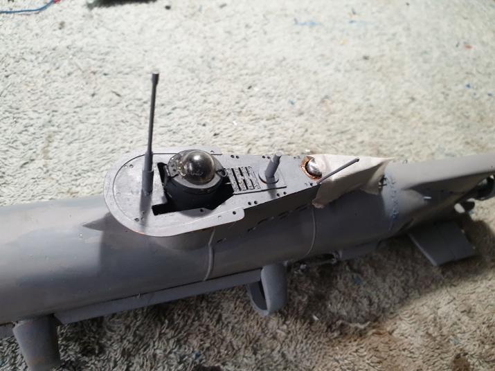

                  The turned inlet with the cap glued down on the Seehund, made a hole inside the deck to make this possible.
                  Click image for larger version  Name:	20240221_204435.jpg Views:	0 Size:	47.5 KB ID:	178717
                  Made a provision on the schnorkelhead to make removing easier, not sure if it will stay, i can allways remove it when not needed.
                  Click image for larger version  Name:	20240221_204718.jpg Views:	0 Size:	49.7 KB ID:	178718
                  The inlet tube is closed off by the cap, there is a little O ring present on the inlet tube which makes a watertight seal.

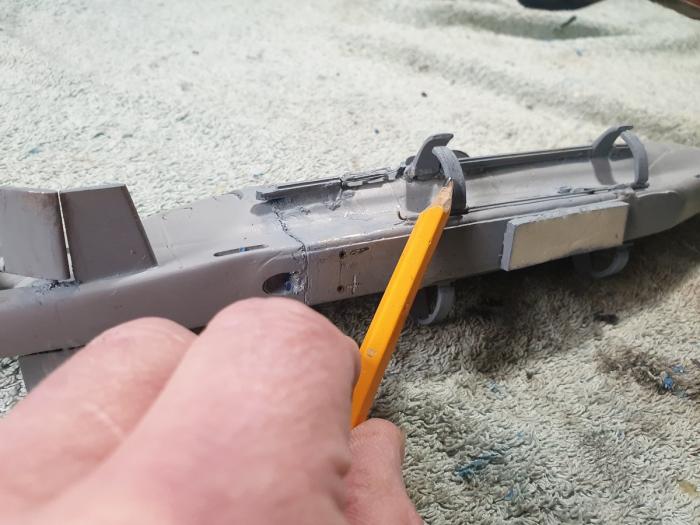

                  This was a bummer, after drilling the hole through the hull the Seehund didn't start anymore, opened her up, and yes offcourse i hit a wire, repared the wire and sealed her again.
                  In the background you can see the Marder which i allready started with, had to switch back to the Seehund for repairs
                  Click image for larger version  Name:	20240301_105814.jpg Views:	0 Size:	46.2 KB ID:	178721

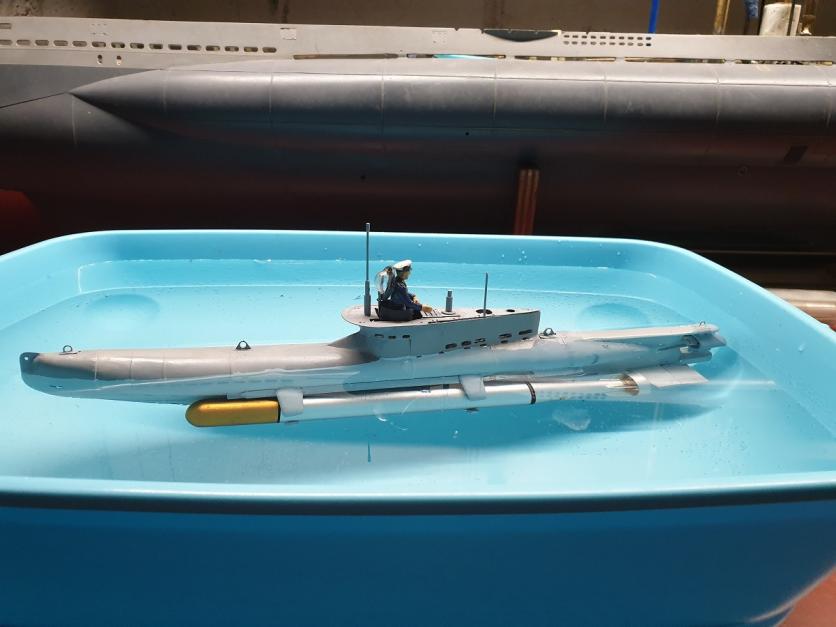

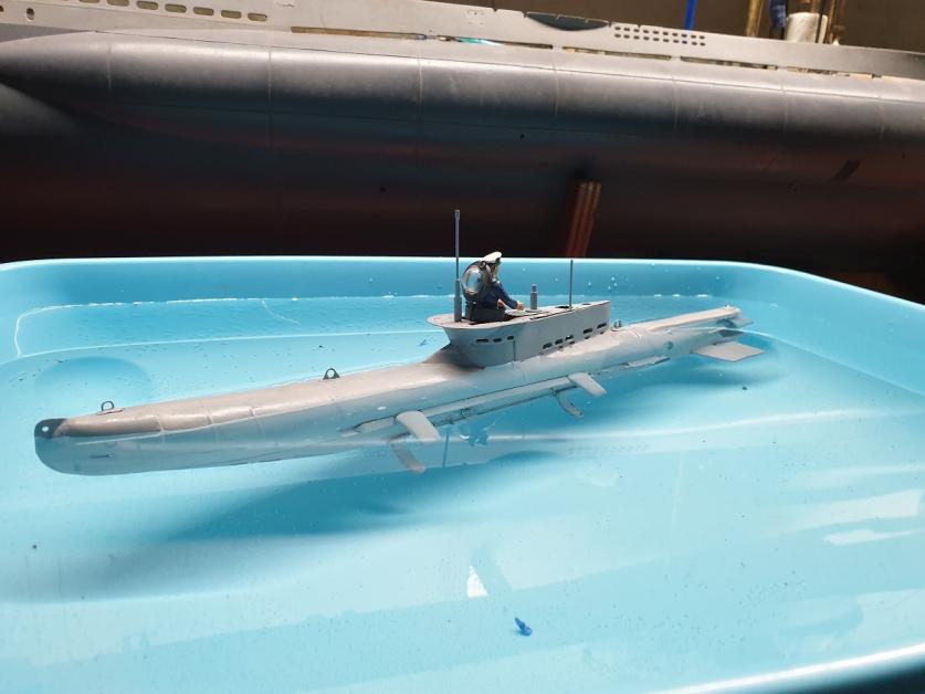

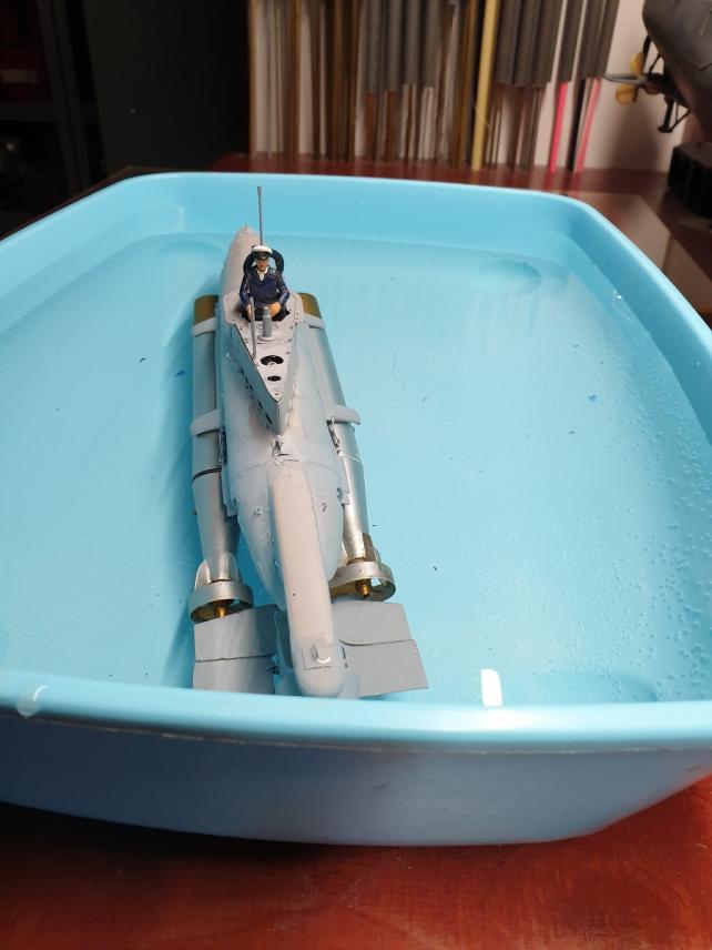

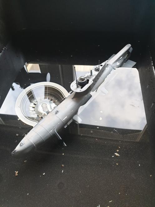

                  Testing if she is watertight inside a cat litter box, big enough to do some testing.
                  Click image for larger version  Name:	20240301_105823.jpg Views:	0 Size:	44.6 KB ID:	178722
                  Also did some work to get her straight in the water, added some lead and foam to get this right.
                  Click image for larger version  Name:	20240301_105917.jpg Views:	0 Size:	44.2 KB ID:	178723
                  Without the torps, in this configuration i want to see if she will be a dynamic diver, after that i will have a go with both torps attached.

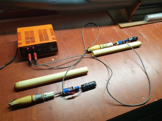

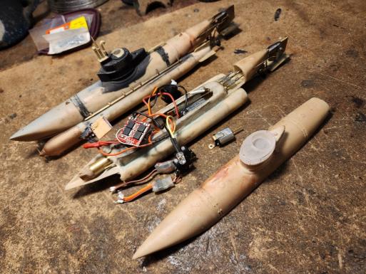

                  All batteries replaced on the type VII torps, did the same job with the torps of the type XXIII
                  Click image for larger version  Name:	20240225_143031.jpg Views:	0 Size:	45.1 KB ID:	178724
                  New batteries on the Ko-Hyoteki torps, they will run slower due to the lower voltage of the replaced batteries
                  Click image for larger version  Name:	20240226_154958.jpg Views:	0 Size:	48.7 KB ID:	178725

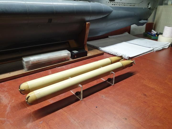

                  Made a stand for the torps to keep them safe at storage, some scrap pieces of lexan and some threaded rods, still have to add the rubber which will protect the torps when painted.
                  Click image for larger version  Name:	20240301_121656.jpg Views:	0 Size:	48.9 KB ID:	178726

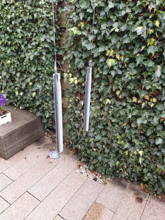

                  This week we had some nice days to spray some paint.
                  Click image for larger version  Name:	20240301_122145.jpg Views:	0 Size:	49.7 KB ID:	178727
                  For now they are inside the Cave to dry and harden, in the end they will be weathered.

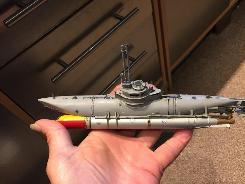

                            That is very nicely built. Quite a lot of detail added even beyond the Verlinden kit. I don't want to hi-jack your seehund thread but this is very closely related.
                            I had exactly the same idea your mentor had although he did it much before me. I used the Verlinden kit as a starting point and made fiberglass hull. At the time I didn't realize there is a Italeria biber kit in the same scale that would probably be a much better starting point. My first attempt (the one in the foreground) made it all the way to pool testing which revealed many problems. Too heavy, not enough buoyancy. Tiny servos too weak to move controls adequately. Geared drive motor too slow to actually propel the craft. I put it on the back burner and built another one using a small toy as you had done with your Marder and I had done with the tiny FS-1 flying sub.
                            That one actually works very well and has a working ballast system. It does not have moving control surfaces, instead it is propelled and steered by the propellers on the torpedo Click image for larger version
