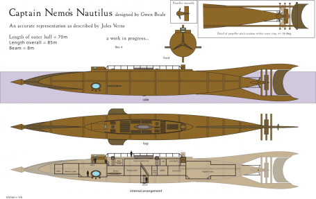

            Nautilus-Gwen.pdf Here's an update to the Nautilus drawings.

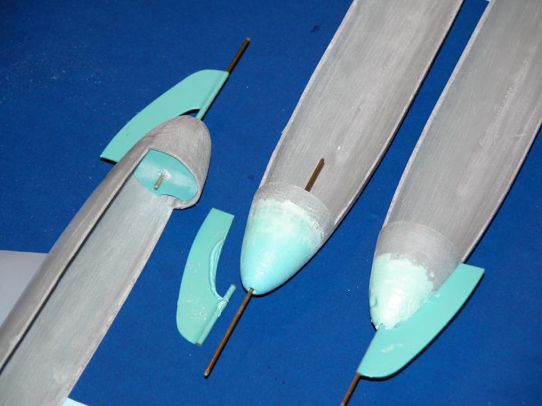

                  A skipjack hull would get you nine tenths of the way towards that hull shape. The bow would need to be a bit sharper in profile, you could achieve that with a simple scree tool and some polyester putty.
                  Demonstrating what Andy suggests:

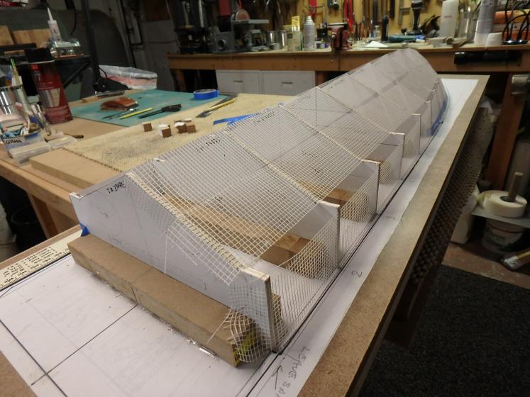

                    Hi Gwen, the type VII looks great! The Nemo/Jules Vern Nautilus is a great subject but I think styrene might be a little tough to work with...also I hope you are planning to remove the the station formers after the hull is built and stable. Those formers will take up a lot of precious internal real estate . Might I suggest a monocoque GRP hull in Polyester-I have found that I could do two to three layups in the time it takes epoxy to cure and at 1/2 the price.
                    In 2003, I built a 1:64 Cod by using plywood formers covered with spackling self stick fiberglass mesh from the big box home store (similar to the attached picture) in a crisscross multi layer fashion. It conforms readily to compound curves -then using a credit card and some polyester body putty lightly squeegeed (in thin layers) onto the mesh to produce a strong master. Then I used Ultracal 30 (Molding Plaster) to cast a right and left mold. This method is both cheap and easy. (LOL) -just another option​
                    Click image for larger version  Name:	P8120002.jpg Views:	0 Size:	66.0 KB ID:	167975
                    Click image for larger version  Name:	image_39049.jpg Views:	0 Size:	53.3 KB ID:	167976
                      That is, SLICK!!!! I'll file this trick for a future project I'm thinking of. Great potential with this trick, Bob.

                              Nautilus-Gwen4.pdf OK, here's the latest revision. The wheelhouse is now fully retractable. The portholes line up when it is retracted. I added a pair of vertical fins rather than the four arms to support the aft rings and rudder as well as provide additional protection for the propeller and more yaw stability. The rudder mounting ring was removed. I significantly narrowed and lengthened the dive planes to make them less likely to take damage. In order to make the changes to the wheelhouse it was necessary to lower the ceiling in the Salon. Click image for larger version

                                • 13980
                                The three strakes that radiate from the bow spike: make the top one extended as a cutwater terminating just in front of the wheelhouse front deadlight -- the tip of that cut-water level with the deck atop the superstructure. Planes make more sense now. Get rid of the external propeller pitching horns. That rudder is still vulnerable, recommend you put it down low in back of a skeg. That puts the rudder operating shaft internal at the stern with its linkage inside.
