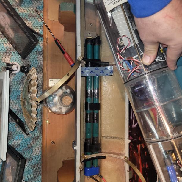

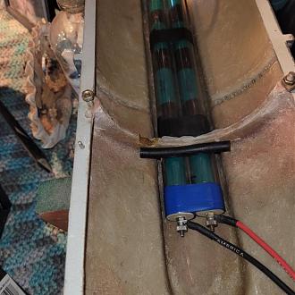

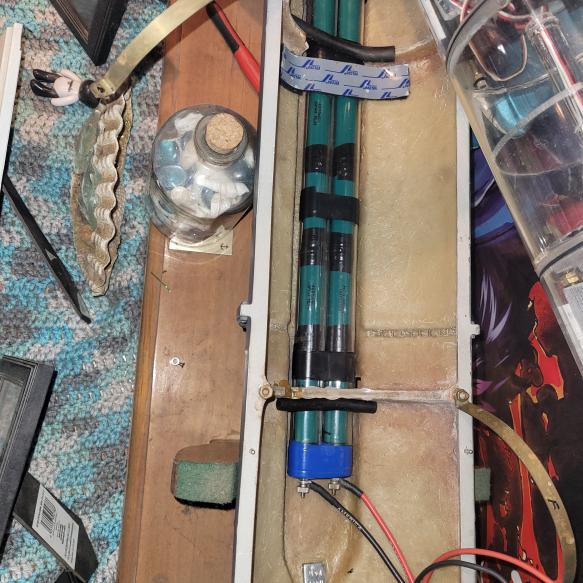

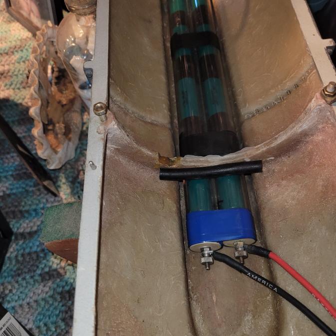

          Ok, now that I have satisfied my wife's requirements of rearranging the living room in preps for Christmas, and my daughters request of replacing the heater core in her Jeep, I could get the pictures.
          These are 10x 4000 mah Nimh cells at 1.2 Volts nominal each. They are arranged in 2 tubes, 5 cells each, bussed in series for a 12 v 4000 mah pack.
          The tubes are .75" id acrylic tubes from McMaster-Carr I believe. The endcaps are custom aluma-lite cast and have brass hardware threaded through them. The tie bar is machined .125" brass bar.
          Click image for larger version  Name:	20221118_083111.jpg Views:	0 Size:	63.8 KB ID:	166958Click image for larger version  Name:	20221118_083105.jpg Views:	0 Size:	73.2 KB ID:	166959Click image for larger version  Name:	20221118_083059.jpg Views:	0 Size:	72.1 KB ID:	166960
          You can see that the battery pack fits inside of the keel of the boat, and they slide under the wtc saddles. There is enough room to slide them forward and tilt up to pull the pack up. The battery is held down by velcro tabs under the aft end of the pack.
          V/r
          Tim
