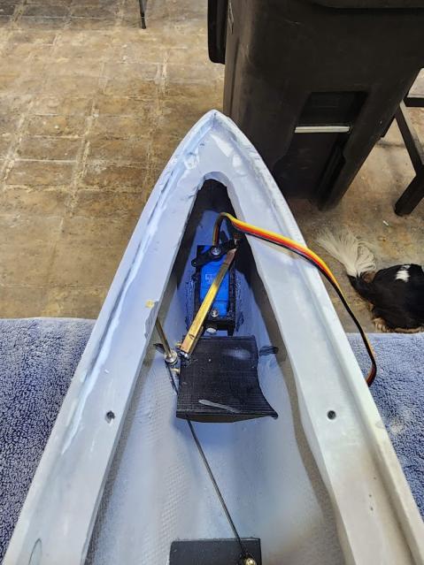

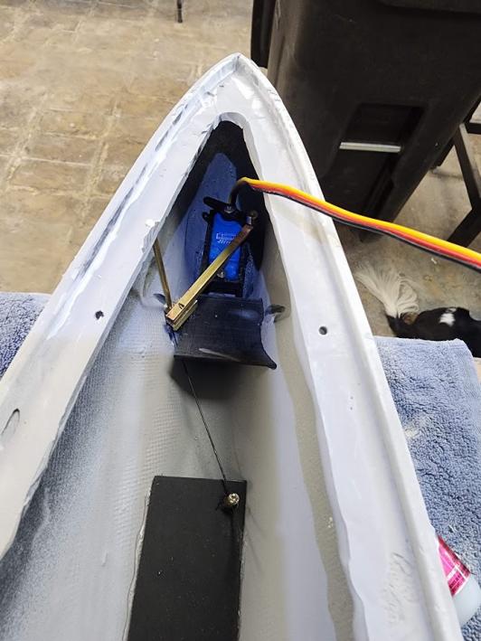

    I successfully engineered the retraction half of the bow planes. It uses elasticized cable and a pulley to keep inward tension on the planes. I drafted and printed servo holders for the two waterproof servos that will be used to extend the planes. The idea is that the extension arm is anchored on the rear half of the servo horn while the forward half has a pin that presses against the arm when the servo swivels. In this way, the arm is under tension when extending, and rotates freely when the opposing plane is actuated.

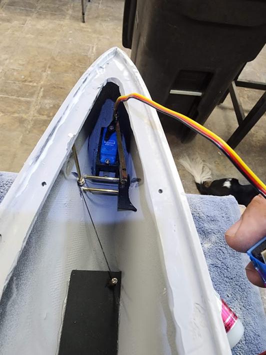

      Success!
      Honestly, the forward linkages were a mental stumbling block for me, and part of the reason that I kept putting this project on the back burner, which is unfair to Steve, who commissioned the build. Happily, I pushed through last week and successfully integrated two waterproof servos and the sliding retracting bow planes into a functional system.
      The bow planes slide in and out of a pair of brass rails. Inward tension is achieved via the use of a high-strength elasticized cable. Extension force is applied via an arm actuated by a waterproof servo. The arm is anchored on the far end of the horn. As the servo spins, the arm pivots about the mounting point until the horn itself is encountered. The arm forces the plane outward, sliding on a brass channel. Moved in the opposite direction, the servo horn rotates, but the arm simply pivots without movement as the opposing dive plane is extended.

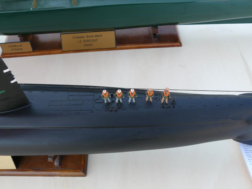

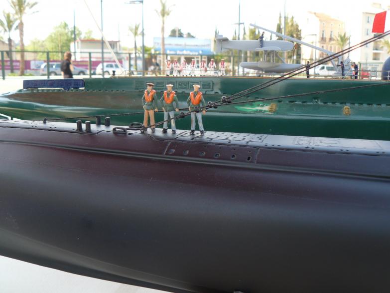

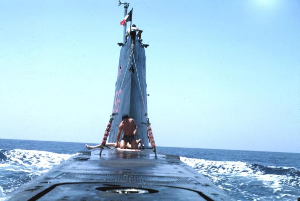

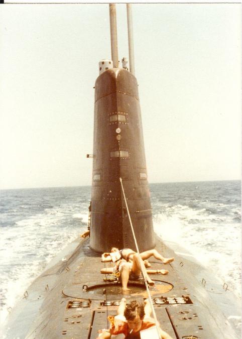

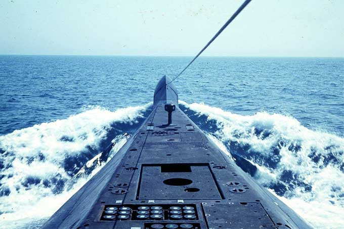

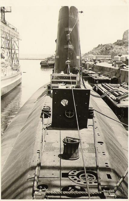

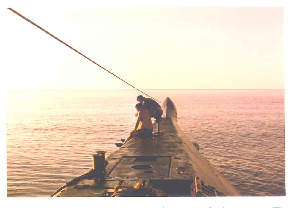

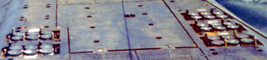

        OUTSTANDING BOB! I deliberately stayed away from this web site for a while & just hoped I didnt upset anyone. The hull looks so beautiful now and the bow plane mechanism looks simplest and very robust like the rest of the hull.
        Sending you every photo I have of anything showing the uppr decks close in Since emails seem to not be working, posting every deck photo I have collected for years. I probably have bout every photo in the public area on these boats. Hope these help. Posting here instead of emails for down load.
          • 939
          #34
          Click image for larger version  Name:	Md9TMg9.jpg Views:	2 Size:	64.4 KB ID:	170655Click image for larger version  Name:	Terdgqq.jpg Views:	2 Size:	31.0 KB ID:	170656 Sending all deck photos i have.
          Click image for larger version  Name:	3furz0u.jpg Views:	0 Size:	58.4 KB ID:	170658

                    Excellent. Exactly what I was after. I'll have to rig up some kind of drawing, extrapolating the info from the photos in order to make a scribe plan of some kind.
                    Bob
                      • 939
                      #40
                      Bob
                      Sent you 1/32 scale detail drawings with the model parts long ago. Still have? If lost, i'll happy to rush you copies Bob? Thank you .
                      Steve
                        • 2041
                        #41

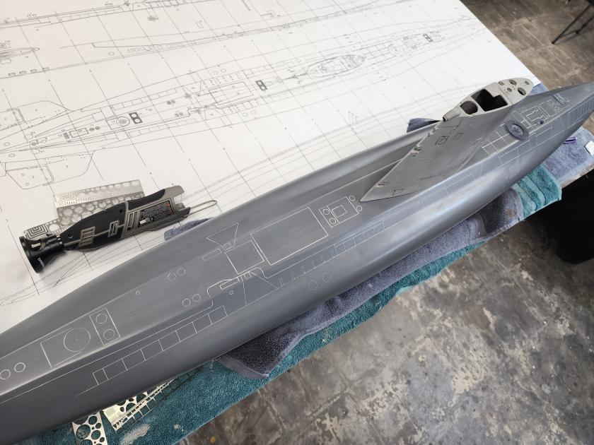

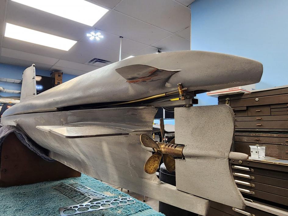

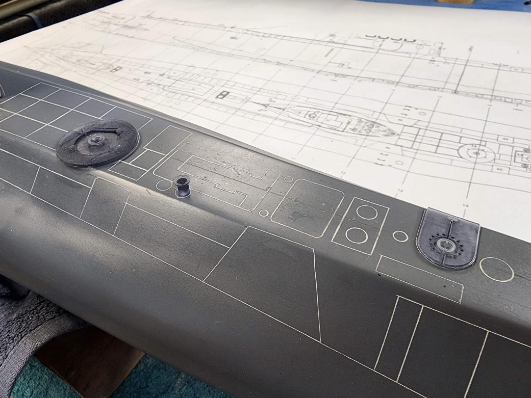

                        I'm putting a push on this project to get it finished by the end of June. Hull scribing is taking place now. The supplied drawings are great, but don't seem to match up to the photos that Steve supplied above. I'm doing a mashup of the two to best fit the model.
                        Rather than simply scribing the hull, I'm including a lot of 3D details, including hatches, recessed areas, etc. This should really lend realism to the completed model.
                        The rear rudder linkage needs to be redone. I did not properly allocate the needed room when I did the first iteration. I'll have to switch to a very narrow setup, likely a belt/toothed gear assembly.

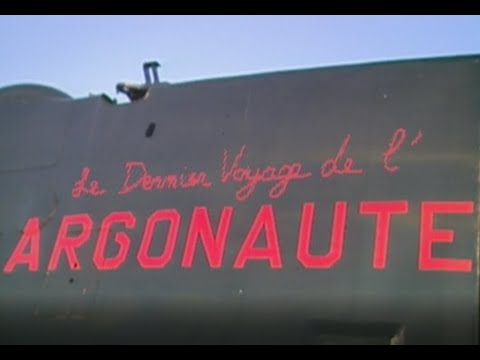

                            Here is a French documentary on You Tube about moving the Argonaute Hunter killer submarine inland to its present display at the Paris Science Museum.

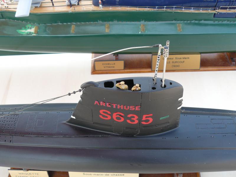

                                Bob has a New video in his weekly series. The radio tests successful Confident of operation. Featured among many subs in thi latest video on you tube is the Argonaute. S636 of the Marine Nationale (French Navy) Operational from 1958 to 1982). I'll let Bob carry on with his comments and imput. .The video above I was surprised & pleased to find. I do not know French & I just use certain key search words and thing begin ot appear. 'Argonaute', 'sou marin' , etc.
                                Here is Argonaute in her new paint and markings on July 15. The unusual bow plane arrangement was 'surprisingly effective' Bob reported.
                                62 inches long, 1/32 scale.
                                Source of model image Bob Martin.
                                Steve
