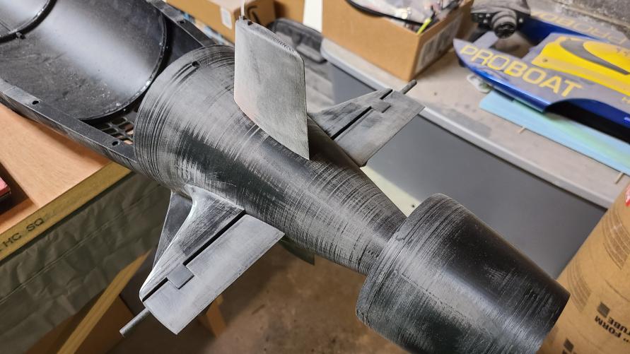

        The corrected stern planes.

          #34
          Seawolf runs split stern planes in a tips and flaps configuration. The inners are the smaller flaps like the original and with the outers, the whole tip of the chord rotated. The Trumpeter model in
          s inaccurate in that the planes go full length.

            #35
            Good to know. Not quite sure I am following you though. Do you mean like this or something different?

              #36
              Here is a diagram

                #37
                Are the flap and the tip actuated separately? Do they move differently?
                • SubDude
                  • 825
                  #38
                  Here is a diagram
                  Thank you for the diagram. That is what I thought you meant but something in my brain was saying NO! For real?!? Did the flap and the tip work in unison?
                  • SubICman
                    • Jun 2022
                    • 87
                    #39
                    As far as I know, yes. I never got to drive a Seawolf, so I am not familiar with if they could be operated independently or not. I suspect they are similar to how the split planes work on a Virginia.

                        #41
                        I don't know this for sure. But, if you want to dampen out foil-roll and snap-roll induced banking (sexy looking but a big ship control issue), differential use of those outboards would be of some assistance, even though their moment arms are short. Such use would put a hell of a 'knuckle' in the water -- so much for stealth.

                          #42

                            #43
                            Dave with the win on pics.
                            The newer ship control systems could handle it, but i do know that the dihedral surfaces do dampen out the roll and snap phenomena so no need to operate the split planes as such.

                              #44
                              David, did you use a single pivot rod for the surfaces or two? I see what looks like both ways in your pics. The finished model has two but one pic of the raw parts appears to show just one and a support 'tooth' or whatever it's called extending from the fixed horizontal plane?
                                You're spot on, sir. The larger 1/96 model had the room for independently operated stern planes -- one set inboard, the other set the full-flying outboards, each set with their own operating shafts. The smaller 1/144 model only had room for a simplified arrangement which ganged the inboard and outboard control surfaces on a single operating shaft -- a cheat.
