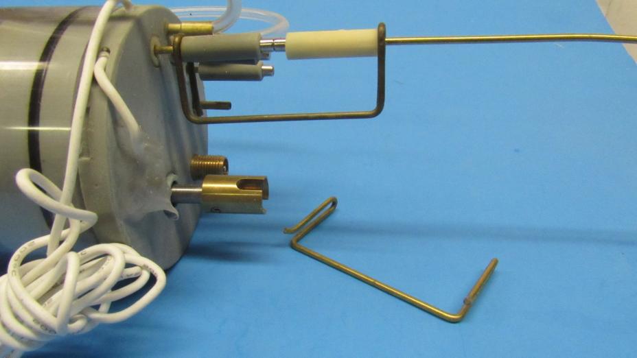

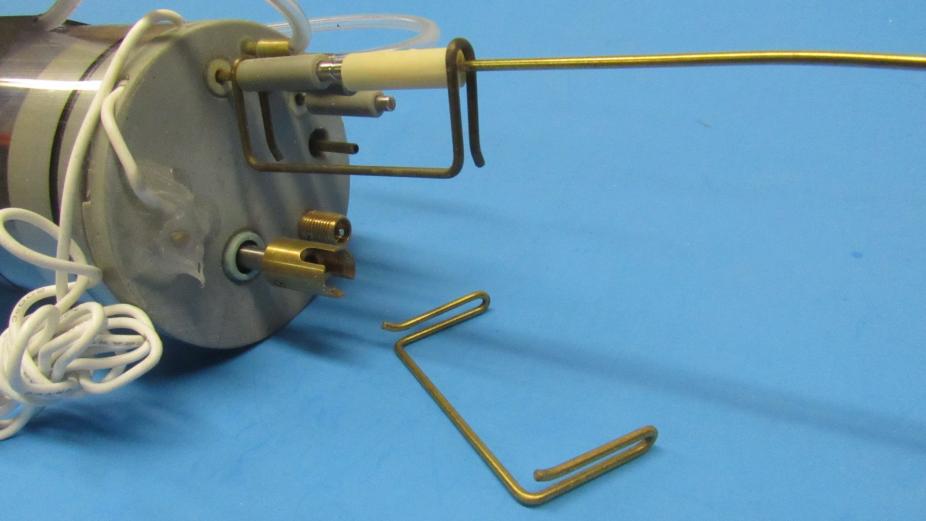

                      When the stern planes are at full rise the two magnets are separated by 1/32" but they do come back together when the servo moves back. Should I have any concerns for this or is it ok? They stay close together by the attraction of the magnets like they are still trying to get back together.

                        From 1/16" brass rod bend a U-shaped retainer that you slip over the ends of the resin magnet foundations. This will keep the control surface pushrod from dropping away if the magnets are pulled away to a degree where the magnetic attraction is lost.

                          • 3746
                          David shows the simple solution to magnets pulling apart.
                          I did a 3D printed version that did the same thing.
