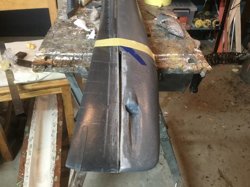

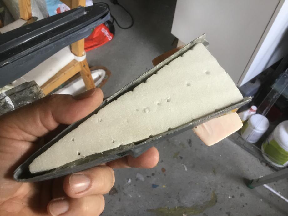

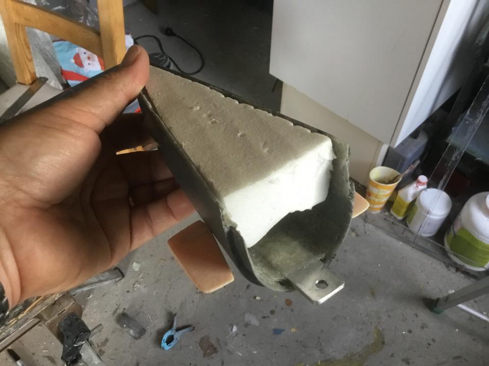

          The lower bow section needs to be joined to the upper hull. Firstly however I sculpted and shaped the foam that would go in the front section just below the waterline. I glued this in after having fixed in the aluminum attachment plate. I aligned up the bow section and also the rest of the hull was clamped securely to the top and bottom hull to check how they have all been aligned and then cut some narrow strip of glass weave and glued up the two halves.
          The curve at the bottom of foam is to move the air bubbles in to the center of the foam and then up the holes drilled along the middle. I have already been playing around with the Foreplanes.

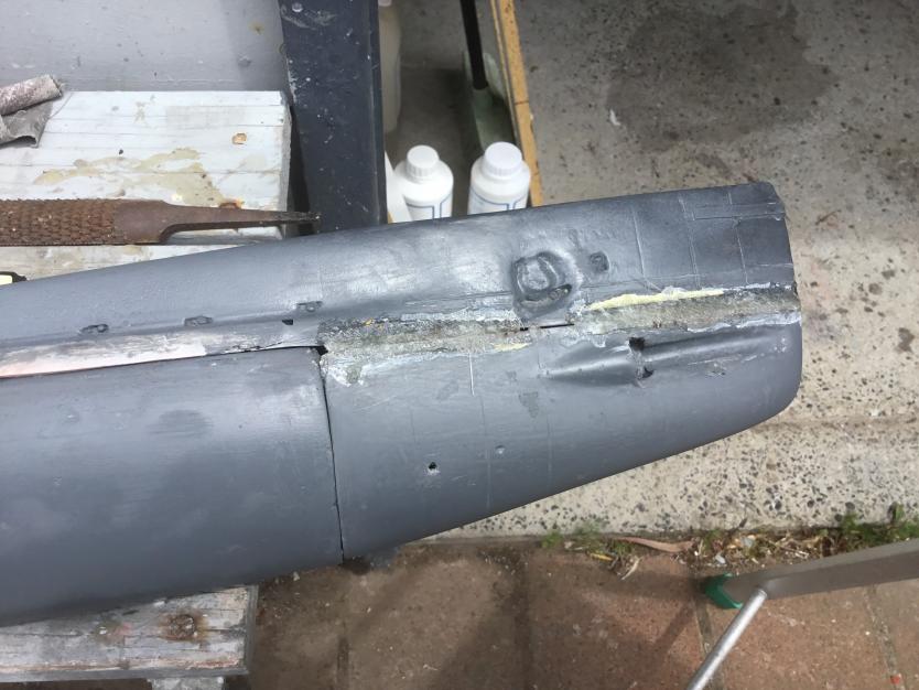

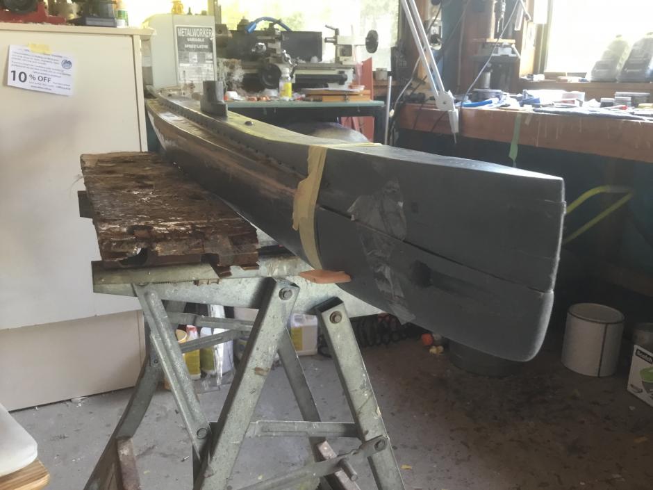

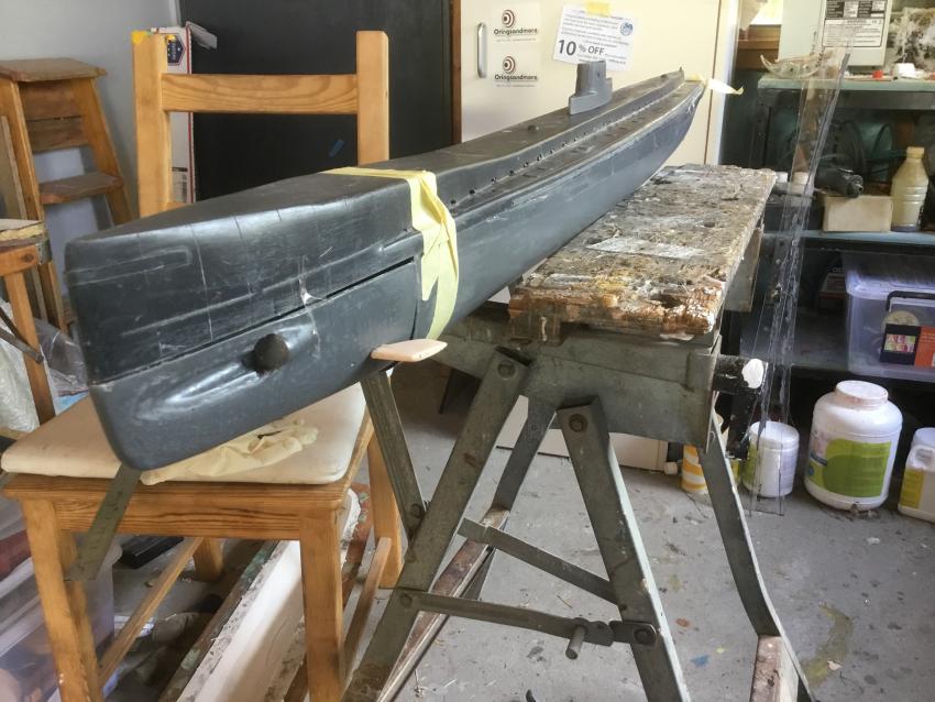

          Below pic shows the hulls taped together. Before I did this, I pressed sticky tape down along the flat rim of the lower hull. I then pressed and taped the top hull down and then pressed filler into the gap between the two hull. The filler will stick to the rim of thr top hull and create a tighter seam line between the two hulls.
          The stick tape was pressed down along the sides of the lower hull, this means that any filler on here would lift off and the only filler left would be on the top hull and sanded flush.

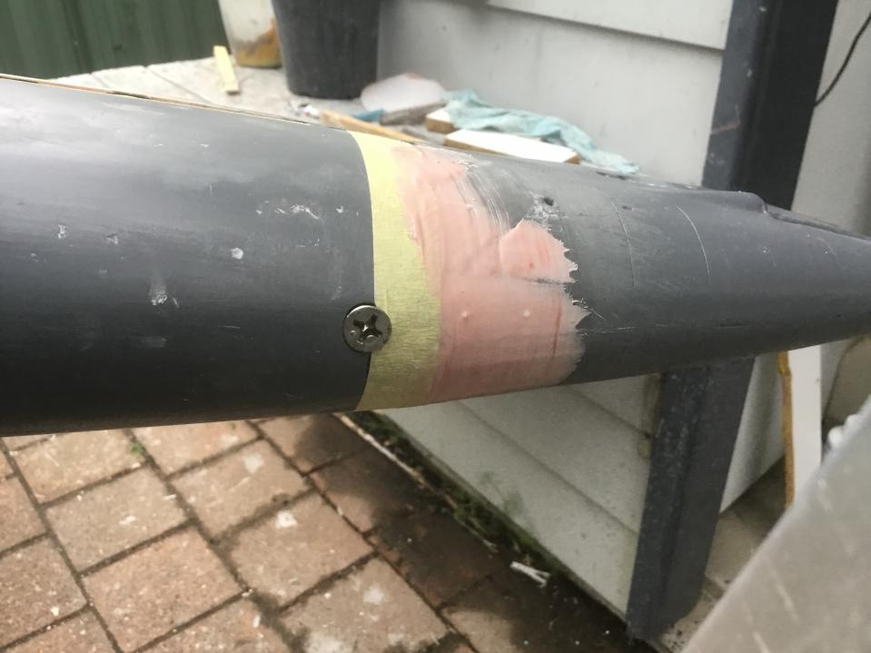

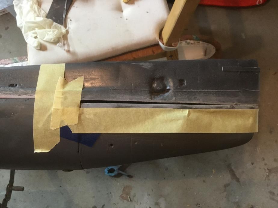

          I taped with masking tape the areas around the joint areas. I also screwed down the bow lower and main hull to help with alignment.
          Glass weave laid down. The gap was where the clamp was. A lot of sanding back. Reinforced form the inside too.

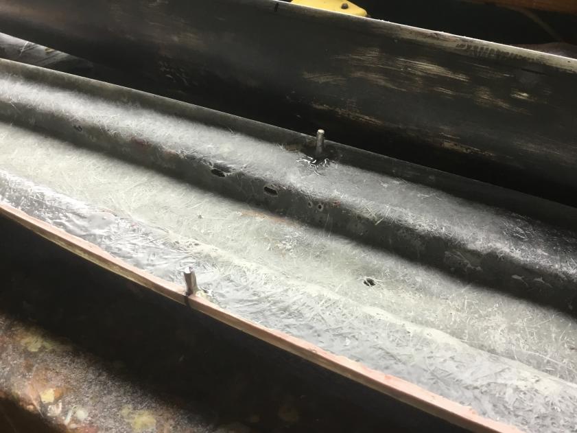

          After the font section I then looked at how to secure the top and bottom hulls together. Because thr top hull is mostly flat the way I secure the two hulls will be different. All my previous boats have had round hull sections and the so the use of a lip that slides inside another was quite realistic. This hull with its mainly flat decks won’t really work plus the use of the rim or flange along the top of the lower hull means a different approach. I decided to use stainless steel rod to create drop lugs that will drop into slots in the lower hull.
          These were epoxies into place and then had some glass reinforcement. I had to create a slot to accommodate the lugs as I need to drop them in place and then slide them forward for the front lip to push in under the bow. Below, the filler creating a level lower rim on the upper hull.

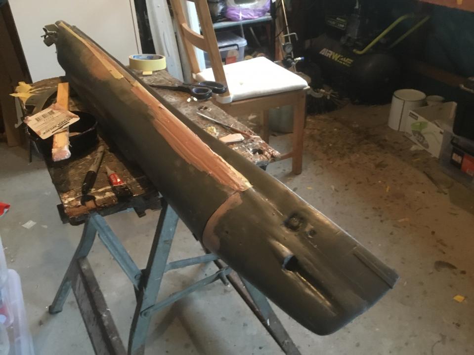

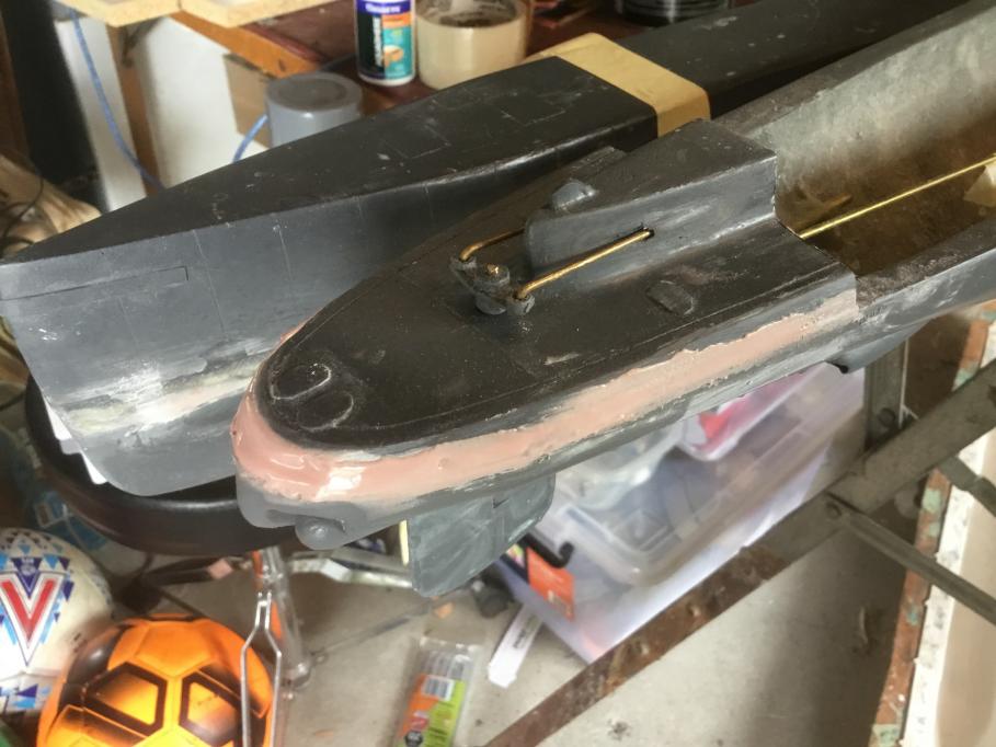

          I then returned to the bow section and after attaching the main hull and top, I realized that there was a gap between the lower bow and main hull. So I then did a similar thing as with the main hulls in that I masked off and filled , screeding smooth the filler and then resanding.

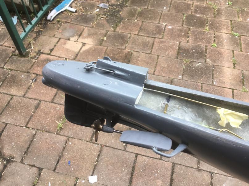

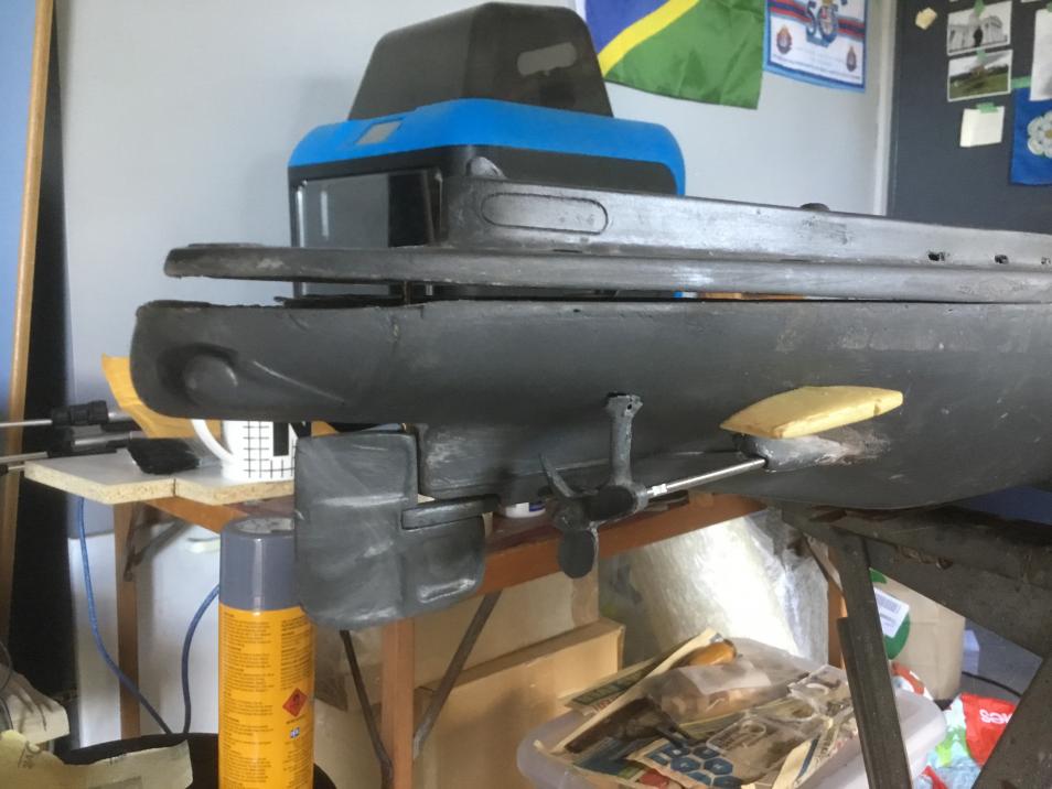

          Back to the stern, I started working out the arrangement for all the stern bits. The glands, shafts, props, brackets, rudders and planes. The small parts needed sanding down after coming out of the molds. A little bit of filler here and there. I also had to make sure that the alignment of each piece corresponded with its opposite. Very happy with the alignment of the notches and dimples In the mold.

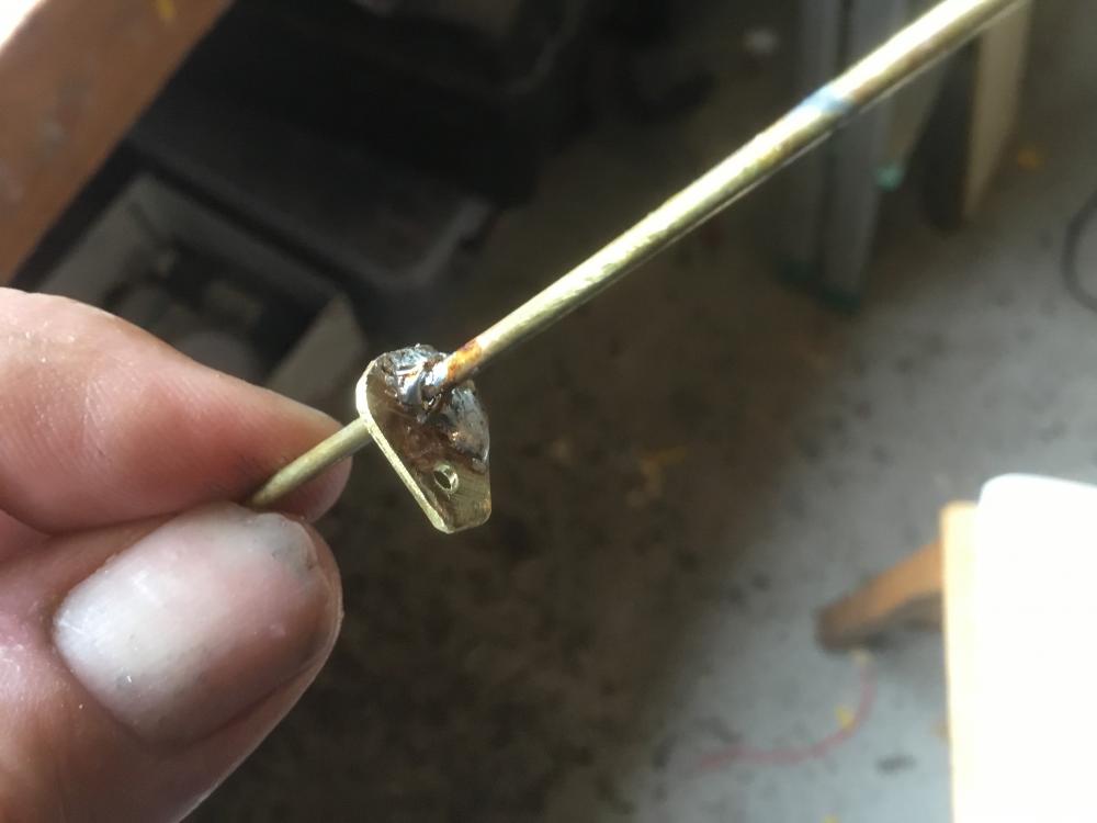

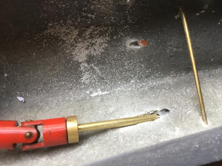

            The shaft exit points will feature embedded brass shafts that will be glassed down at the transition point between the inside and outside of the hull but wont extend through the gland as such. I needed to use a small file to widen the area for this shaft tube to be fitted. As can be seen the location for the stern planes and the relevant shaft is already in place. These will also feature small brass shafts to reinforce their position and stop ware on the hull wall.

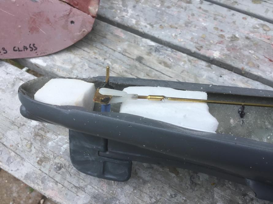

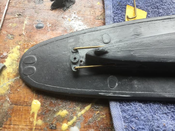

            The first bit of stern hardware to be glue in place however would be the Rudder and then rudder post at the bottom of the transom. This was a small cast urethane piece that holds the rudder in position. (It sits in the step in the below pic) I needed to then start sanding around the rudder support area and also make sure that the rudder itself is presentable. The rudder shaft would extend up through the top of the upper hull just before the raised deck starts. It will be terminated in a push rod mechanism that was used on pre-war U boats. This mechanism has been discussed earlier. By installing this section I could then glue the top Upper hull to the lower stern section and complete the hatch arrangement for the whole boat.
            The Rudder would be secured by a small brass tube that sits just above the top of the rudder (seen below) and secures the shaft in place before it extends up to the push rod system . In between these two components there is a push rod horn that is made of brass and is soldered in place and this is the actual push rod mechanism of the rudder. The above deck one is purely cosmetic.
            Here you can see the rudder post in place with holes directly aligned for Rudder shaft. Stern glands in place. Divits and holes can be seen for the stern plane guards , hole for the stern plane and the locations of the two attachment points for the shaft brackets.
            Once all this was done all I needed to do was to glue the rudder in position. Tricky to glue as you need superglue in some parts of the shaft and rudder and not others. Superglue along the main section of rudder and a trough of lanolin at the bottom of the rudder. I had earlier made up the brass push rod. This was soldered into position and given some extra encouragement to stay put with the use of some black cotton thread and superglue. A throw over to me Gliding days. A very secure means of attaching push rods. Topped off with some paint. As with the bow i have added blocks of foam int the areas that I will soon not have access to. Note the brass rod sticking up for the fake push rod mechanism.

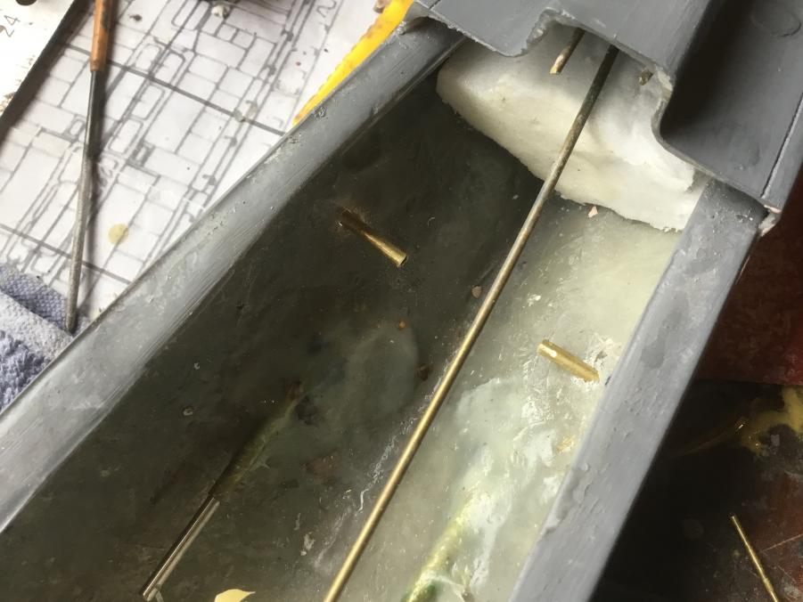

            The push rod mechanism needs two inlet points on both sides of the raised stern section. This area is outlined on the side and simply needs to be cut out. Once cut out and filed then the inserts can be placed. These tiny inserts need to be drilled and filed out before two small brass rods are mounted. The push rod head is also cast and it features three holes, the main pivot and the holes for the brass shafts either side.
            Till next time...

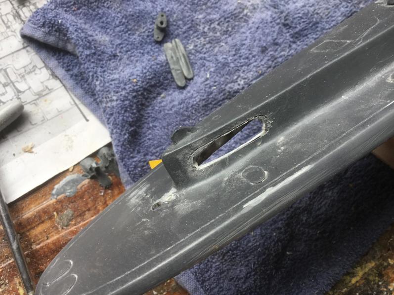

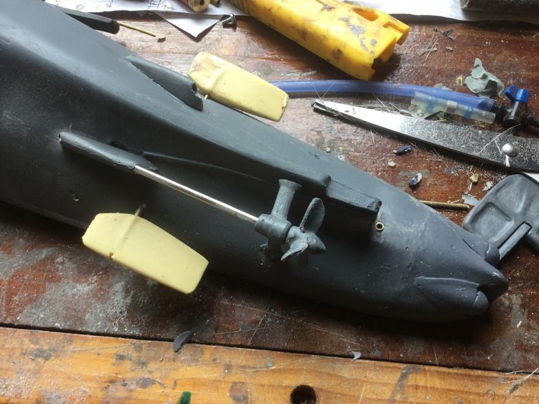

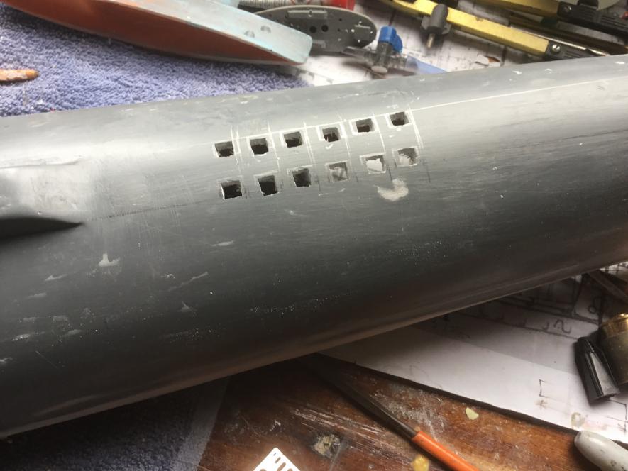

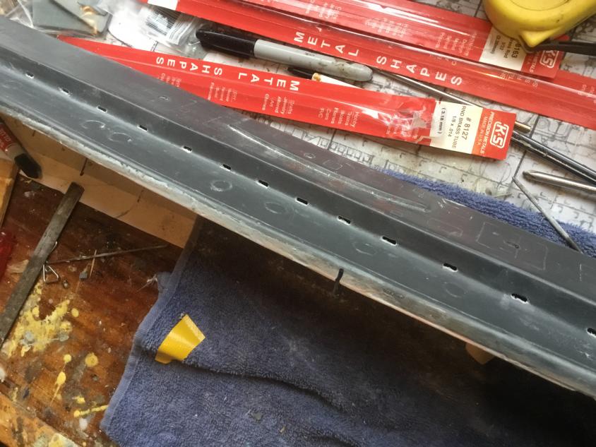

              At this point I decided to work on the ballast hull vents. I have virtually no information on the location of Ballast tank vents on pre-world war one U-boats. As a result I have effectively had to guess what these vents look like and where. I have looked at photos of washed up U-boats on the English coast line and such however have only had fleeting references to where these vents may be. As a result, the placing of these vents may very well be out and this is the reason why I didn't scribe any vent detail into the hull masters.

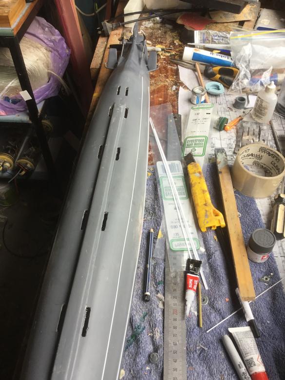

              I went with long vents along the sides of the keel and will drill small holes in the bottom of the Keel as this is where water will undoubtedly pool.

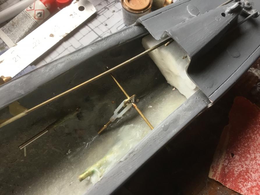

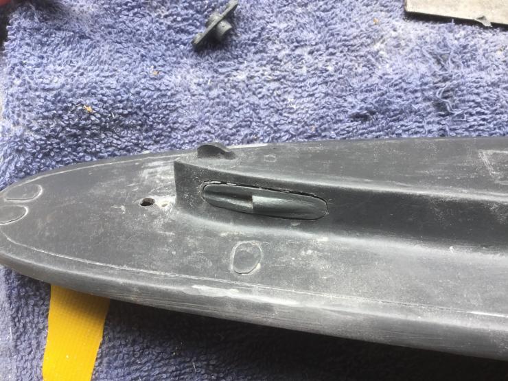

              Back to the stern, I now created the brass push rod horn for the horizontal plane. This brass rod simply fits between the two planes and is uninterrupted. (yes!) I cut out two small brass sleeves to were glued into the sides of the hull to give support to the shaft and make sure that over time it does not wear into a larger hole. I cut out a small rectangular piece of 2 mm thick brass sheet to make the horn. Drilled the appropriate holes and like the rudder horn, soldered it in place and painted over. The clevice will be a plastic one.
              Above the stern planes is the brass push rod for the rudder. The dummy brass push rods are evident sticking out the front of the cut. One 3 mm shaft is in place. The Sleeves have been glassed over.
              Brass sleeves about to be glassed in place.

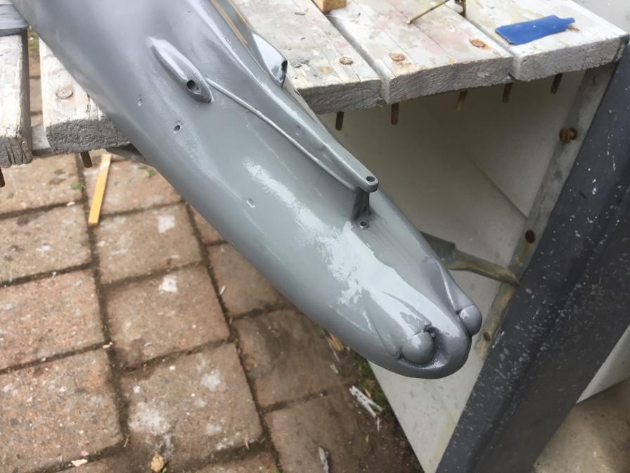

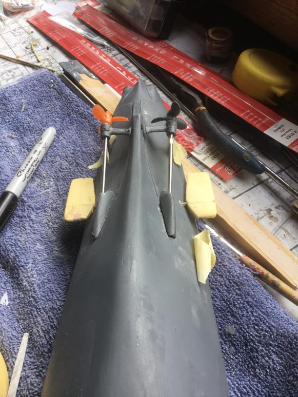

              The rest of the stern section is pretty easy and just external features. The stern plane guards needed sanding and then filling, sanding and then the shaft brackets also needed the treatment.The brass shaft for the stern planes stopped just short of the outside of the plane as the guard would stick into the plane just a mm or two.

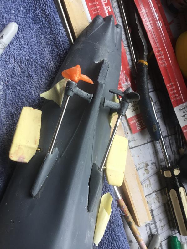

              The propellers were given a coat of brass enamel.

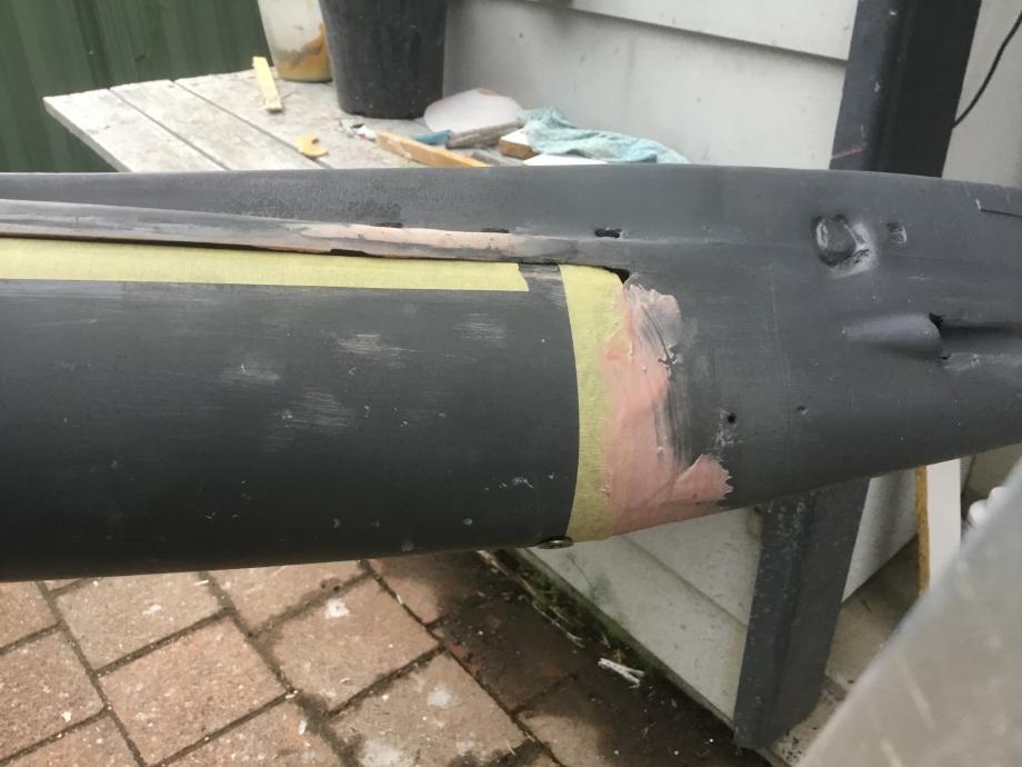

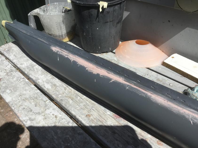

              Still more fine filling and sanding to be done especially around the joint between the top and bottom hull halves, but getting there.

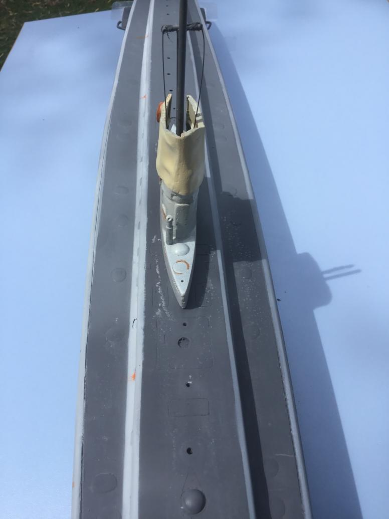

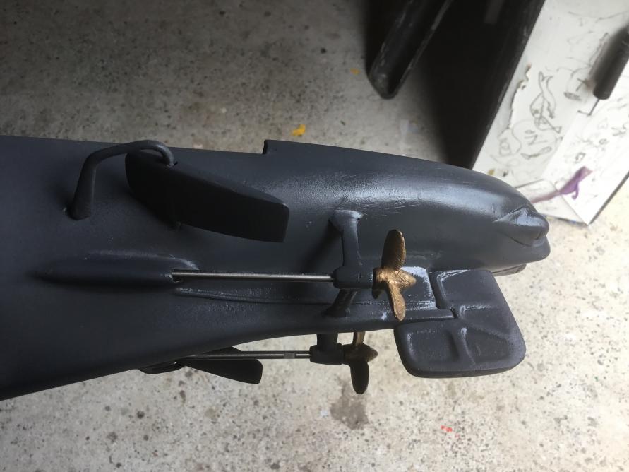

              I will be giving a coat of a Matt finish, here the stern is seen with a still wet coat of primer. This primer is actually very close to the actual colour used on these U-Boats.
              • Davidh
                • Nov 2010
                • 719
                #157
                Hello all,

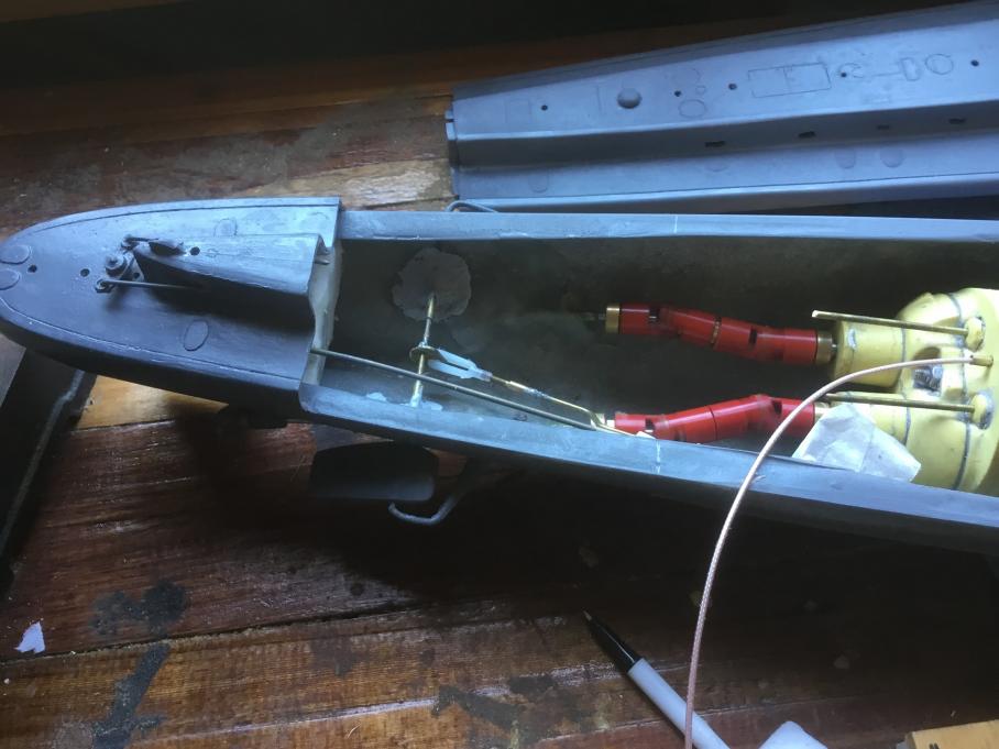

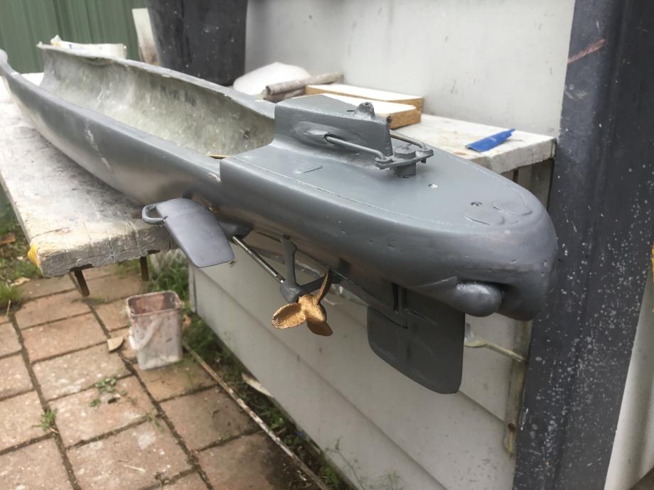

                The stern is mostly done, all the components are in place, the rudder and the prop shaft all turn. Now starting to look at the internals and the arrangement of the all the internal components and systems. As with all my boats I use a Ballast system that is well known particularly in the UK and that is what is (I believe ) commonly known as the "Sheerline' system. This system uses a pressurized ballast tank where water is forced into a tank with no escape for the air. The pressure is maintained and then used to force the water out. My cylinders use a simple 12v water pump that is externally mounted with a separate isolated Ballast tank that is as far as I know an Australian modification. ( All other designs on the market that I know have the pump internally mounted to an internal tank.)
                U-23 will have the Ballast tank slightly forward of the C of G. This is unavoidable because of the amount of space needed for the drive shafts and push rod linkages pushing the Cylinder forward and then the Ballast tank forward as well. I am not concerned as this was a concern on the PAPA and that boat performs beautifully. Forward of the Ballast tank will be the 12 v SLA and then foam. Initially I played around with positioning and location of parts and systems with an eye to looking at making sure that I could get access to everything but also thinking about trim and buoyancy.

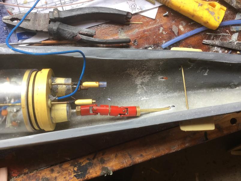

                Here I am still building the insides of the ZB-1/2. This one will feature a Ghz receiver set up.
                I haven't set up the push rod connections yet....

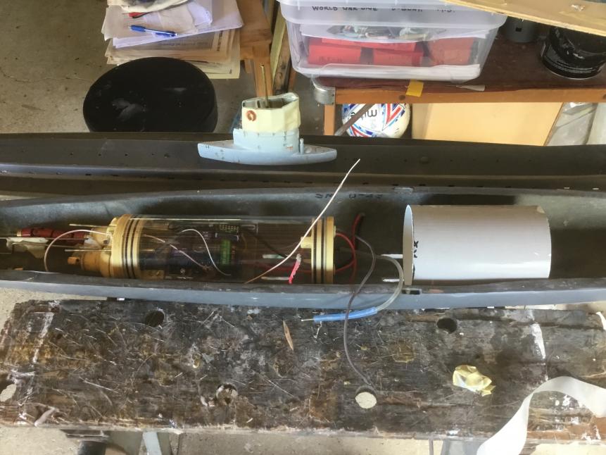

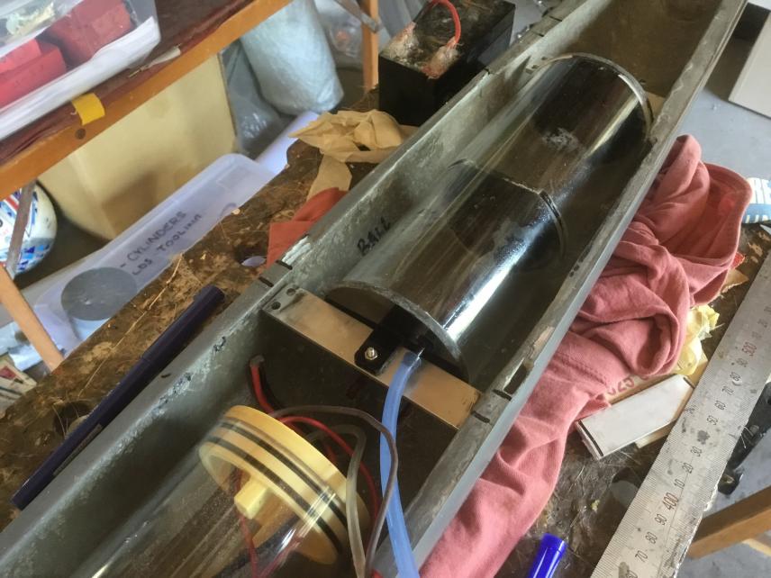

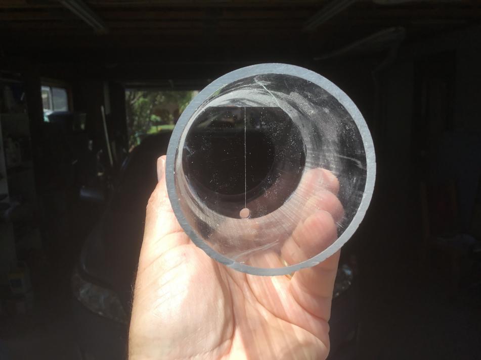

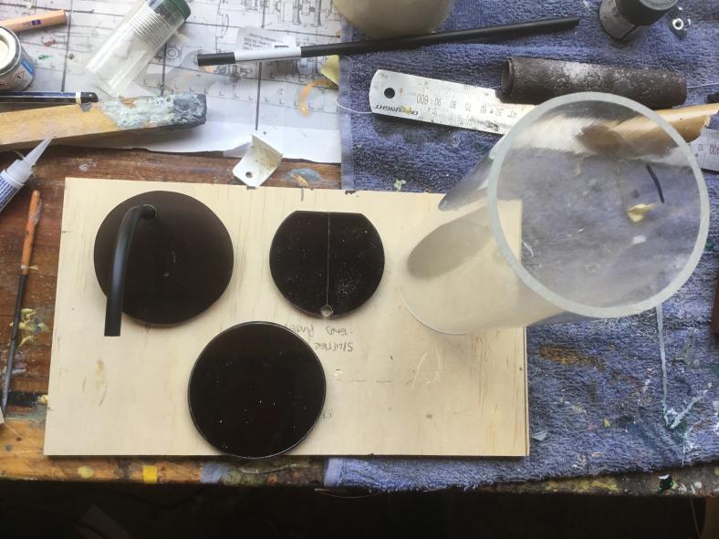

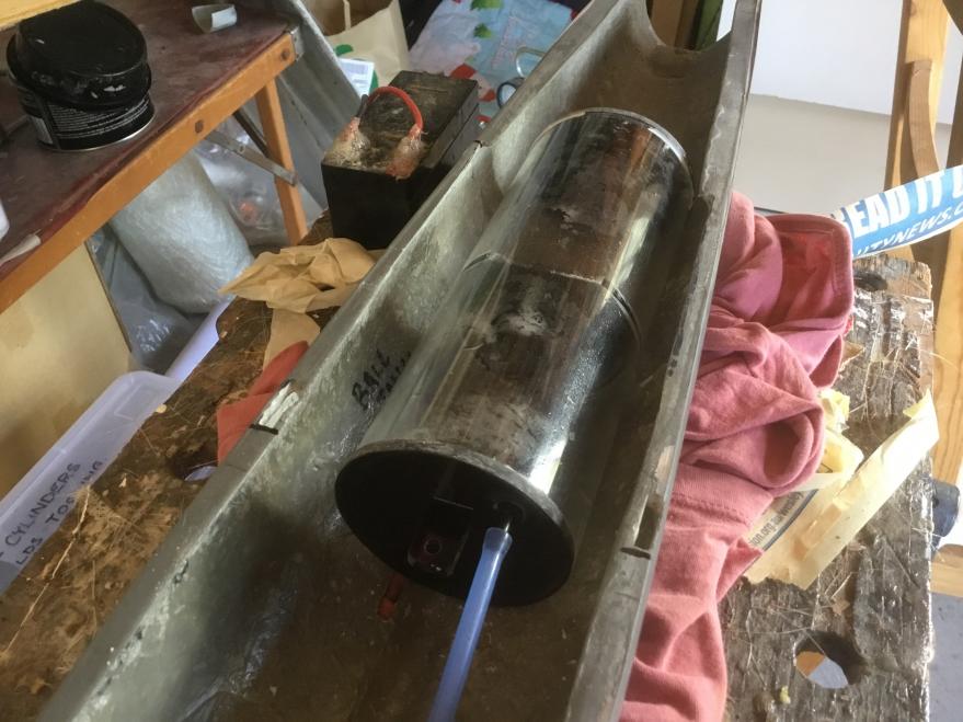

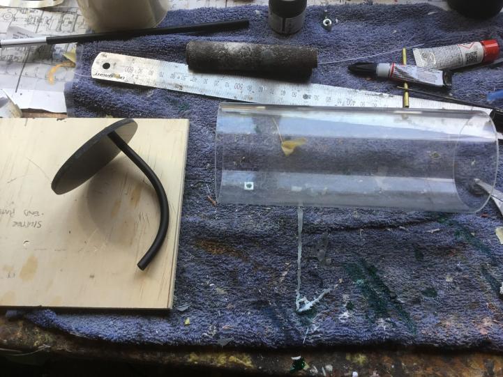

                I usually make my Ballast tanks out of PVC pipe. From the start I was kind of entertaining the idea of creating a period type ballast tank and making one out of Brass sheet with soldered sides. Kind of make it look like it was made in 1913, however the effort and detail required was out of my league and time. So I simply went ahead with the PVC pipe. I wanted to heat up the pipe and make it a similar profile to the hull shape with a reasonably flat top section, this would mean I could produce a wider large capacity and yet as a result, shorten the length of the tank to bring it closer to the C of G. However in doing so I would not be able to use a standard PVC end cap. I would have to fabricate one and make it stand up to pressure. This caused a drama as it kept popping off under pressure. I then looked around and found an old Acrylic pipe from one of my old Cylinders form years ago and decided to make a Ballast tank out of that. This is nothing new, acrylic ballast tanks work well ,just make sure they don't crack.
                End cap with curved pick up. The curve comes out of my deduction that an abrupt change in direction may slow down the rate of flow? I cut out one Baffle for the middle. And then another end cap at the other end with a horizontal bar on either end to bolt down to an Aluminium cross piece at either end.
                Middle baffle small hole at bottom for flow in between chambers and gap at top for air movement.
                Aluminium cross braces that the Ballast tank will bolt down to. Yet to be glassed into place.

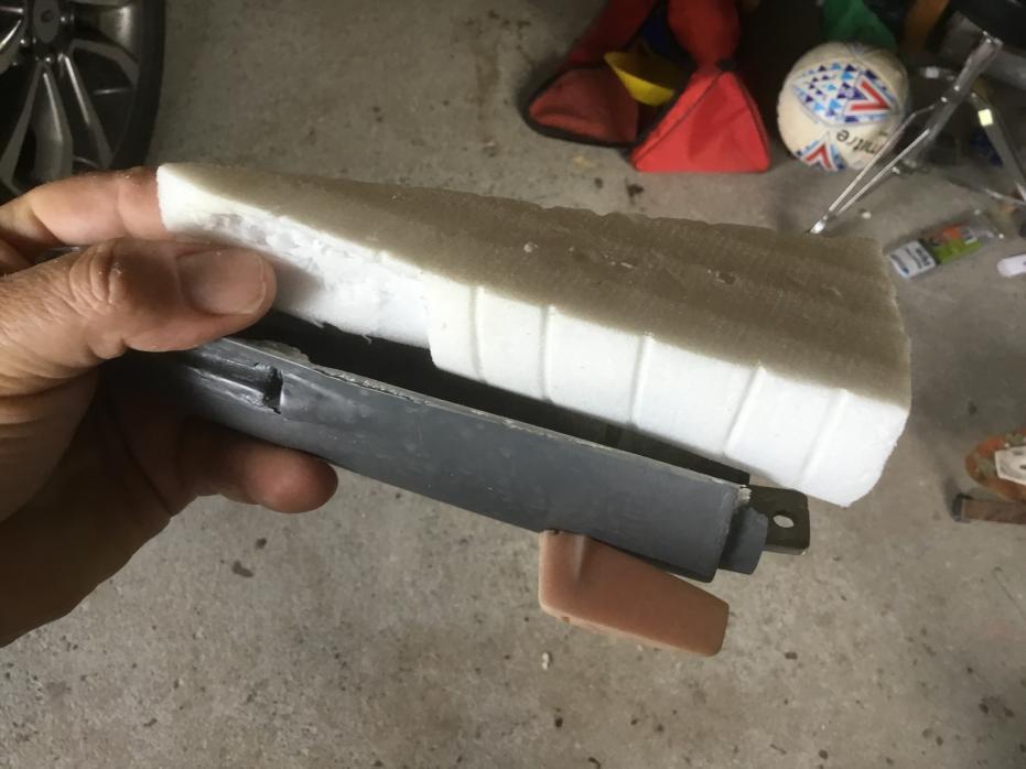

                This photo shows the Ballast tank installed. I carved a chunk of surfboard foam by putting a hole in to big enough for a 12v battery. Wow a clean desk....

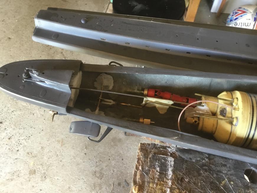

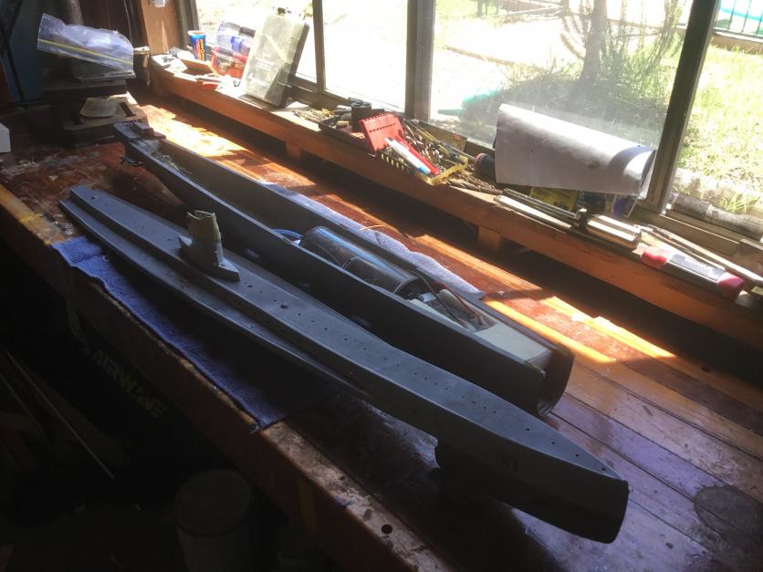

                The ZB Cylinder has been secured in place by being wedged between buoyancy foam around the sides and a rubber band strapped over the top. The next major steps are mainly cosmetic and comes down to the fun part, spraying and painting. These U -Boats were mostly two tone, two shades of Grey. There was also the light tan color of the Canvas. To get an idea of what these colours where I looked at the colour scheme of the ' Das Werke U9 " kit. Hey , they may as well be use full sometime. I decided to go with these colours.

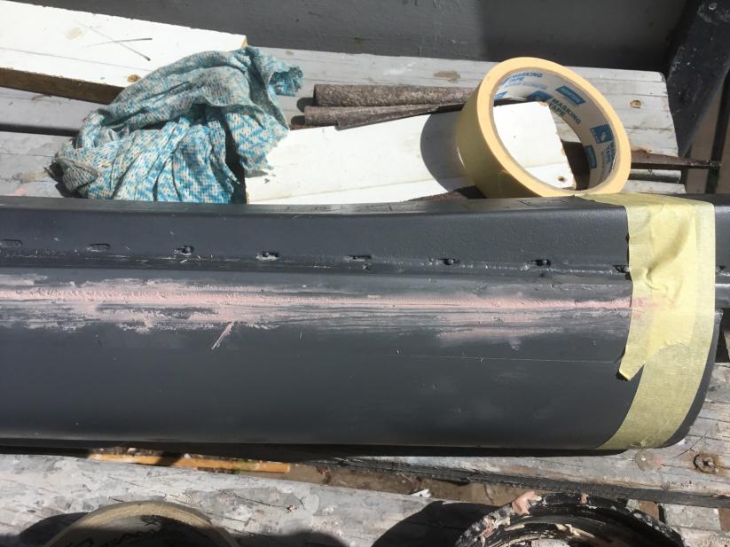

                Some of the masking tape is still in place, I have found that the primer that I use is almost exactly the same as the grey used on the lower hull. I also like the sheen...

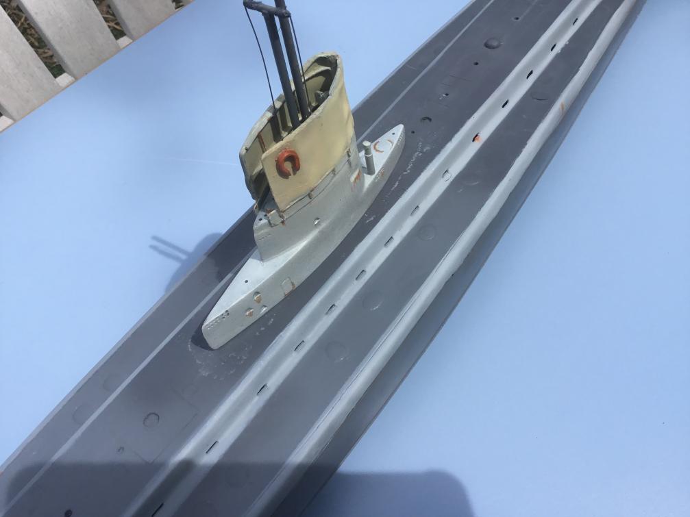

                I am really happy with how the canvas looks. The 2.4 Ghz antenna will come out the top of the Periscope. Deck two tone was reasonably straight forward to apply.

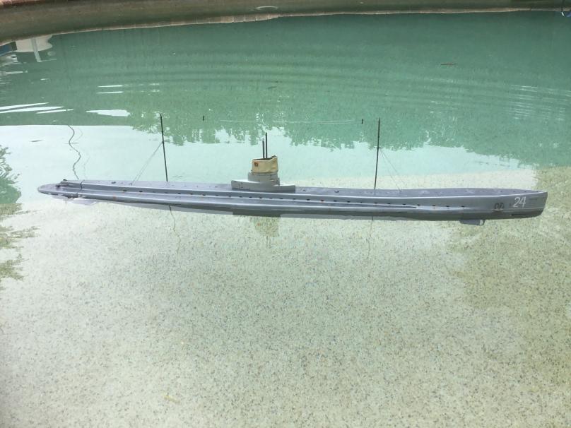

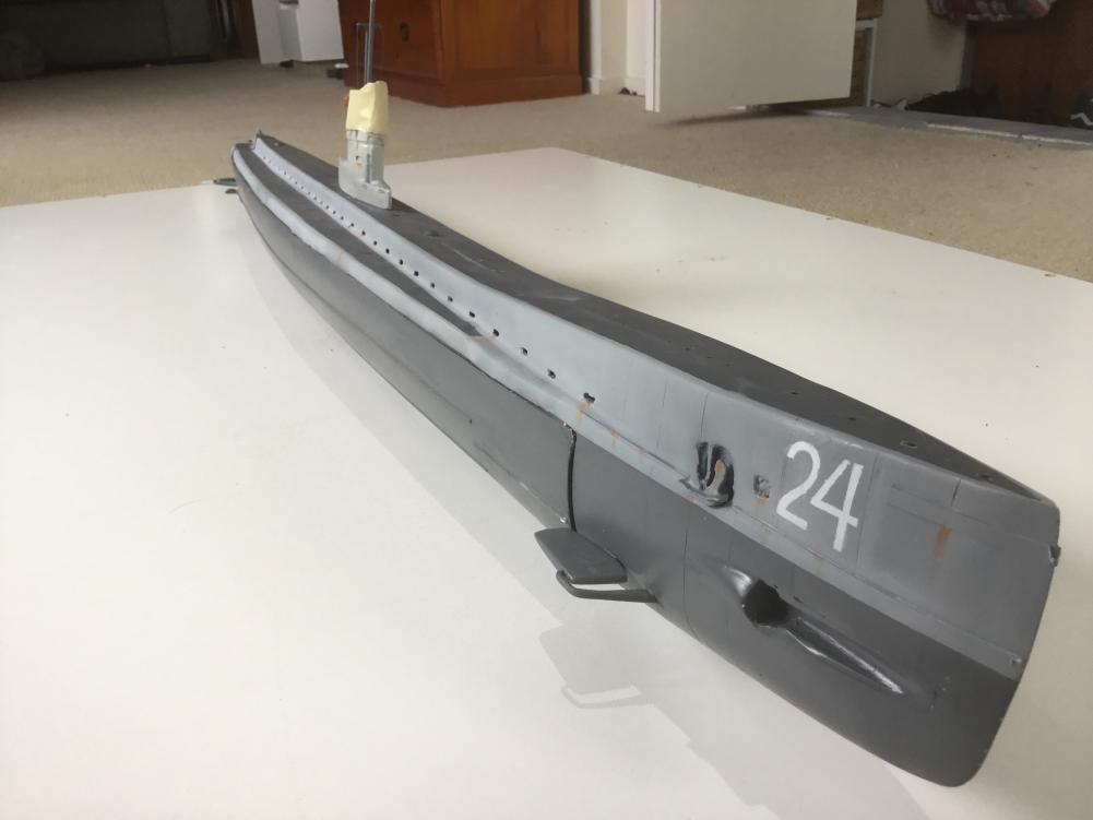

                I have decided to make my boat the U-24. This boat survived the war and wasn't broken up until 1921. I like the rust. I have yet to glue in the Torpedo tube doors.

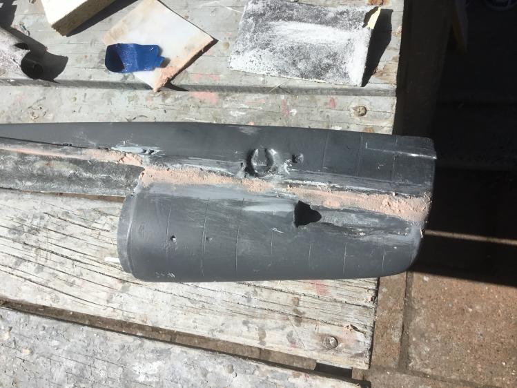

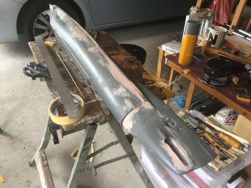

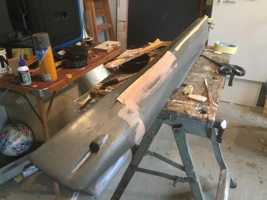

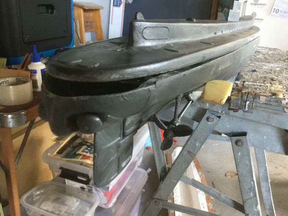

                I should be working on the making the gap between the forward and main hull a bit better. Bow planes are fixed.
                Next installment, in the water!

                    At this point the U-23 is ready for early testing. At the moment the 2.4 Ghz cylinder isn't ready just yet so I am reverting back to using my old ZB-2 cylinder. (Twin shaft, twin motor) discontinued not that there were many orders. The distance between shafts is constant between both cylinders and length is virtually the same so that fitting between the two shouldn't be a problem. As mentioned in the previous post I have used foam as a means of securing the cylinder and wedging it in place. I have placed a good amount of foam fore and aft and then started placing lead sinkers in the locations that I typically would find these sinkers in my other boats. The box keel at the bottom of this hull is really use full for this as it allows me to place lead underneath the cylinder and ballast tank, something that wasn't easy with my nuclear boats.
                    At this point I did think about the cubic capacity of the ballast tank and if it would be enough to bring her down satisfactorily. I had though that when making it maybe I should have made it slightly bigger. I could always swap it out. Then again I want a boat that will only just get close to neutral buoyancy and not go beyond it. I've never been good at the maths.

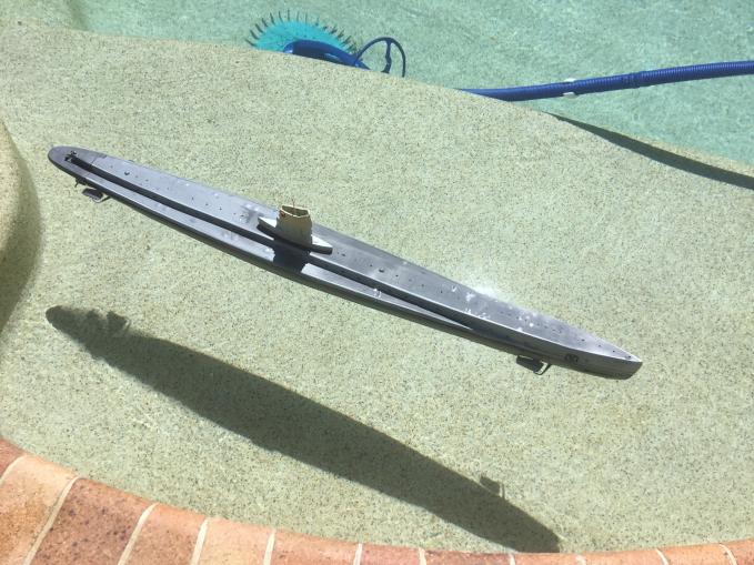

                    Initial tests showed that she was slightly stern heavy, but overall a little high in the water, certainly above her surface waterline . So do I add more lead or increase the amount of Foam? I would do a mixture of both but found that with cylinder and Battery added she came close to surface trim. The initial dive test showed that she needed all the ballast tank water she could get to submerge and the slight stern heavy was accentuated somewhat. More trimming with foam and redistribution of lead weight.
                    As seen at this point not all the painting had been completed yet and some of the surface details hadn't been installed either. I intend on making the Radio masts later and having them as detachable masts and stays. At this point I was thinking, how you get the boat to sit as high as you can and yet easily dive to a nice neutral bouyancy? Eventually after some fiddling all afternoon I managed to get her to sit with the conning tower above the water, it is clear that the tank could probably be just a little bit bigger. No big drama, just a redistribution and and a bigger tank, probably only needs to be about 20% bigger.

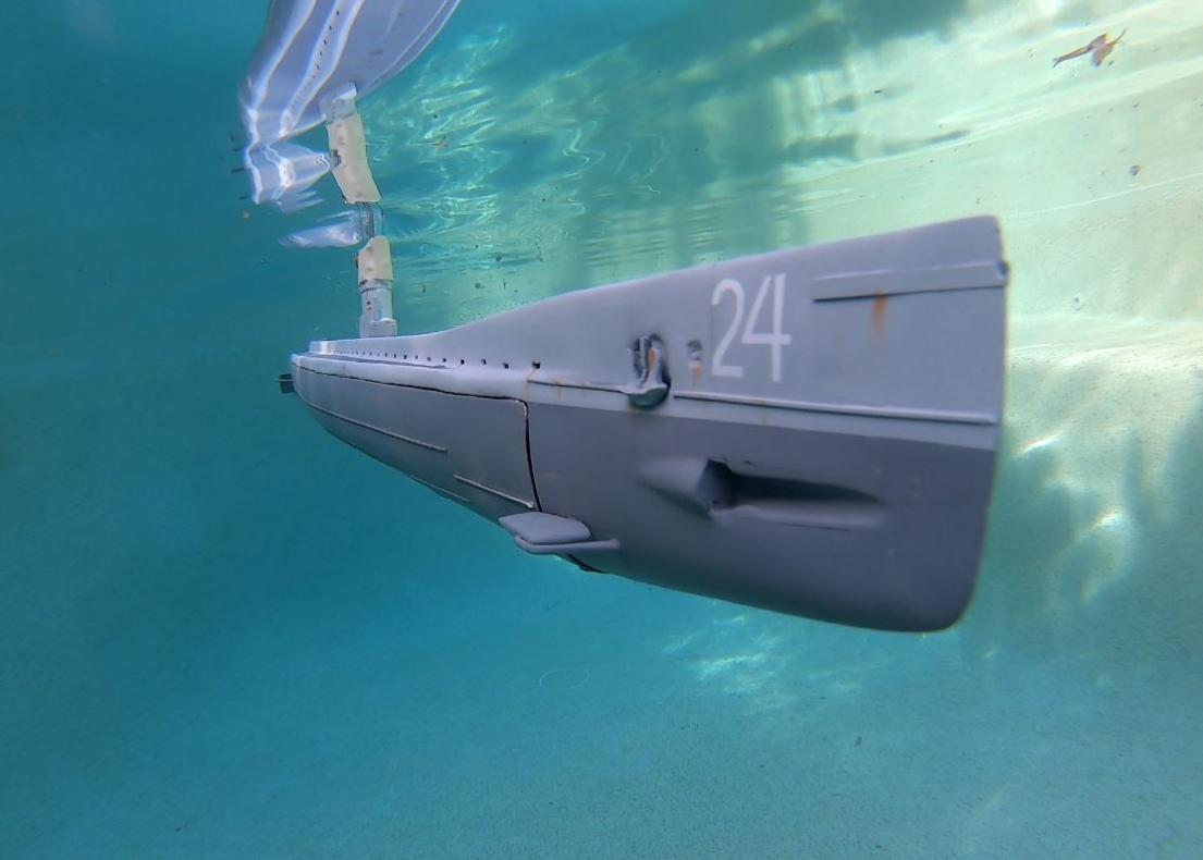

                    The underwater realm and a really good lens shown up imperfections in a light that you just don't quite get on the surface. Here the torpedo tube doors haven't been installed yet and the Z cut needs some looking into. The bow planes are fixed. I haven never made them operational on any of my models. I probably should. One of the things that I found was that the stern planes were not as effective as I would have liked. The only made slight influence when at speed.
Name:	U-23 bow down 10.JPG

                    I have know that my pool isn't ideal. It is a salt chlorine pool and I think that Rio in the concrete doesn't help. But its all I got and there are times when the reception is OK and other times it's glitchy. I decided to increase the stern plane surface area by adding clear plastic strips that above the surface of the water are effectively invisible, but under the surface are noticeable.
Name:	U-23 in depths 1.JPG

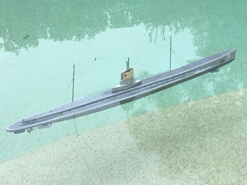

                    The radio masts were a distinctive feature of these early U-boats. They made the boat very vulnerable to the slow flying Biplanes of the age and couldn't as a result, dive quickly. I think they look great and mostly leave them on which is most un-scale like when diving but, what the heck. The masts are made of Skewer stick given a coat of resin and paint and the wire is fine gauge wire. You just have to be care full when you haul the boat out of the water that you don't accidentally pull the wire or get tangled somehow in it.

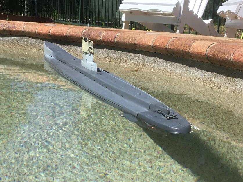

                    As you can see here the bow it a little high. I haven't made a decision on doing a new improved Ballast tank, I don't have the time at the moment but will consider it in the future.
