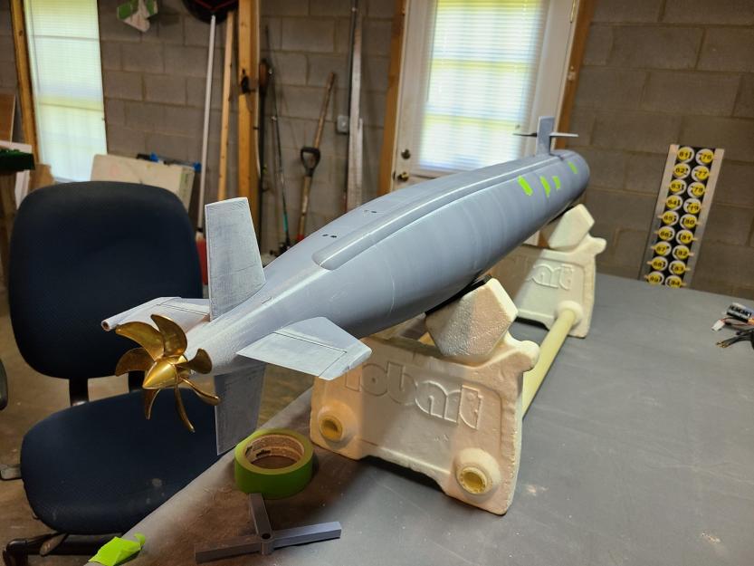

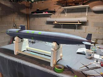

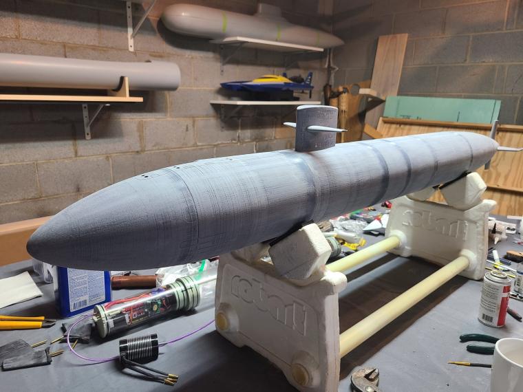

    The LA files from The Nautilus Drydocks in 1/72 scale printed in PLA+. 5-1/2" beam. 60" long. Its a good looking boat. I will seal it inside and out with high fill polyurethane primer.

    Where did you get the stand? I'm looking for one for my 1/72 Skipjack........................
    • SubDude
      • 825
      Yeah, it is just a foam Robart plane caddy.

        NIce print, now what is going on with the Typhoon in the background?
        • SubDude
          • 825
          That is an epoxy fiberglass hull pulled from a set of molds that my friend Darrell Sprayberry has. Him and another guy made the molds years ago. I am waiting on the resin appendages but basically it is a future project.

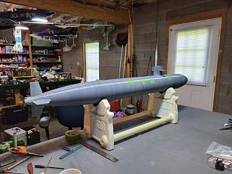

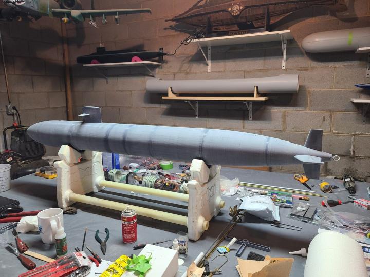

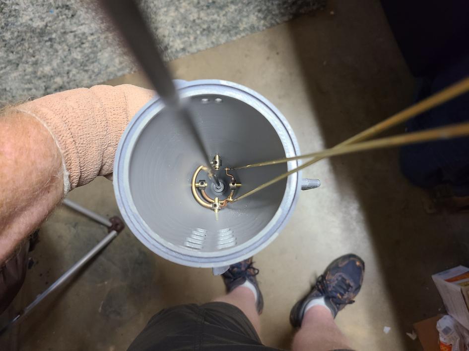

            I taped the openings from the outside and then sloshed polyurethane primer inside to seal it up and added the stern plane yokes. She's ready to start filling and priming.

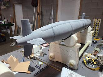

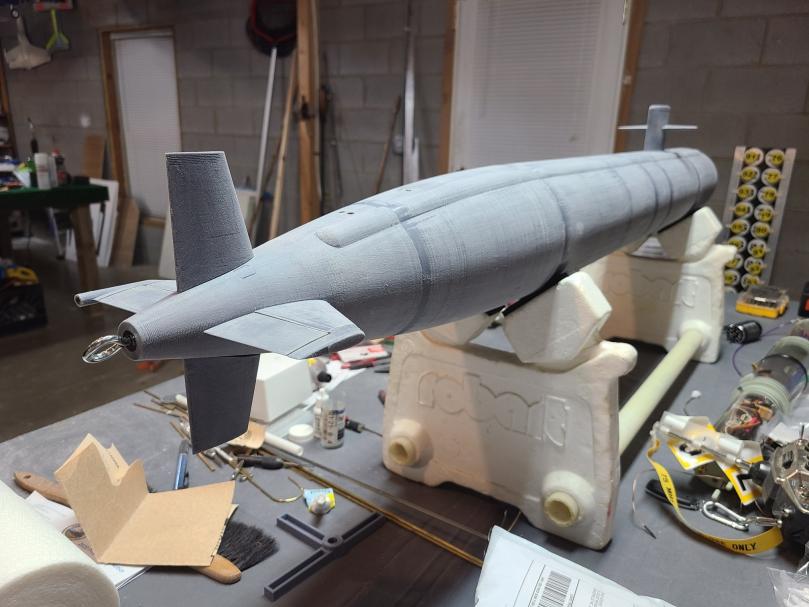

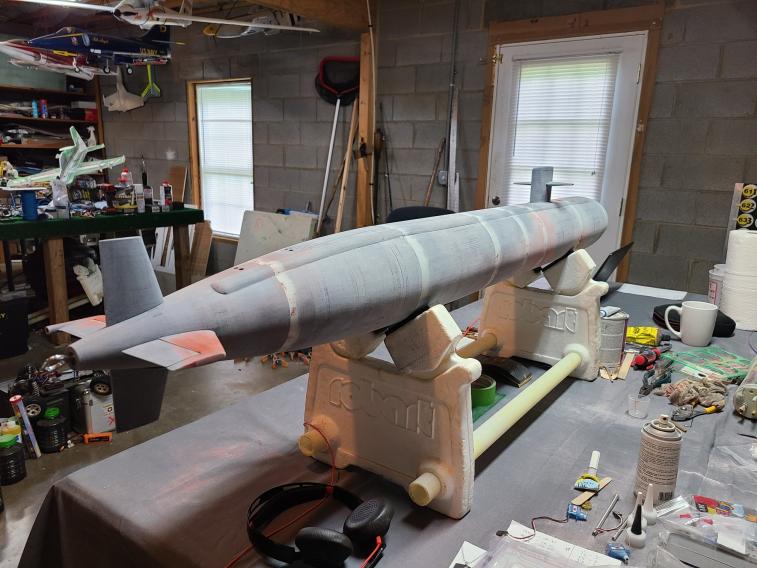

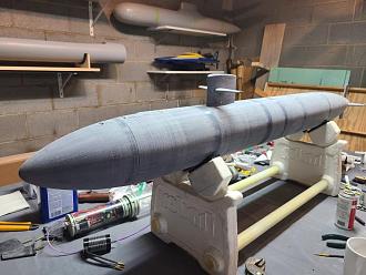

                Sanded with 80 grit it is now ready for some Evercoat Rage filler and then a coat of PU primer. There is a good possibility that I could have this one ready for the regatta in Cohutta next month as well.

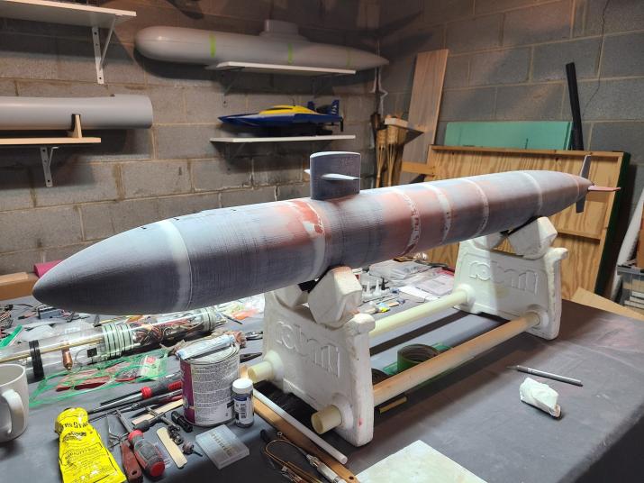

                  Ready for primer.

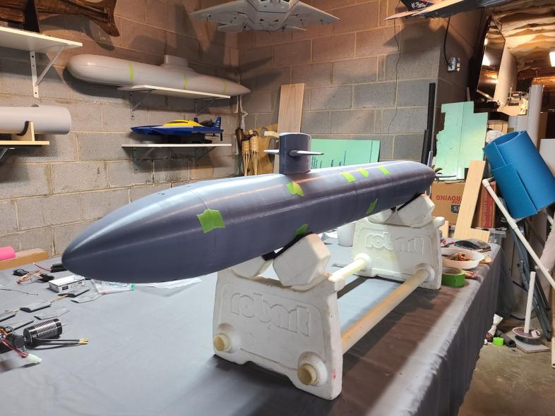

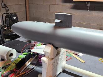

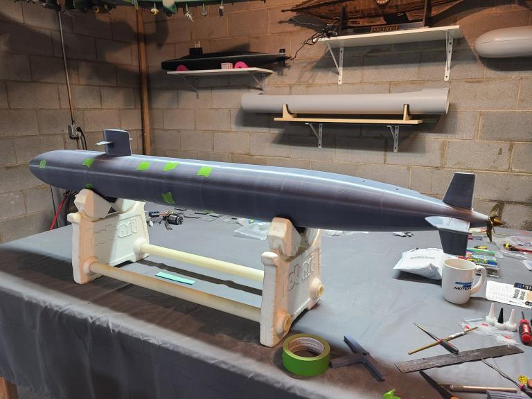

                    First coat of Finish 1 Polyurethane high fill primer is on and it looks good. Lots of sanding ahead.

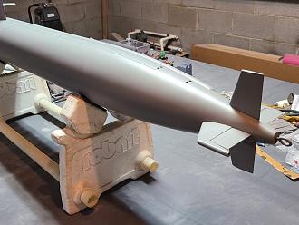

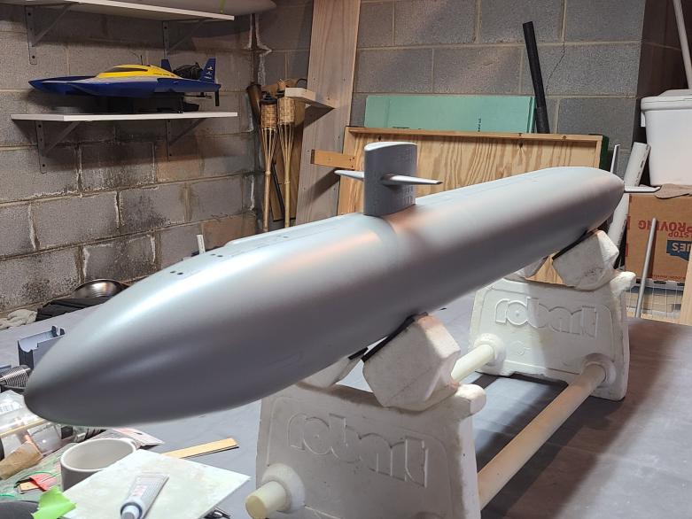

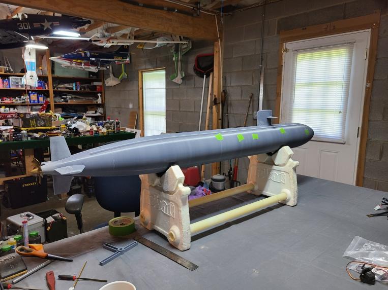

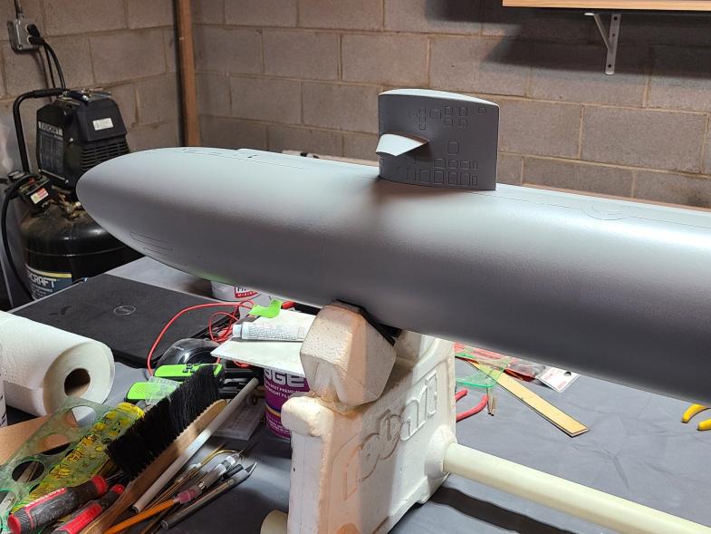

                        Second coat of primer is on. Turned out great. Only minor sanding required and then I will paint it.

                          That is really coming along nicely!
                          • coryhenry
                            • Jul 2020
                            • 156

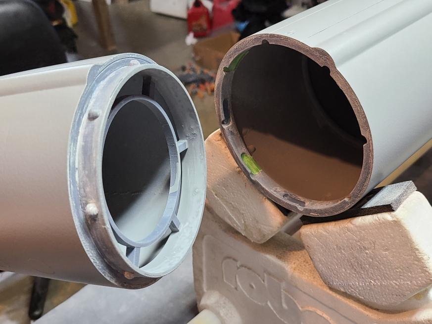

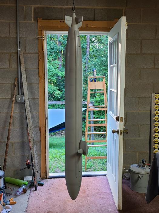

                            Which way are you going to cut it?
                            • SubDude
                              • 825
                              It's a bayonet style hull so it already separates in two places. One just ahead of the sail and this one aft.
