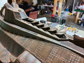

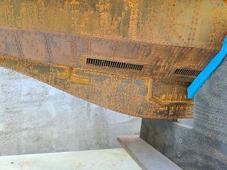

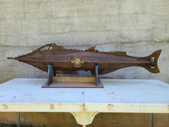

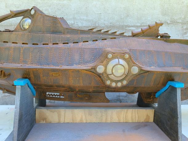

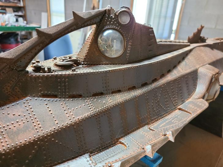

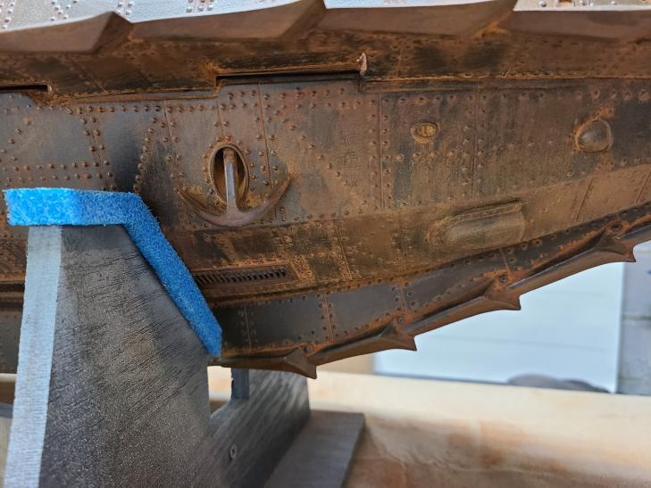

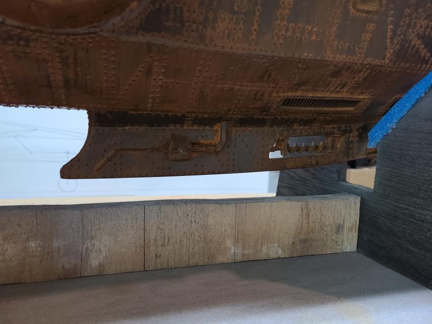

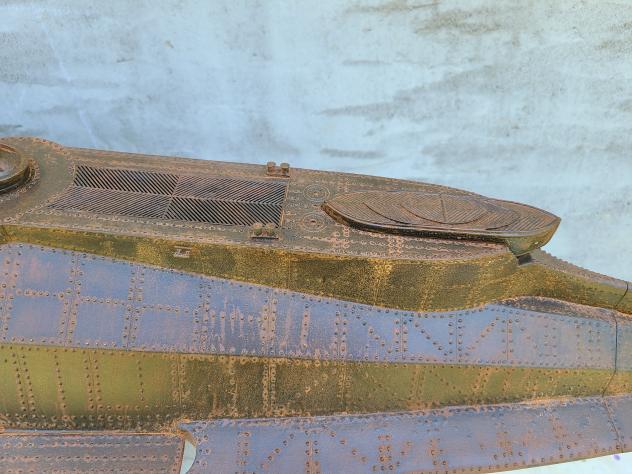

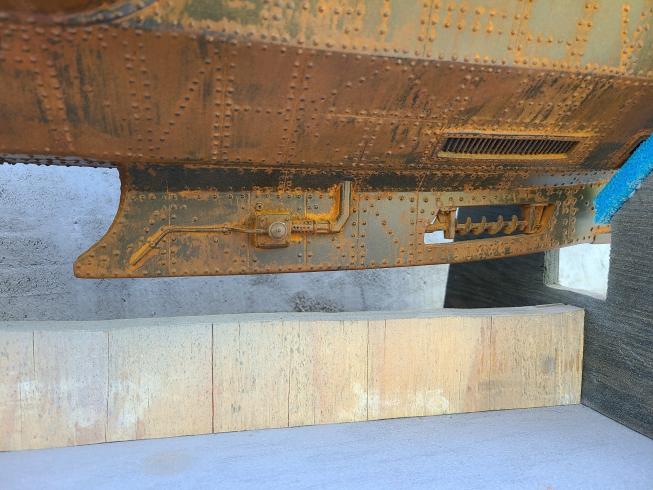

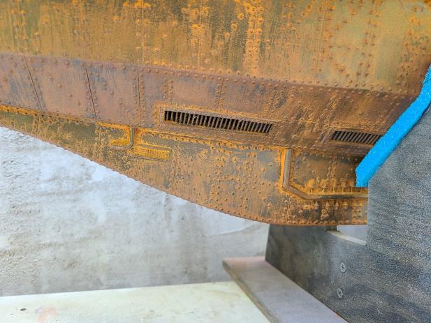

      Ok, so as is my custom, I typically let something sit a couple days while I look at it and wonder what I like or don't like about it. I wasn't too fond of the contrast between the base coat and rust effect after the satin clear went on. First I tried a light coat of matte clear to see if that would help and it was a little better but I felt it needed more of a rusty hue. As an experiment I tried dusting the whole model with some Vallejo old rust powder pigment and then hit it again with a light coat of Krylon clear matte and now I couldn't be more pleased with it. She looks friggin' awesome!

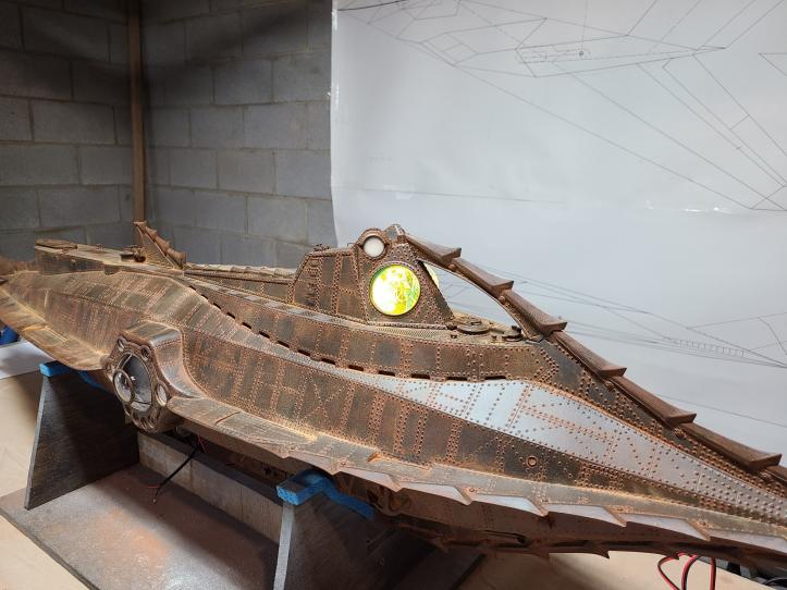

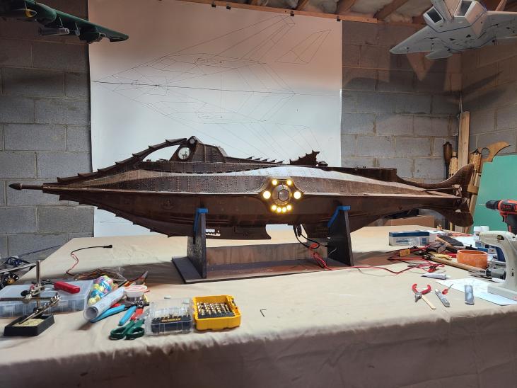

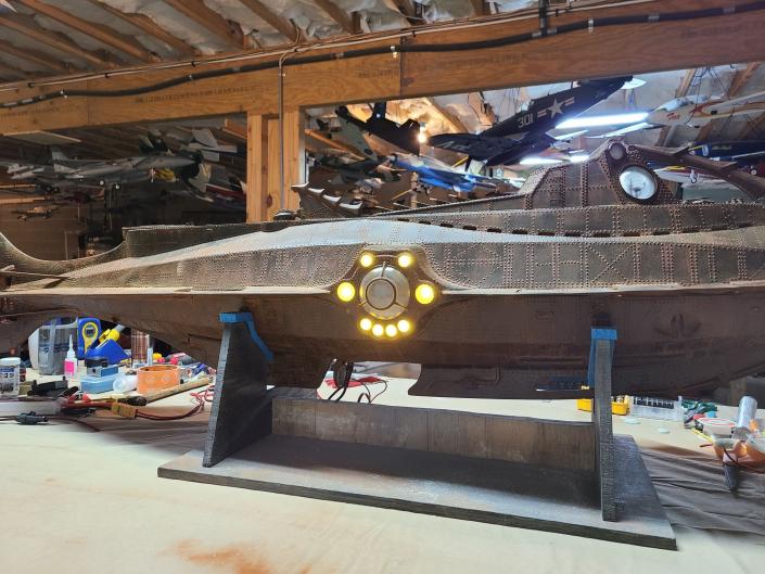

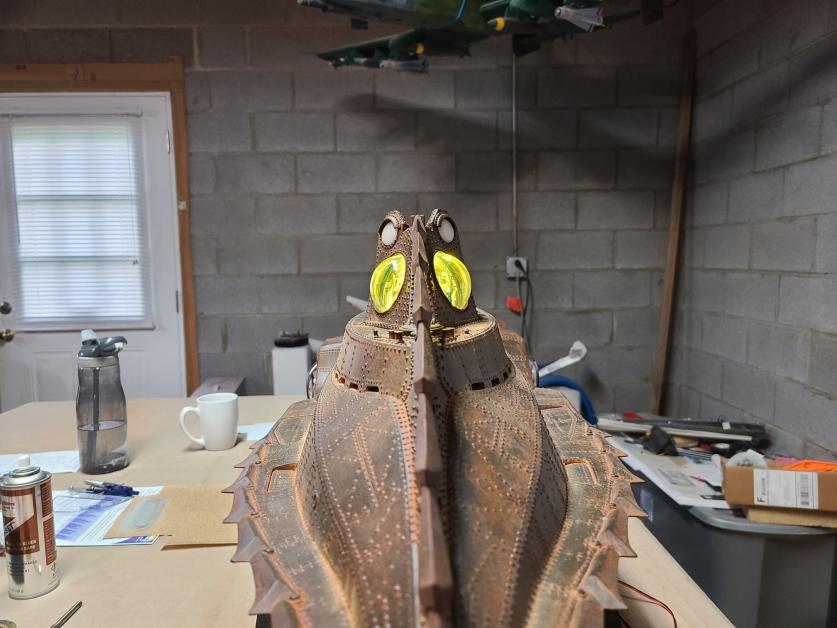

                  Lighting progress.

                    #39
                    Steve,
                    Those lights really set that boat off! The last photo would certainly scare the crews of any ship that might wonder into it's path. Great look, with the blueish/green light!
                    Are you doing any of the interior work inside the main hull?

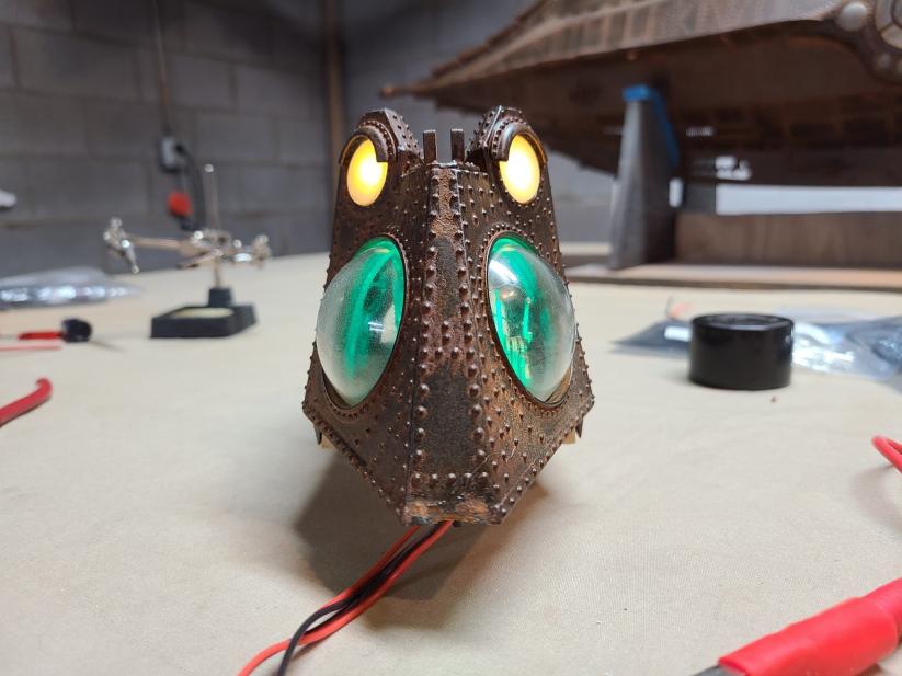

                      #40
                      The green LED's are likely going to change. I am considering detailing out the salon to a point. Already working on replacing the windows in the wheelhouse and salon but it will still be hard to see much inside it.

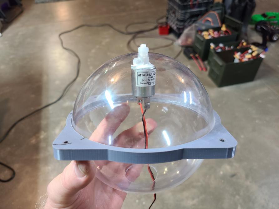

                        One of two ballast tanks. 5-1/2" sphere with 12V solenoid installed and mounted in a 3D printed frame. The frame simply screws to four pillars glued to the bottom of the hull.

                          Playing with some different ways of lighting up the wheelhouse. Trying to come close to that attack scene look.

                            That ballast tank is the slickest thing I've seen in a long time! I love it!
                            For the uninitiated, a spherical ballast tank is the ONLY way to ensure no change in center of buoyancy due to water movement during operation. It's ideal from a physics perspective, but not for space-saving.

                              Twin piston tanks will also do the same, especially so if they're driven off a common shaft (e.g. single motor).

                                I agree with Bob, it is really a cool look. For whatever reason, it fits the Nautilus theme. It has a Steam Punk look and feel to it. If the frame is painted an antique bronze it will be eye candy on the inside. Steve, you are doing.a great job on this submarine.
