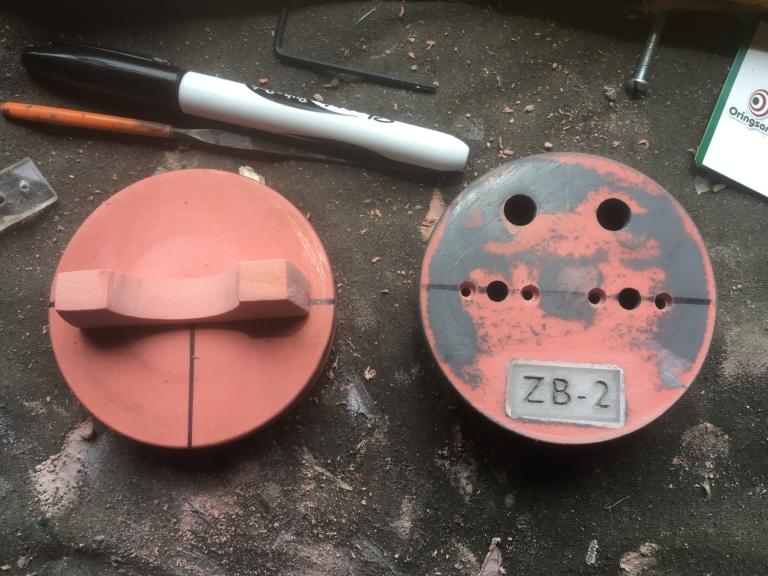

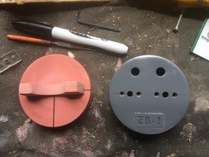

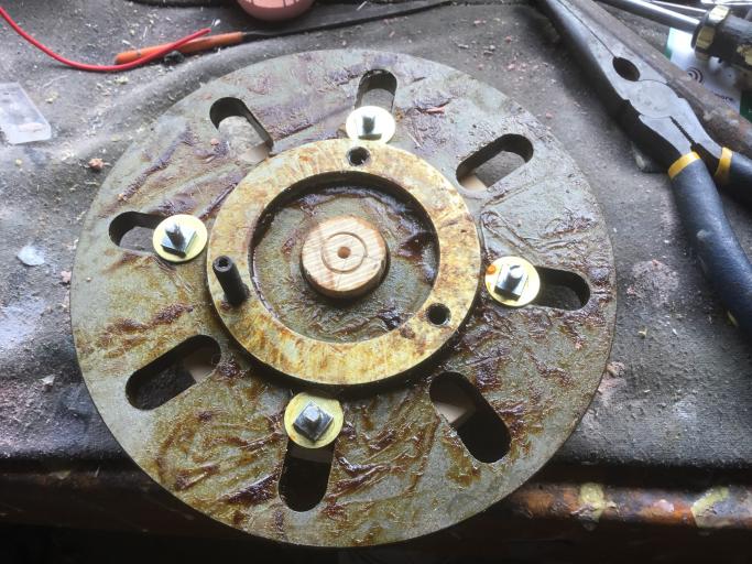

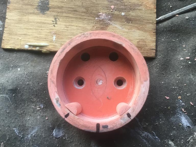

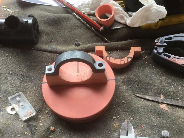

    Just a few of the specialized holding-fixtures I use to machine cast resin bulkheads. The two big ones in background employ a proper face-plate. The big holding fixture to the right features taped holes through the steel plate itself. Note that all holding-fixtures feature a piece of #100 sandpaper glued to its face – this to insure a no-slip surface between holding-fixture and the resin bulkhead being worked.

    This holding-fixture, the one in hand, features a thick hunk of RenShape screwed to it, giving me enough meat in drill and tap holes at various radius points to accept securing studs. Most of the cast resin bulkheads (internal and end-caps) have holes in them for either a conduit or to later accept watertight seals. I take advantage of these holes as I secure the work to a specialized lathe holding-fixture.

    In some cases I need to get the nut above the work. So, I use a long stud and stand-off to get unobstructed access to the nut (or wing-nut) well above the bulkhead.

    In some applications a strong-back is used to more evenly distribute the compressive force of the nut along the face of the work.

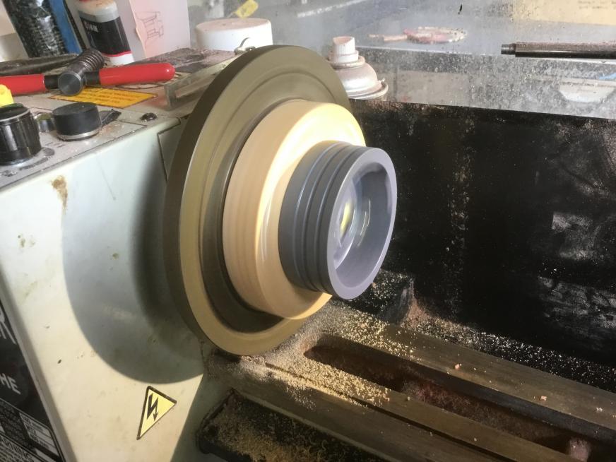

    The face-plate/holding-fixture screws right to the spindle of the head-stock. The smaller holding fixtures are secured in the jaws of a three or four-jaw chuck.

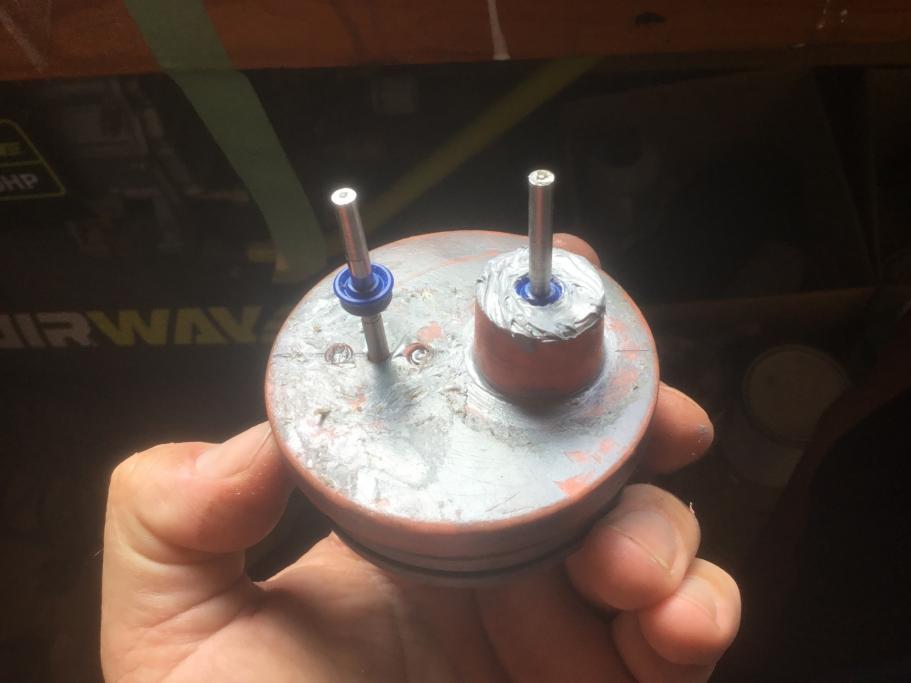

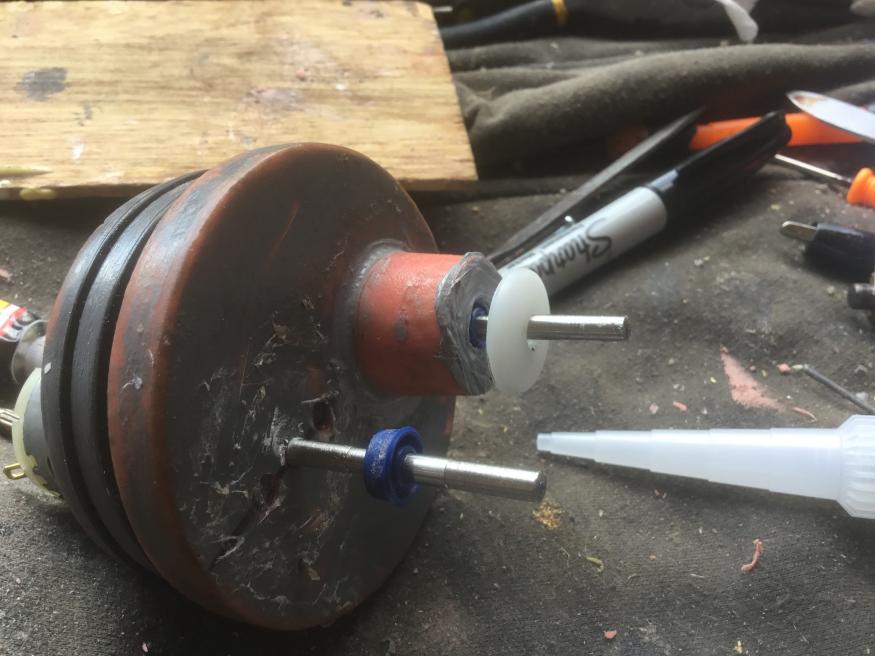

      This photo shows one of the shaft mounts done. The other shaft has the cup seal on it. The other has the cup seal smothered just short of the cup seal lip. Over this will be placed the end support cover. Currently machined out of Delryn.
      The left over silicon from the last attempt is still evident on one side however the new silicon, a nice grey one just smothers over the top..
      All I have to do here is press the while end support down onto the silicon layer around the cup seal.

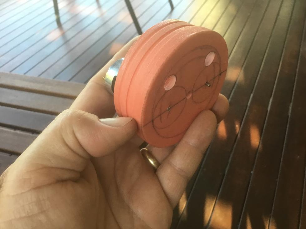

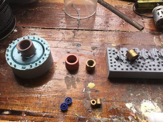

              I realized that the push rod housings would not fit along the arc so close to the shaft support. As a result I had to move them further up on the arc and then re-drill the holes for them. I also decided to reduce the width of the flange on the outside. I reduces this by a couple of mm. This would reduce the material used but still create the stop that could help with making the units watertight.
              I haven't been able to test these brass units yet as I need to make a mold and then encapsulate the "O" ring as needed. I am very confident that they will work 100% as they are only sealing a push rod that moves back and forth occasionally.
              After a couple of extra layers of resin and sanding back the end cap looks nice. There is still some some fine sanding but getting there.

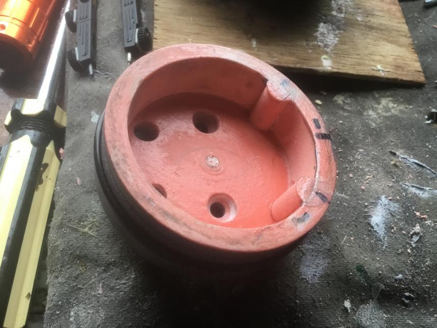

              For some time I have been looking at how I would get the tray to affix to the end cap. On my previous end cap designs I simply glued an acrylic ledge to the inside face underneath the motors and then bolted a further curved piece from there. Bolted so I could the take the whole tray off if I needed to get to the motors and take them off.
              With this design I am going to try and keep it simple. In doing so i am taking David's guidance and I am going to make the trays out of Sheet metal. This has got to be so much easier.
              I'm doing so I have had to resolve how I am going to attach the sheet metal to the end cap and this would have to happen in the space beneath the twin motors. I have noticed that
              David has simply drilled and screwed two screws into the rim of the end cap. I have decided to pretty much follow this however i will create a series of two round supports that stick out from the inside diameter. I could drill just into the rim but if I have to machine this down a fair bit from the established outside diameter of the molded piece this could give only a little material left. These two extra curves give a more secure area in which to drill and secure the sheet metal folded tray.
              As you can see I haven't yet given the inside a coat of grey primer. I've yet to fully fill the center and get it flush. What is clear form this shot in the countersunk for the motor bearing recesses. I have yet to drill the small 2.6mm holes for the motor attachments. ( why did someone at Mabuchi pick 2.6mm of all diameters? Why not 3-4mm? 2.6 is not easy to get.)

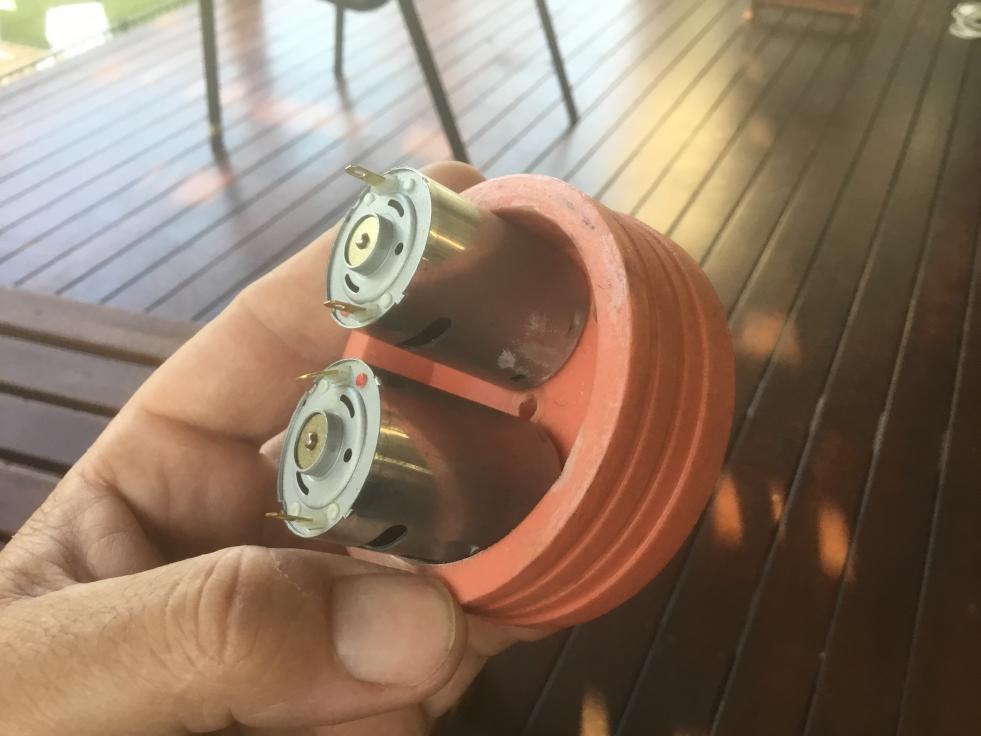

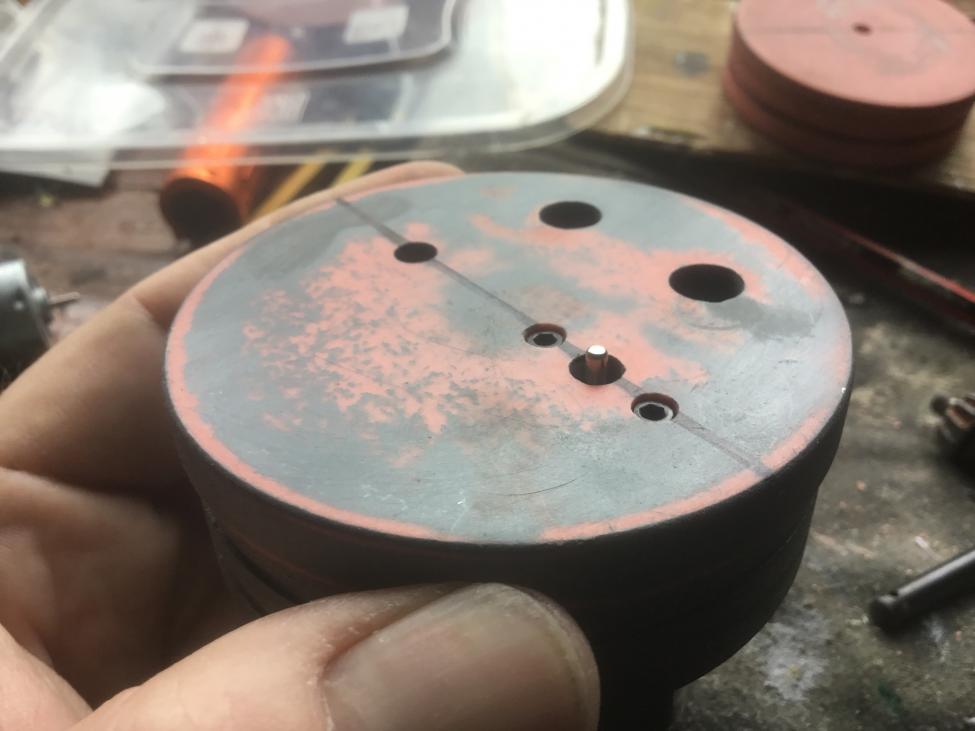

              Here you can see the motor shafts just protruding out of the two holes. I have yet to drill the holes that will align them better. I have found that one motor has pinched a bit in the corner so i have had to get hard with the sand paper in the corner just to free up the space for the rim of the motor as it presses hard up against the inside of the rim.

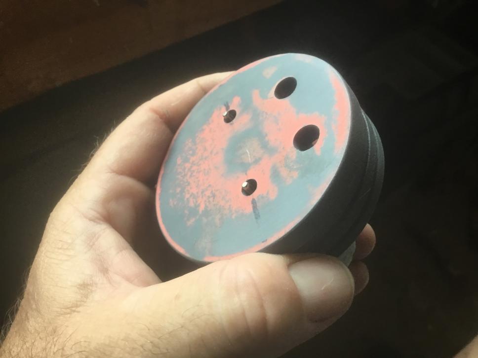

              First spray coat of primer. Yet to drill the holes around the bulges at the bottom of the rim..

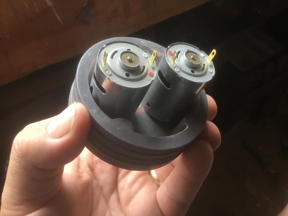

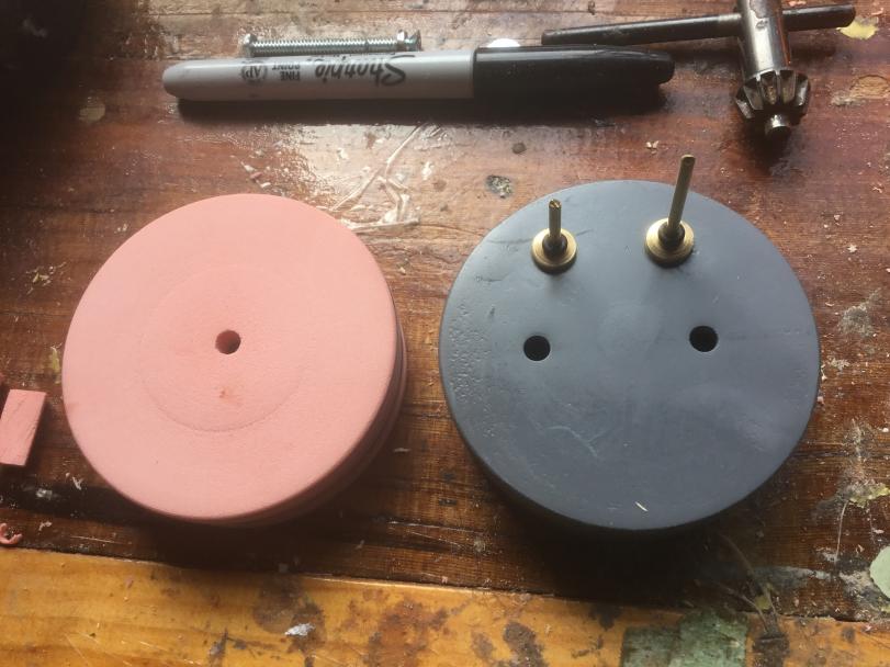

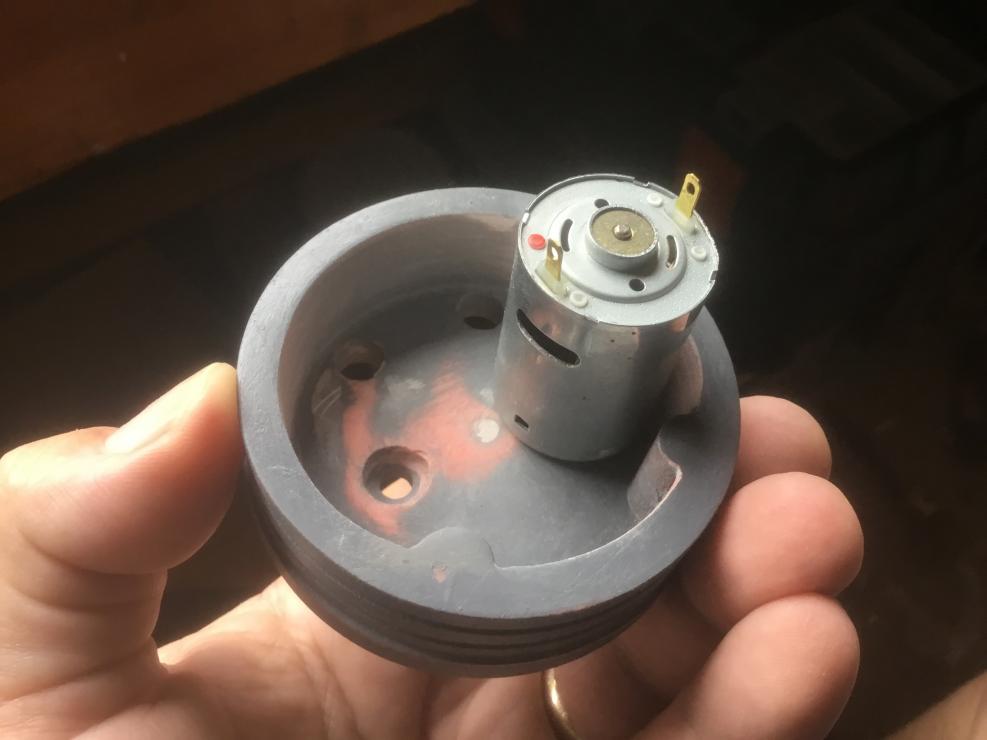

              These motors have been press fit into place. Next I will drill out the holes for the 2.6mm screws.

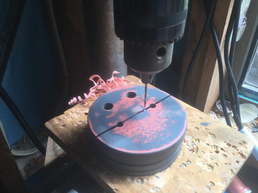

              Drilling first holes. These little 2.6mm screws have nice hex bolts. Neat. After drilling the 3mm hole drill a small 3.5mm countersunk till about half way down.
              The motor is not centered in the hole. This hole needs to be big enough to fit the press fit shaft extension in to the motor and pass through the shaft.

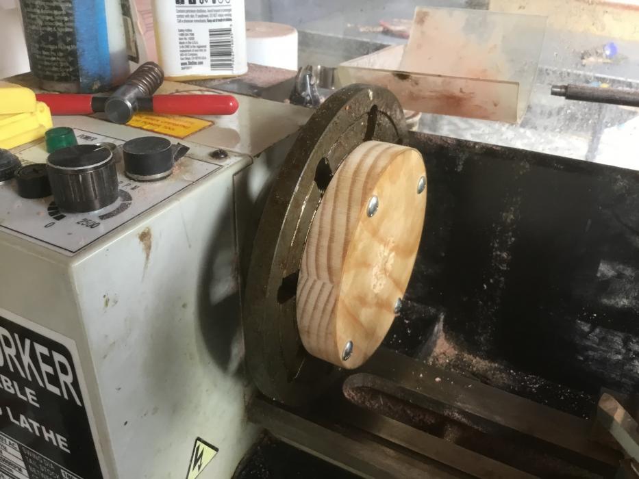

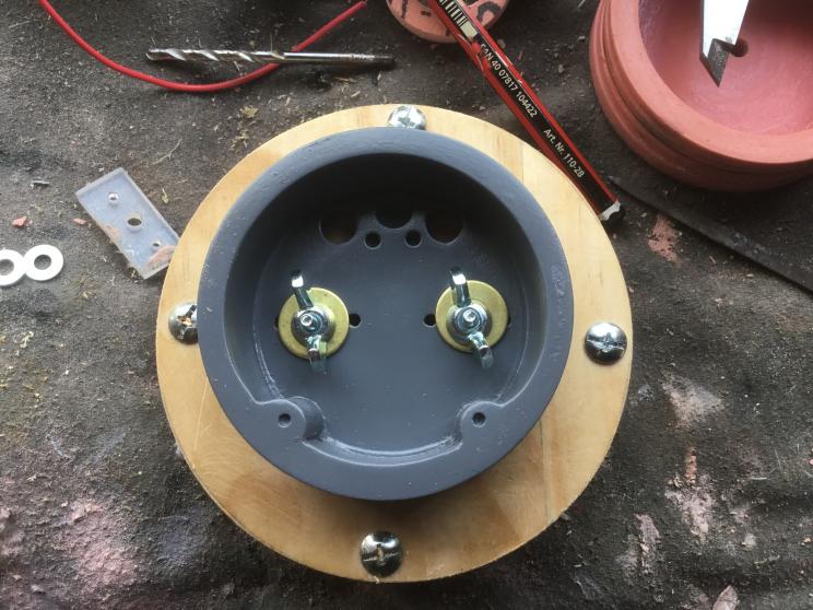

                  I decided to leave the whole lathe fixture mounting for another time and that time has just come and gone.
                  Initially David took one look at the smaller block that I had fashioned up and told me to get rid of it. Rightly so, It couldn't really work. I needed a wider and bigger fixture plate to
                  hold down the stern end cap. As it was the lather face plate I have has grooves that are further out from the smaller diameter block that I had. The write up was fantastic and got me thinking...
                  I cut out a wider piece of 19 mm thick pine with a diameter of about 90 mm. Cut it round on the band saw knowing that I would eventually want to turn it nice and round. Great thing about metal lathes, they can turn wood too. I have glued a small round block on the inner side that will sit as a register point within the round hub of the face plate as it is bolted onto the shaft.
                  So I drilled four holes around the outer rim of the block, these would hold the bolts that secure down the fixture to the face plate. Big fat washers and really tight nuts should do the job.
                  I also turned down the outer rim to get it nice and centered.
                  After this I would take the stern end cap and place it on the other side of the fixture to work out where the screws would be drilled to get the end cap as close to center as possible.
                  There is a hole drilled right through the center of the fixture. This would help with finding the dead center of the end cap. A mark on the end cap at dead center and then a look through the hole in the fixture to align up the hole and then mark out where the hole should be drilled to go through the biggest holes in the end cap, which are the motor shaft centers.
                  The bolts are 3 mm dia 40 mm long. Nice big wingnuts and wide washers give plenty of movement to find dead center. I am happy with how this is looking..
                  It didn't take long to center the end cap with almost no eccentricity.
                  Nothing to be done, just to check that I have a system that works. I can be confident now that when the cast resin end cap comes out of the mold, this stage in proceedings should work.

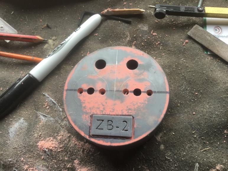

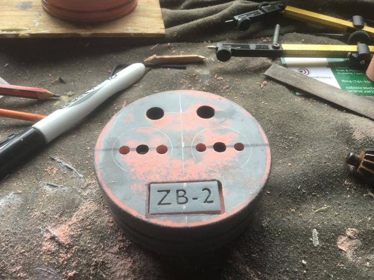

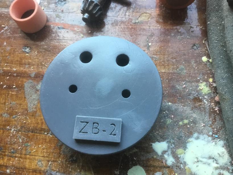

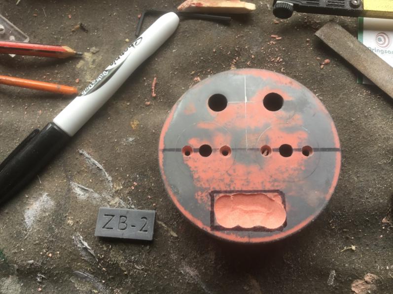

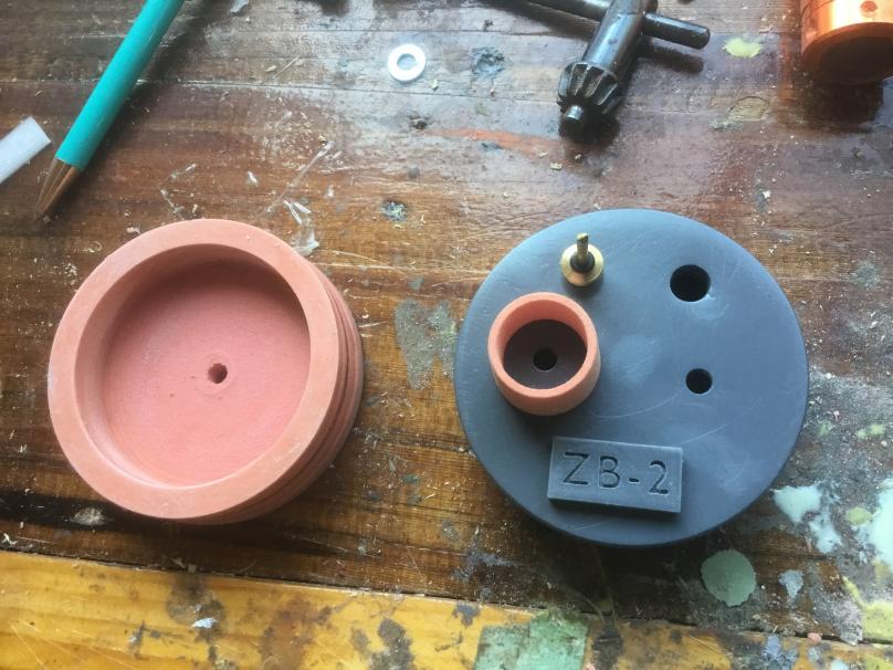

                      The stern end cap is mostly done. The holes are where I need them and I am pretty happy with the arrangement. I am now going to spend a bit of time dealing with surface finish on the inside and out. However before finalising the end cap I thought about putting my 'personal touch' on it. I decided that with the end caps I would have some text embedded into the design, a negative feature that would distinguish the unit. This being the Zero Bubble twin end cap would have 'ZB-2' moulded into the face somewhere.
                      I wanted to mold "Zero Bubble model design" along the rim but found that even 3D printing a template the text is just too small, so i simply decided to go with ZB-2 along the face at the bottom and out of the way of penetrations coming in and out. I was'nt going to scribe the words in, I would stuff it up, the Text could stick out but this would cause problems for anyone wanting to drill further holes from the inside out. The unit would not sit flush on the drill press. So the text would be in relief.
                      I designed a block in Blender with the text recessed inside and then printed it out.
                      Gave the text block a shot of primer and then sanded it back. A tiny bit of filler here and there and more sanding. Whilst doing this I outlined the area to cut out to create the recess for the text block. This was simply a case of getting out the dremel and grinding out a rectangular pattern, making sure that I didn't go to deep and cut holes out to the inside wall of the end cap.
                      Once enough material was removed I could then get the block flush and level with the face. Then I just had to center it and glue it in.

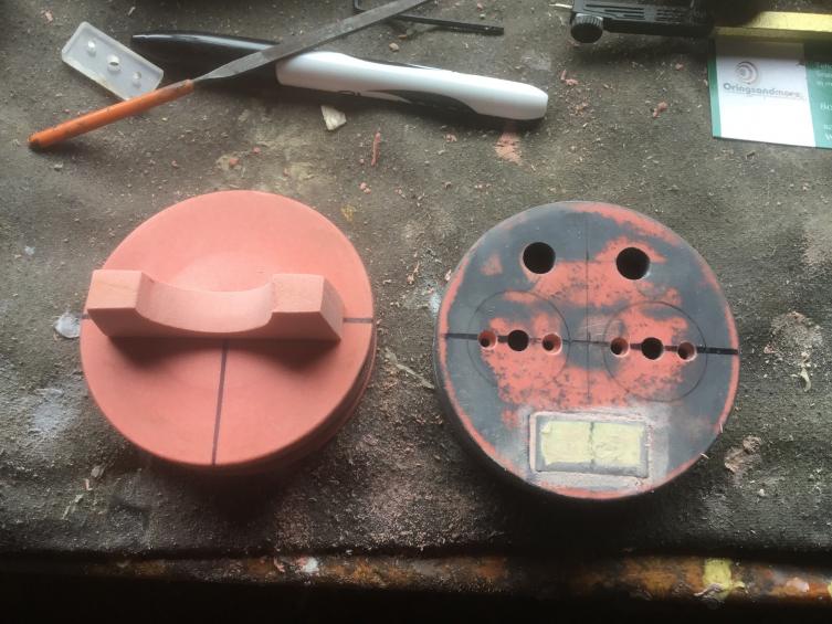

                      To the left is the front end cap. The U shaped bracket is for mounting the 12v pump.
                      There is still more sanding to do around the rim. Want to lose the border around the text.

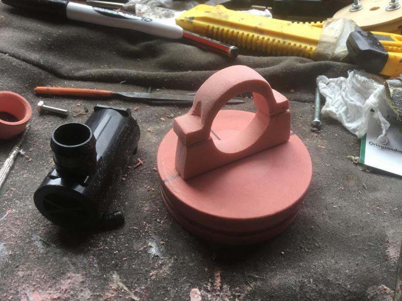

                        The front end cap is designed to feature a bracket that will hold the 12v pump outside. Initially in my cylinder designs a decade ago I had the pumps mounted inside however this just makes for a more crowded cylinder and extra sealing. An external mounting makes replacement much easier and quicker. The bottom mount is made of Renshape that has been cut and sanded to have a semi circle section in the middle to follow the profile of the pump. This is glued to the front face of the front end cap. Then there is a clamping bracket that holds the motor in the bracket.

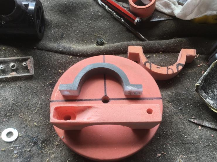

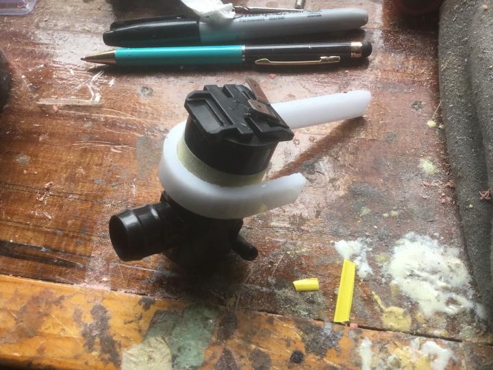

                        Initially I thought of using a Renshape outer bracket. As you can see this one is not really a great fit. I then had the idea of cutting a strip of Acrylic and sanding smooth the cut edge. Then I took a heat gun and heated the shape around the curve of the front of the pump. Then cut off the strip. A strip of masking tape protects the front of the pump from the residual heat.
                        Then I simply have to cut two small square bits and glue them on either end. These will make the bracket. Holes drilled into them and corresponding holes
                        drilled into the bottom mount. The Bottom mount will have the bolts mounted upwards with the heads molded into the bottom bracket. Nuts will simply be tightened
                        down over the thread to secure the pump in place.

                              ​ Hello All,
                              Thanks Trout, David,
                              I have another set of questions for HWSNBN to answer, I’m still waiting for the shaft one.. ( I know you have been busy)
                              I am about to start creating the molds for the following parts. However I need to get your opinion and advice regarding the best way to set up the mold. (orientation of the part)
                              These two parts are the inner and outer supports for the motor shaft extension. The Renshape one is the Outer ring and then the Brass, the inner support.
                              I will be casting both of them out of Urethane.
                              The masters seen here have a very nice and precise fit with the inner support just fitting into the outer ring (Renshape). I will need to be able to replicate this in a mold of these two parts.
                              So the question is:
                              I have two approaches to how I create the silicon molds for these and they are principally to do with the orientation of the part to the separation plane.
                              When I created the ring parts for the Propulsor unit of the Borei I placed the ring parts pointing upwards and molded a two part mold with the riser sitting along the top rim of the part. The separation plane of the mold being perpendicular to the part and running close to and around the lower rim. I am seriously considering this for the outer ring. Glue a very small bubble catcher along the top rim and some air vents off these.
                              For the inner support, (the Brass piece) it needs to have a precise inner ID to hold the 4mm ID Oilite bush. I don't know If I should mould this as shown in the below pic with the piece laid on it side with the axis of the piece parallel with the separation plane of the mold. Should I just have a huge 8mm insert going through the middle or should I mold it standing up like the larger outer ring that it needs to snugly slide into?
                              In this photo the outer rim is sitting on top of the "vertical mold' for want of a better term. To the right the inner support is laid horizontally like the parts in the mold beneath it.
                              Should I mold this part (inner support) like the one on the right?
                              O.K, I hope this makes sense.
                              What are your thoughts?
                              David H

                                Yeah, I've got to get on that how-to-make-a-shaft-extension piece for you, David. Thanks for being patient with me.
                                You can simplify your seal foundation by making it a simple cast resin cylinder with a bore at the forward end to accept your Oilite bearing, and a smaller bore at the after end to seat the lip of the cup-seal. On the cast resin seal foundation, from the forward end you slide in the bearing and glue it in place with CA; and from the after end you slide in the cup-seal; then you glue a washer-shapped retainer over the cup-seal to keep it in place. Finished!
                                Here's a variation on that theme:
                                KISS damnit! KISS!!!!
