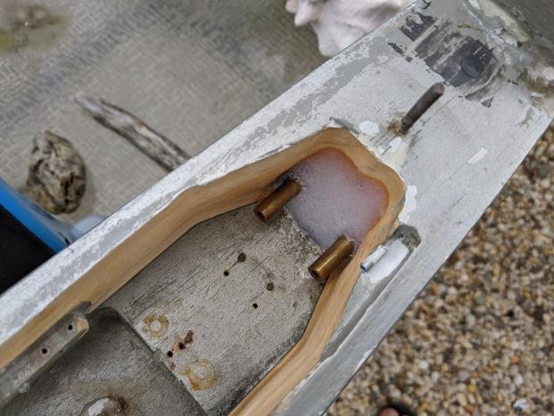

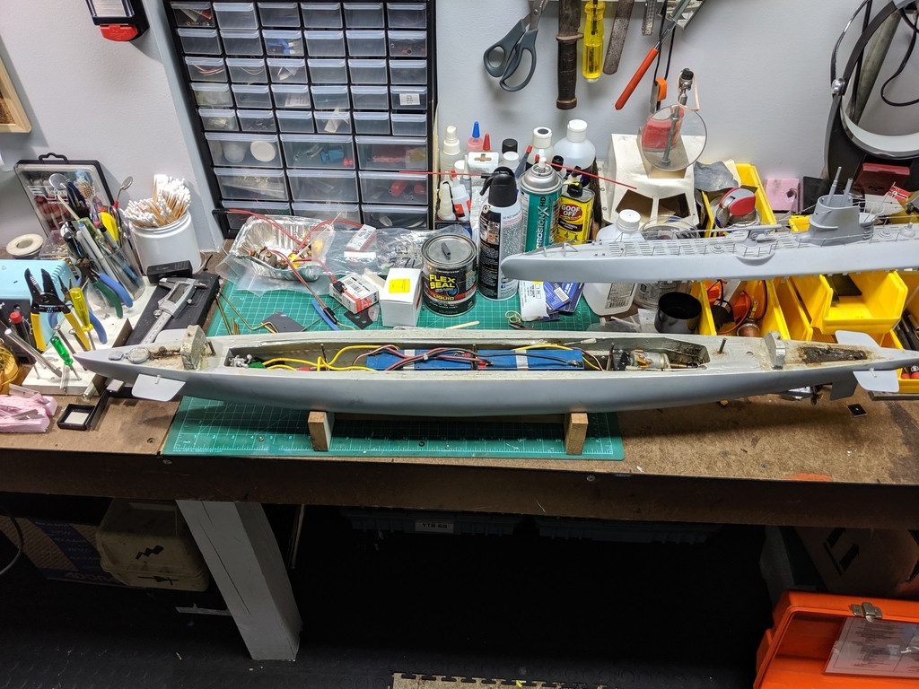

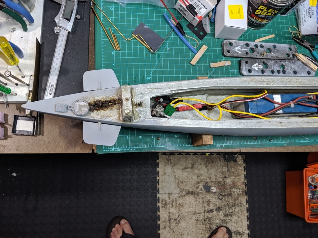

    First things first…..strip her down….clean her up!!!

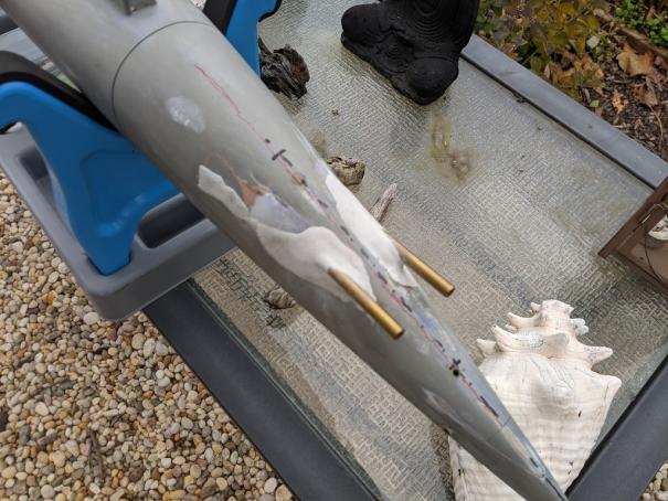

        Despite the fact we've been running boats every weekend since Groton, and I find myself overjoyed on how well SSN-591 has been running, I've been finding the time to work on U25.
        She's been stripped of operating gear and all that grease the former owners felt to use since apparent failure of her push-rod seals, which was revealed upon cleaning.

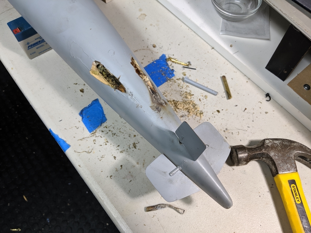

        I also ripped out the old style "grease gun" stuffing box's, which will be replaced by my home brew dual cup seals shaft seals. That means I'm tossing the original 1.96mm shafts with L/H, R/H molded in plastic props. On order from the Prop Shop UK are two brass replacements that will use a 1/8" SS shaft (P/N V3011/3 BRZ scale props handed pair). The new Shaft tubes will only be increased by 1/32" in diameter.
        As you can see it took a wee bit of "surgery" to remove them. We may differ in our definition of "wee". You know what they say about egg's and omelet's. One should never be afraid to proceed!
        ANYTHING can be fixed.

                I like Ed’s strategy. Get out the BFH and go to work.
                • QuarterMaster
                  • Sep 2015
                  • 1244

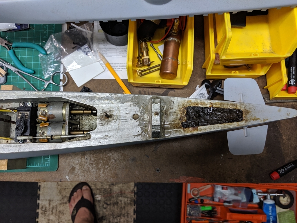

                  I torched those friggen' stuffing boxes with a propane plumbers torch and they didn't budge! The heat should have softened the epoxy enough to slide them right out. Whatever Jim Butt used to fix them in with should be used by SpaceX to coat the hull of STARSHIP for re-entry! It took the BFH to get them out lol! (And a 3/8" drill!!)
                  No worries! Came out great in the end with the new double, cup ring seal!

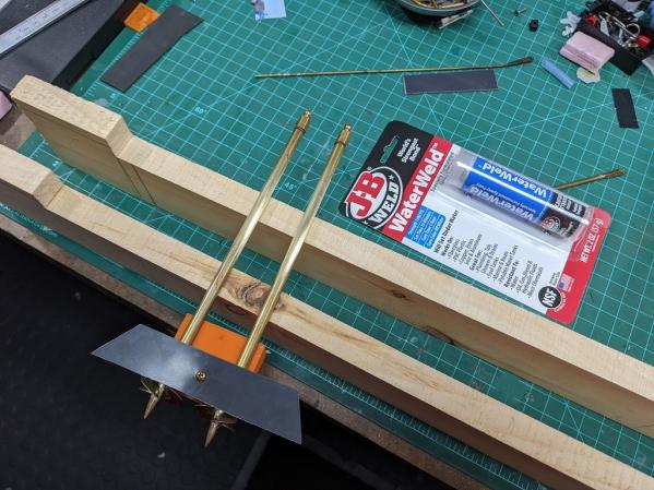

                  Here are both shafts, shaft seals, and new brass propellers in a 3D Printed jig to maintain alignment, FWIW, the originals were not only out of alignment with the boat, but with themselves! I believe the angle from horizontal per the plans, and what the original motor mount indicated, is about 7.5 deg. Now it lines up perfectly with the canted motors. I did give them a slight "toe-in" angle to insure I clear the new, realistic rudder, and themselves with respect to the motor c/l-motor c/l distance.

                  No H2o getting past this!

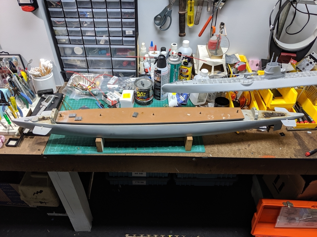

                  Time to sand, and sand.....(JB Water Weld)
