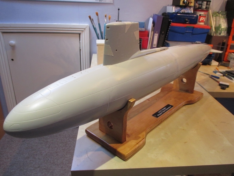

    A Skipjack in Ireland No.2
    Here we go again!!!
    I'm having another go at converting the Revell 1/72 Skipjack to R/C, it's just too good a model when completed to be without.
    Click image for larger version  Name:	IMG_1997 (800x600).jpg Views:	1 Size:	282.5 KB ID:	132117
    Z - cut complete, on my usual oak effect stand.

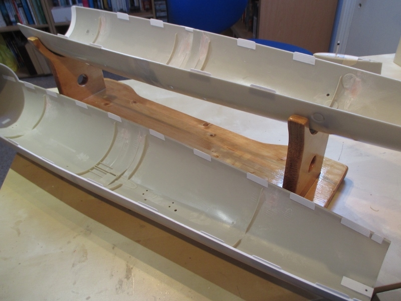

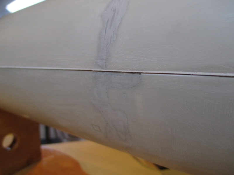

    Lots of problems with this hull, it had seriously warped in the box (left in sunlight?). Plenty of filling and alignment strips were needed to get it aligned and still more to do.
    Click image for larger version  Name:	IMG_2000 (800x600).jpg Views:	1 Size:	184.0 KB ID:	132118Click image for larger version  Name:	IMG_2007 (800x600).jpg Views:	1 Size:	258.8 KB ID:	132119

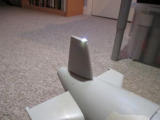

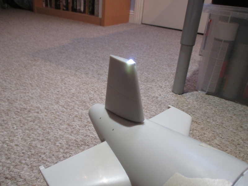

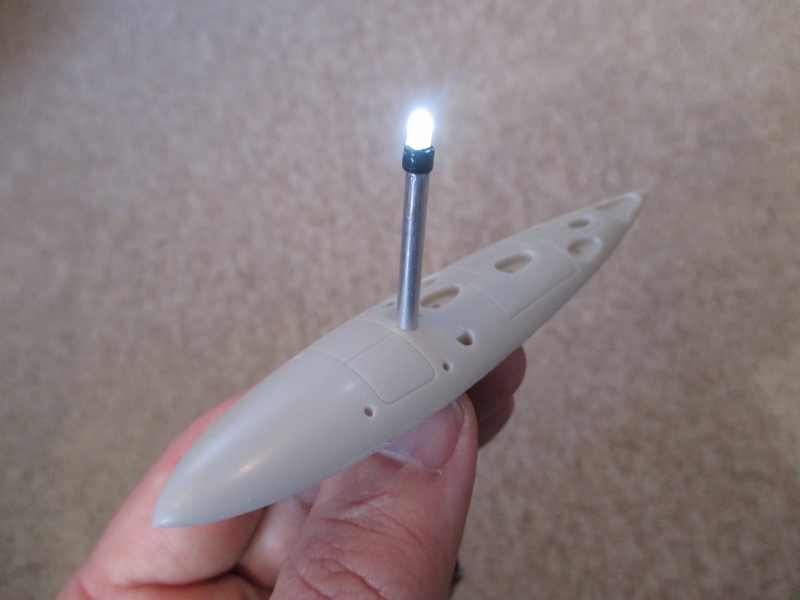

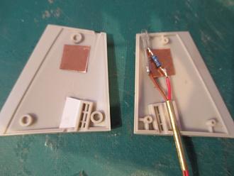

    I'm adding details I didn't do last time...........the mast light on the tower, a bit over scale.
    Click image for larger version  Name:	IMG_1998 (800x600).jpg Views:	1 Size:	230.7 KB ID:	132120Click image for larger version  Name:	IMG_1999 (800x600).jpg Views:	1 Size:	187.7 KB ID:	132121

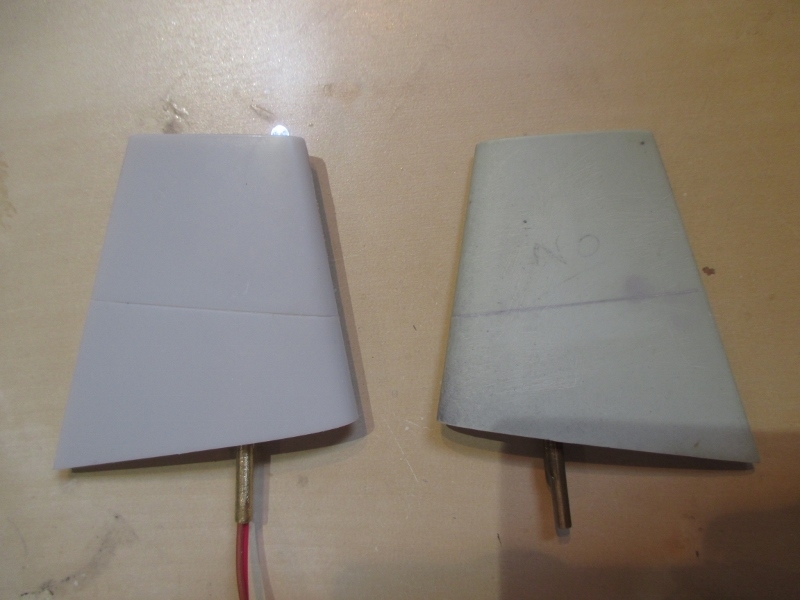

    It matches the tail light on the upper rudder.
    Click image for larger version  Name:	IMG_2008 (800x600).jpg Views:	1 Size:	256.9 KB ID:	132122Click image for larger version  Name:	IMG_2009 (800x600).jpg Views:	1 Size:	222.0 KB ID:	132123

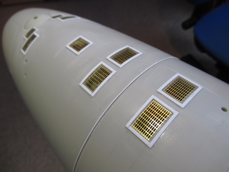

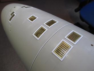

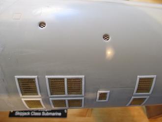

    I've a few bits left over from the last build, enough to scratch the gratings on the lower hull.
    Click image for larger version  Name:	IMG_2001 (800x600).jpg Views:	1 Size:	212.8 KB ID:	132124Click image for larger version  Name:	IMG_2002 (800x600).jpg Views:	1 Size:	222.8 KB ID:	132125

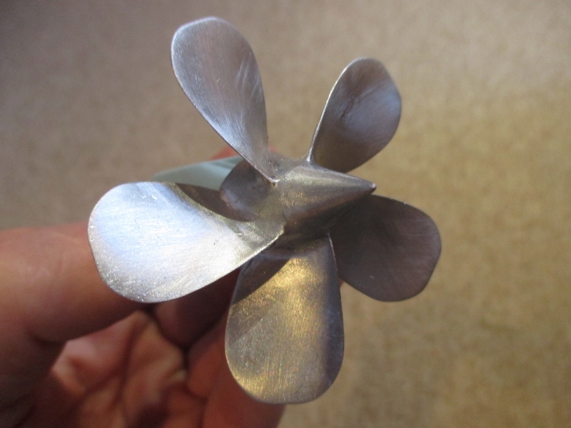

    My good friend David sent me a package all the way from the USA to Ireland, including this cracking prop..................
    ........ here it is polished and ready to go.

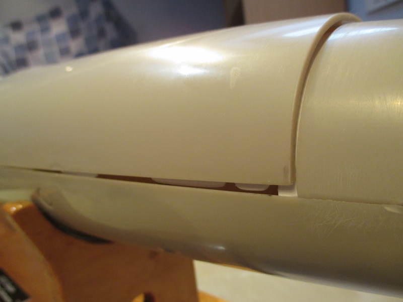

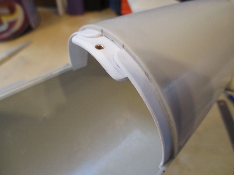

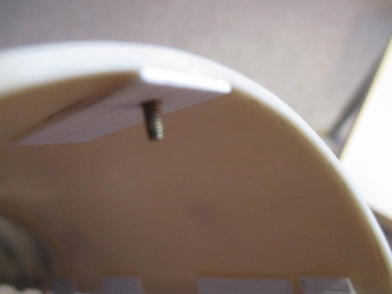

    This is how much warping I'm having to sort, suggestions welcome!

      Rob,
      Could you make your pin face up and hook that under the front lip? That would pull it down and lock it in place. (aside from the obvious of trying to heat it and bend the parts)
      tom

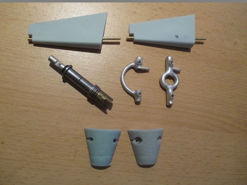

        Too late to get you those, stern control surface yokes?
        • The Boattrainman
          • Mar 2016
          • 443
          Hi Tom,
          The locking bolt pulls the hull downward at that point and works fine, but then the side bulge outwards a bit.
          It's weird, if you look at the top pic, it looks like the top and bottom hulls are two different shades of grey plastic.
          I tried heating with a powerful hair dryer inside the hull, but it was making the warp worse!!!!
          I can work with shims of styrene and lots of sanding, but I don't think this one will be perfectly round unless I can de-warp the middle hull.

            Hi David,
            No dude, just starting out on the Skippy, that's all the progress to date. Alternating between this and the Type XXXIII, any rear parts available would be helpful, especially those yokes, reallly tight space in there my usual 3mm brass and plastic cranks don't fit.
            Thanks.
              Hi David,
              Thanks.
              Excellent. Send me your mailing address. dmeriman@aol.com

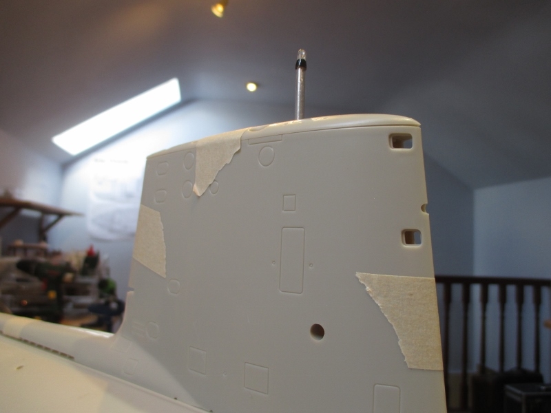

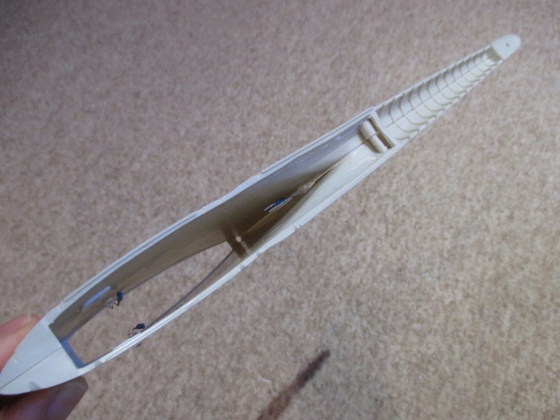

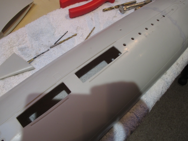

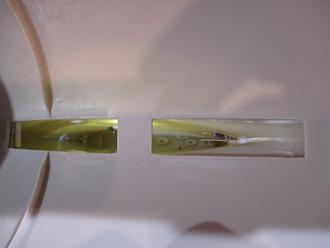

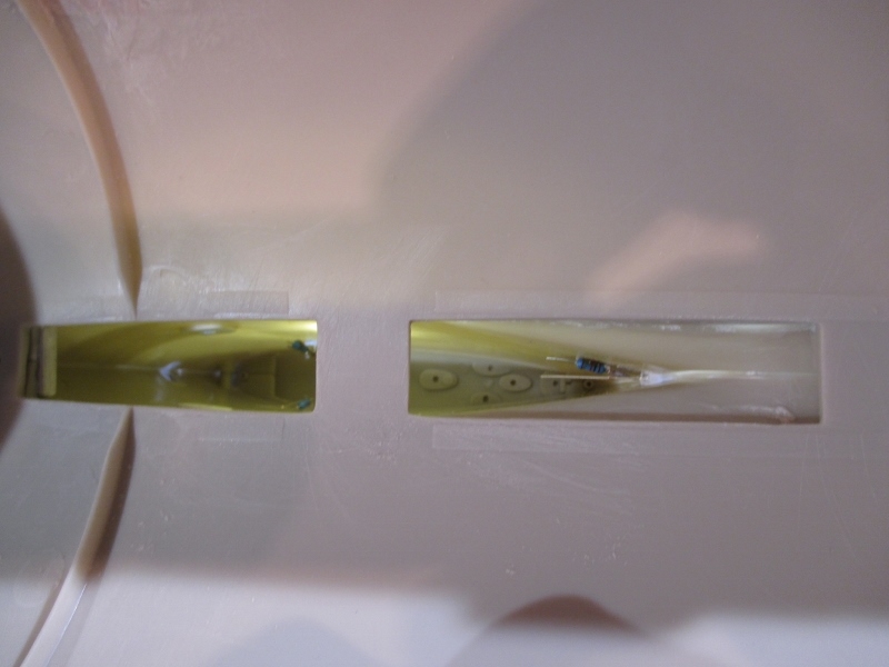

                Work on the tower continues, I removed the entire bottom section of plastic.....
                Click image for larger version  Name:	IMG_2012 (800x600).jpg Views:	1 Size:	278.3 KB ID:	132275
                ...............and two large slots on the hull top.........
                Click image for larger version  Name:	IMG_2013 (800x600).jpg Views:	1 Size:	245.6 KB ID:	132276
                .......this give access through the upper hull into the tower, I'm gluing the tower to the hull on this one.
                Click image for larger version  Name:	IMG_2016 (800x600).jpg Views:	1 Size:	198.6 KB ID:	132277

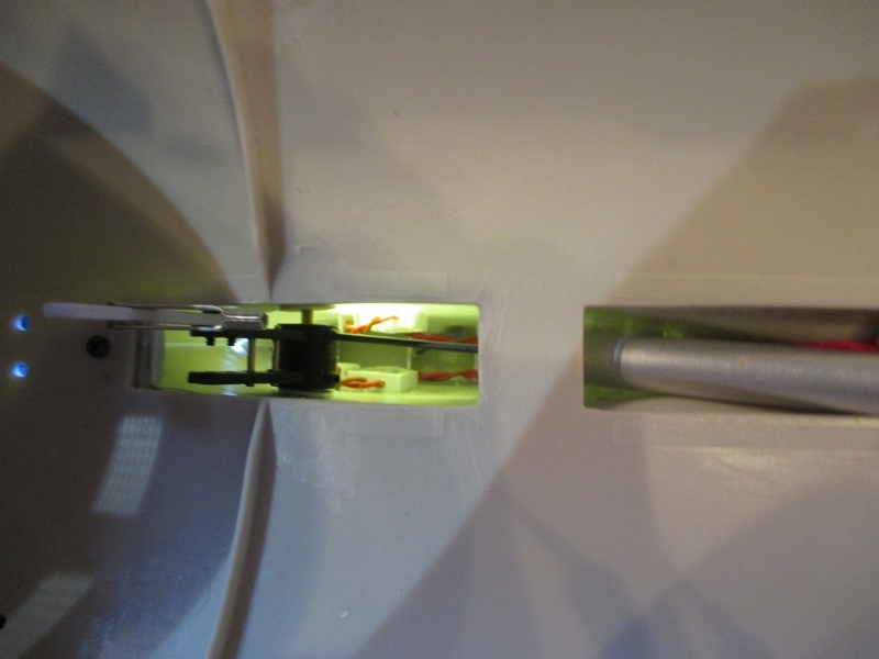

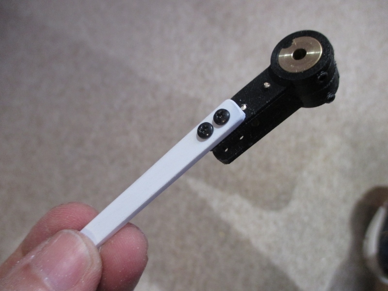

                The diving planes on the tower are activated by my usual twin tiller arms glued together with a long extension arm, each dive plane has 3mm rod that slots into each tiller, and the second slot in the hull is so my allen key extension will reach the grub screws.
                Click image for larger version  Name:	IMG_2024 (800x600).jpg Views:	1 Size:	234.4 KB ID:	132278Click image for larger version  Name:	IMG_2025 (800x600).jpg Views:	1 Size:	229.8 KB ID:	132282

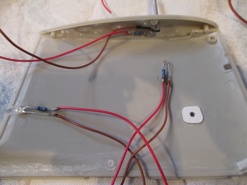

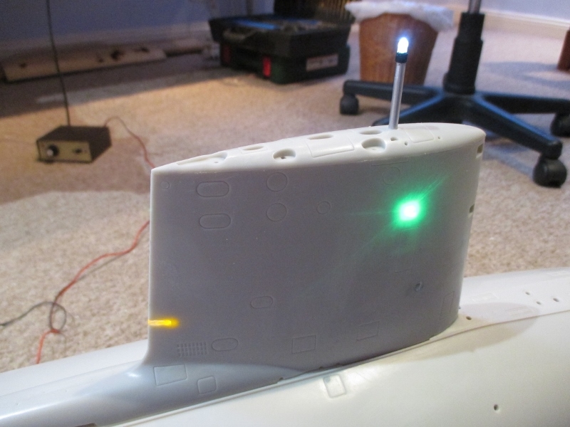

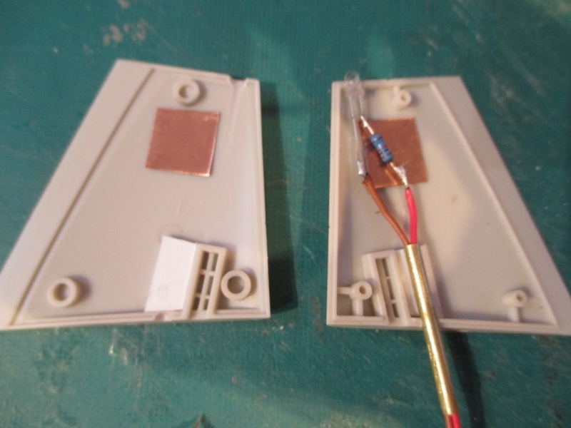

                The lighting (3mm LEDs) are attached............
                Click image for larger version  Name:	IMG_2017 (800x600).jpg Views:	1 Size:	249.5 KB ID:	132279
                ...............I added an off white/orange in the triangular window at the conning tower rear for the hell of it.
                Click image for larger version  Name:	IMG_2020 (800x600).jpg Views:	1 Size:	256.1 KB ID:	132280Click image for larger version  Name:	IMG_2019 (800x600).jpg Views:	1 Size:	270.6 KB ID:	132281

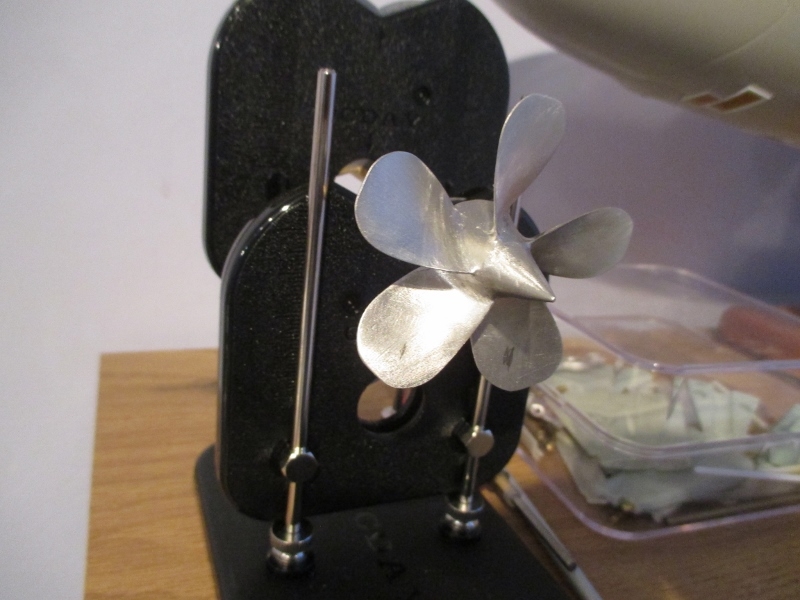

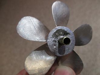

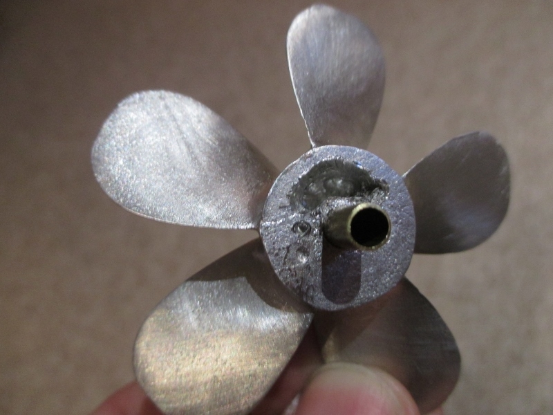

                        I've been balancing the props on my surface skimmers as I got this balancer recently..............
Name:	IMG_2035 (800x600).jpg
                        ......the brass props only needed a tiny piece removed from the rear of the boss to get them right, however...............
Name:	IMG_2036 (800x600).jpg
                        ...............I've had to take a massive chunk out of the Skipjack prop, and while it's a lot better, it's still outa whack.
                        Getting so I don't want to take any more off, don't want to damage it or compromise the shape.

                          Should be OK; unless you're planning to water ski behind that boat.
                            I expect your brass props have a much smaller boss?
                            • The Boattrainman
                              • Mar 2016
                              • 443
                              Yes, deffo, the brass ones are smaller and I don't think it's a major problem if it's a small bit out, not like a model airplane prop.
                              Anyway, I've taken off as much as I dare and it certainly doesn't wobble anymore when spun by hand.
                              Will fill the void with epoxy and sand over.
