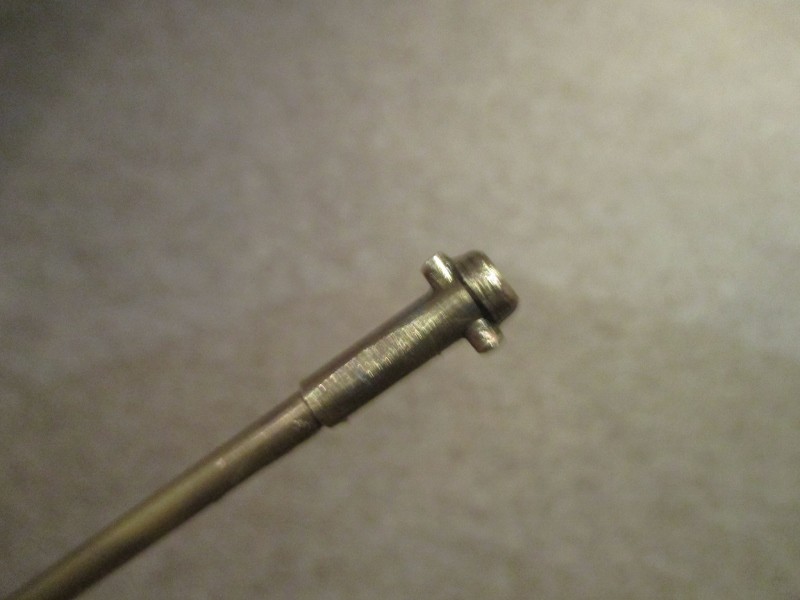

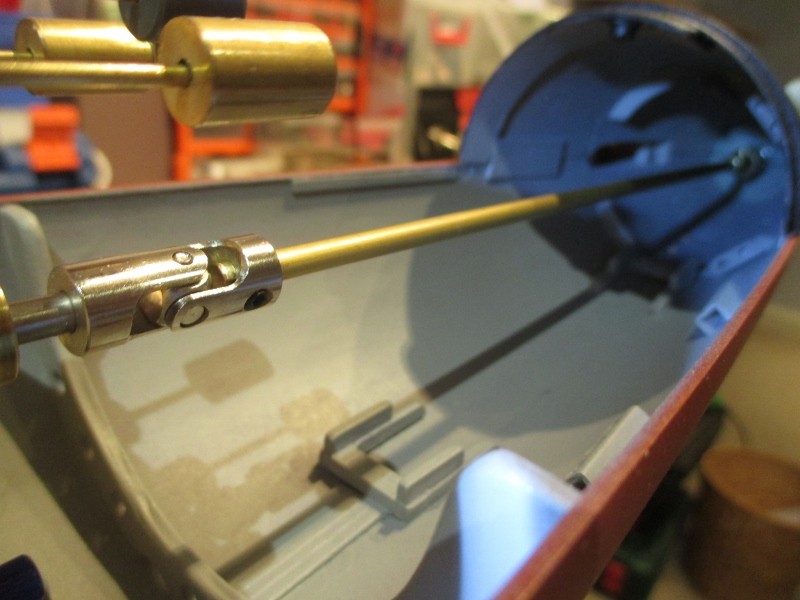

    I spend an enormous amount of time setting up the shaft and prop, and in doing so discovered my homemade prop was wiggling around in the mini prop shaft housing at the prop end.
    To fix this I added a tiny collar to the brass dogbone fitting, only 3mm wide......
    Click image for larger version  Name:	IMG_2135 (800x600).jpg Views:	0 Size:	82.1 KB ID:	138465Click image for larger version  Name:	IMG_2136 (800x600).jpg Views:	0 Size:	61.2 KB ID:	138466
    ........it stopped the wobble and a lot of rattle at the back end, amazing how a small addition can make a big change.

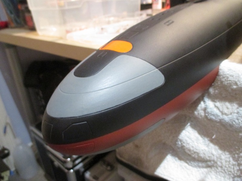

    I brush painted the emergency bouy access hatches and the sonars, easy as there is a panel line around them, 5 very thin coats was needed.

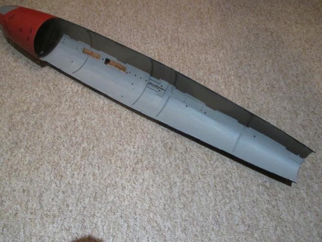

    I also brush painted some thick enamel onto the interiors of the shells, I find that the insides get bashed about a lot over time, plus it looks nice (even though no one will see it).
    Click image for larger version  Name:	IMG_2133 (800x600).jpg Views:	0 Size:	51.7 KB ID:	138468

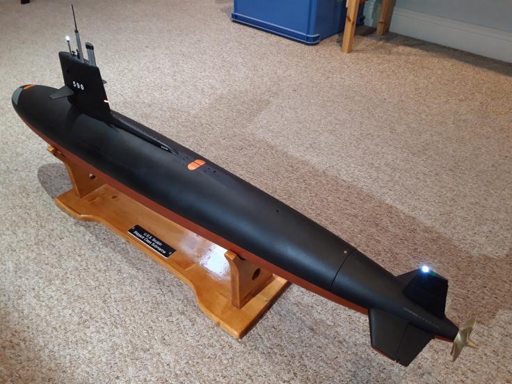

      All the electronics are in PMO, but my LIPOs were puffy so they have been binned.
      Lots of work to get it finished, depth markings, light weathering, and it's only trimmed for the surface so out with the dreaded ballast foam.........

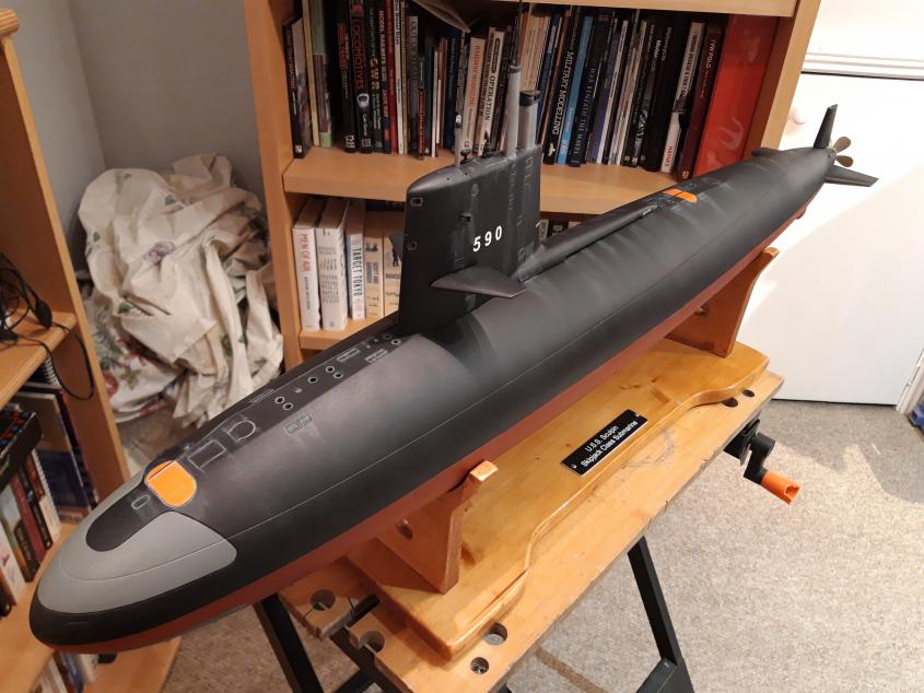

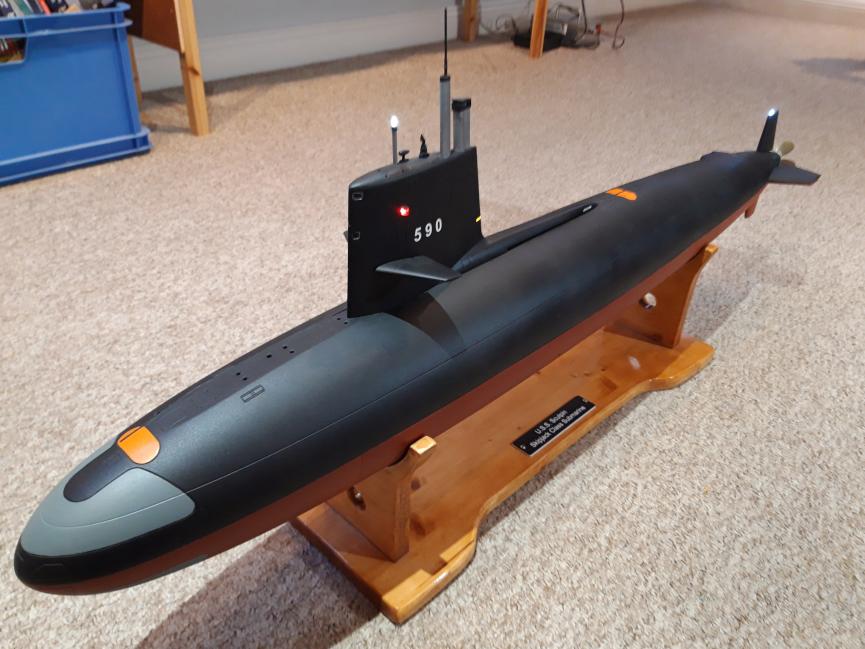

        So the start of the weathering, lots of grey/white salt wash. I also put some metal grey paint on a shaving brush and drybrushed the whole black part of the hull, not subtle but it gives a slight metallic sheen, will add some more shading when this dries.

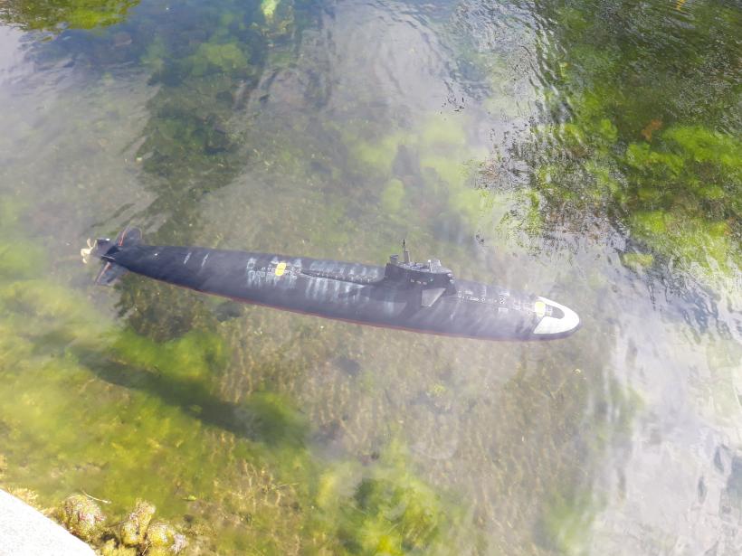

              #36

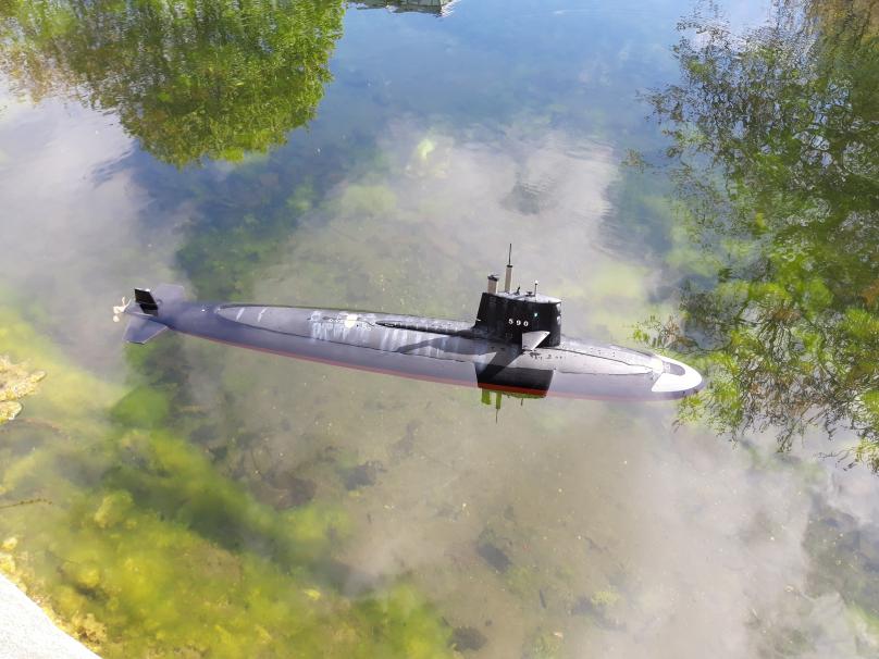

              On patrol with the Skipjack.
              Surface trim is fine if a little low, the R and R WTC has only 450ml of capacity.........
              .........submerged is set just below the scope depth.......
              ..... but still a bit of servo twitch to sort!

                Tone down the upper hull streaking with a good misting of the base color (black). Looks awful!
