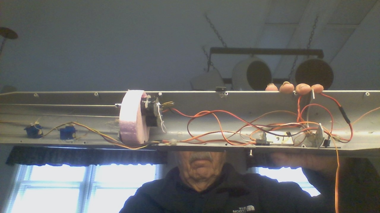

                      I did a web search of gas generating Baking Soda & Vinegar type generators. I suddenly realized a calibrated fuse of some type is needed. Not interested in doing any more dives in my underware with a 12" cinder block.
                      81 years, 6 stints, Pacemaker & Defibulator. I think I will just do a static diver..........Bad luck ? I will be buried at the lake.

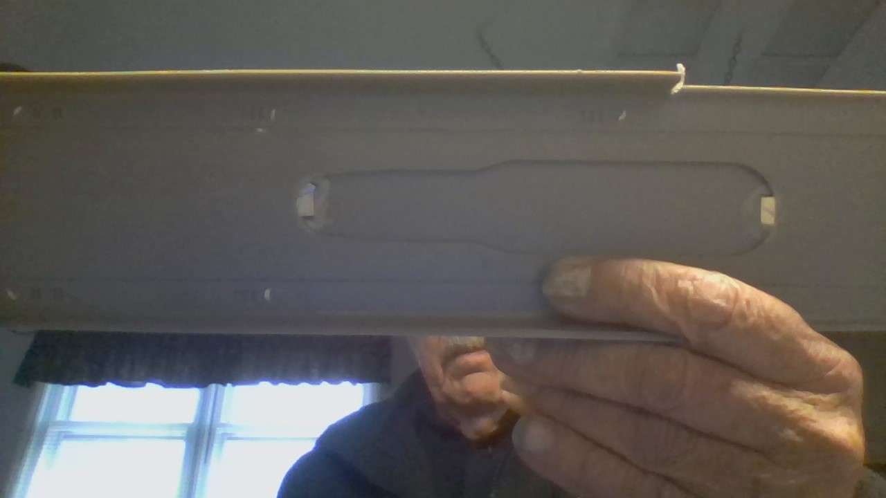

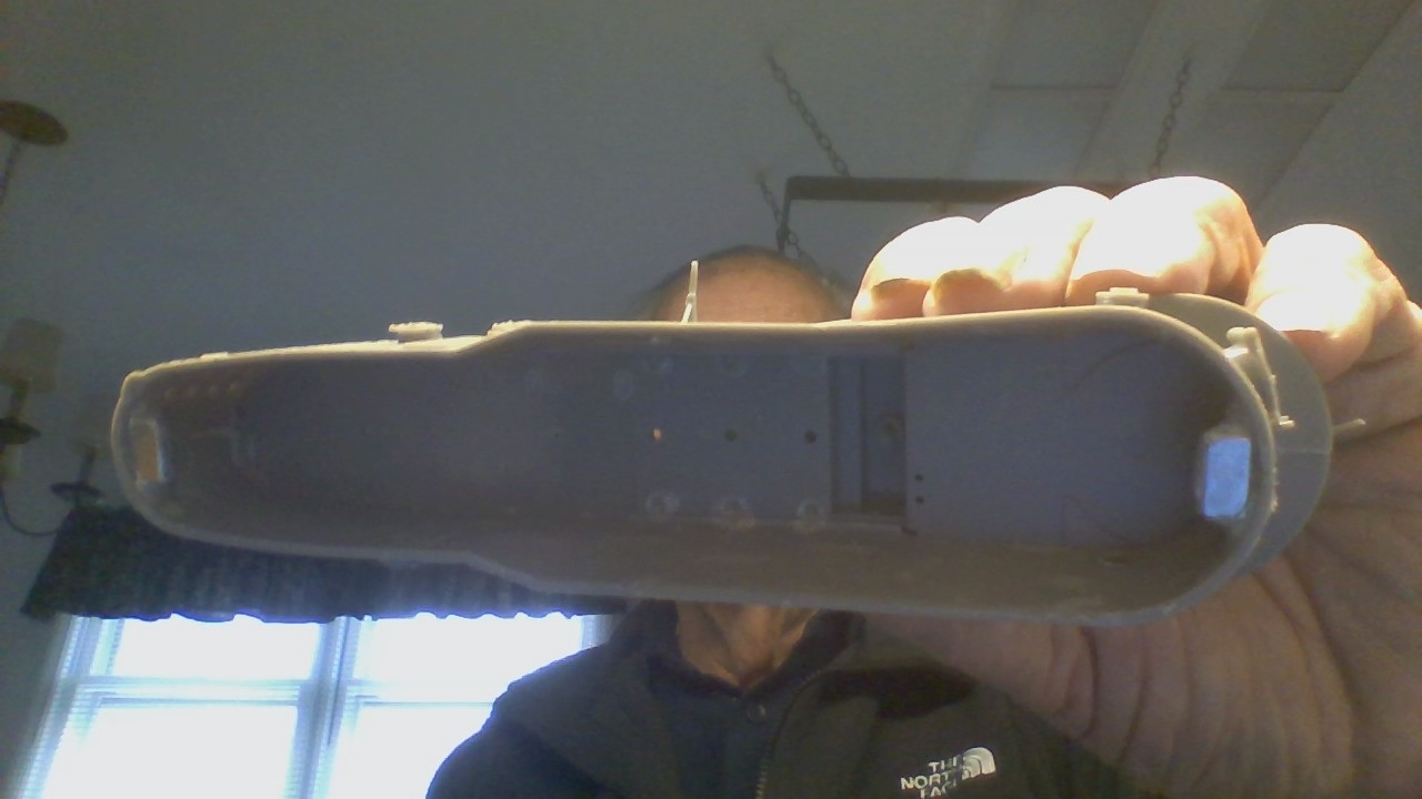

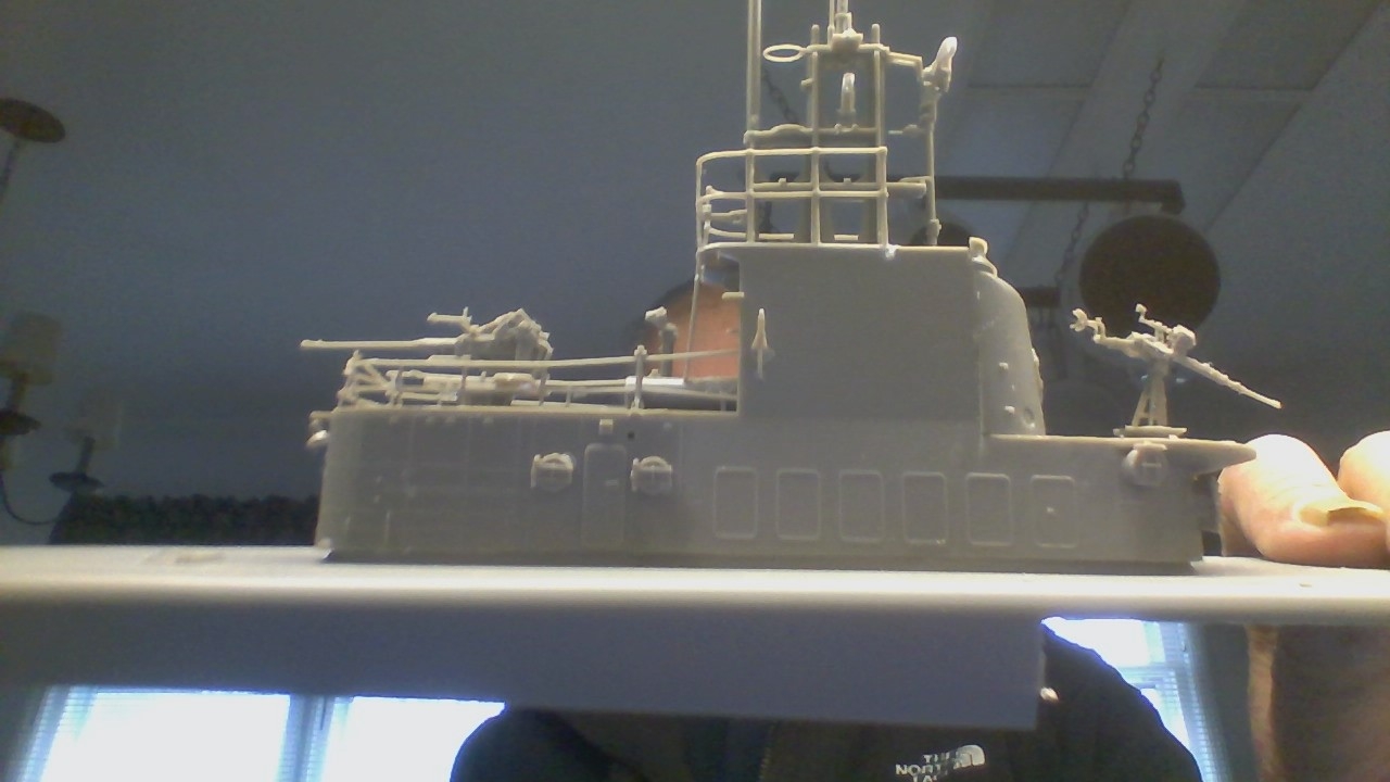

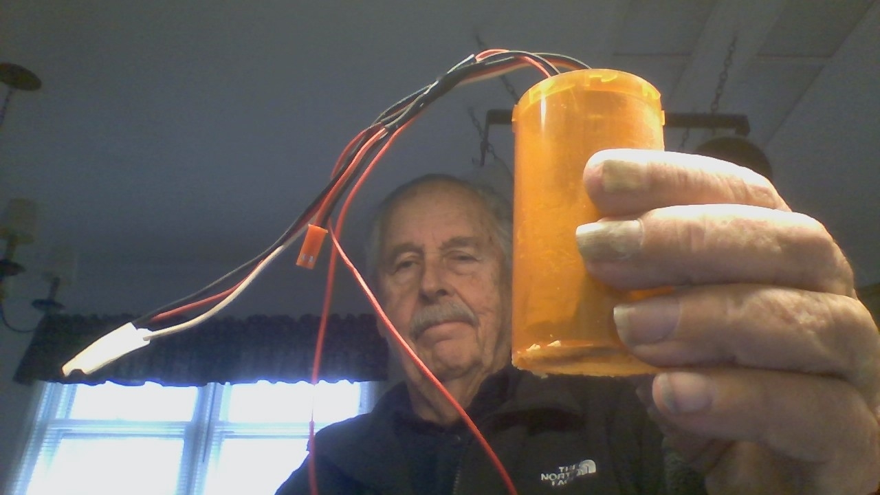

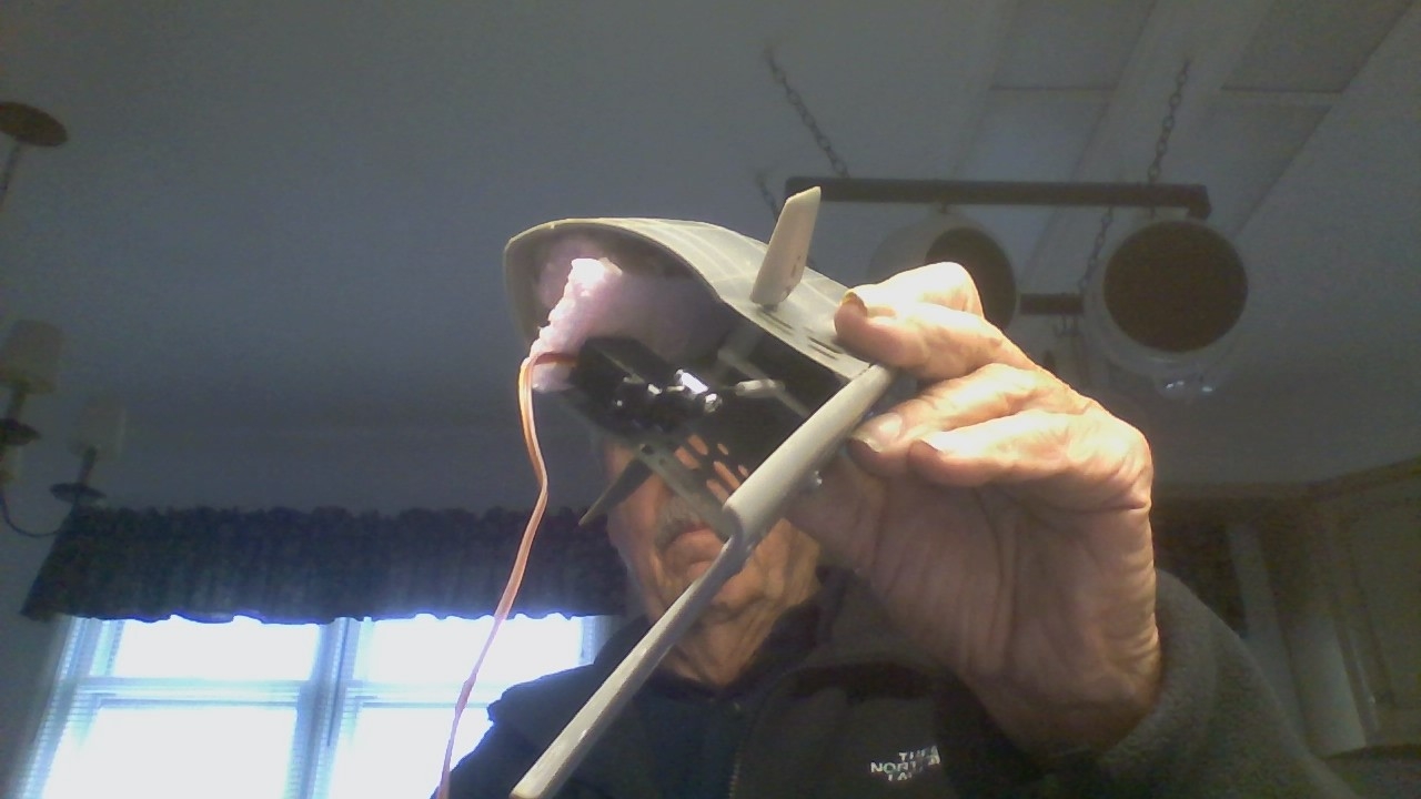

                      I decided to just do a wet system of motors- sealed by RTV coating. RTV & grease of all servos. Soldered servo wires covered with Hot Glue. 2 A123 1100 mahr cells power everything. Rc is a FM 4 channel .
                      The 2cells & receiver & ESC are in a drugstore pill bottle. Spring loaded caps are very good.. The drive shafts & couplings are S S.
                      Pictures are from doing submerged water tests during constructions.
                      I will add closed cell sheets of blue dock foam to get her balanced. The hull sections are held together with plastic straps across the seams. All are covered by the main deck plates.
