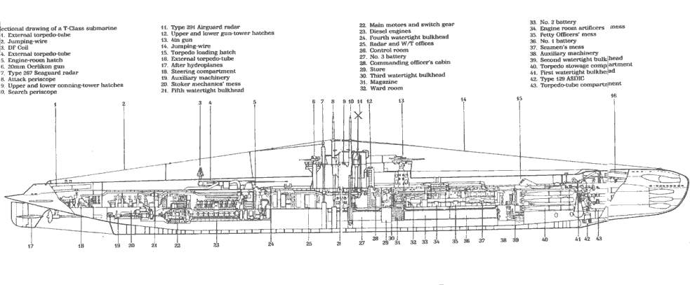

              ADF receivers are used in Fullscale subs, not RC models.
              The ADF Antenna is something that can be put on WW2 aircraft, ship and sub Models to make them look more realistic.
              A good way to locate where you are in the world, at that time, by tuning into 2 or more radio-station transmitters of know location (position triangulation).
              The Direction-finder Antenna is labeled #3 on this drawing of a WW2 British T-class sub (mounted on aft deck with a large triangle shaped antenna coil element, sort of a Christmas-tree shape):
              (On most US and German craft the antenna coil has a smaller round shape, tho. The Revell Gato model has a round-hoop shaped ADF antenna on upper tower. In the German VII the antenna could be lowered into wall of tower/bridge to protect it)

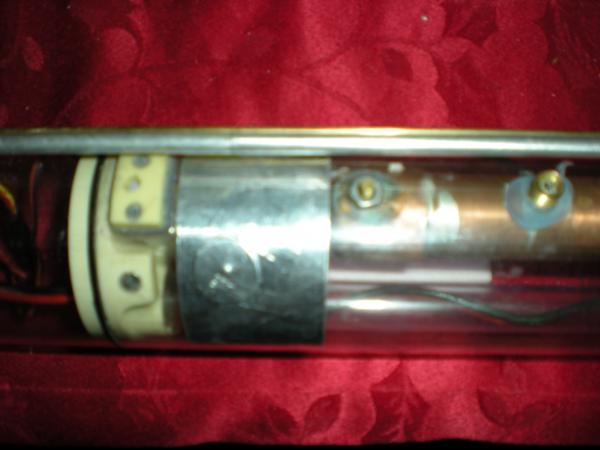

                              Looks Great! You even attached antenna-cables on deck. That's being very brave! :)
                              I'm curious what the metal-plate is for, in the ballast chamber of the SD?
                              Is it a deflector for the cold gas?
                              See Pic:

                                it is where SD cracked .drilled holes to stop cracking and sealed with alum: tape and silicone
