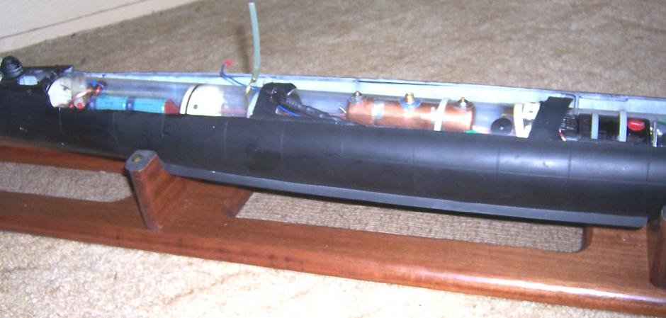

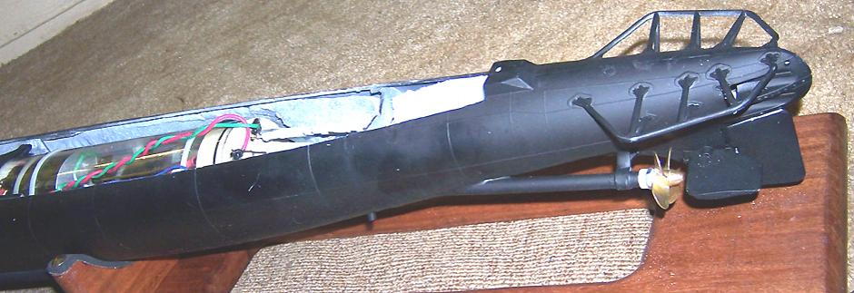

    Boomer, you asked about separation cut being high on hull, so seam would be hidden by Deck/cover assembly.
    So I thought I would post some pics of my Hull, to which I did that.
    Just need a steady hand using a dremel-saw, which can be dangerous, if not careful.
    When installing SD, the hull has to be flexed open a little to get it past upper lip, at aft end, but not much. (Maybe 1/8")
    It worked out Great, no problems! :)

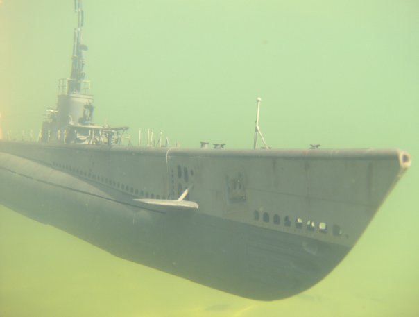

              I got more pool time with the Gato today.
              Once I was cruiseing along about 3 feet down and all a sudden she shot to the surface very fast.
              It must of had the first actual test of the loss of signal failsafe. I had tested it before by turning off the transmitter but it didn't surface that fast then for some reason. May have had more gas in 'er belly this time. :D
              Anyway everything is still working perfectly and we had great fun with it. :)

                  • 14013
                  Was it the first blow of a fresh charge? for some reason the fist squirt out of the bottle is of a higher pressure than all subsequent shots.
                  You operating in heavily Chlorinated/Salted water?

                    Yes, it was the first blow. I was just using the Snort before that.
                    I was at my neighbors pool so don't know what he has in it.

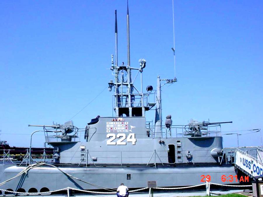

                              Be sure to open up the Access Doors on both sides of the fairwater. There were NO doors on operational boats, just an "Access Arch". This will give you some additional "breathing" ability if you also open up some of the deck under the fairwater. Also, but it may be too difficult for you to do now, on the 1:1 boats there was 3/4" clearance between the deck battens which allowed more flooding/venting space through the deck. The metal deck portion had holes drilled out for venting too.

                                The open access doors Boomer is talking about can be seen in lower-right of this pic of the USS Cod:
