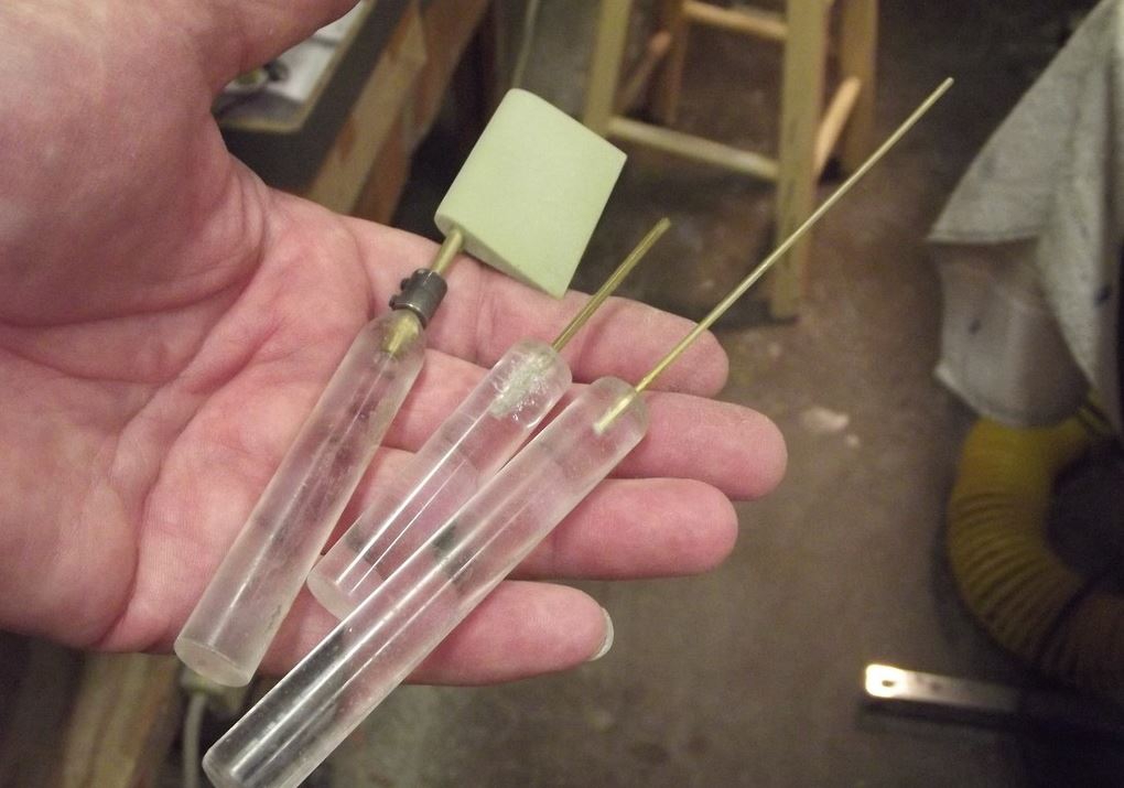

        Are these mandrels for the planes and rudder stock bores?

          Exactly, Bart. Over here in imperial-measurement-land the typical bores for control surface operating shafts range between 1/16", 3/32", 1/8", and 3/16". Yes, mandrels or 'handles' that make it a much easier task to work these smallish items with file, sand paper, and painting.
          Here are some commercial and hand-made hand-vices I use to hold no-bore small work:
