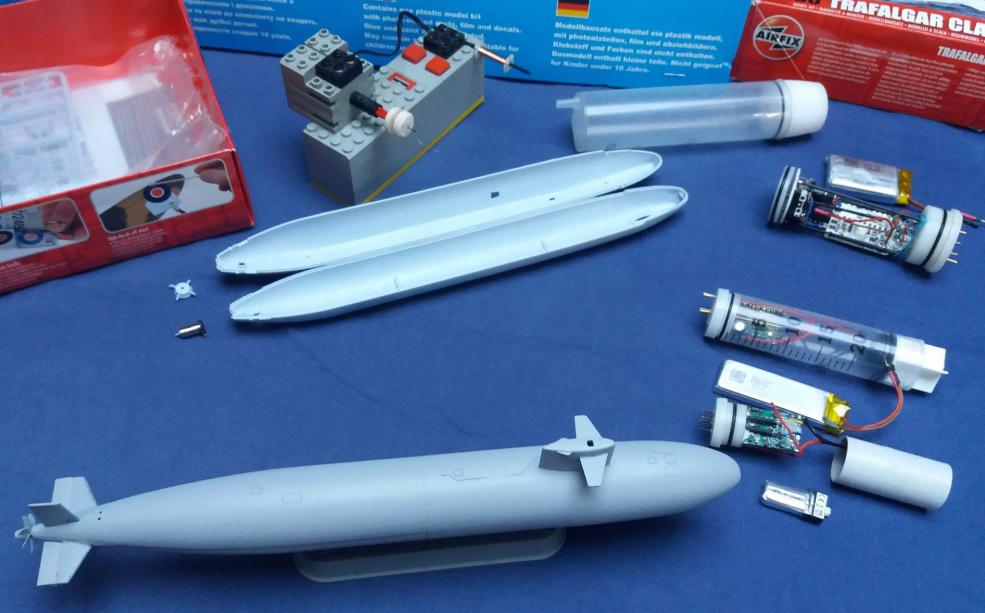

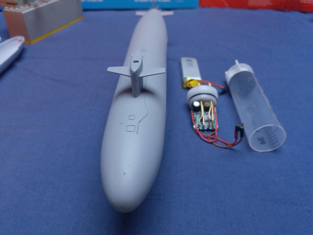

        I think i went a bit over the board with this... I've recontoured the bow, installed a new coil, installed movable stern planes, made a new micro wtc with a 20 ml syringe wich can hold a 550 mAh lipo, installed those ears on the sail, scribed a couple of details on the deck and done safety rail with copper filament. Just shot some primer: scribings are too deep but clean enough, they will be partially filled by clear coatings.
        I'm very happy with the new wtc: can slide back and forth and with adjustable buoyancy makes finding correct attitude and balance a snap. All i had to do was to guesstimate a foam block dimension, shape and glued it and move a couple of times the front manual piston.
        This flexibility allows me to convert almos all 1/350 nuclears and even the kilo: when there is no space for a magnetic rudder i will use a stern thruster for steering.
        I've picked up Airfix Trafalgar as next project, already found a perfect 5mm coreless motor and done the coil. Probably I will be able to retain the original moving stern and front planes, stay tuned!

                Thank you sir! No peristaltic pumps here, sir, just good-ole dynamic diving. But, maybe , you are referring to the thing you can see in the upper right corner: it's Akula's 30 mm wtc, it varies it's volume by moving the fwd bulkhead fore and aft. Below that you can see the new, high capacity 23mm diameter 2,5 ch wtc. Here too the fwd bulkhead (aka trimmed syringe piston) can be moved but manually, to assist in trimming and compensating water variation density wich at this scale is quite important. And below that you can see the first little 2,5 ch wtc wich is 19,7 mm diameter and holds a small 70 mAh battery.
                Now, something cool about those small bang/bang TX/RX sets is that you can easily waterproof TXs and swim with your creations
