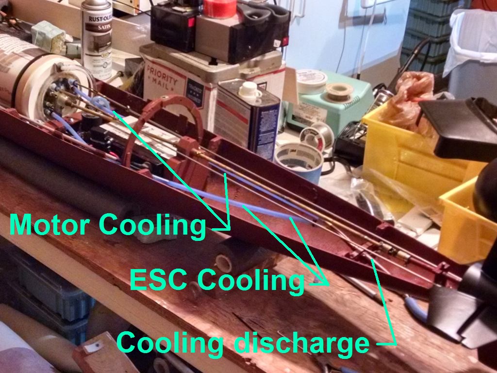

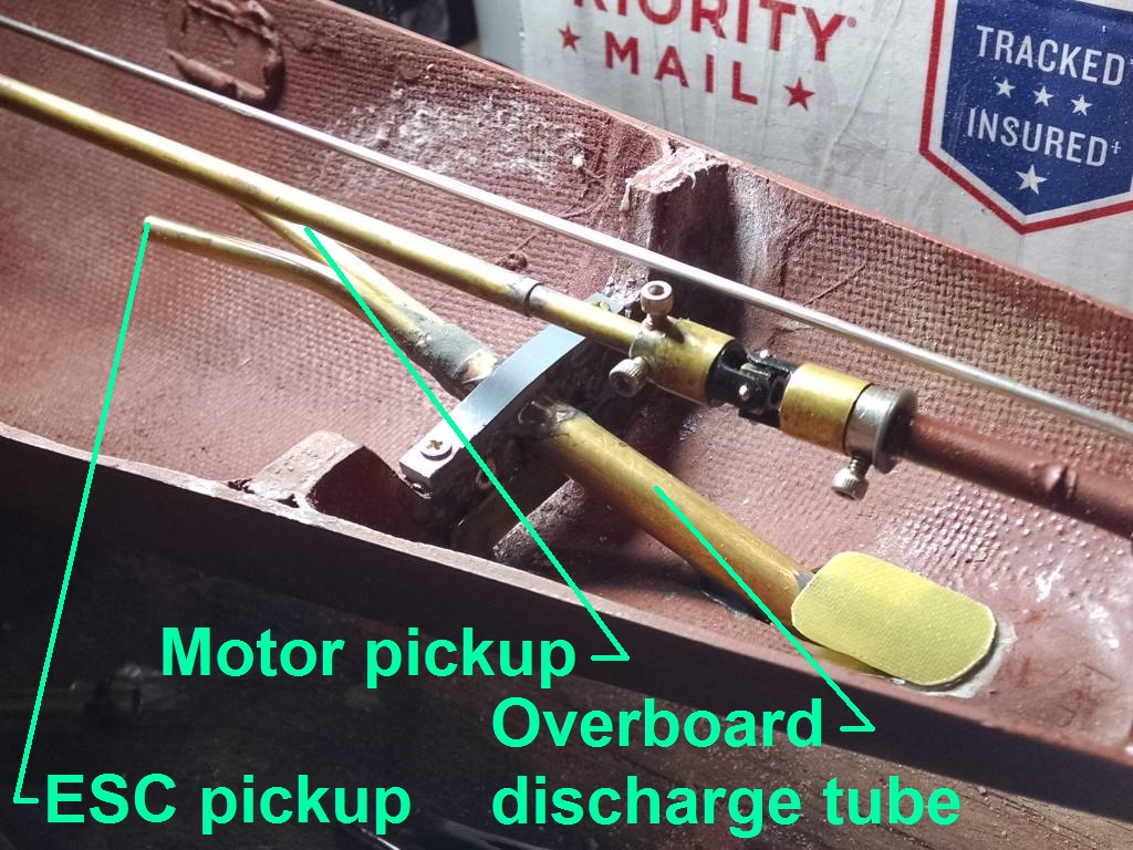

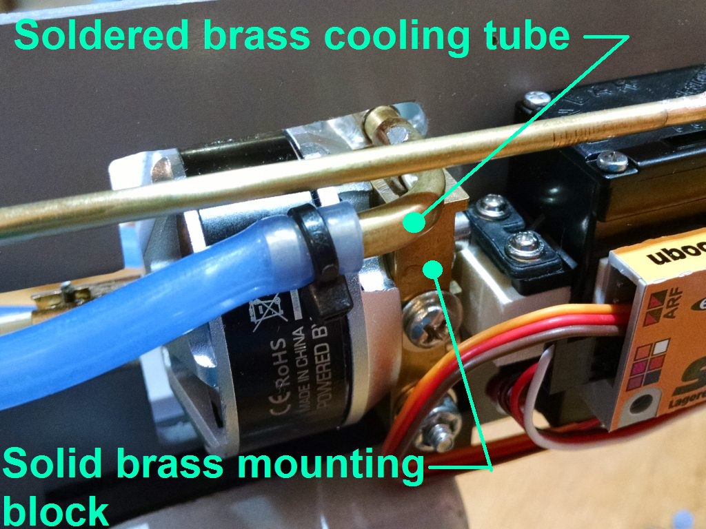

                        Excellent Video and run. Must be all your advanced preperation that kept problems few at the Regatta. Just keep your eye on that small brushless motors temperature. It may produce good power but it can also overheat in a hurry. Just sayin.
                        • QuarterMaster
                          • Sep 2015
                          • 1235
                          Rgr that, hence the water cooling brass mount seen in the first video. It's a passive system. The motion of the boat through the water naturally draws water through it. The faster the boat moves, the faster coolant flows through the motor mounting block. The ESC is cooled as well.
