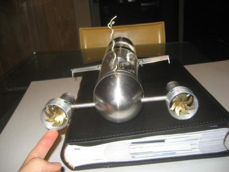

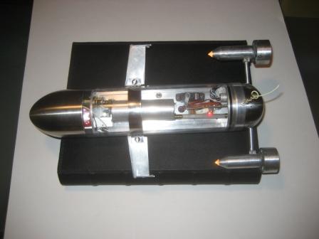

    These are two RC submarines that I build while in high school with the help of a bench lathe and mill and lots of birthday and holiday money.
    The silver one has a dynamic diving mechanism (aka: piston tank)
    Will try to post video of submarines in pool.

    The silver one looks like a Flash Gordon ship.
    Can you share some technical infos about your subs.
    BTW, piston tanks belong to "static" diving system.

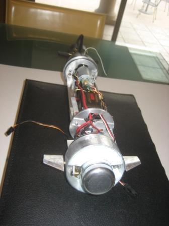

      You are correct. Static was the word I meant.
      Technical Data:
      Silver Sub:
      Length: 12"
      Weight: 5lbs
      Uses two Direct Drive 250 motors
      Axis where motors are mounted pivot and allow the sub to roll and do some fun tricks.
      Max diving depth limited by RC transmitter
      Uses automatic level to bring sub back to horizontal.
      Really simple and easy to use.

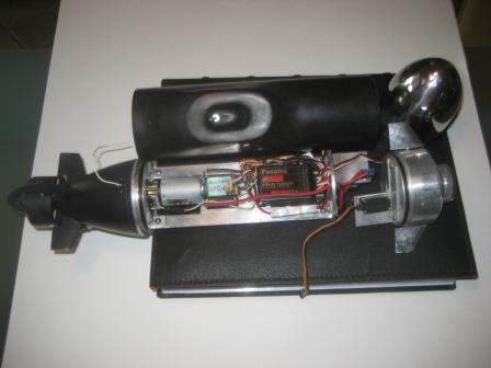

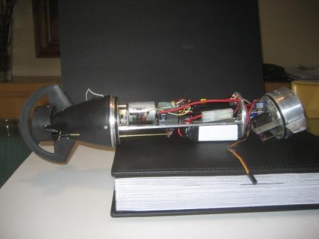

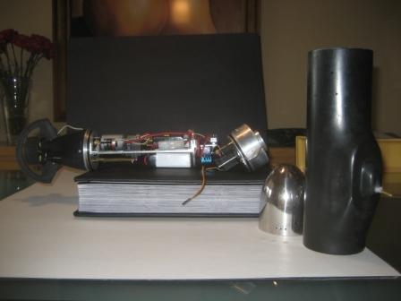

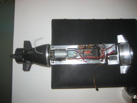

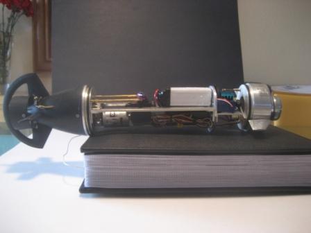

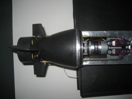

      Black Sub:
      Same size as Silver.
      Detail seen in pics.
