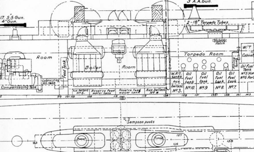

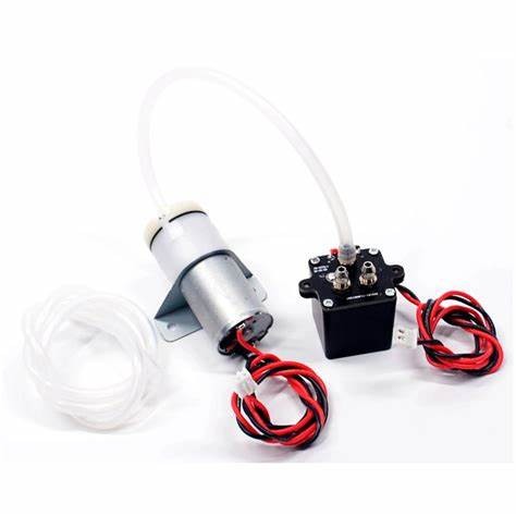

        Two chimneys retract? Looks interesting, this WWI submarine has a lot of interesting features, it shouldn't be hard to make the chimney retract, but it would be a little difficult to add a smoke generator. It's really cool to have smoke generators spewing white smoke with the throttle, the rc tank smoke generator will do it, maybe extra check valves are needed to prevent water ingress, but these smoke generators tend to be large and will be a waste of space on a 2.5'' SD, maybe it won't even fit.

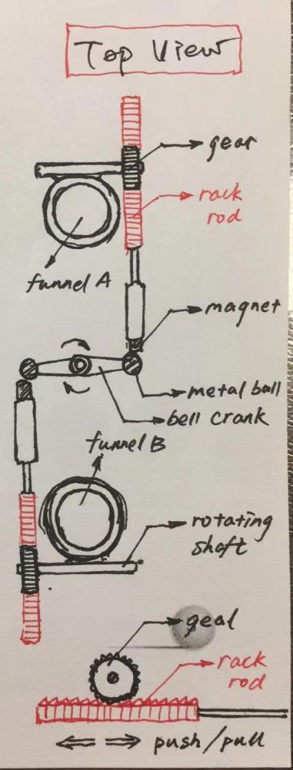

        So I think it can be as simple as possible, the following is a simple chimney retract top view:

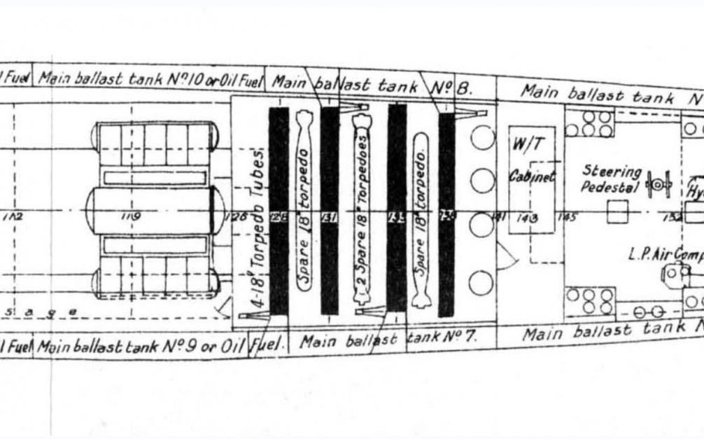

        I think the strangest thing about this ship is that it has 4 fixed beam torpedo tubes, 2 on each side, which is very different.
