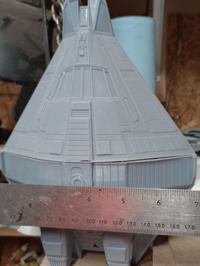

                  4k and 8K are only resolution of details. It doesn't have anything to do with the size of the print. My 4k Saturn will make prints the same size as the 8k and the 12k Saturn. The only difference is the detail. And like I showed the 1mm cigar has ashes. I can print 1 complete hull sections as well this escape shuttle is almost 7" wide and I can print roughly 7.5"h x 4.5"d x 7.75"h. That might leave you hanging on some of the larger models for sure.

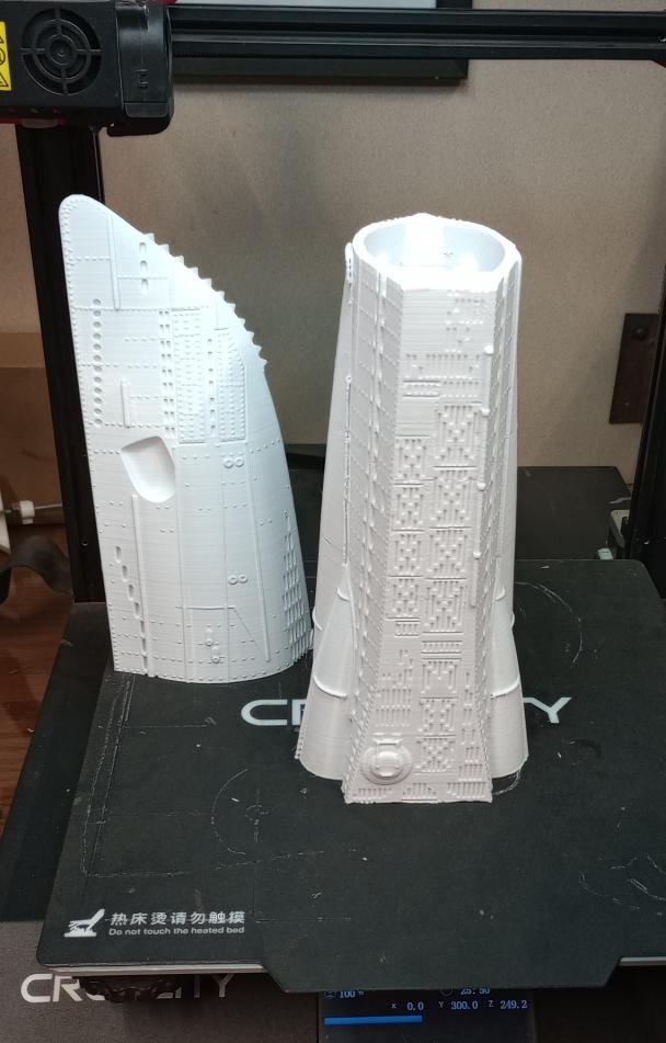

                  I plan to print in ABS after I finish Das Boot in PLA
                  • Wizzard033
                    • Sep 2023
                    • 41
                    Alien escape shuttle Narcissus in ABS like resin and Das Boot in PLA
