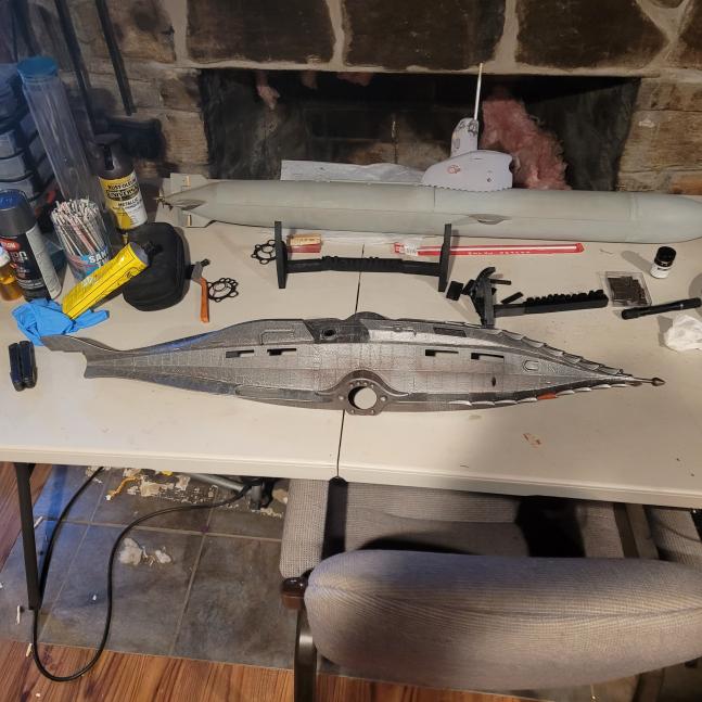

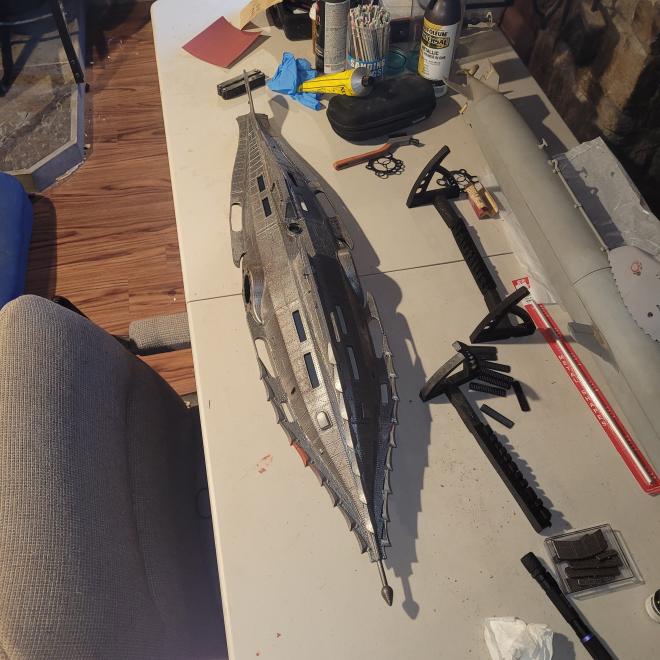

        Current state of work on the Nautilus. Window frames and aft fins are printing now. Took the aft keel and the mid rakers off the build plate and post processed them this AM.

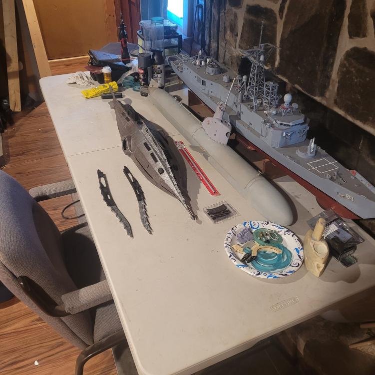

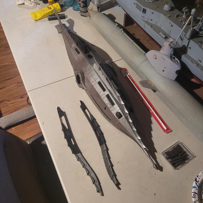

            Been more than a few busy days, but I got some work done over the last 2 on the Nautilus. So the scale works out to be 1:63 with the 60% scale of the model parts in Lychee. I have been using a syringe with the elegoo resin in it, and a UV flashlight to fill in any small gaps left after gluing the rakes and the keel in. I am using spot and glazing putty on areas that the resin will just flow through.
            I also started printing up the stand pieces. Those are going to need some love in the joint areas, as I am unwilling to reprint these for minor imperfections.
