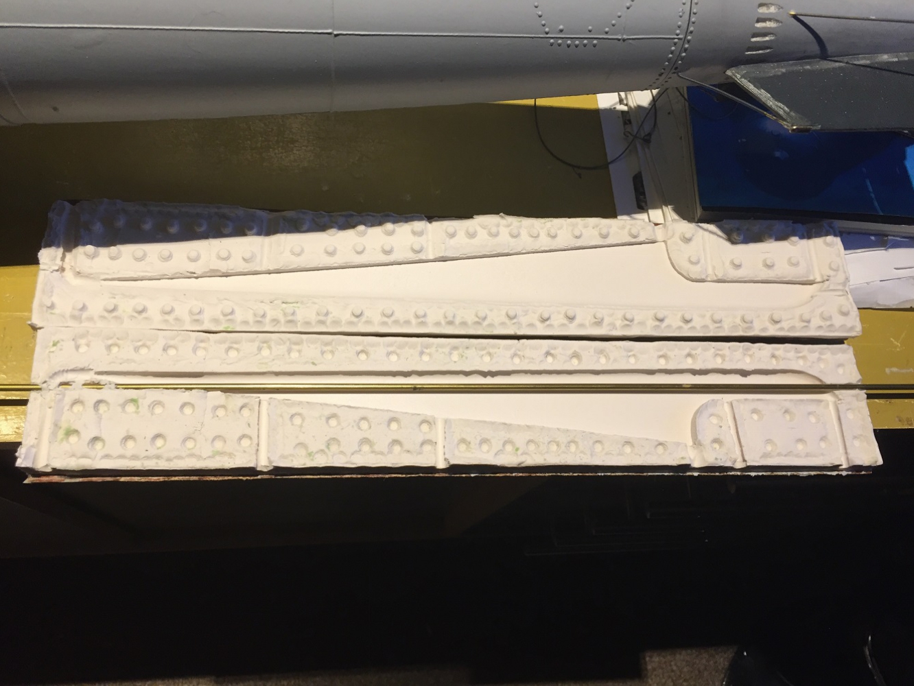

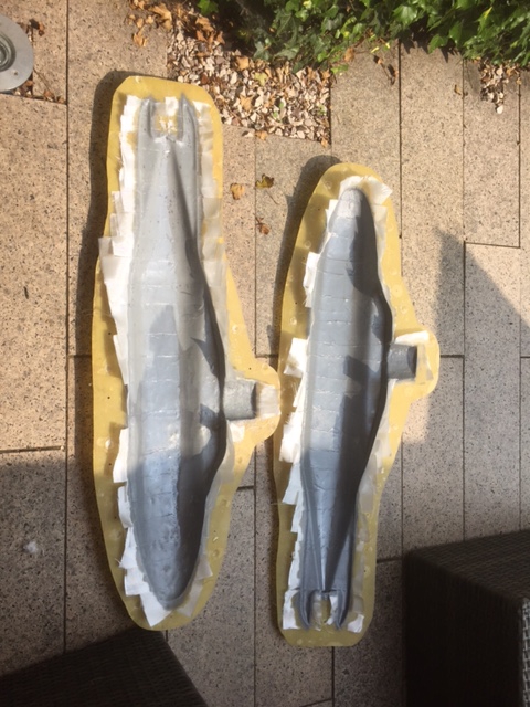

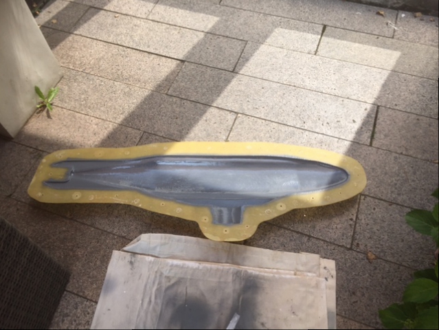

                As you guys know David had lost the first hull i made for him in a flood, so i promised him a new one, build this one in silence and posted nothing about the progress, just mailed David about the progress, now it's save inside his cave i'll share some pics how things went.
                Click image for larger version  Name:	IMG_1467.JPG Views:	2 Size:	214.7 KB ID:	127627

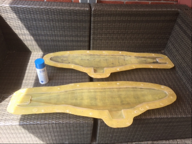

                First stage, cleaning and prepping the molds.

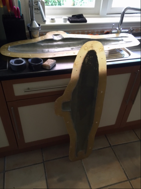

                Click image for larger version  Name:	IMG_1468.JPG Views:	2 Size:	205.4 KB ID:	127628
                Click image for larger version  Name:	IMG_1469.JPG Views:	1 Size:	211.4 KB ID:	127629
                Getting in the layer of gelcoat, the different colours are due of using two batches of gelcoat.
                Click image for larger version  Name:	IMG_1470.JPG Views:	2 Size:	225.1 KB ID:	127630
                Always the tricky part, getting in the first layers.

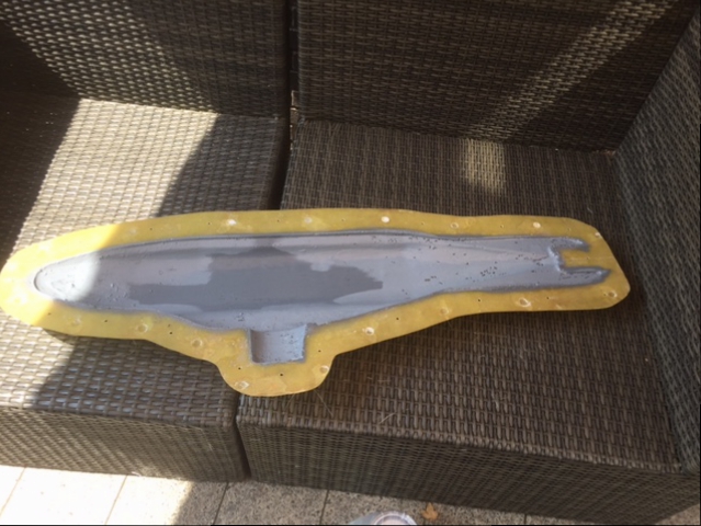

                Click image for larger version  Name:	IMG_1490.JPG Views:	2 Size:	222.9 KB ID:	127631
                Dispite the colour, the details came out better as expected.
                Click image for larger version  Name:	IMG_1493.JPG Views:	2 Size:	146.8 KB ID:	127632

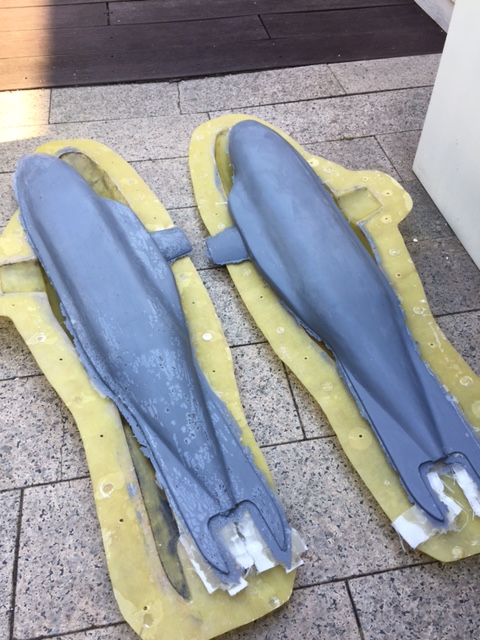

                More work at the hull parts, using the molds to get the edges flush for right fitting, it's not that much work but it secures a tight fitt, only disadvantage is, you're wearing out the edge of the mold due to the wet sanding.
                Click image for larger version  Name:	IMG_1494.JPG Views:	2 Size:	219.9 KB ID:	127633
                But when done you get this as the result, next boat i will pull out of this mold, will be used as master for a new mold, simply because the dimensions will not be good enough.

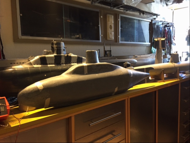

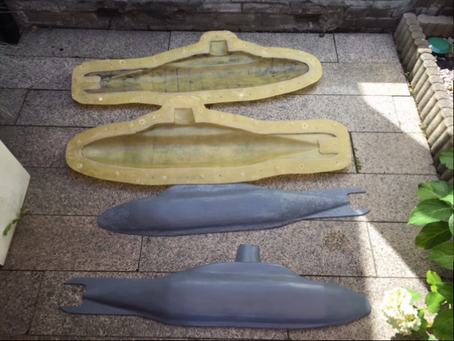

                Click image for larger version  Name:	IMG_1495.JPG Views:	2 Size:	180.6 KB ID:	127634
                Final test-fitt before sending it to David, still funny to see exact the same hulls together.
                This was not the end of the story, in the past i made some silicone molds of the rudder and divingplane, i wanted to add some extra items, but that will be for the next post.

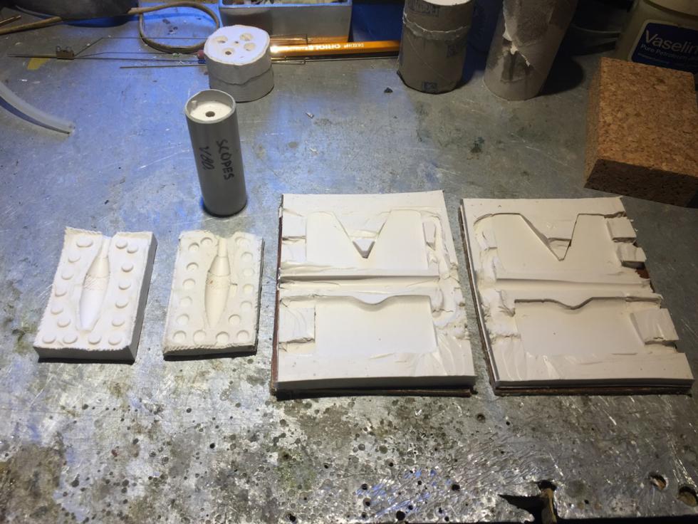

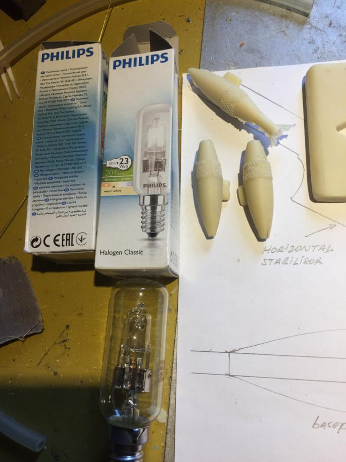

                  The mold on the right i had made earlier, the one on the left represents the O2 exhausts, in the background is the mold of the scopes, i never had intentions to make more molds, but i could not know how wrong i was.

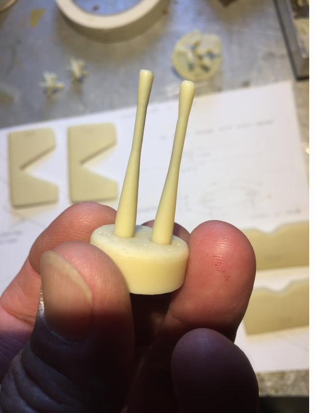

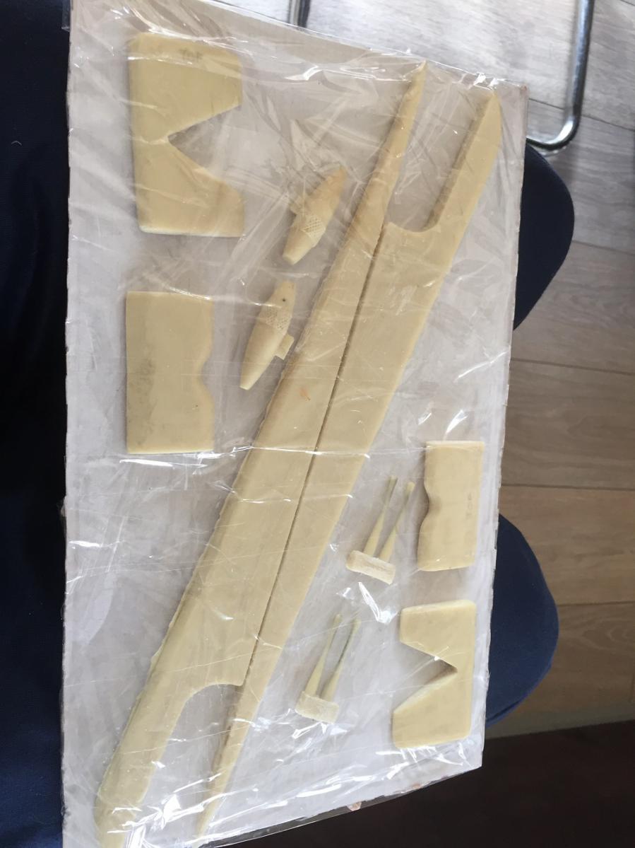

                  This took me some more effort, i still had the wooden master of the stabilisor, and decided to make a rubber mold, it would ease the load on David for building this boat.
                  It's crude but a good start to get some stabilisors, i managed to make a conduit inside the stabilisor for steering-rods.

                  Getting the scopes right made with resin took a bit of a learningcurve, injecting the resin into the mold was the solution, a stainless rod is inserted to make it more sturdy.

                  Those rudders and divingplanes pouring was easy, made two sets, so David can play around with them.

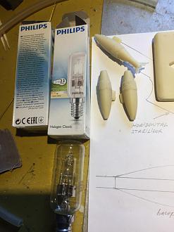

                  Made three O2 exhausts, why?, i lately found out on some stills of a video, the V80 had two O2 exhausts!!!, so two for David and one for myself, drove my boat for about 5 years without knowing this, those bulbs can be used to make the dome.

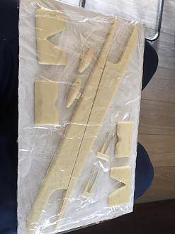

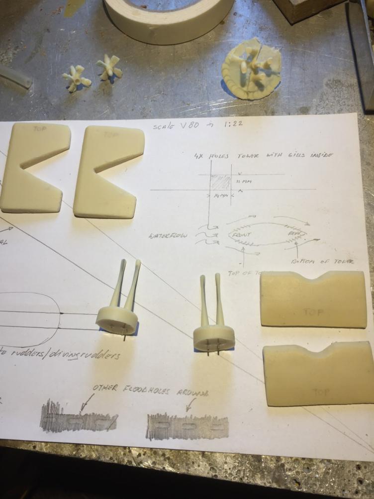

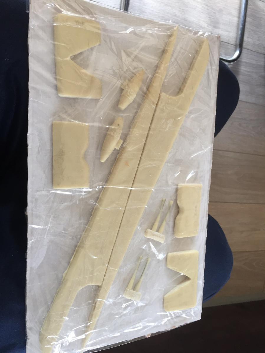

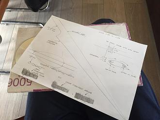

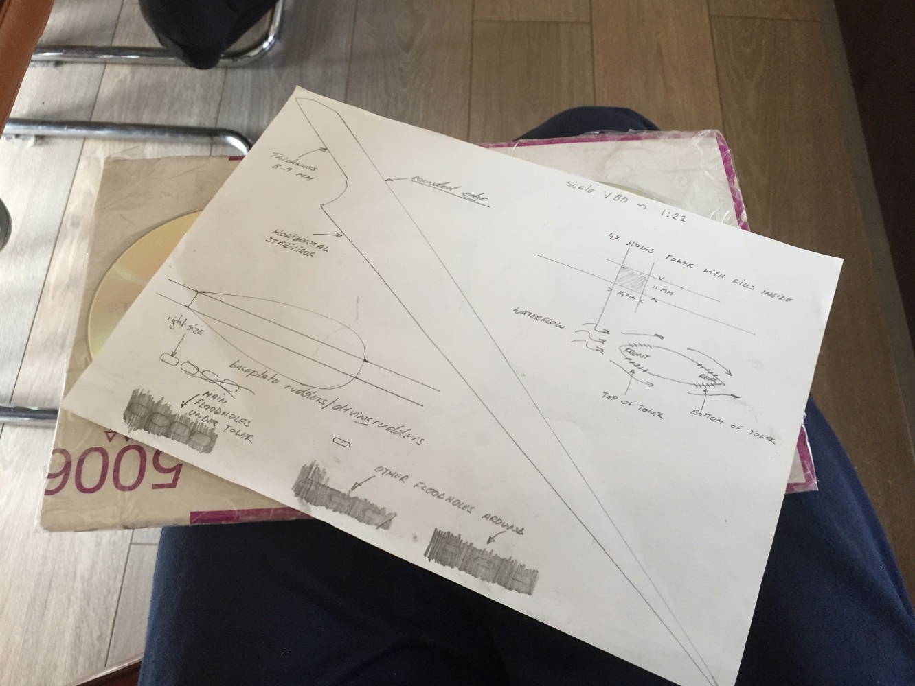

                  Made a simple drawing on the floodholes and some info about the "gills" on the tower, send David also a set of original buildingdrawings which i had become from Stefan Schmitz from SONAR.

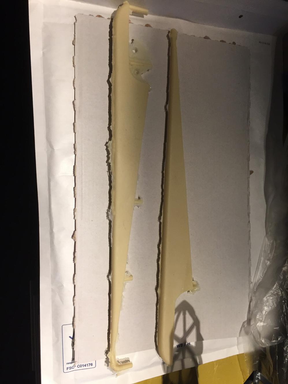

                  Sticked all the stuff on a piece of cardboard, it seemed to have worked, no broken parts when arrived.
