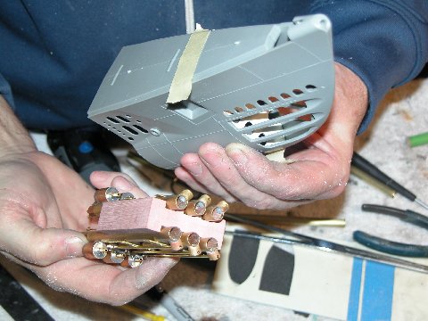

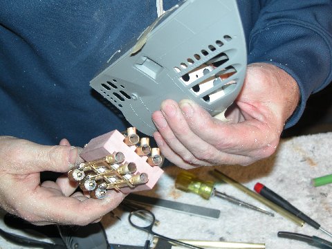

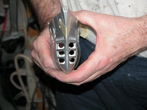

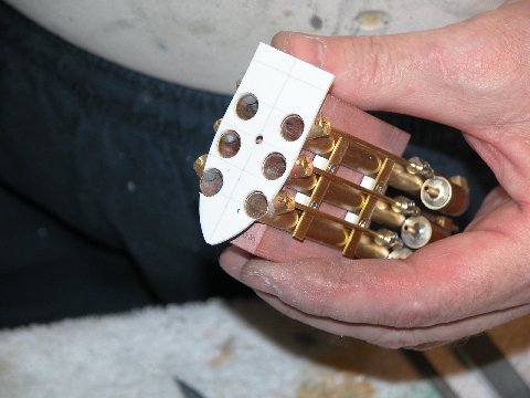

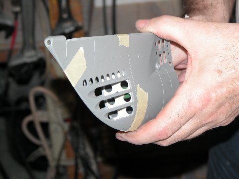

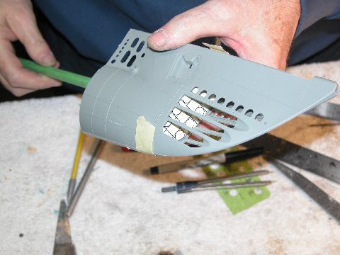

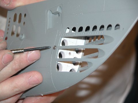

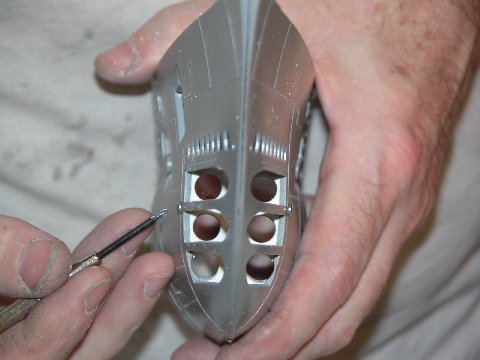

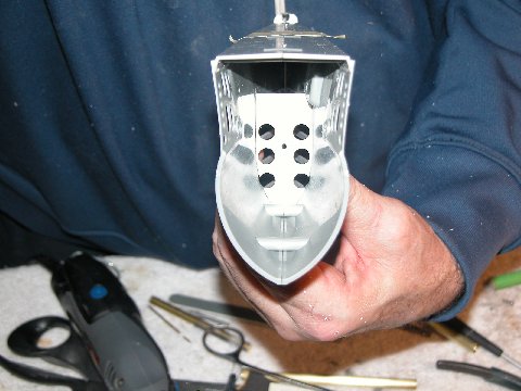

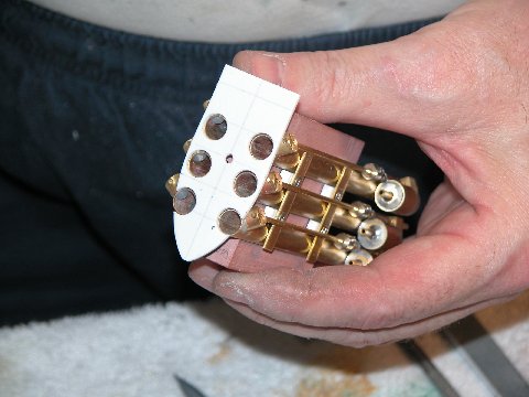

    Here are some shots from The Cave, with The Wizard showing the installation of tubes. Note the special plate he's made to align the tubes. These will be available in due coarse as an add-on product.

    Magnifico, bravo, very nice work, I'm glad I never cemented my bow to the main hull. However, just wondering how much foam will be needed to offset the additional weight in the bow. Thanks for the peek shots.
      • 14013
      Thanks, Al.
      About two cubic inches of foam per tube, a bit less I think, I'll work up a firm answer on that soon. Believe it or not I'm producing a bow and stern torpedo launcher interface kit that will allow of installation of the tubes with the bow and stern sections already permanently bonded to the main hull. I'm almost at the point of tooling up the interface masters and from there I'll move on to make a commercially available kit for you guys. I'm awaiting some raw material from McMaster-Carr, then I can get underway with the orders and interface kit.
