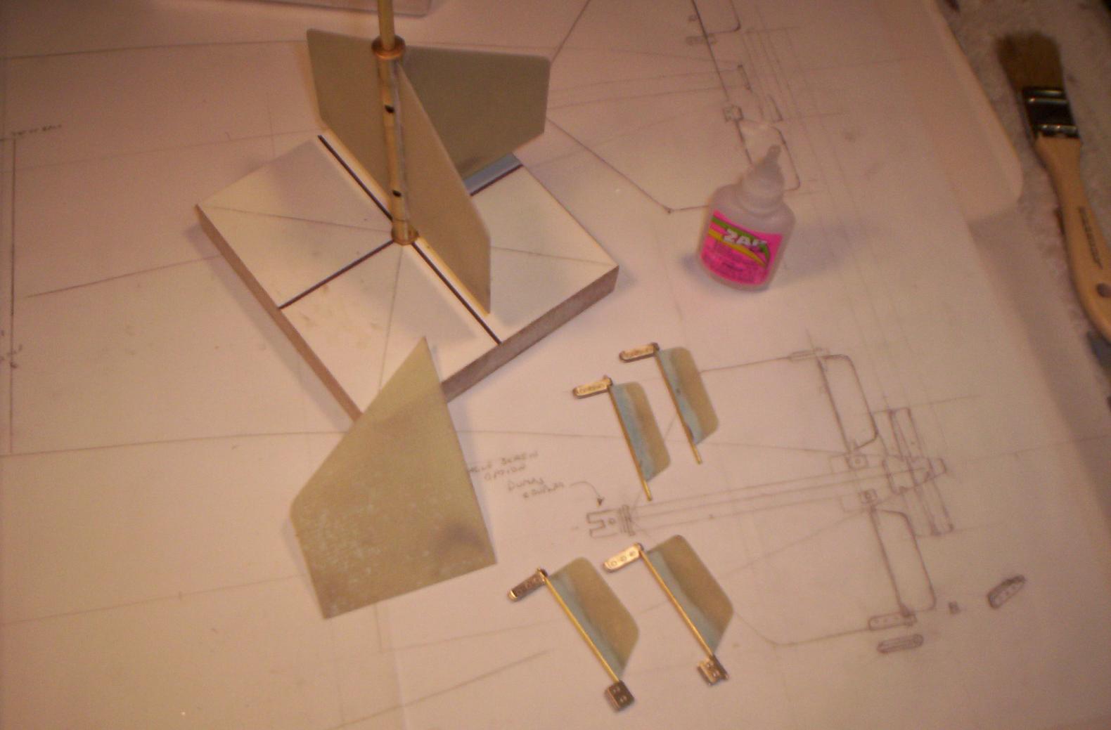

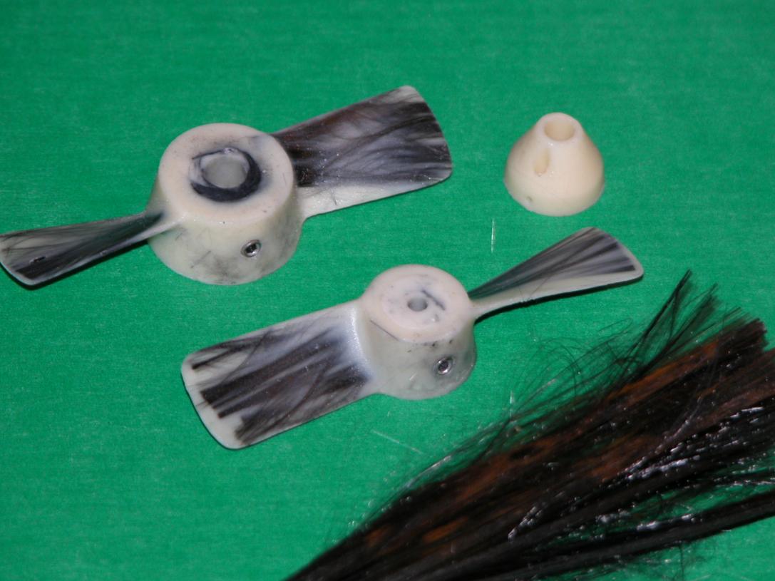

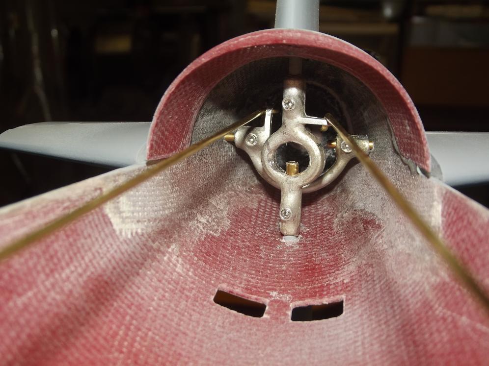

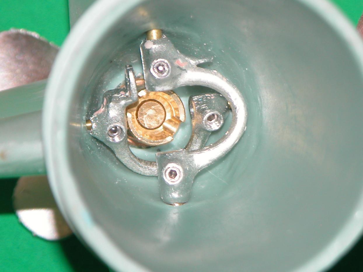

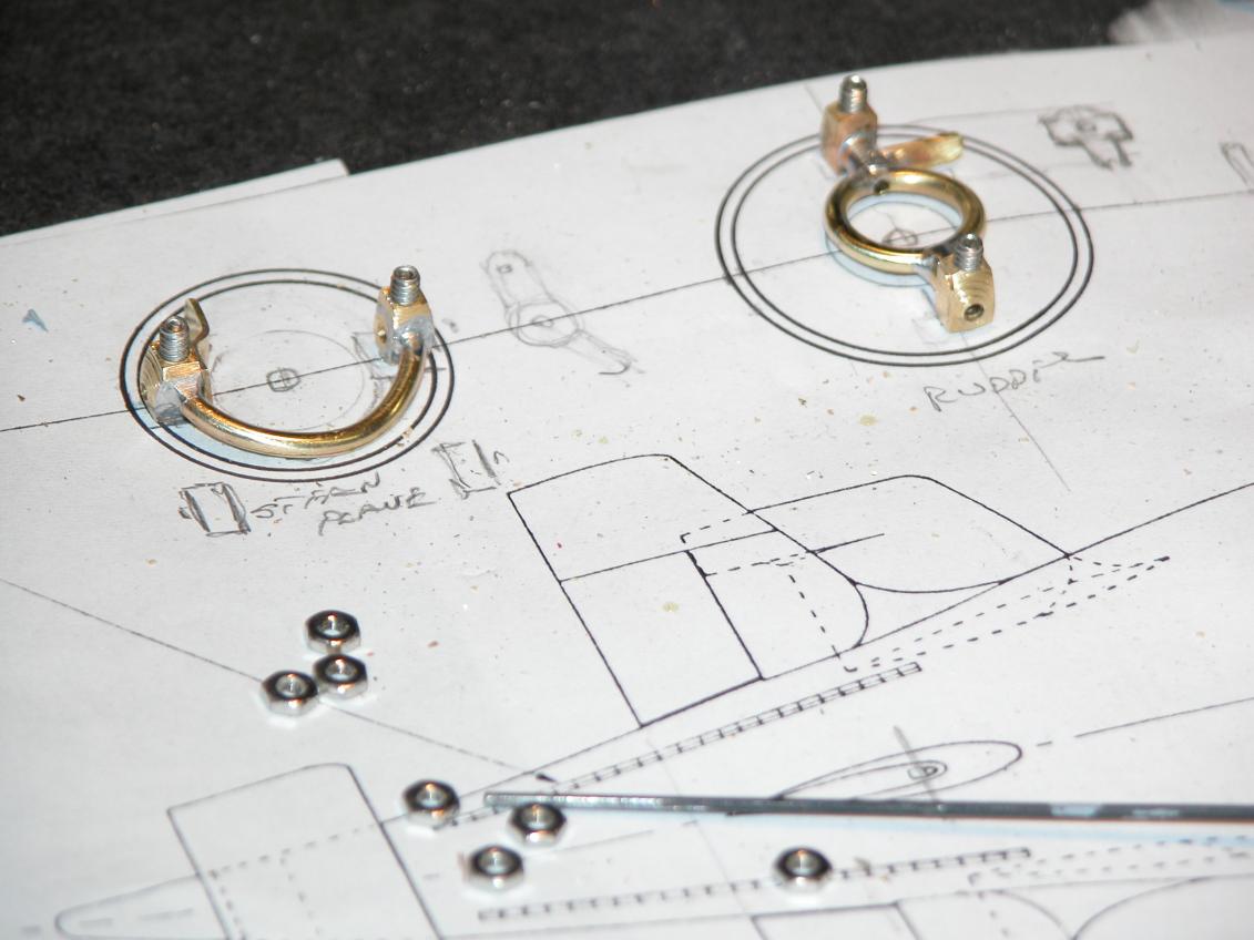

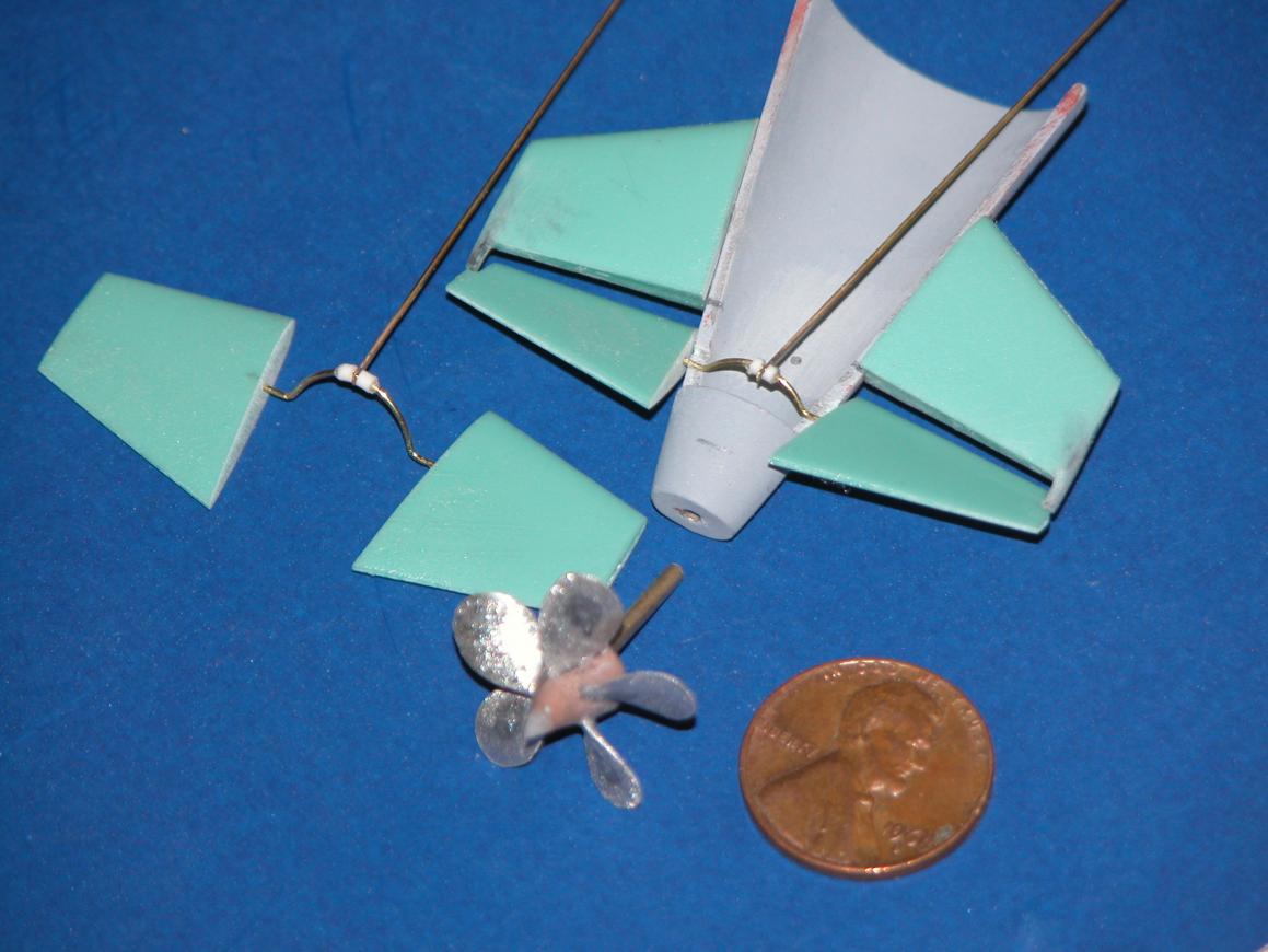

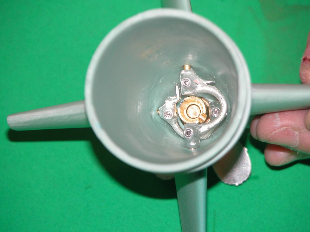

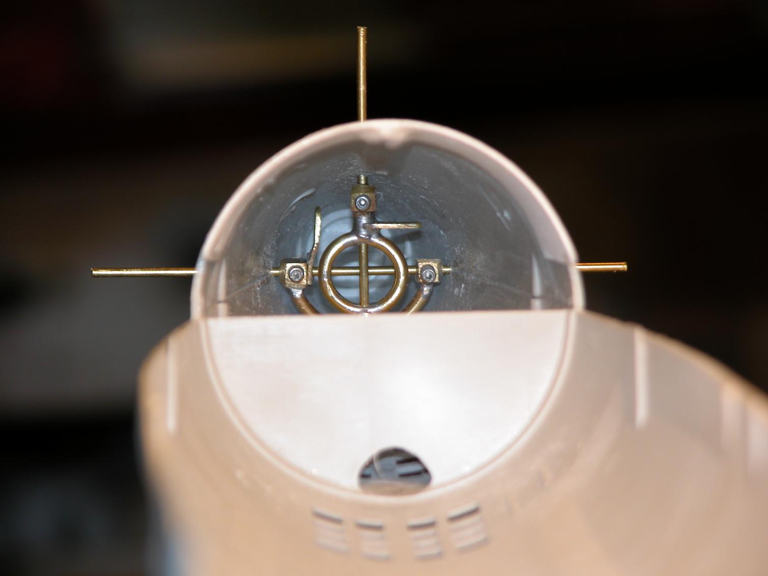

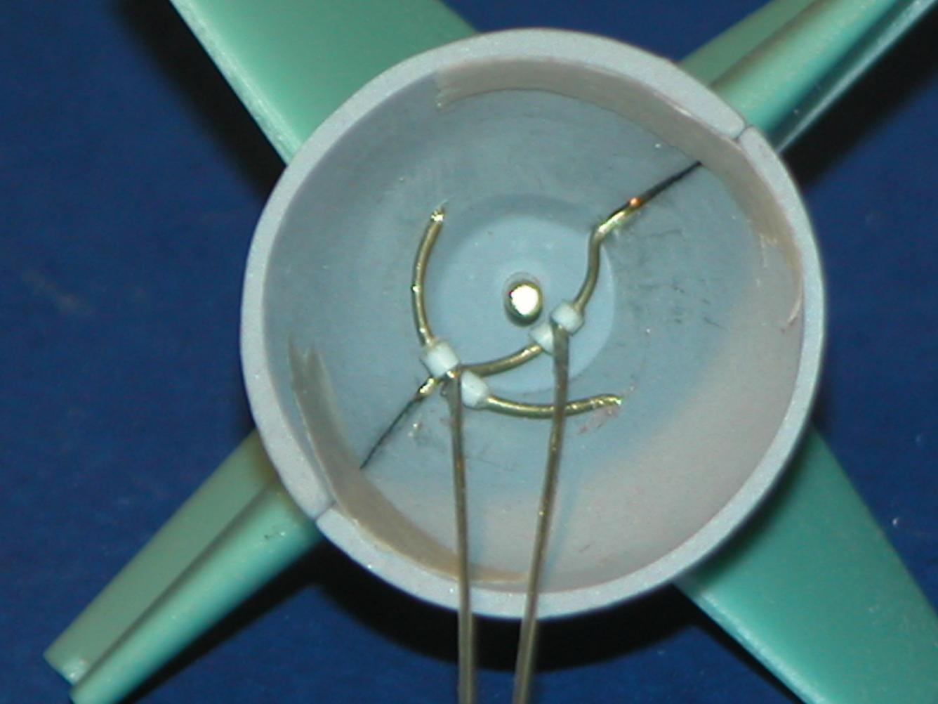

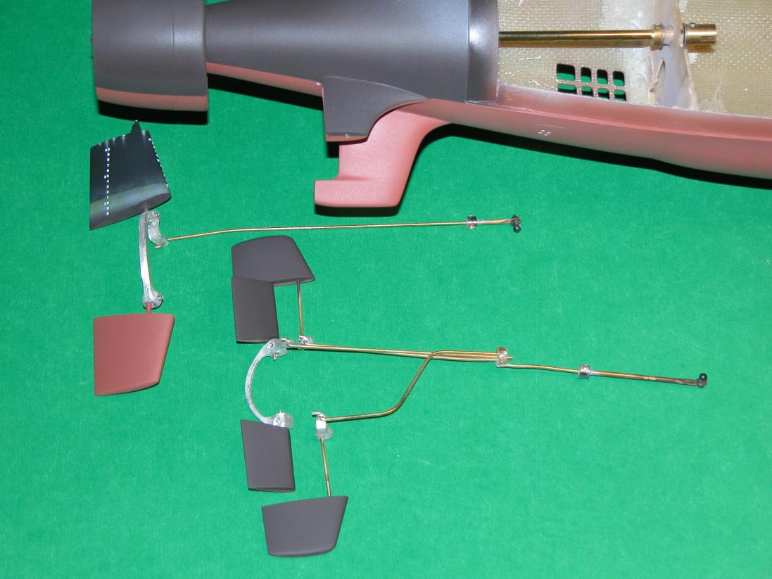

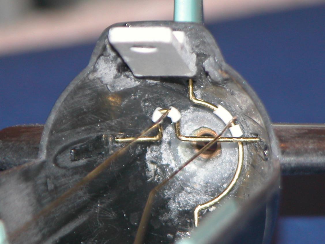

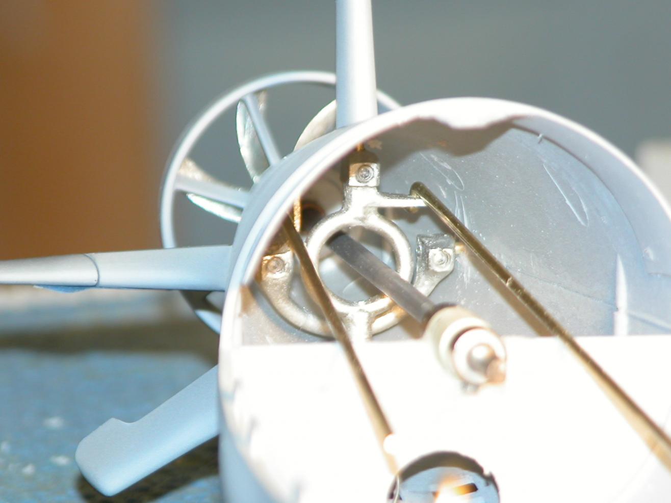

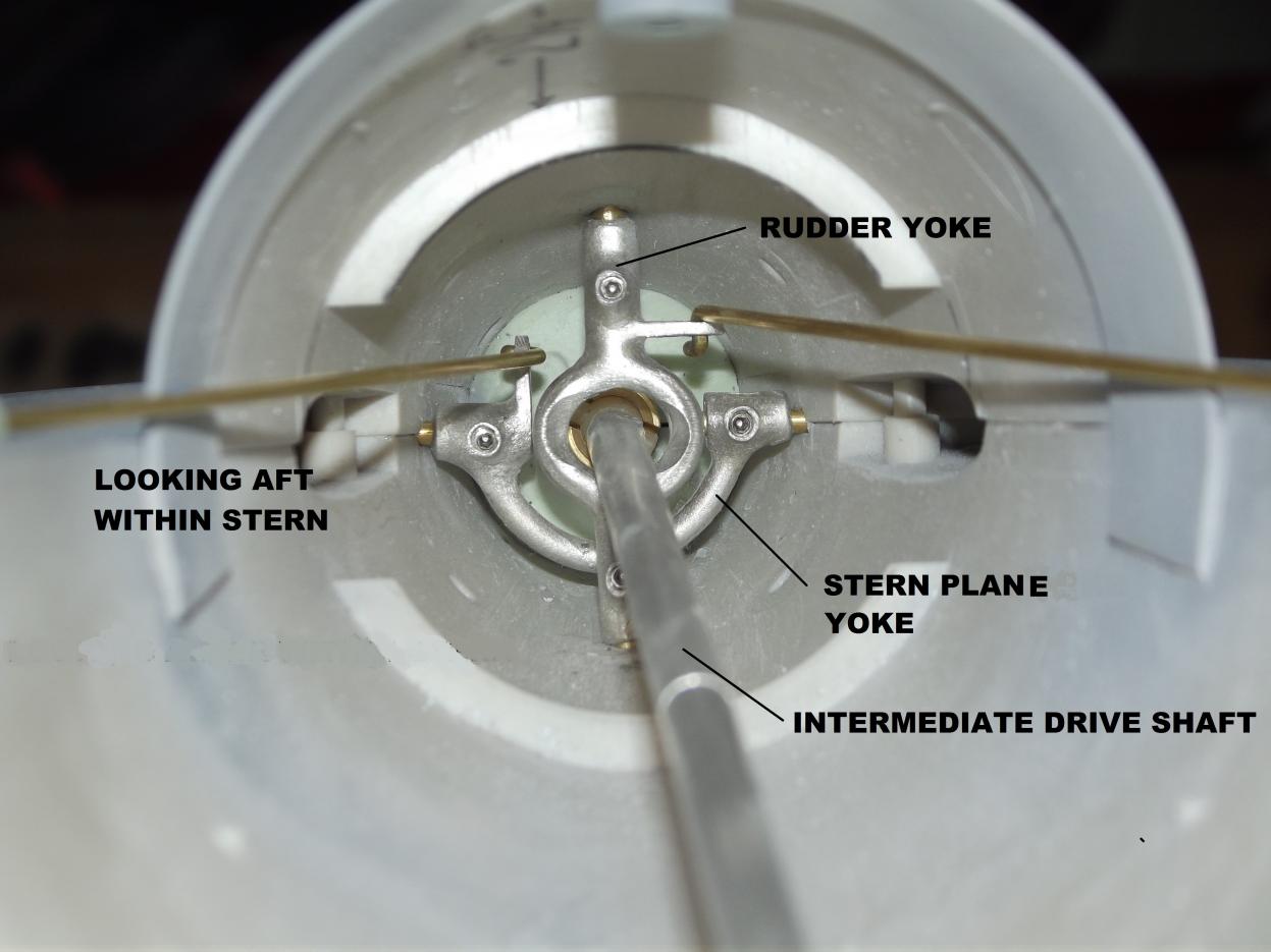

    Can anyone post a picture of the tie-rod arrangement that they used to activate the 2 rear horizontal, and vertical tail fins, and allowed for the drive shaft. Any sub that uses the same sort of configuration for tail fins will do.

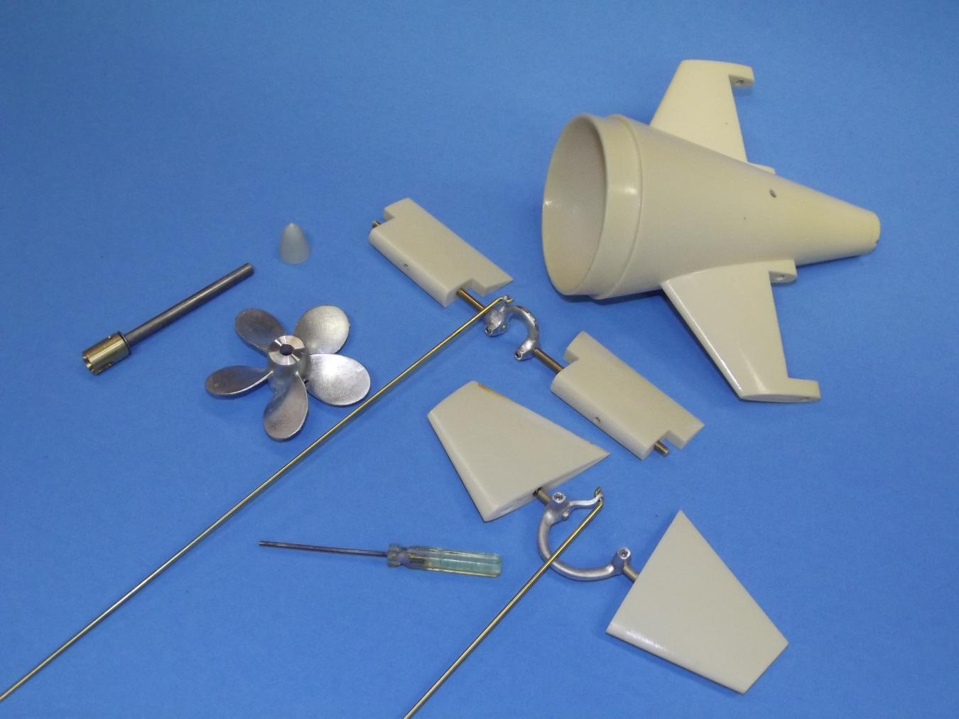

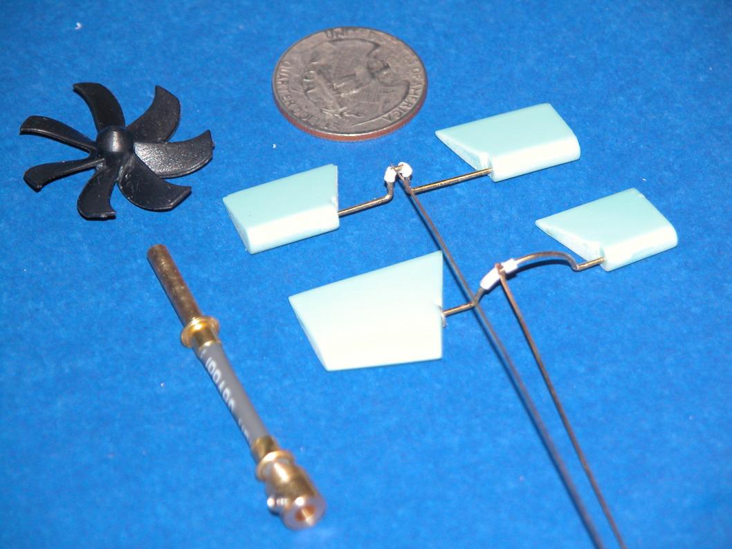

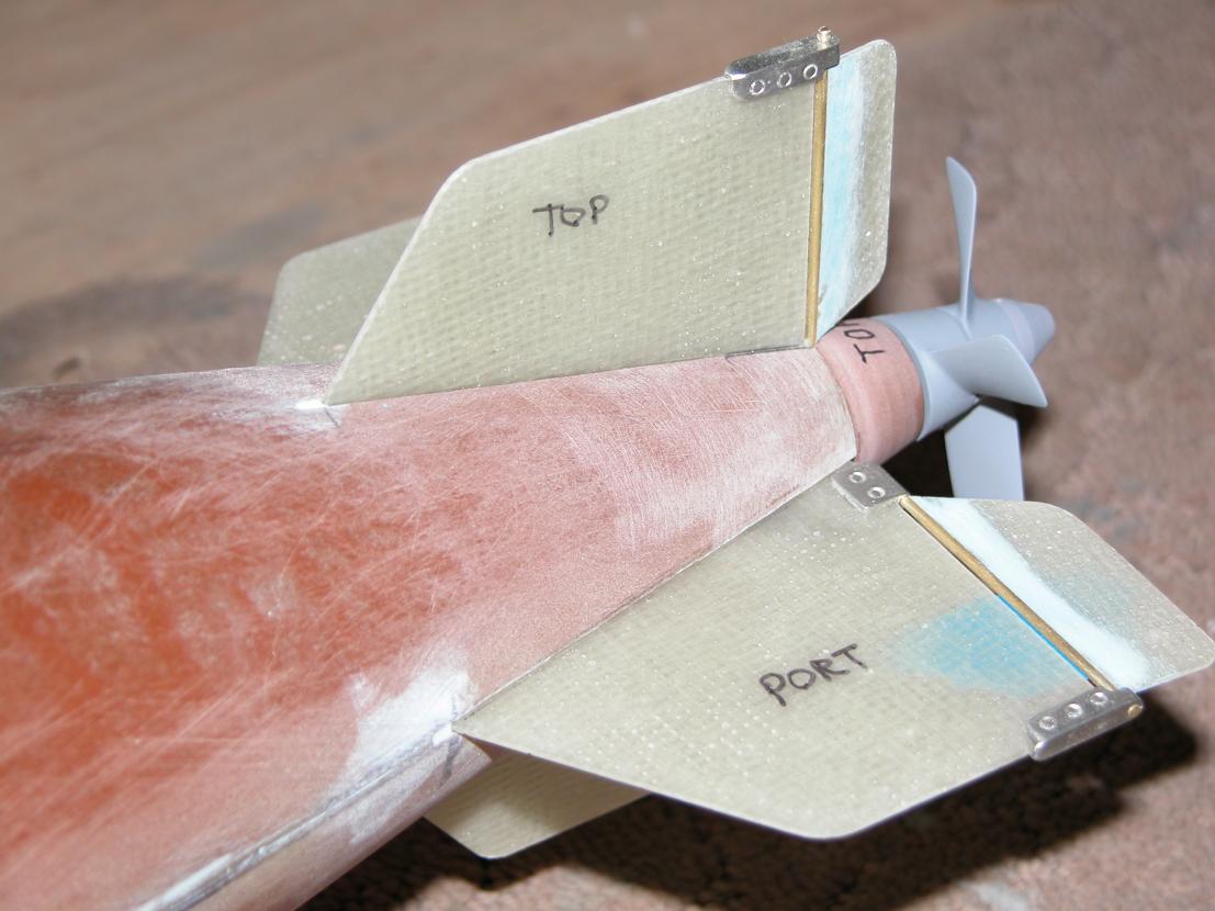

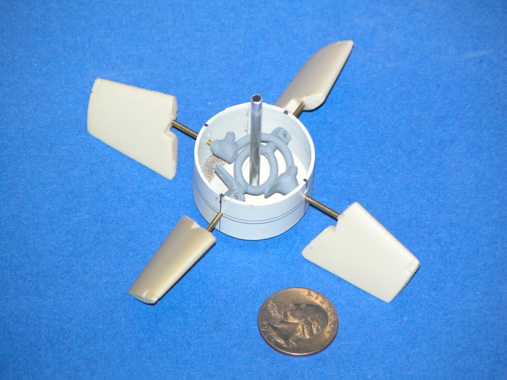

      Thanks in advance
      Kim
      Prepare for sensory OVERLOAD!

        Wow, that would have saved me from a lot of agrivation on the Ko Hyoteki, if I knew about those gimble castings. I like the simple wire and teflon stops idea too.

          That last pic....that is a close fit....and you probably squeezed in contra rotating propeller shafts because you had some room left?
          I’m a little surprised you didn't make the props steerable too.
          After seeing this I will try to gradually put the pieces of my, once healthy self-esteem, back together with duct tape and continue with my build.

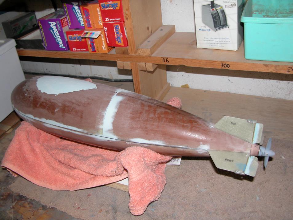

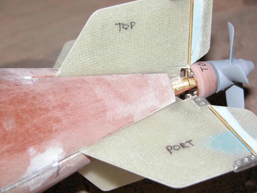

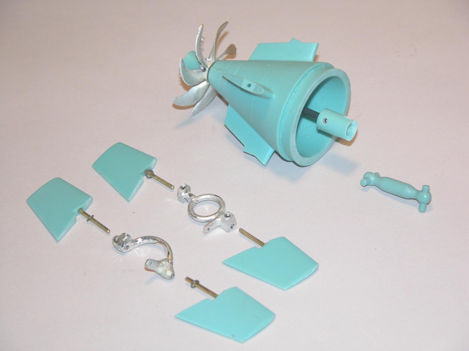

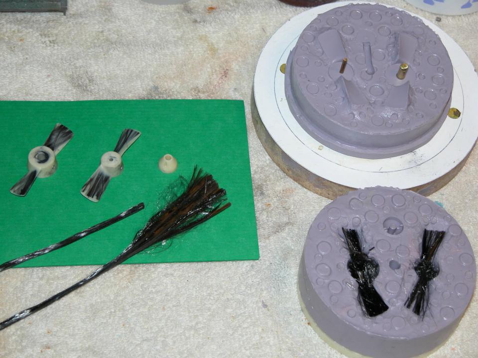

ID:	98426 Darrin Hataway (one of the most fearless Model Builder's I know) was kind enough to share with me his original tooling for his DELPHIN (spelling?), the German K-Corps intended one-man mini-sub. I got as far as the control surfaces and running gear, put it sits collecting dust as I got caught up in production work (I blame my boss, Mike Caswell, the Evil, Dark Overload of the Universe).

                      Mr. Caswell and I hope to one day produce a vacuformed kit of this thing. But, that won't happen till I catch up with orders -- something I have not been able to do since hitching our wagon to his.
