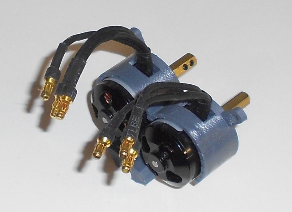

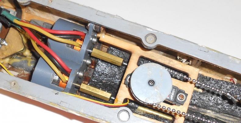

    Here's some motor mounts. The first is installed in a 144 destroyer, the second is for a cruiser project.
